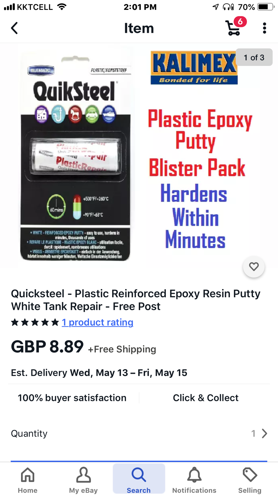

There plenty of products around Gary and first thoughts are a epoxy mix glue for cracks etc. Wielding is risky and a lot more involved to be concerned with.
Would be the first choice I would consider tbh.

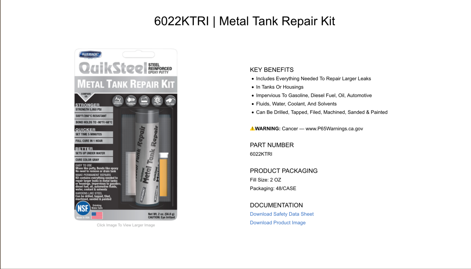

Dervish, does that actually cope with fuel, it says from what I can see, 'tanks', that may be water.
Epoxy putty is good though for loads of things
There are many products all Similar tbh with all pretty much doing the same job. These products do many jobs and have many uses from what I’ve seen. Description below.
QUICKSTEEL - PLASTIC REINFORCED EPOXY RESIN PUTTY WHITE TANK REPAIR
You can trust it - the UK's leading roadside recovery service does!
Quiksteel Plastic - White, is a two component epoxy resin in a single stick; the outer layer is the epoxy and the core is the activator.
Here are a few reasons why Quiksteel, the world's toughest epoxy putty is a winner with both the professional trade user and the DIY enthusiast:
Sets steel hard within 15 to 30 minutes, even under water, achieving a full chemical cure within 60 minutes. It's impervious to petrol, diesel, oil and even battery acid.
Permanently bonds to aluminium, brass, copper, steel, PVC, fibre glass, plastics, glass, wood and more.
Repairs leaking fuel tanks, kerbed alloys, stone damaged radiators, cracked sumps, stripped threads and exhausts. Around the home it can fix anything from leaking gutters to a leaking central heating pipe.
It is temperature resistant to 260 degrees C (500 degrees F) and it is drinking water safe.
Bond holds to -32 degrees C (90 degrees F)
Detailed instructions included within the pack.
When fully cured, Quiksteel Plastic can be drilled, sawn, milled, ground, filed, tapped,sanded, painted and lacquered.
Quiksteel Plastic - White reinforced epoxy putty - easy to use, hardens in minutes, thousands of uses - every home and every toolbox should have one!
Tube size: 56.8 g / 2 oz

This the Quicksteel you want, it's the proper stuff for fuel tank repair. I'm gona get me some of that.
Although I cant see any difference between the Grey or White apart from the colour. Theres a Green one as well
