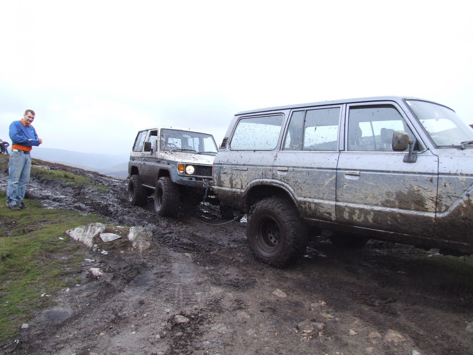

This is a good picture of these 2 trucks.
Was hard to find that picture!
Ahh yes, u see i tend to shy away from the ones where im being towed out :lol:. nice pic mate, one i haven't seen :thumbup:

Ah, now I have a photo of that 70. Not being towed, but being stood on :icon-biggrin:
Thats a good pic there Steven, You must have been a good 4' to 5' off the ground where you were standing! It's always pretty good that truck with standard suspension and road tyres!:think:

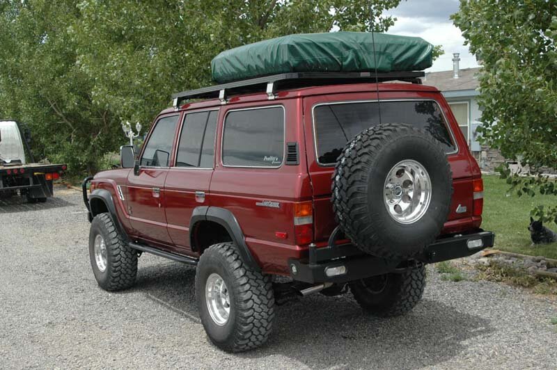

What are you planning for the rear bumper something with a spare wheel carrier and recovery/towing points I've been looking at some nice ones but they are either in USA or oz and cost a fortune.
We were looking at that job last Sunday, trying to hatch a plan:think:
I was looking about an hour ago at this and on some of the builds on IH8MUD.
Something high up again. Will be able to get the spare wheel carrier spindle hub and bearings of a local blacksmith guy. Unless someone on here has a supplier?:think:
I did see the ones for sale in the US but for $1799.00 its avoidable!

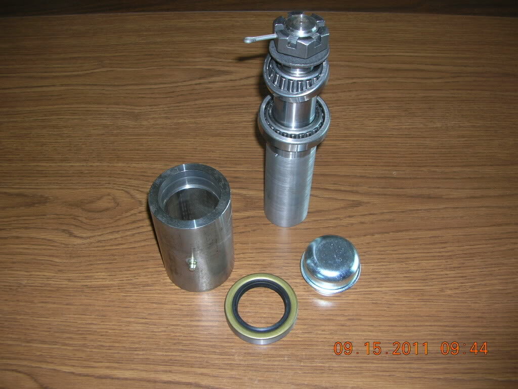

I am looking at this at the moment and was going to use a wheel bearing from something as they are 2 taper rollers back to back but in 1 housing so all you would need to machine is 1 'tube' and they are sealed for life.
this way it meanis you done have to have a stepped tube with the seals and bearings. would be a lot easier and cheaper to produce.

These guys sell the pivot kit.
I do see what you mean with like a rear axle bearing hub off like a drum braked golf for example. To but also from an industrial application that uses a similar setup.
