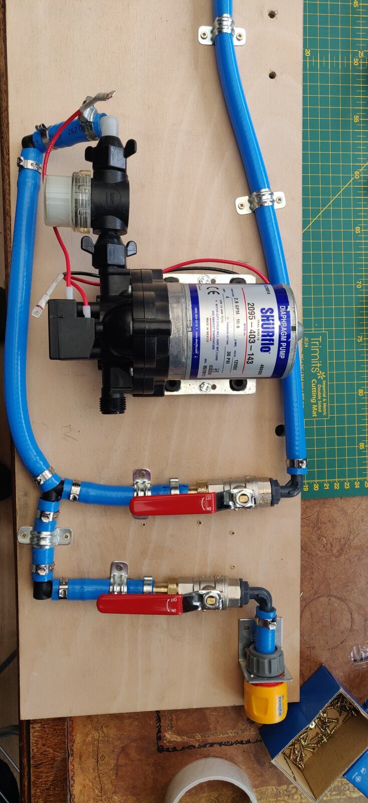

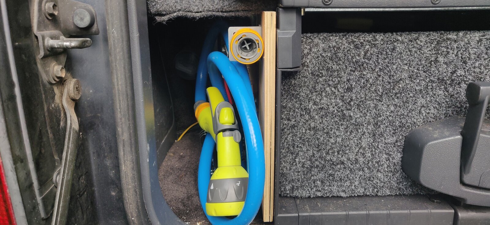

Would love to have something permanently fitted in the truck but I haven't found anything compact enough so I went a different way. Collapsible bucket, short length of hose and a couple of valves to switch from main tank to the bucket and a conveniently located attachment point that sits flush with the drawers.
I does takes a little longer in prep, usually 5 - 10min to heat up enough warm water in the jetboil, set up the shower tent and sort out the hoses but its a whole lot more space efficient and cost me about £15 in parts! We only have a 40L tank so it also helps make sure we use only what we heat up, no 20min leisurely showers here!
