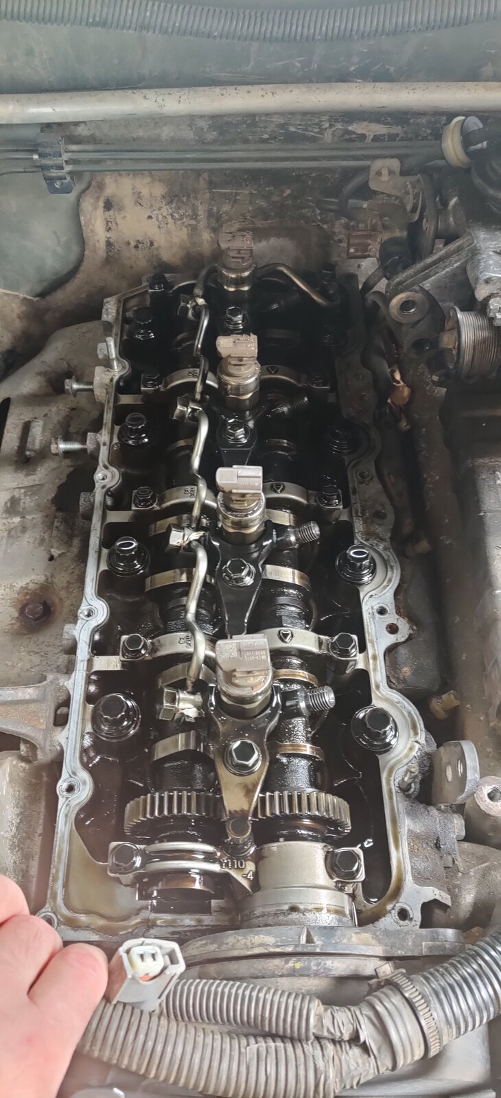

I've not gone further than this, as I'm about to find my endoscope and inspect the pick up. I was going to do that anyway, but this is what I've got right now.
I'm not an expert, but I think I'm right to assume this sludge at the top shouldn't be there?
Nooo, that does not look good at all. I'd be curious to know what state the oil pickup strainer looks like.
Also curious as to the injector seats and seals.

Hell fire how many thousands of miles did that poor engine have to endure between oil changes, i don't believe it was just injector seals responsible.
Seen two engines with carbon build up as bad.
One was the typical neglected Ford CVH lump, and one V12 MB engine stripped down on my MB indy's bench, both cars suffered neglect of fresh decent oil for many thousands of miles.

If the pick up is clear, would I be alright to just clean the sludge I can see?

Be interesting to see if the inside of the sump/crankcase show similar carbon build up, i would definately have the small lower sump off and judge then if the main sumpe needs to come off as well for clean up.
The problem with such build up is what to do about it, flushing oils i don;t think will tackle such build ups, then yopu have the danger of clumps breaking off and blocking the oil pump intake.
You've got lots of cleaning ahead, good luck.

I was expecting something similar to the head, full of gunk, but in all honesty it looks quite clean. So I'm going to leave the sump as it is. As for the rocker, I'm going to clean the bits holding on to the injectors as they look like they have the worst of it. In and around the cams, while it looks black, it doesn't look like sludge.

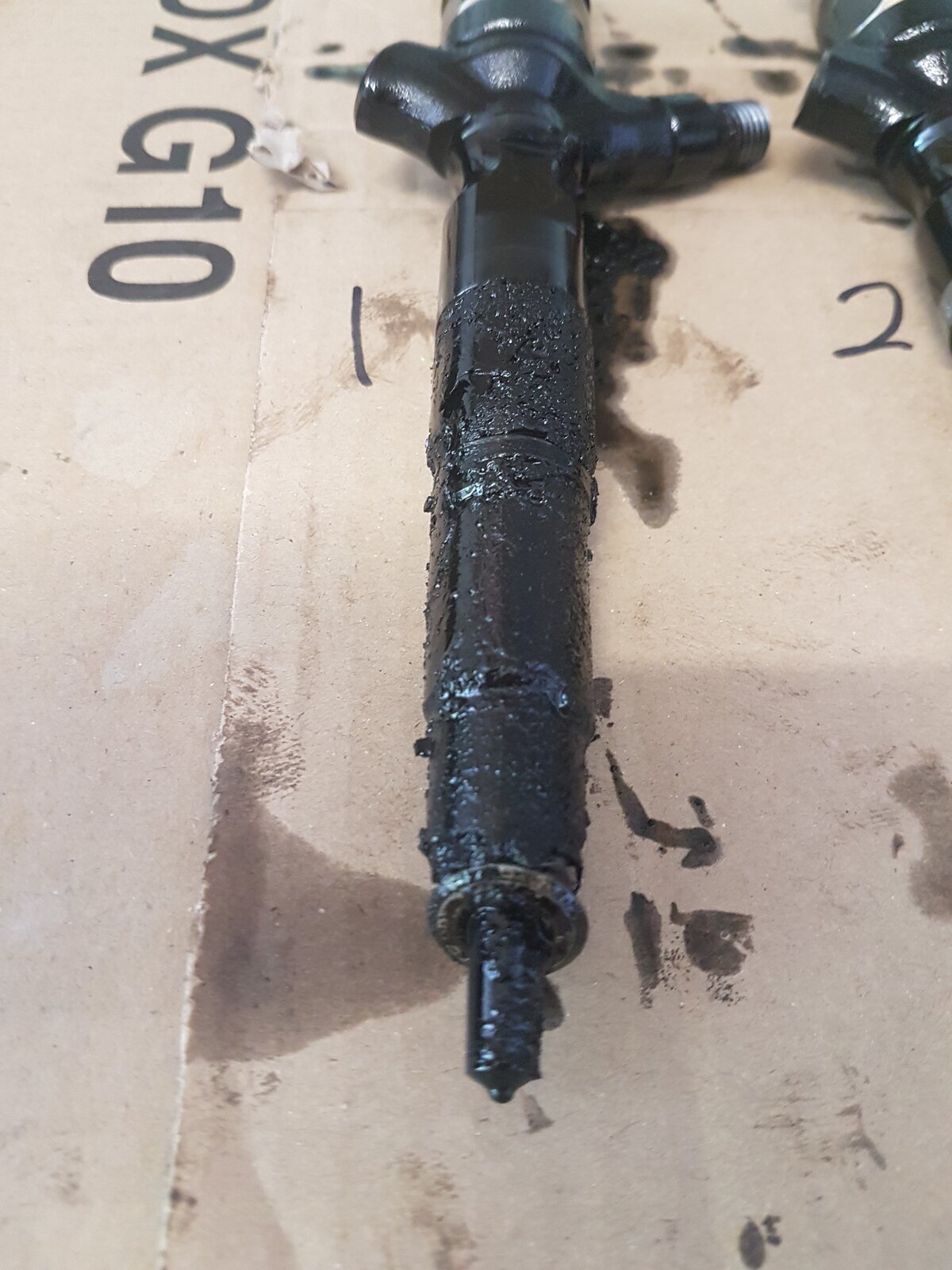

Got the stuck one out, have a look at the state of it. The stuck one is at the top.
Closer...
Notice, if you will, the top one doesn't have a washer. I've not taken it off, so it either never had one, it's burnt away to nothing, or it's still stuck in the engine!!!
It was stuck in the engine, I got it out by using a pick tool.
Fourby4diesel makes this look so bloody easy, but he definitely earns his rate I can tell you all.
