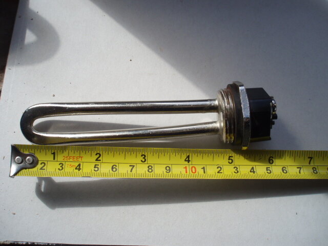

Sometimes I get some very good quality used veg oil that only needs de watering and filtering but I like it to be less viscous and I was wandering if the standard fitting would do the job before the heat exchanger warmed up but if not I'll knock up a glow plug block.

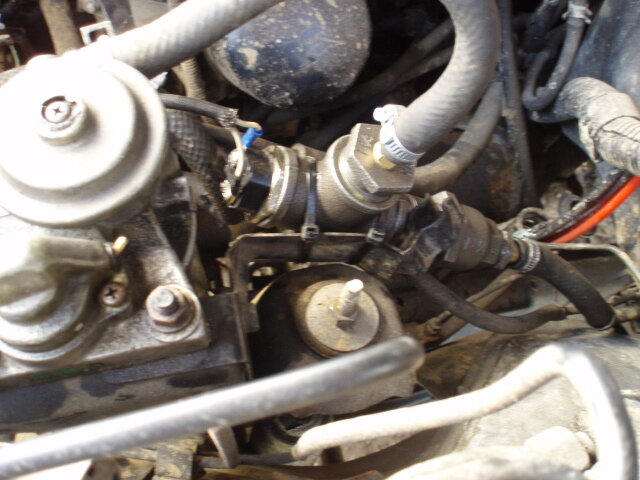

Looks like it's not working . It has an ignition feed but certainly not getting warm . Is this a permanent feed or is there a temp sensor of some kind that switches it on and off ?
The ign feed powers the fuel heater relay which in turn supplies power to the vacuum switch built into the heater unit. With a vacuum of 10.24 ins/Hg applied to the vacuum port of the switch there should be a resistance of 0.5-2.0 ohms between terminal 1 in the heater connector plug and the switch body. With no vacuum applied it should be open circuit. If the vacuum switch is knackered the heater will not function.
Many thanks. The feed I am talking about is to the heater unit in the filter itself thats without the engine running.Can't see any vacuum unit to operate it.
The vacuum switch and heater unit is in one piece and is fitted on top of the filter unit. Look for the wires that go to it. The vacuum part is the bit at the bottom that you can't see without removing the unit. Vacuum is presumably created when the engine is running. As fuel is drawn from the tank into the fuel pump via the filter/heater a low pressure i.e. vacuum, is formed.
