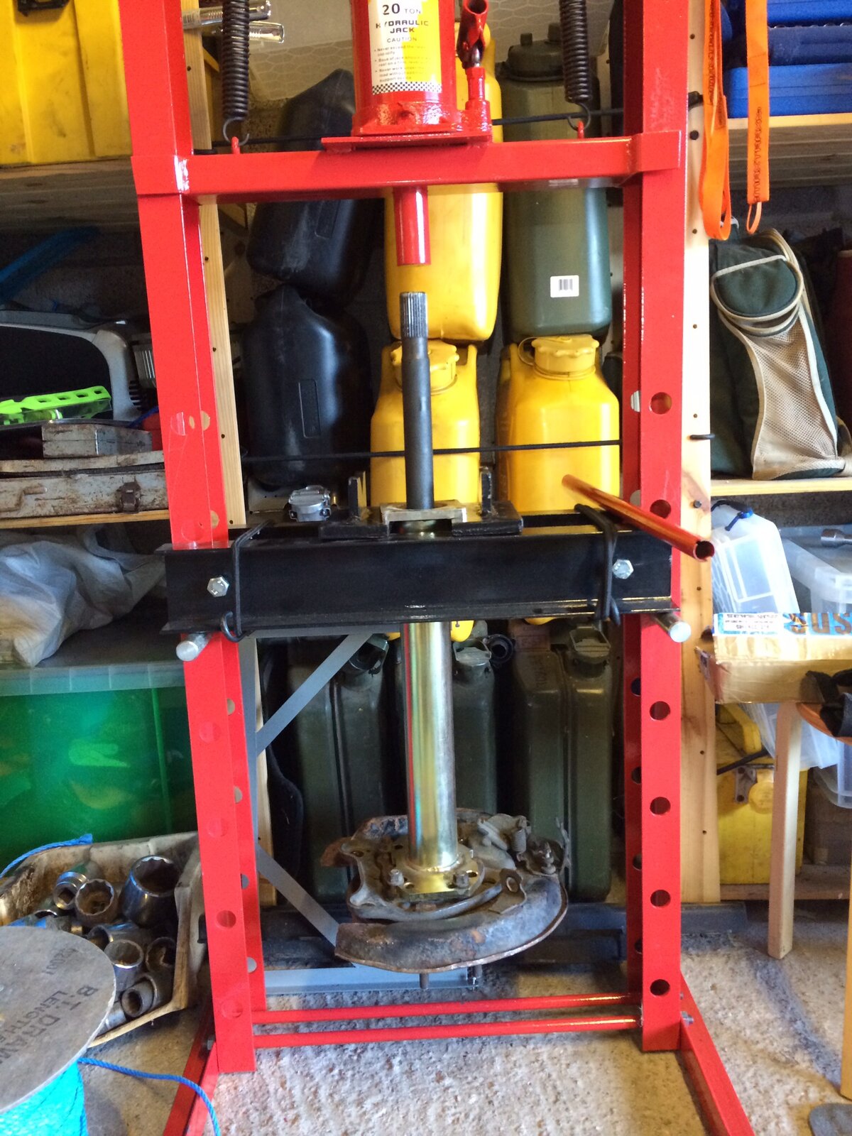

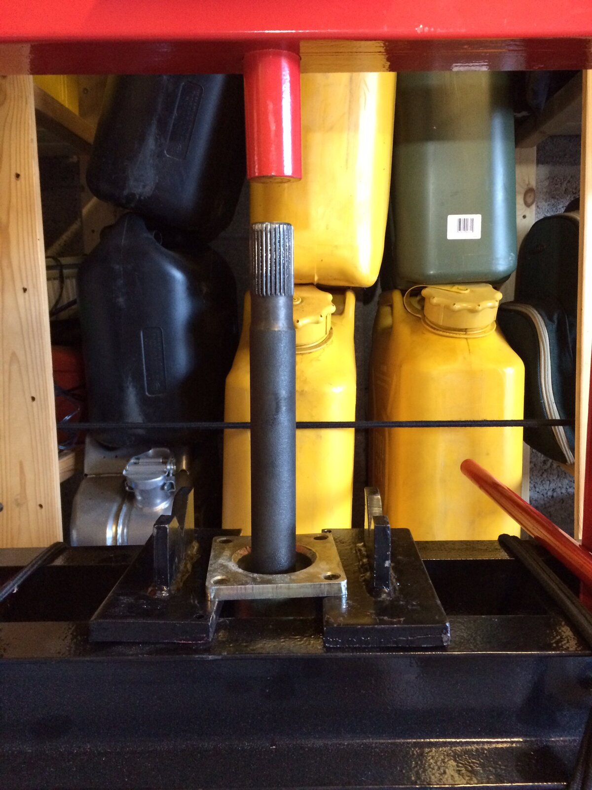

this is the tool being used to push out the shaft before you can get to the bearings

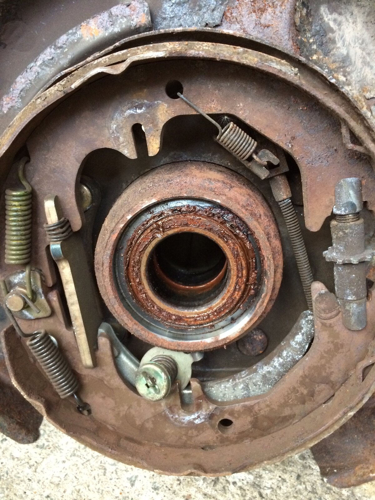

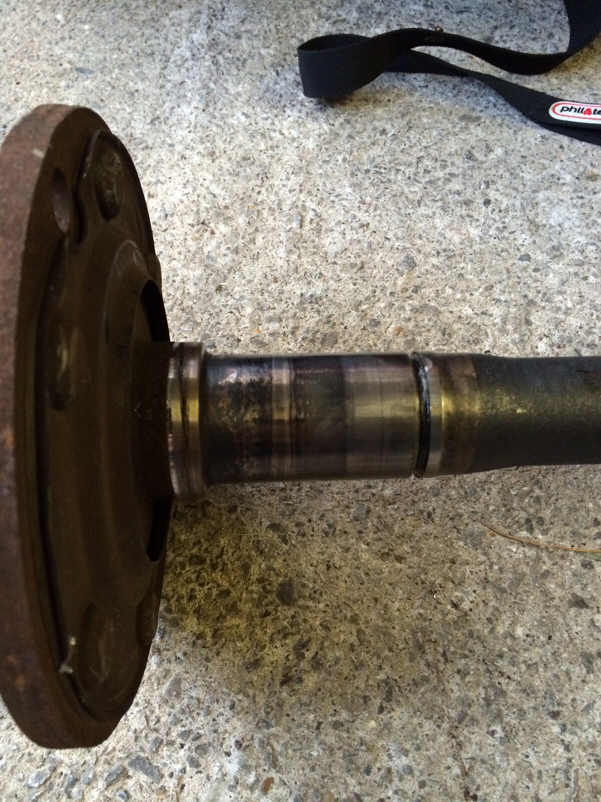

Once the shaft is out you can then push the bearings out of the hub
Awesome. :thumbup:
Thanks for the pics, I finally understand how that tool works! :oops:
I will have to make me one so I can change my bearings before my big trip. :icon-cool:
