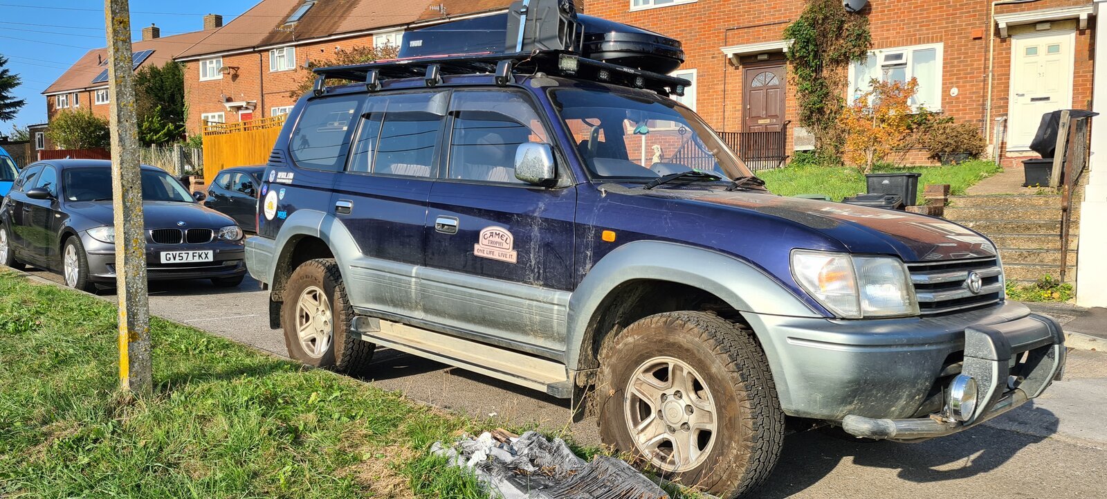

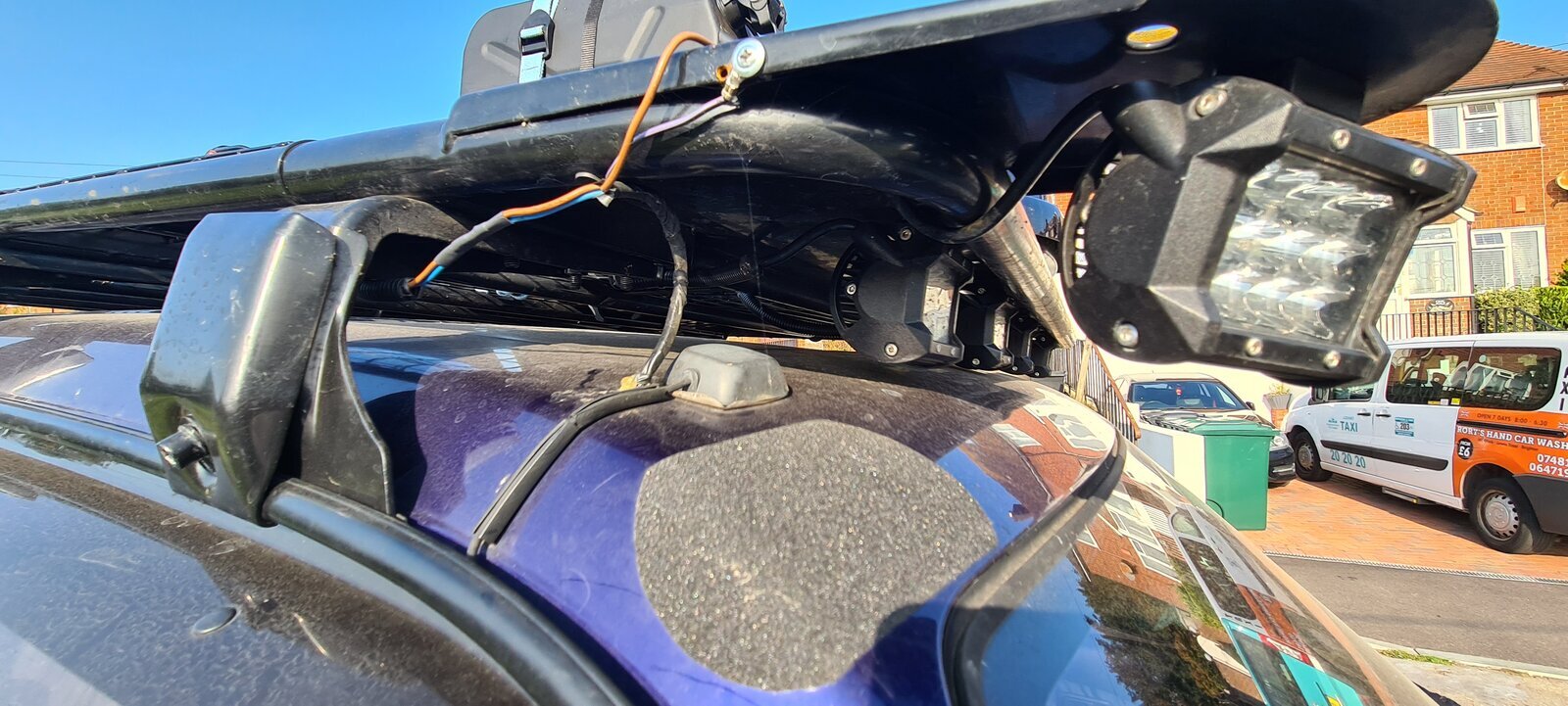

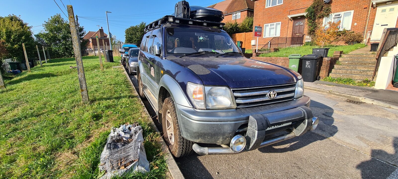

prado roof lights are wired, 2nd time with waterproof switches. unfortunately the first electrician drilled through the roof of the car. i was shocked because he didn't tell me that is his plan. after all not bothering anymore.
new break pads, shocks for the back were installed. nothing else needed. the rust was treated by me, i have spent 5 days on it.
we took the car up on the Alps, 3x over 2500 meter. slep in snowy peak in July
than drove Prado all the way to Hungary, that off road paradise!! we entered Somogybabod off road festival's field, right after the festival. Crazy mudd baths, heals, long muddy roads. I had to learn to use 4 wheel drive, to use it before entering a mudd bath
Around my mother's village off road every single direction, amazing opportunity for a car like this Prado.
Car was a monster, never failed. Steady power all the way..took on any challenge.
On the way back to UK we took Rhone Alps. Found super spots and we will return. Amazing trip we took, Alps is amazing with cheap diesel on the Austrian side under €1/L
the first wiring was done by a driller through the roof of car. very badly. i've got used to it. i need to cover it to look better. i didn't have leak issues, but i need to prepare for UK's winter weather. is anyone has suggestions???
thanks
