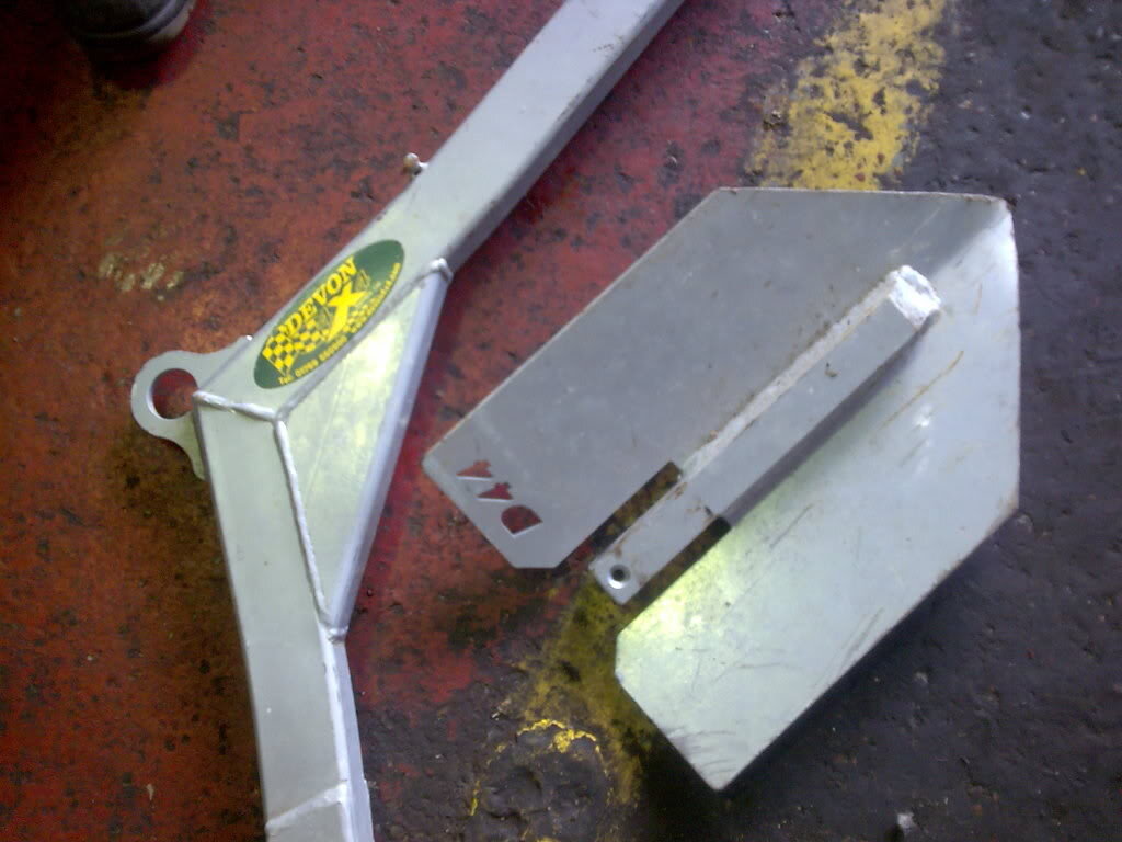

I was rescently offered this D44 anchor by my MOT examiner for £80 (I think they're about £190 new) he took it in part payment for some spannering that he did for someone. I took some pics with my phone as I thought then & still do now that it was the one I'd buy if I ever bought a winch (unlikely) as it was mighty yet uncomplicated with the advantage of being in two parts :)
Hope this is of use to you :thumbup:

would you belive thats exactly what im looking for easy to make and stoor
thanks stevo!!!
