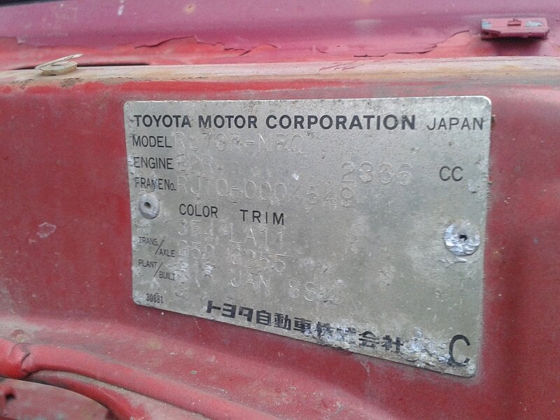

Hi Ben, since you know more about 70 series than me, could you tell me what diff ratio's do you think are in the RJ70 I picked up?

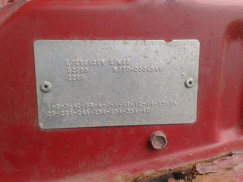

I have attached the vin tags, the axle reads I think G52 G255 ?

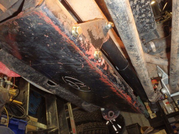

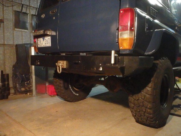

The rear bumper has been shot blast, electro plated and powder coated. I brought it home tonight and got the LED lights fitted to it and then got it fitted on LJ.

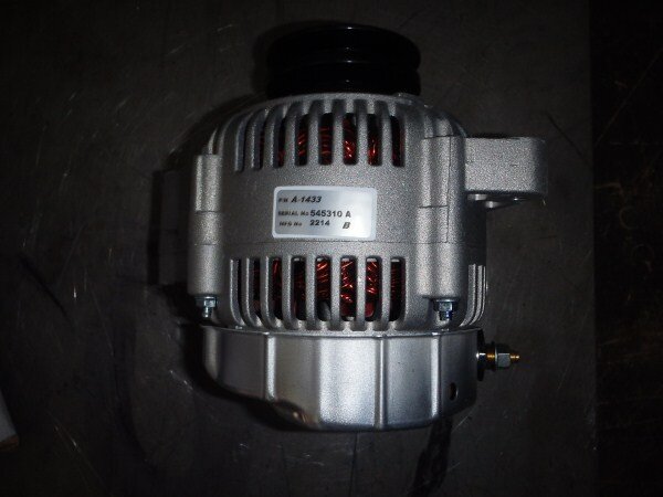

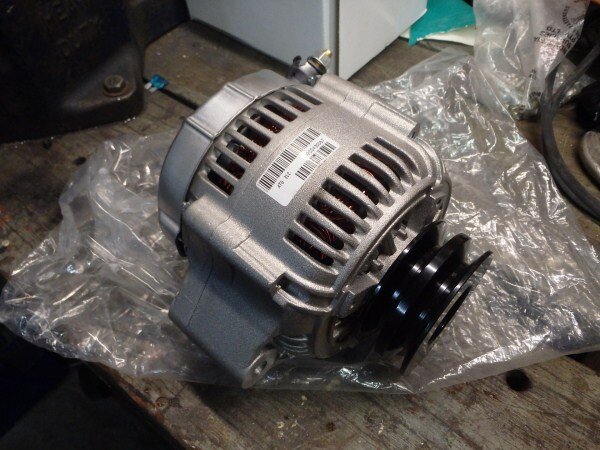

The new 80 series alternator came and on closer inspection the casing looks identical to my old 1KZ-T one (apart from the position of the tensioner mount , so rather than make a new adjuster bracket I'm going to take the new one and old one to work tomorrow and see if the guys will swap the internals out of the new one into my old casing.

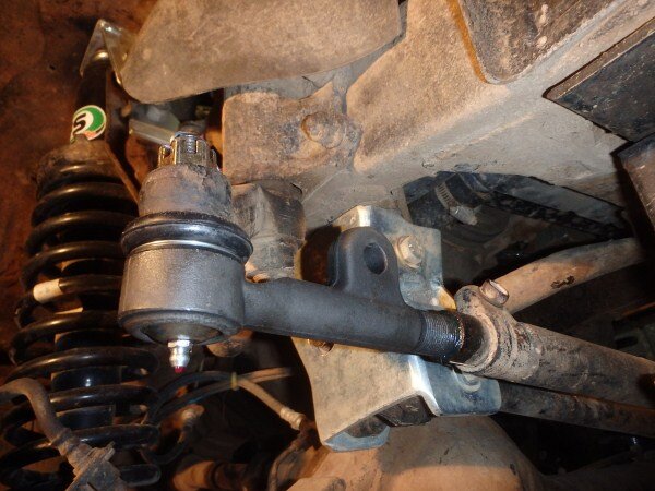

I picked up an 80 series tie rod end to connect to the steering box with a mount for a steering damper on it, this fitted the LJ70 steering bar perfectly and using an 80 series steering damper bolt on chassis mount that I got from Karl, I was able to bolt a 105 series steering damper straight on and it fits and works beautifully. So its got all new tie rod ends now and is ready for a wheel alignment which I'm hoping to get done on Friday.

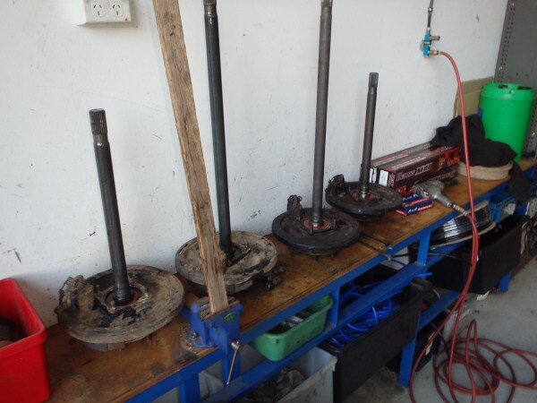

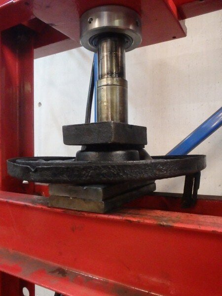

I made another press tool today and pressed all the new rear wheel bearings onto my spare half shafts.

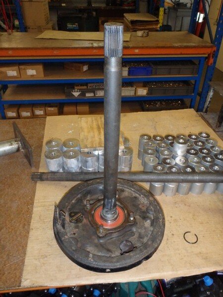

The mechanic helped me and between us we pulled the rear half shafts out and discovered one of the oil seals had let go allowing diff oil into the wheel bearing and both wheel bearings had a lot of movement and so probably wouldn't have lasted the trip. :icon-smile:
Spare half shafts fitted with new wheel bearings and genuine seals. :icon-cool:

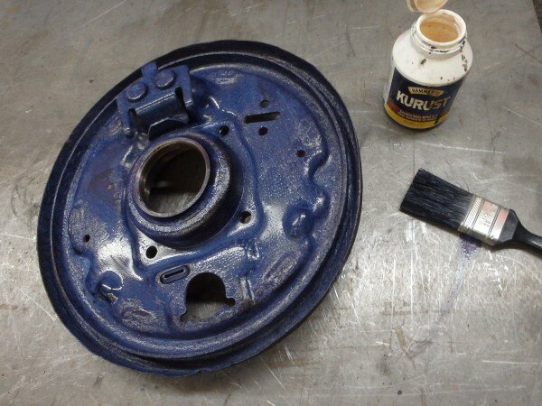

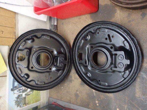

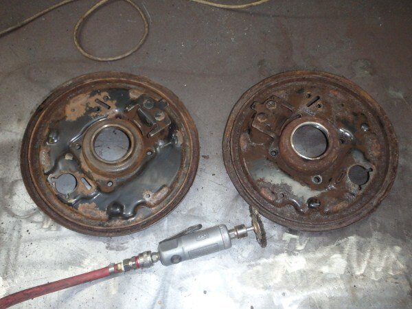

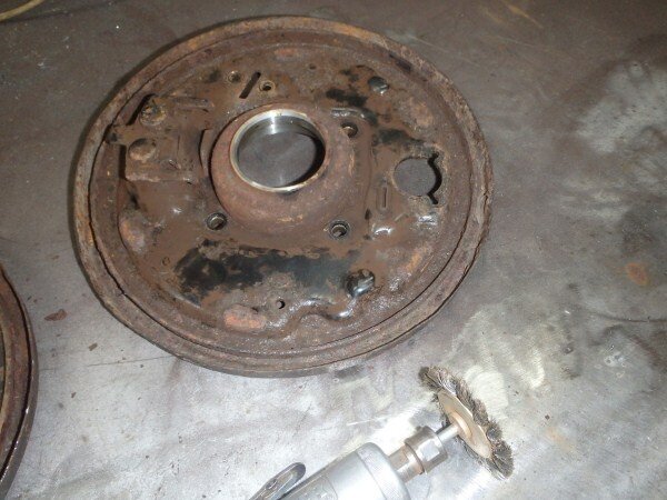

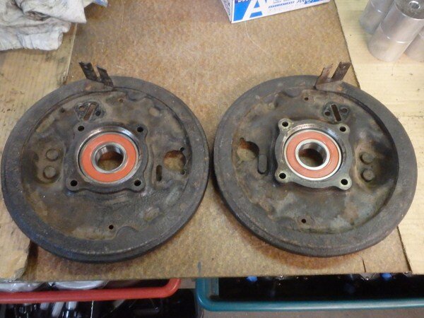

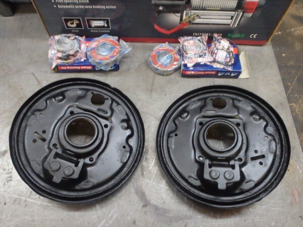

I was thinking of getting the rusty rear drum brake backing plates shot blast and electro plated but decided against this idea as I want to convert the rear to discs soon anyway.
So I wire brushed them using the die grinder.
Rust killed.
And painted.

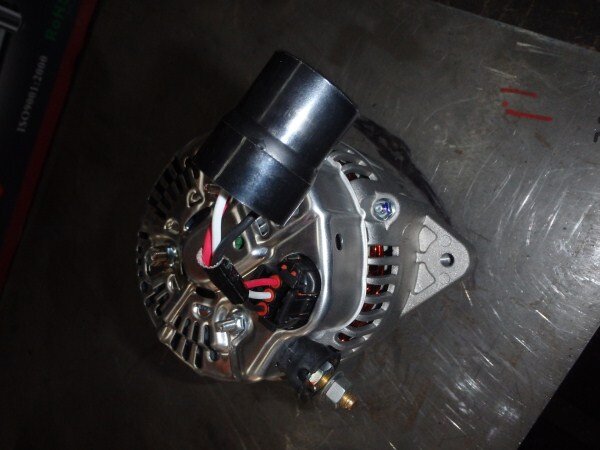

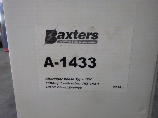

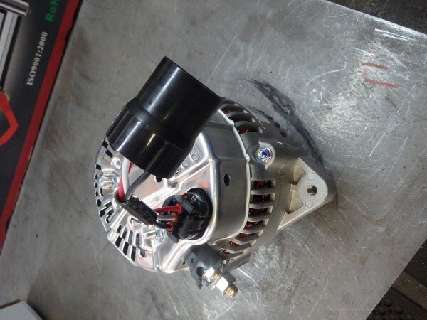

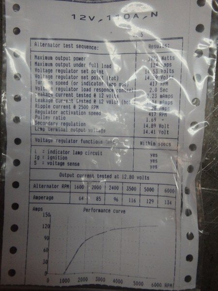

New 80 series alternator arrived.

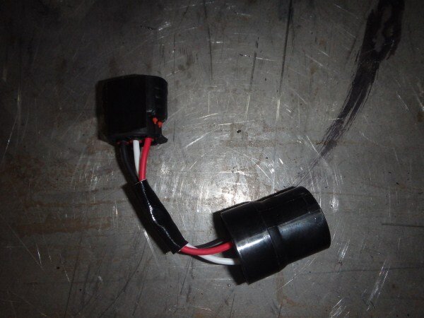

Interestingly it came with the right connector on it for the 1KZ-T loom.
And also with an adapter presumably for the 80 series loom.

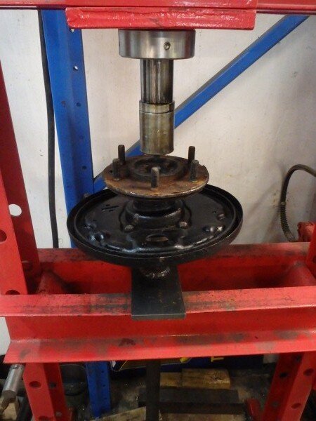

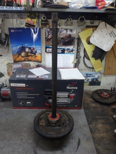

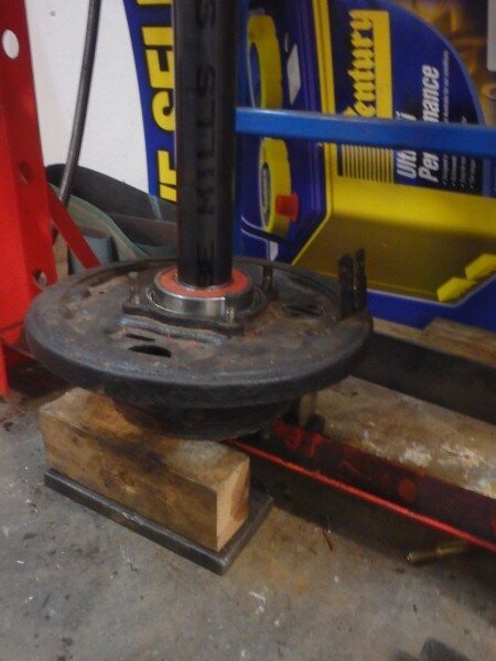

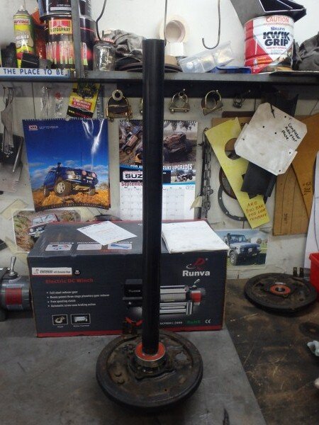

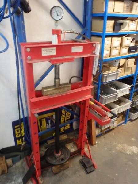

My next job was fitting the new wheel bearings into the freshly painted backing plates, ready to then press onto the half shafts.
They pushed in very easily on the press.

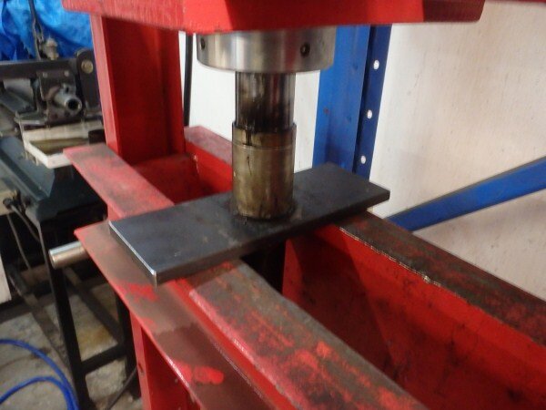

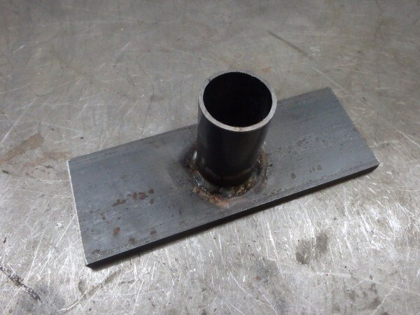

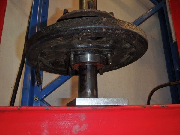

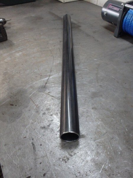

Next I cut a piece of 50mm pipe with the intention of using this on the press to press the bearings onto the half shafts.
Only because the machine wasnt tall enough/the half shaft was so long I couldnt get it to work as there was nothing to press off and pressing off the floor just lifted the machine up. :doh:

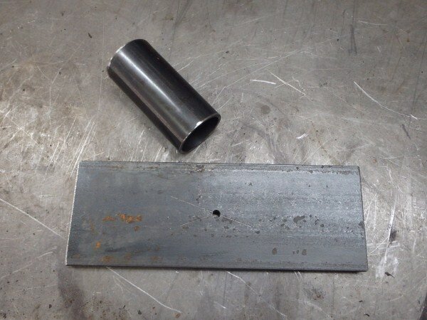

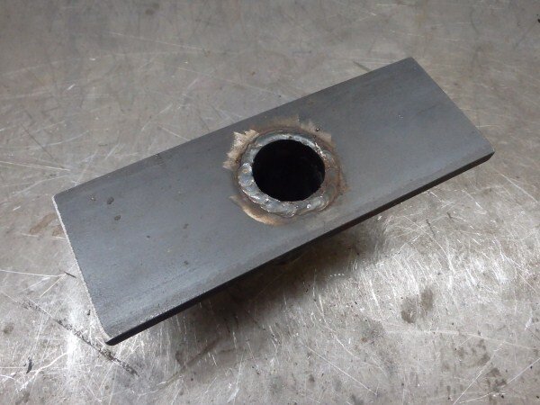

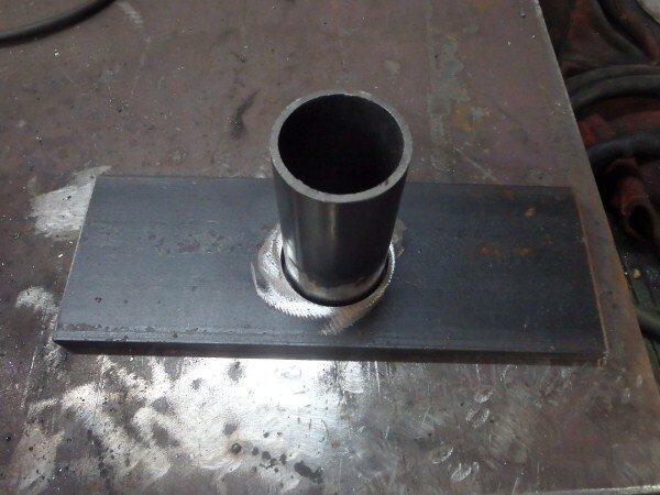

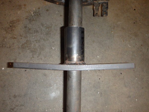

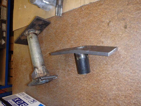

So I decided to get creative again!

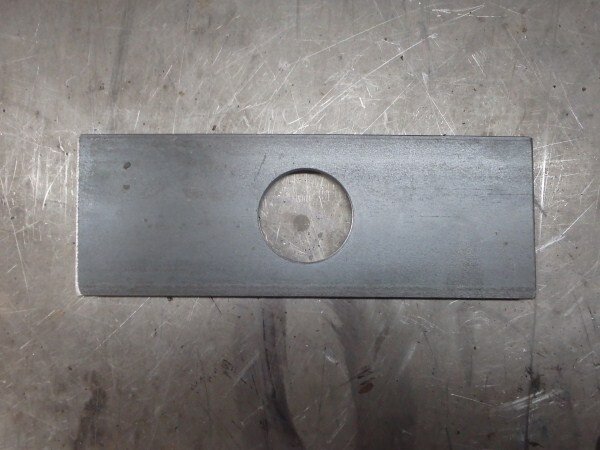

Cut some steel, more 50mm tube and some 10mm flat.
Drilled a 50mm hole in the 10mm plate using a hole saw and the drill press.
Positioned the tube.
And welded it.

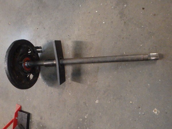

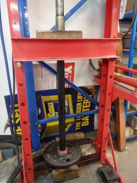

Now I could press the bearings and locking rings onto the half shafts.
Worked well but it did bend the 10mm plate. :|
Once the 2nd press tool has been straightened and strengthened I will get them electro plated and keep them for future wheel bearing changes.
I used the press to straighten my new press tool.

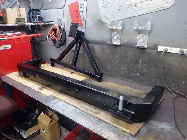

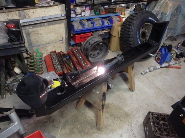

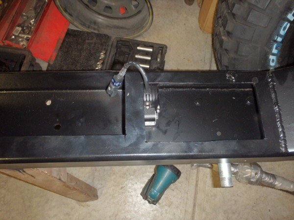

My rear bumper came back from shot blasting, electro plating and powder coating.

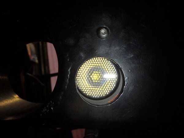

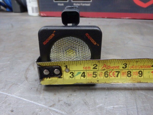

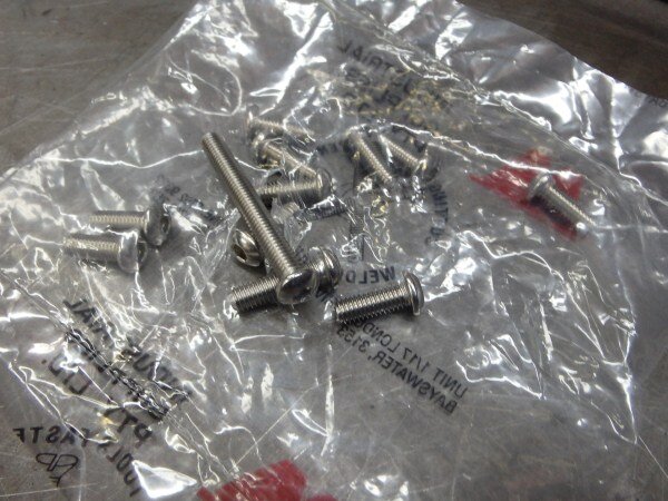

My next job was to mount the new super bright lights.
Using some stainless steel bolts I'd picked up.
I ran out of time at work so I brought it all home and carried on with it in my garage.
The passenger side one was really fiddly to get into to.
But the drivers side was much easier.
All done.

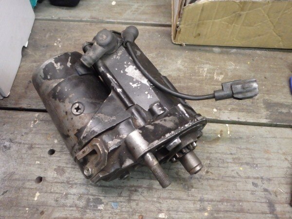

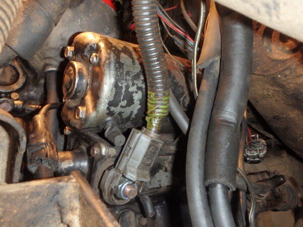

Starter motor next which had been freshly rebuilt by the auto electrician at work.

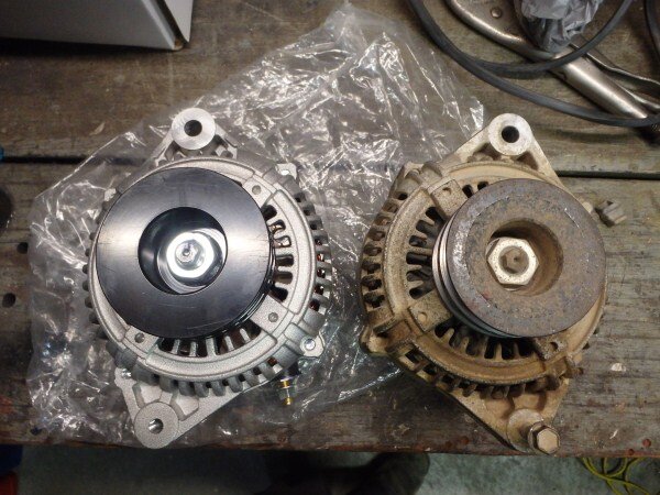

I had a proper look at the new alternator and compared it to my old 1KZ-T one.
It was then that I discovered that the casings were almost identical apart from the position of the threaded hole for the tensioner bracket.
So I had the idea of swapping the internals out of the new one into my old casing. But after speaking to the 2 auto electricians at work they both said it wasnt a good idea as certain parts inside are very tricky to get back in without breaking them on these alternators. I'd also loose my warranty on the new alternator. So it was decided it would be better for me to make a new tensioner bracket and make the 80 series one fit, more on that later.

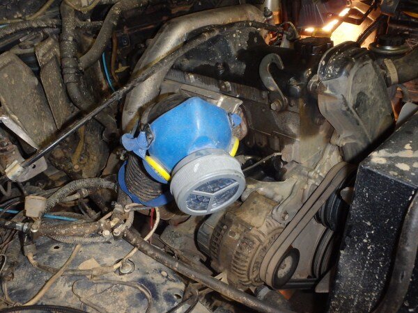

I then realised I'd left my airbox at work as I had been TIG welding up the 2 drain holes in the bottom. :doh:
I didnt want to drive without any filter and looking round the garage I spotted something that might do, a respirator.

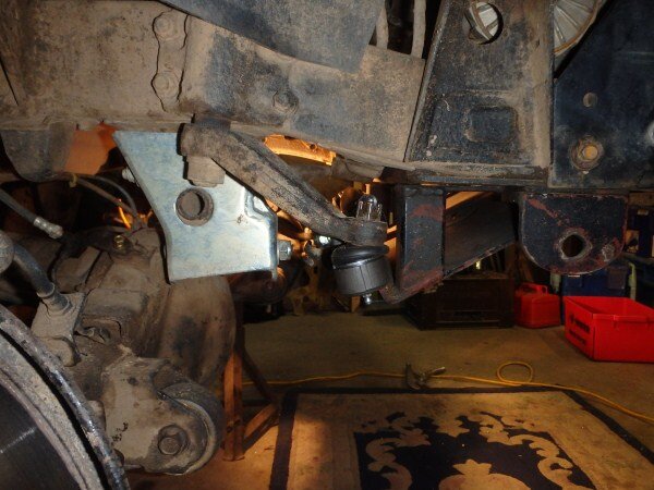

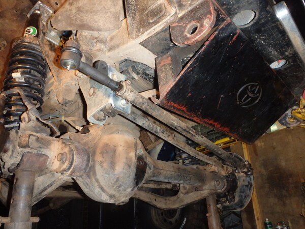

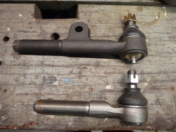

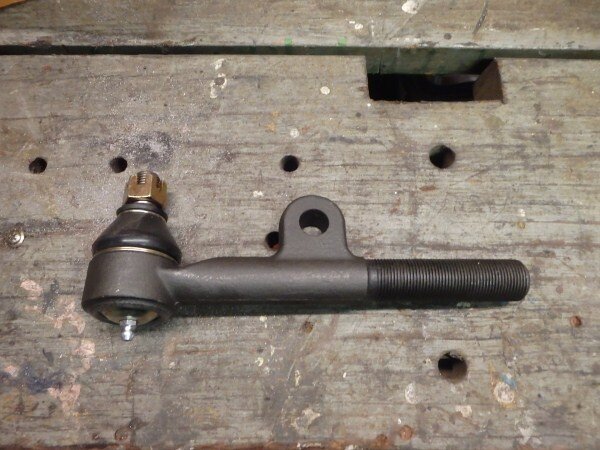

My next job was to try and fit an 80 series tie rod end onto my steering box to give me some where to mount the steering damper as I wanted to move it to in front of the axle like on the 80 series.
New tie rod end.
Comparing it to the new LJ70 one that I bought the thread looked the same size and direction.
(What I didnt notice at the time, but has just become glaringly obvious now looking at this pic is that I'm going to have much less adjustment on my steering bar as the thread doesnt go anywhere near as close to the steering box as the standard setup. :think:)
Fitted perfectly.

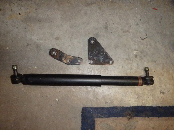

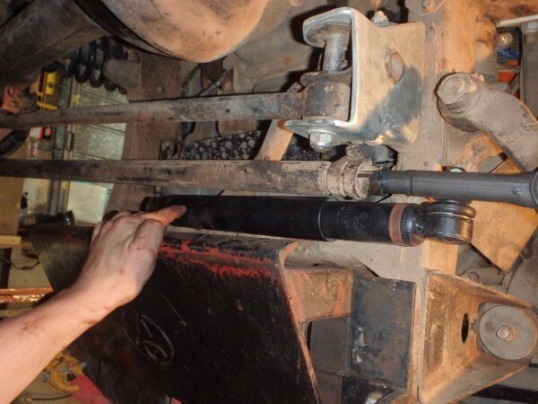

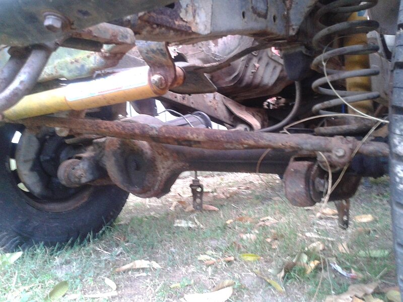

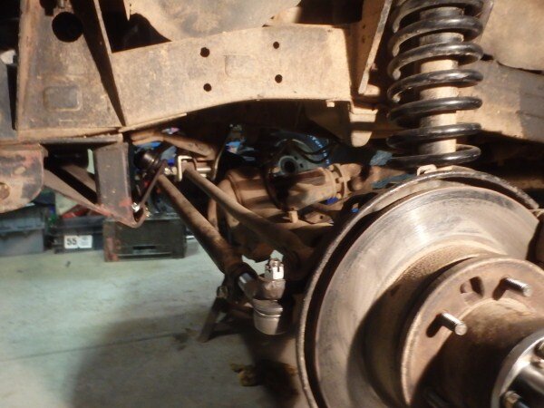

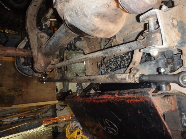

The next job was to mount a steering damper.
The bracket on the left is an LJ70 steering damper bracket that normally bolts to the axle and on the right an 80 series steering damper chassis mount.
I decided the 80 series one would work best so I worked out how to mount it and then did some experimenting to make sure where I positioned it would give me full steering in both directions.
Drilled and bolted in position.

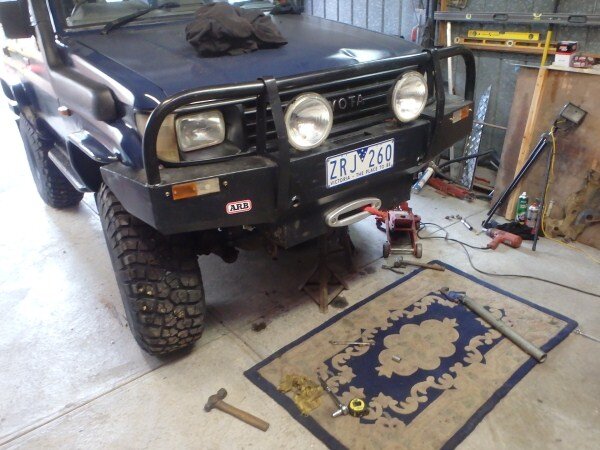

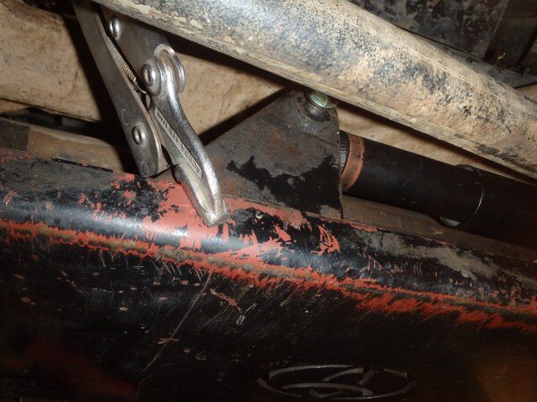

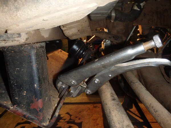

Pulled LJ out of the garage, went to reverse onto the front lawn to turn around and bugger cant turn right! :doh:
I must have left the front steering bar too long. :oops:
So after a quick phone call to the boss to say I'd be late is was back in the garage to start adjusting things.
I couldnt just turn the center of the steering bar with some stilsons as it was winding one tie rod end in and one out meaning the bar wasnt getting any shorter. :doh:
So had to take a wheel off, split one of the ball joints and then turn the steering bar with some stilsons and a piece of scaffold tube. :icon-rolleyes:

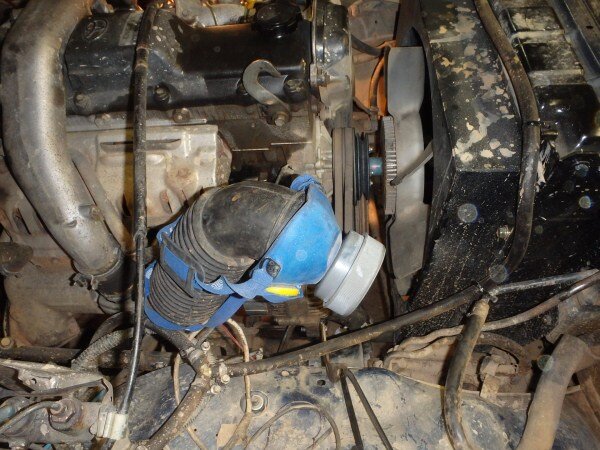

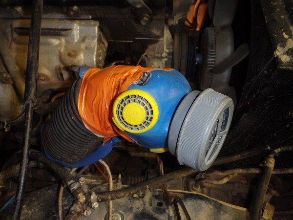

Pulled out onto the street and as I started trying to get up to speed it became apparant I had no power at all, a quick look in the mirror revealed clouds of black smoke! :thumbdown:

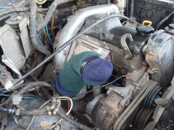

I pulled over and as I suspected the respirator air filter was restricting the engine far too much, so I needed something else........................
Now it just so happened that in my busy schedule I'd found time to sort out my sock drawer. :oops:
So what to do with all the odd socks whos twins had long since been gobbled by the washing machine or stolen from the washing line or wherever socks seem to vanish to. :lol:
The obvious choice was to use them all as rags in the garage and I just happened to have a few in LJ for that very purpose.
Bush mechanics in the middle of the city! :icon-cool:

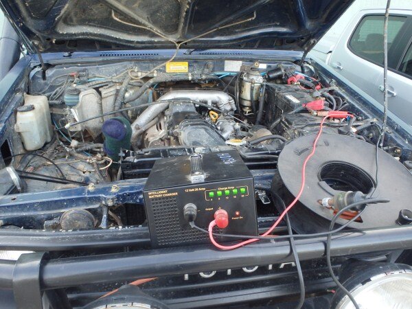

I got to work 30 mins late and put LJ on charge as having no alternator connected had obviously drained the batteries a bit.

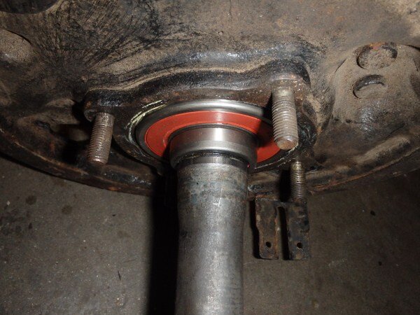

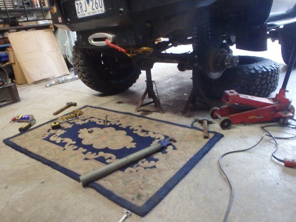

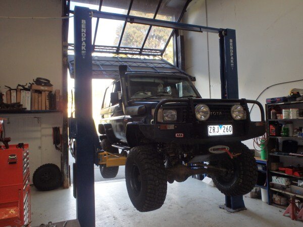

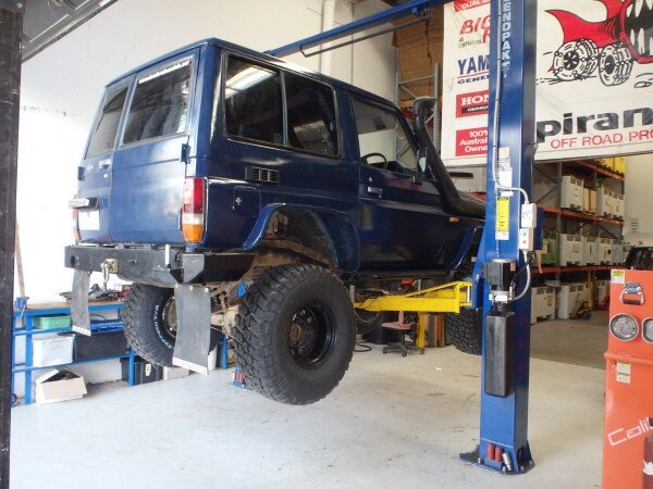

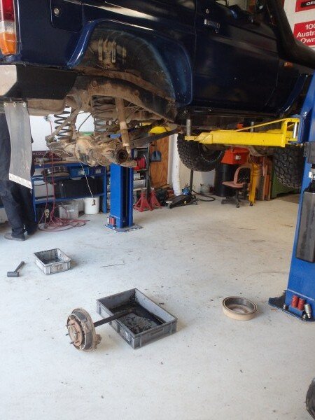

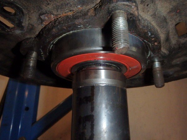

After work I got LJ on the hoist.

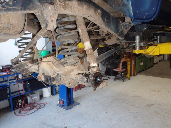

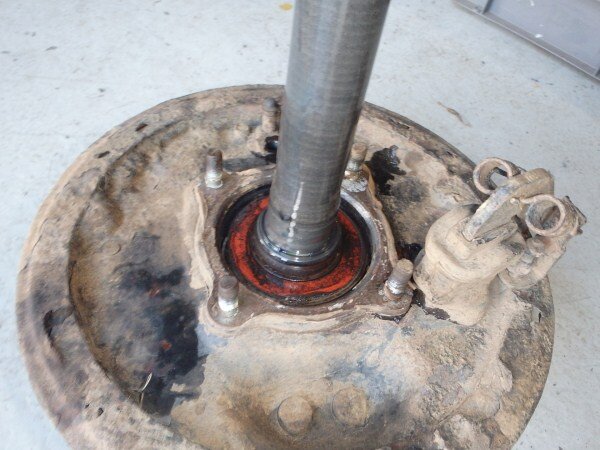

Half shafts out.
New seals as I dont trust the ones in the bearing kits.
Passenger side seal had clearly let go at some point since they were last changed a couple of years ago.
Comparing the genuine seals with the non genuine and they were definitely different and looked like the milner ones that failed on me prematurely, everytime I fitted them.

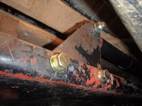

Found some bad rust on one of the bottom shock mounts. :thumbdown:
Hopefully it will survive the trip as no time to fix it before. :pray:
This does some what make it harder for me to order new shocks as ultimately I will cut those mounts off completely and make my own and change from a pin to eye mount. :think:

The mechanic who was helping me discovered one of my wheel cylinders was seized so I shot out and picked up 2 new ones.
He also discovered 2 of my shoes were on the wrong sides, this is how they are meant to be fitted:
Its all to do with leading edges and is biased towards forward travel braking.
We bled the brakes and adjusted the handbrake.

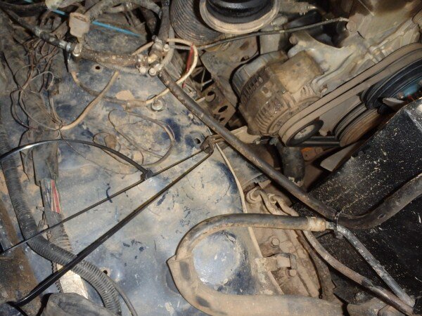

Ok...........enough messing around I was running out of time and still had the new alternator to fit and bracket to make.

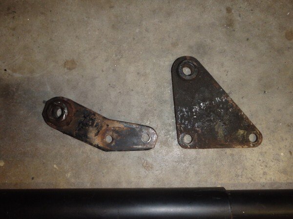

I had a selection of tensioner brackets to choose from.
On the left an 80 series one, then my old 1KZ-T one then a bare steel laser cut one out of 6mm steel.
I decided to use the bare steel one as it was twice the thickness of the others and I liked the idea of not butchering my old one so I could always refit a 1KZ-T alternator in the future if I ever wish.
I cut the bent end off.
Cut a piece of 25mm x 6mm flat and clamped it firmly in place ready to weld onto the bracket.
To ensure maximum root penetration (strength) I prepared the weld joint in a double V configuration.
Welded together and hole drilled in the other end.
I notched a bit out to provide more clearance around the bottom rad hose and welded the bent piece I cut off onto the other end.
And bolted it on.
With that working so well I could finally fit the new alternator.

Good work Ben
Love the sock air filter :)
Are you fitting new drive belt to alternator
