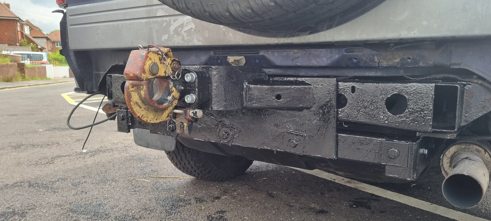

21 August 2021 Timing belt, water pump, radiator coolant Würtenberg, 3 belts, e
xhaust rubber hangers, rust treatment and underbody soaked with 50% diesel & 50% motor oil
