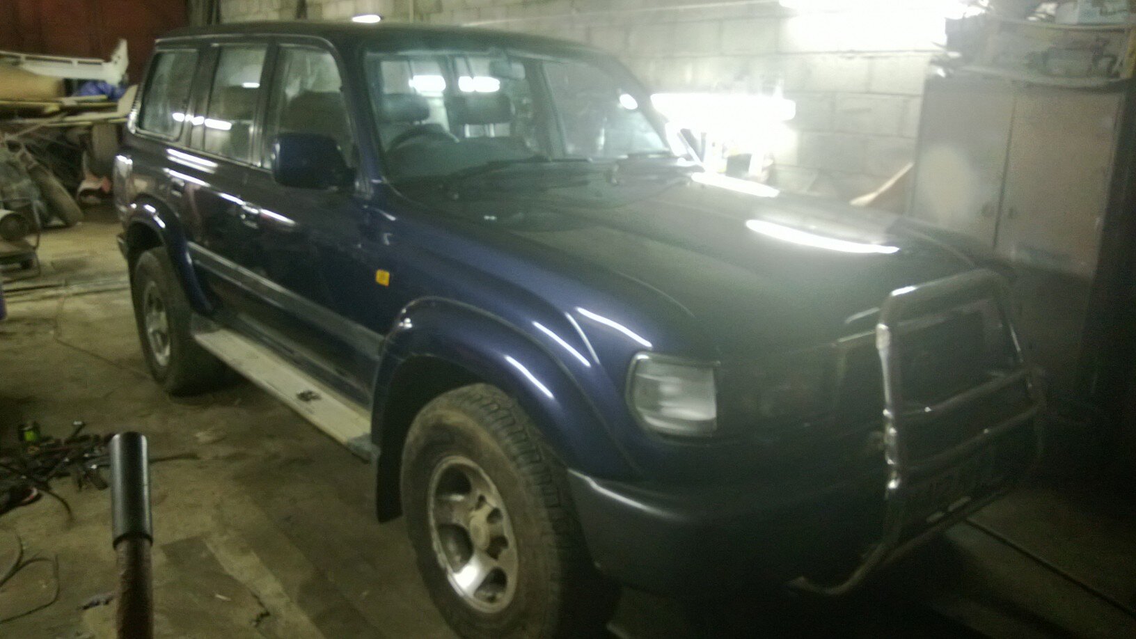

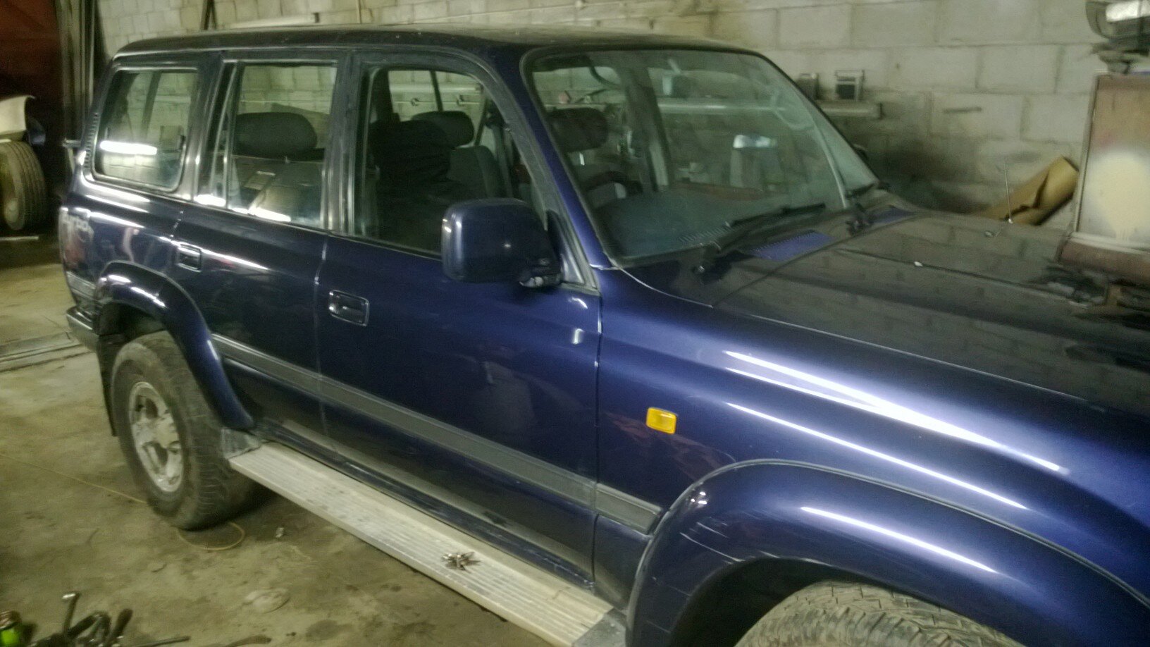

My 'bargain' 24v

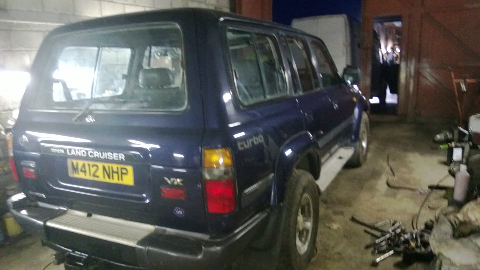

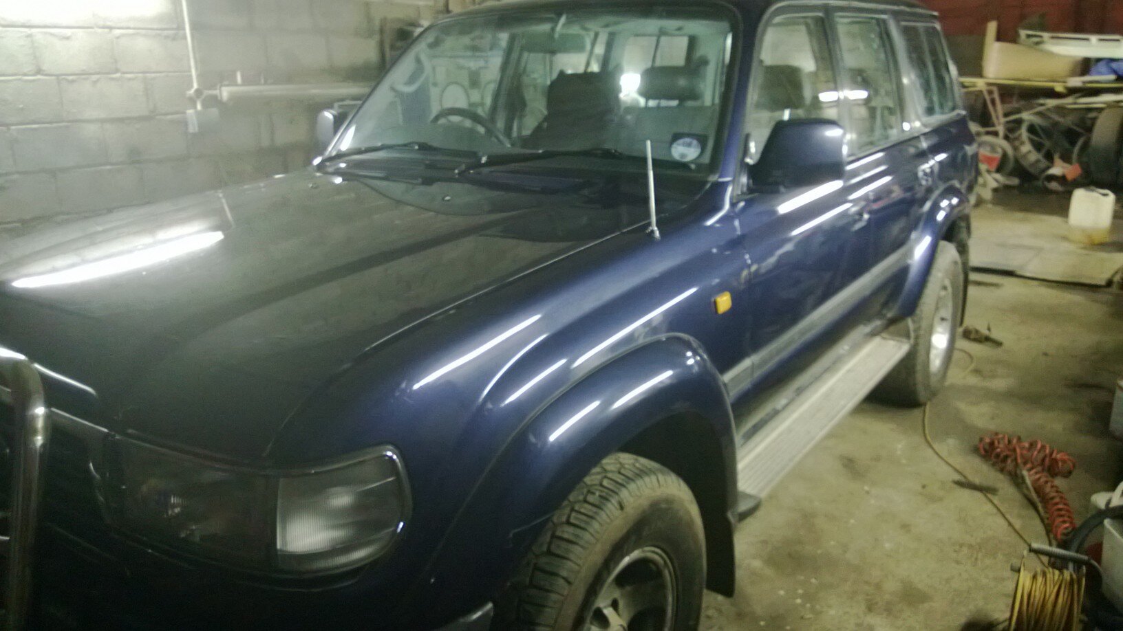

Looks good! :icon-biggrin:
I really like that colour blue. :clap:

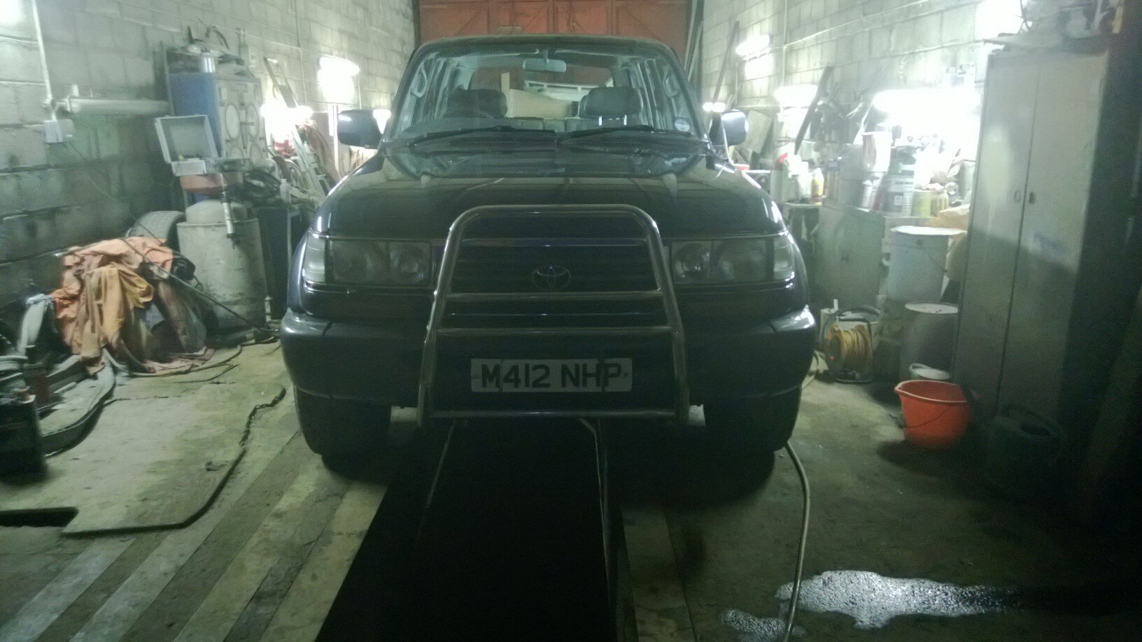

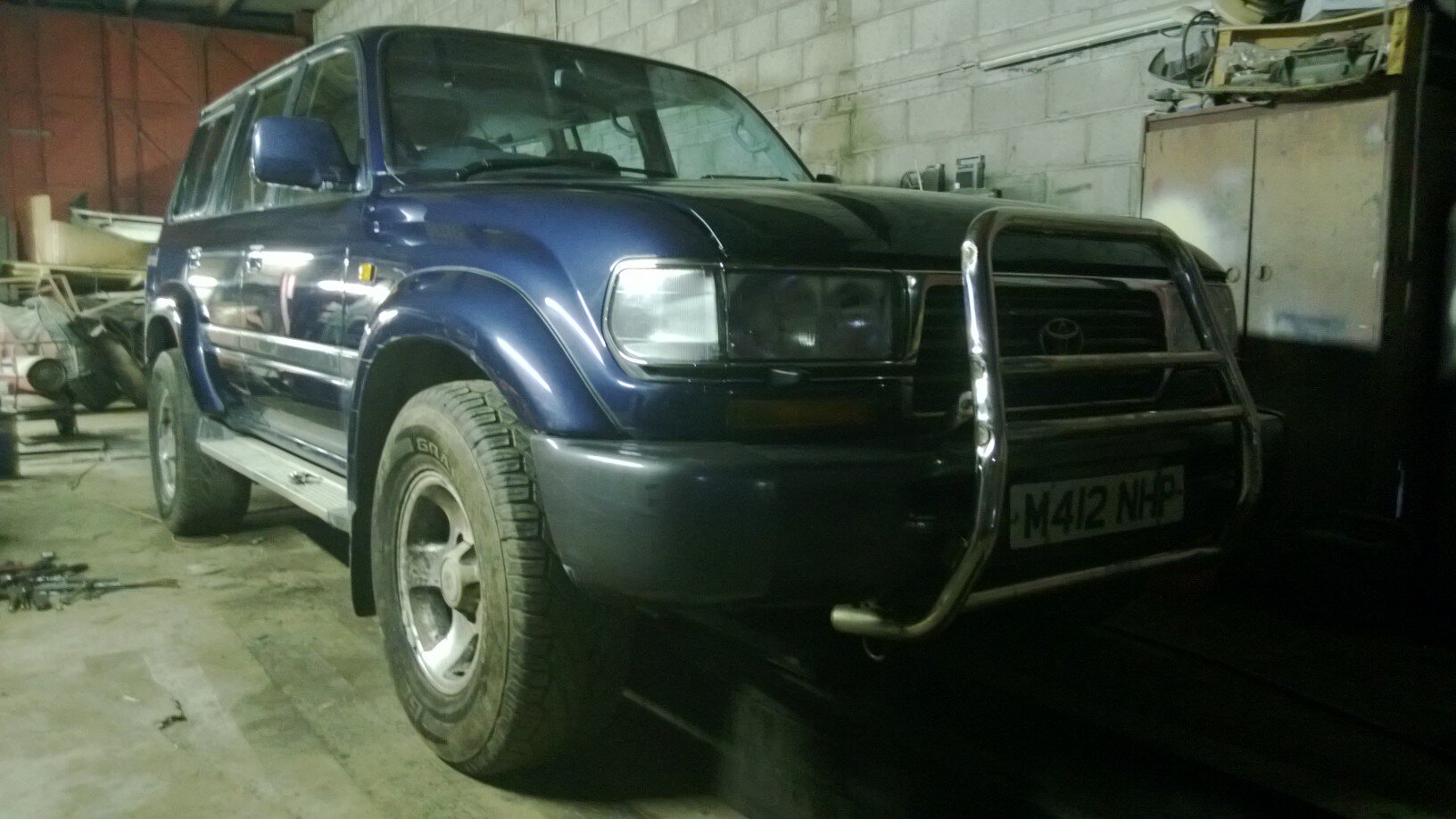

That brake disc looks pretty scored grooved?
Do you plan on getting the bodywork sorted out?

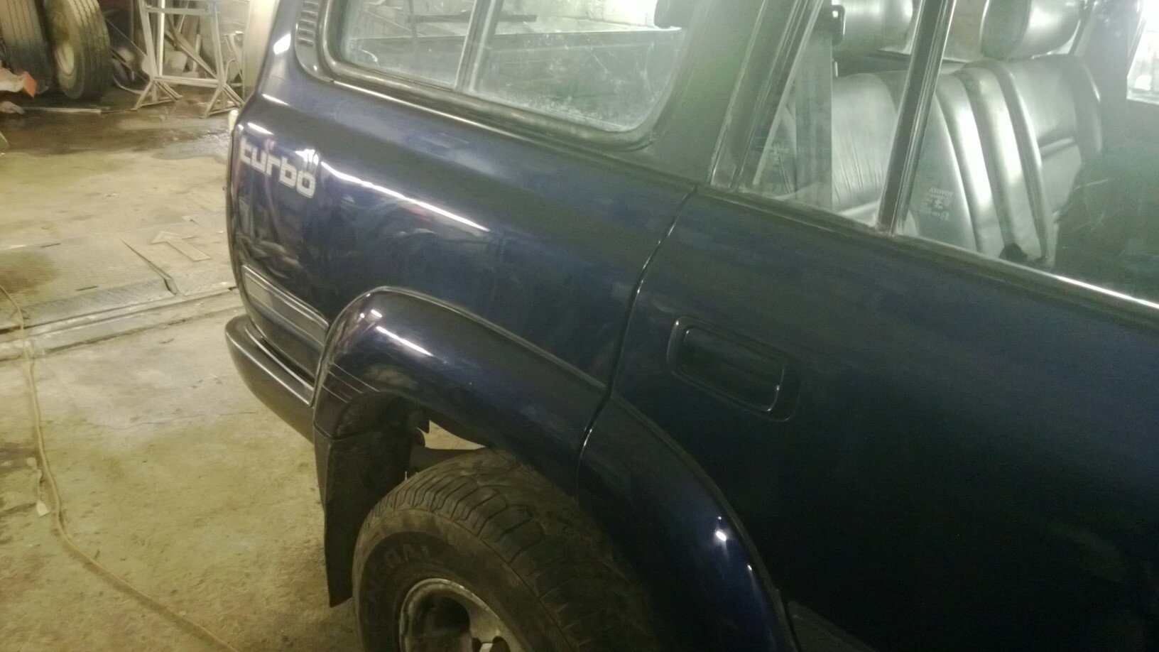

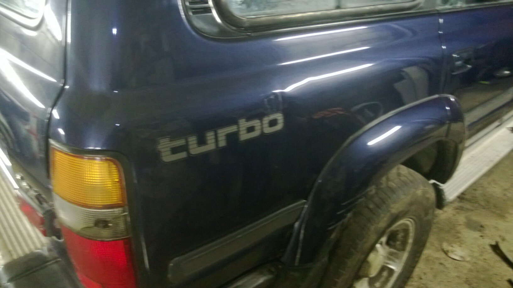

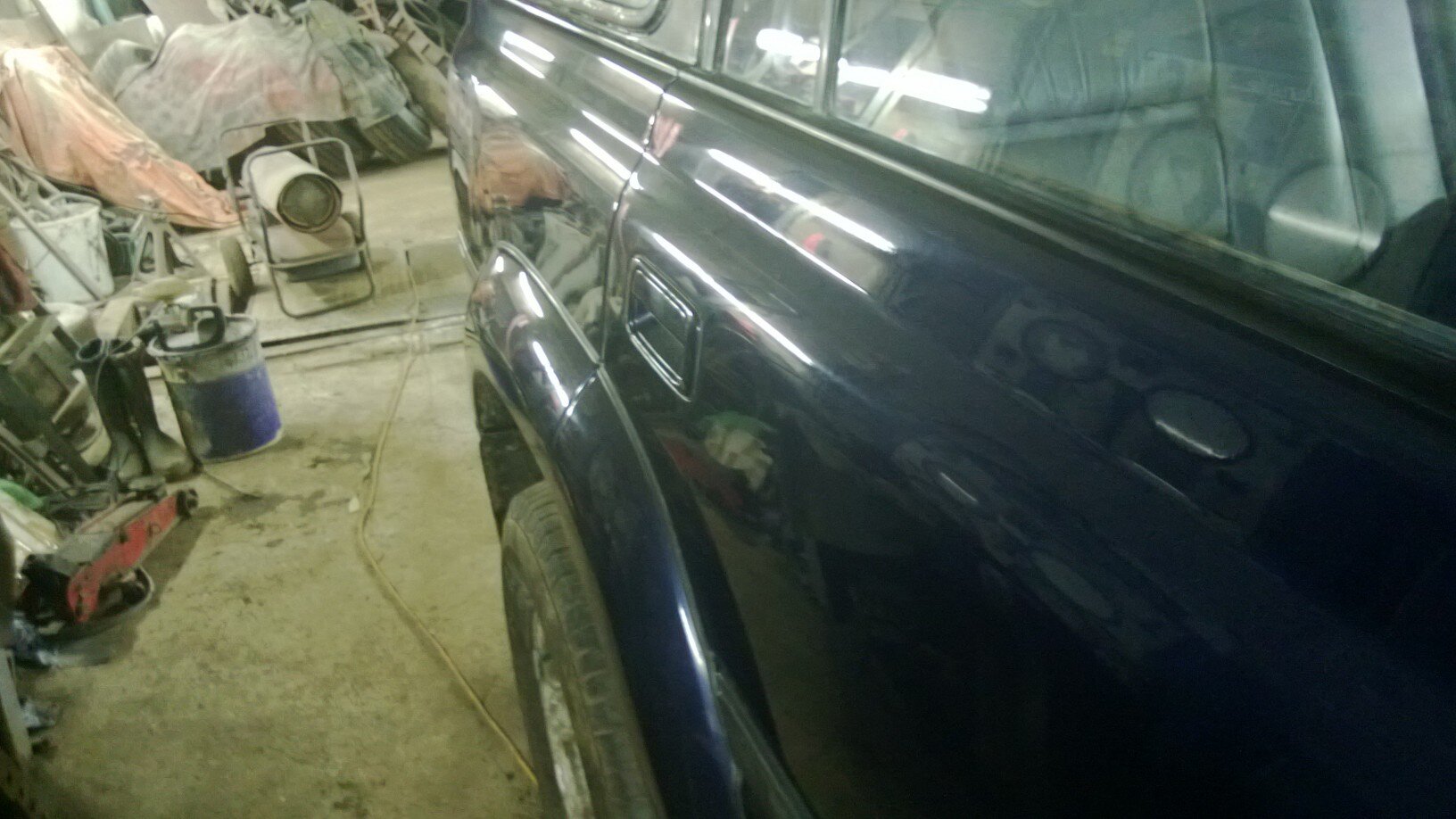

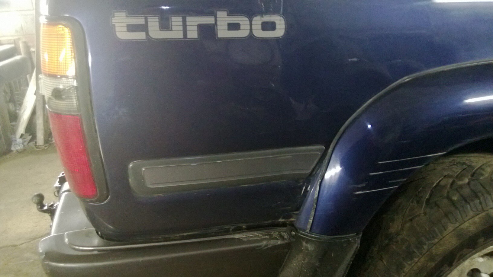

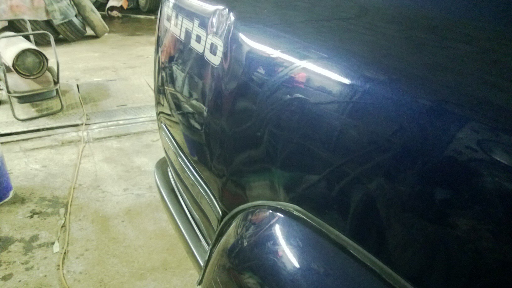

Looks just like the dent on the rear quarter and the bonnet rust? :think:
Will you be keeping it standard?

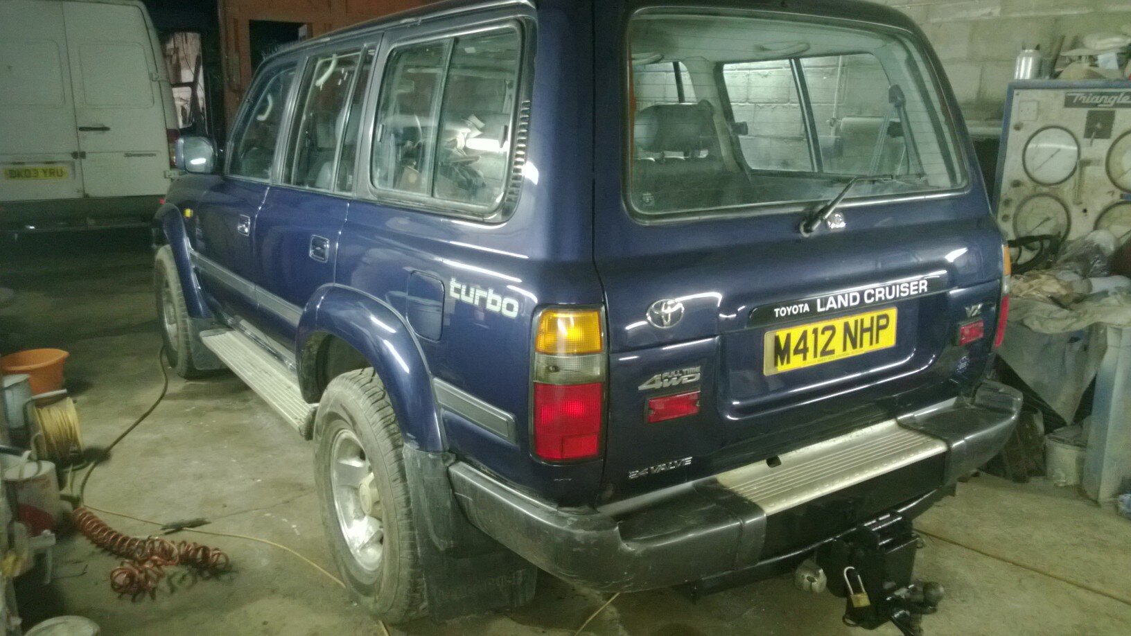

From the photos is looks alright :clap:
The tailgate looks good worth taking the plasic cover off the inside and having a look up inside it and if no rust or rot spray a load of wax oil type stuff around in there.
Rust on the bonnet would prob be easier keeping your eye out and swapping for on same colour. The dint on the rear quarter could pop back out fairly well.
Still a thumbs up from me :clap:
I am impressed,I'm used to LR's and one of them of comparative age and mileage would probably be in a hell of a state.
It has marked the n/s/f disc up,due to the sticky brake,which is a shame but I think once I've changed hoses and another set of pads it'll probably survive for the time being.
Wasn't going to bother doing the bodywork but the rest of it is so nice I think I'm gonna have too!
Those two bits do certainly spoil the overall picture of the truck. Will get it washed off today,so that it looks a little more presentable.
There's plenty of other work to be doing before I get to bodywork

looks like a bargain to me- I wonder if the quarter could be pulled by dent master- it doesn't look kinked. give it a good g3 all over and see how it looks. I bought mine with holes in the upper rear tailgate and driven it for over a year like that despite having a replacement (via Karl webster) lying in the front room! get your fun out of it and then worry about jobs later. At the end of the day its a bloody landcruiser so you only need fuel and it will go! p.s you can get aerosol paint made to match at halfords and ideal for touch ups until you get time to do a proper job. good luck with it.
Underside looks cleaner than what i have seen before. Well done looks like you got yourself a bargain

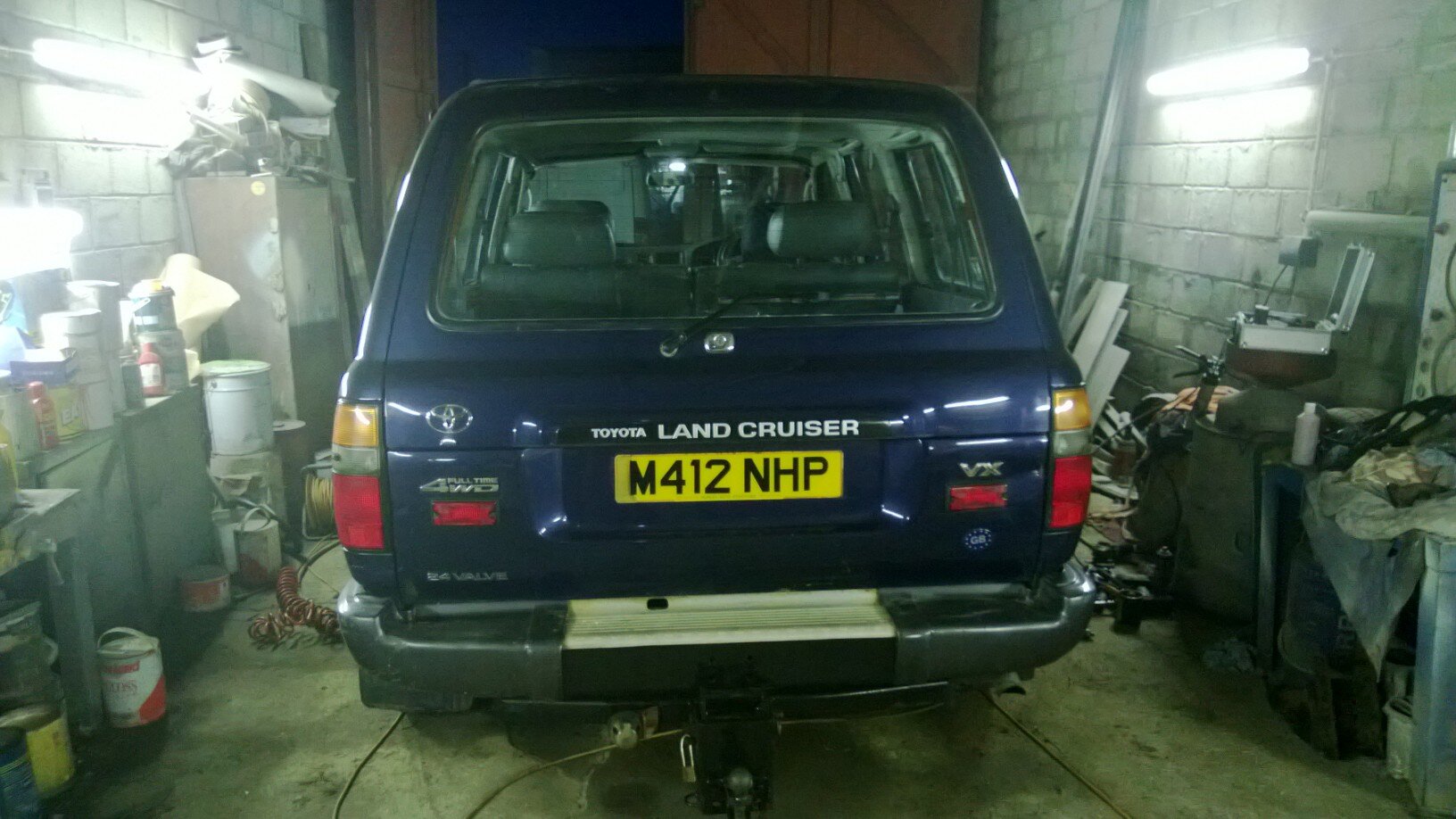

Knocked out the dent in the rear quarter this today,its not perfect,has left a litttle crease. Theres also a scratch from where the damage occured in the first place but it's a lot better and near enough for the time being.

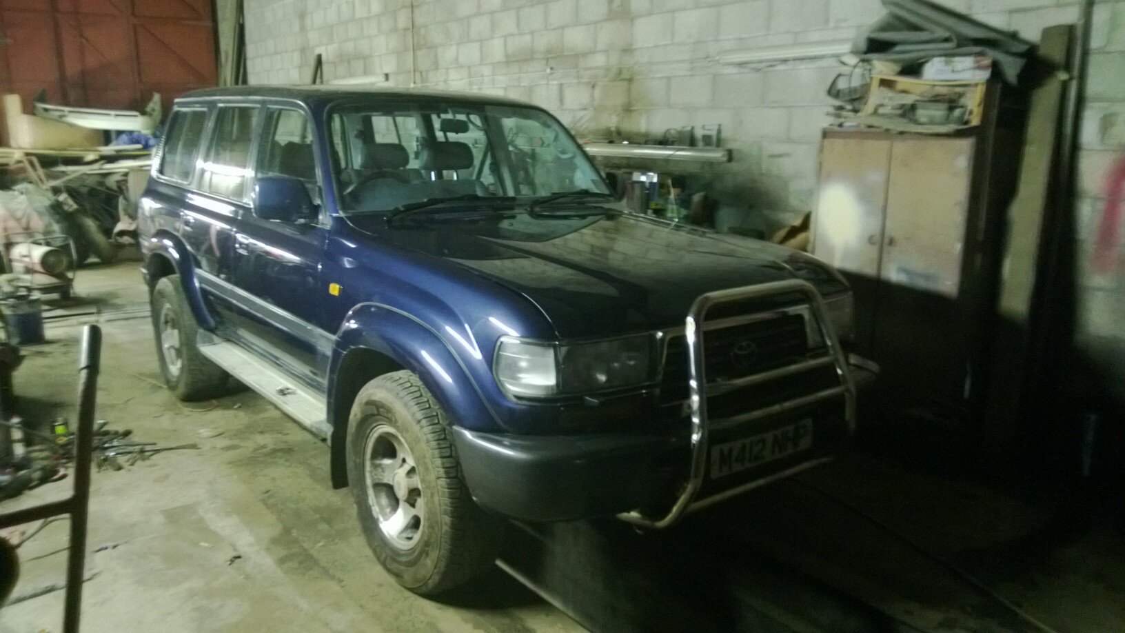

Also chopped the sides off of the bullbar to make an A bar,looks a lot better for it.
Struggling to upload pics for soome reason,will have another go tomorrow!
Yesterdays pics, ran around it quickly with the mop too!

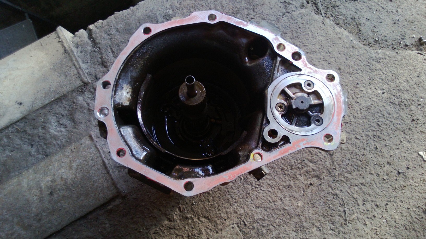

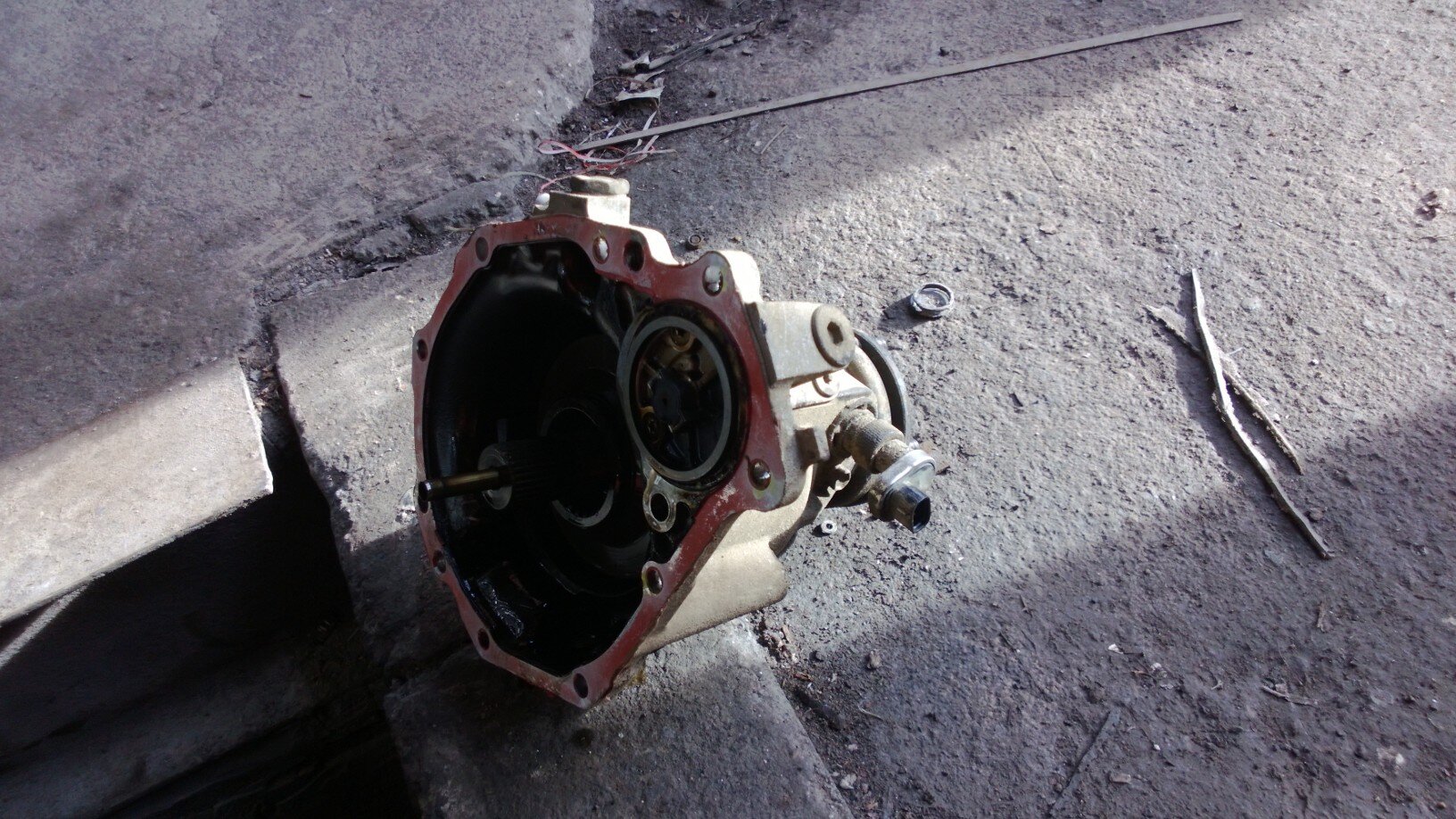

Today I removed rear end of transfer box and wipped the viscous coupling out-
Also had a look at the rear locker today,Magnets had come off inside the motor,stuck them back on and put it back together but it still doesnt work. There doesnt seem to be any power getting back there.There is a power and earth on the 'locked' switch. Ive done a search and found something about making sure the magnets are in the right order? TBH I didnt pay alot of attention,is there a special way to tell them apart??:doh:
The VC's can still be got brand new but not cheap so second hand is your best bet.
