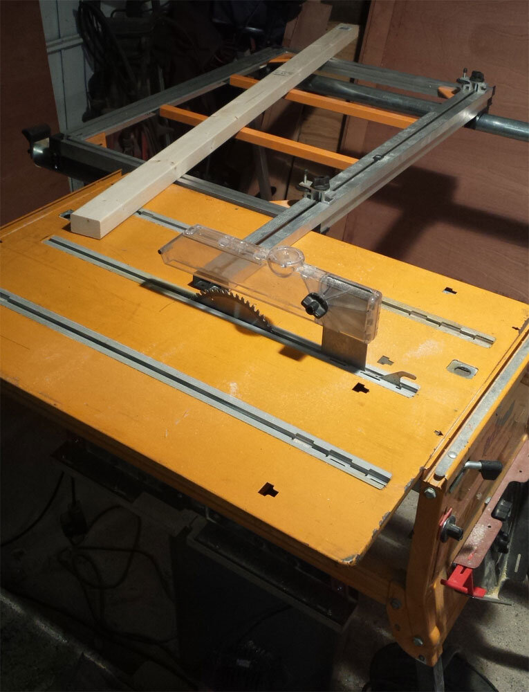

this is our titan multi purpose work bench. great bit of kit would recommend any time.
im using 10x5ft marine ply on the sides, we put the two sheets together with clamps then cut to the required size

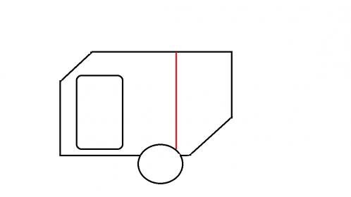

Untitled.jpgwe are looking at this design
1.5 high x 2.550

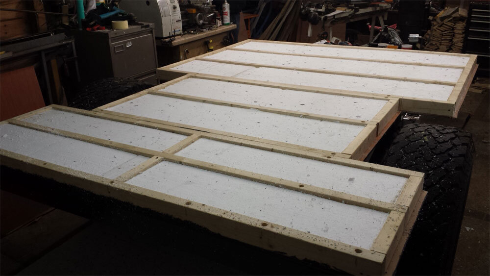

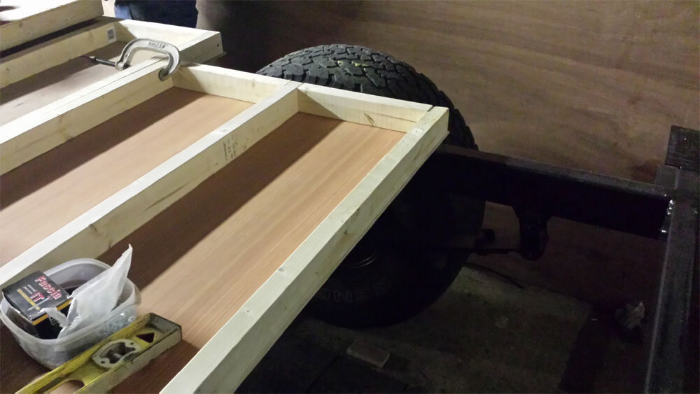

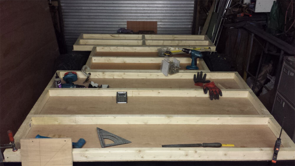

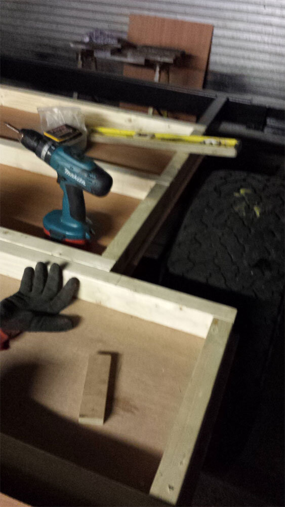

we start with the base, im guilty of missing some pics here, the frame is made using 65mm x 40mm sitting on a 6mm ply sheet which is painted with a dunlop rubber coating, its for roofing and a good product, just dont ask me what its called the whole thing is glued to the frame and screwed, after drying its then turned upside down and fitted to the chassie using tech screws
when we built the chassie it was 5mm out of square just cant get there with wood,
20131213_223105.jpg insulated with 50mm poly its all i could get hold off, the timber cost me enough

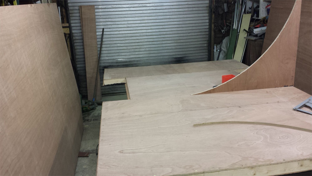

we then fix a 12mm maring ply over the area, there is a small lip of 18mm on the outside to carry the sides, makes the seal a bit easier. the square we have is from an old build

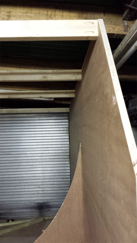

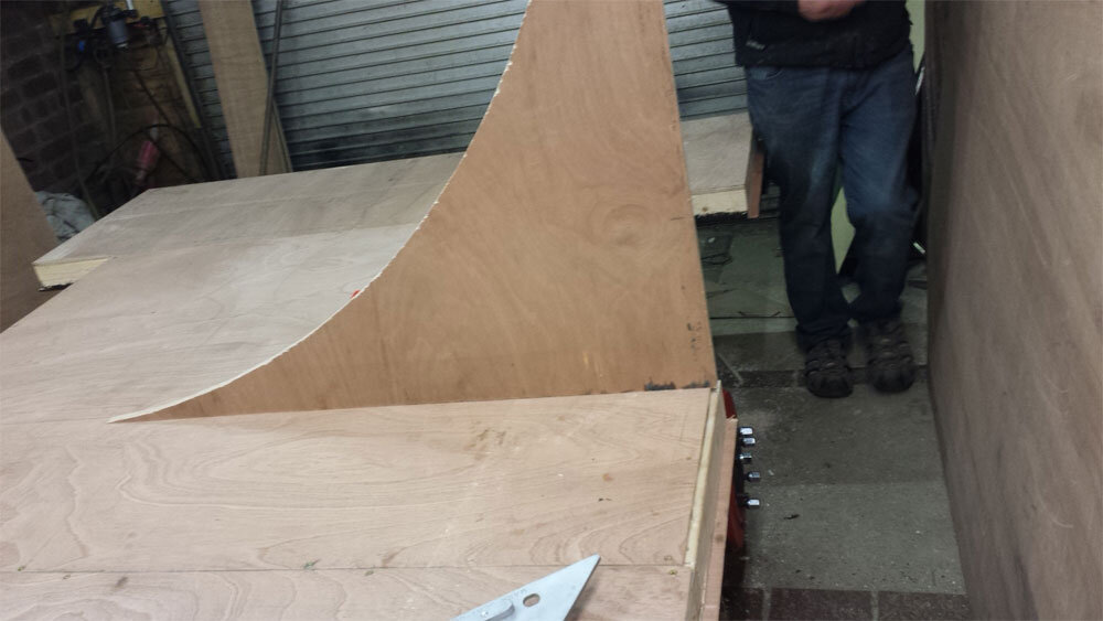

just let me explain this picture, to fit this sheet which is 1.5 high, in the garage, we had to remove the wheels, and sit it on house bricks, its tall and this scares me.

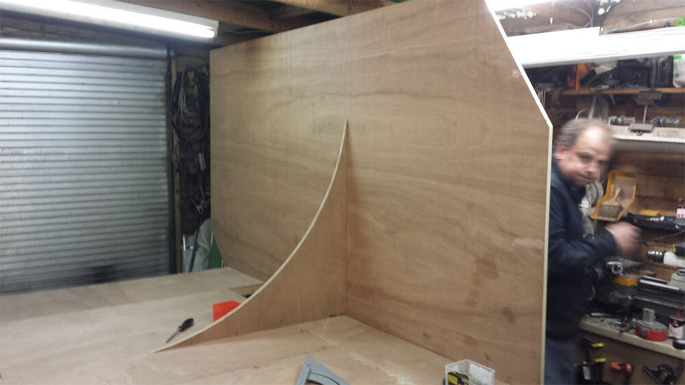

this is paul he likes to make the odd appearance

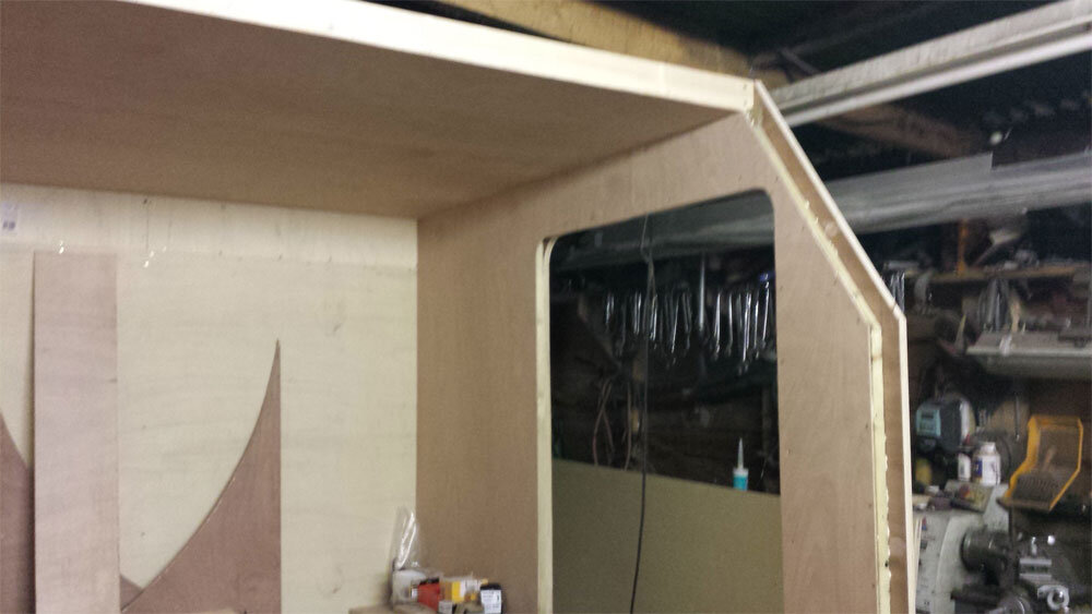

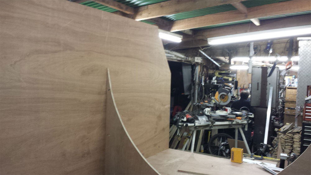

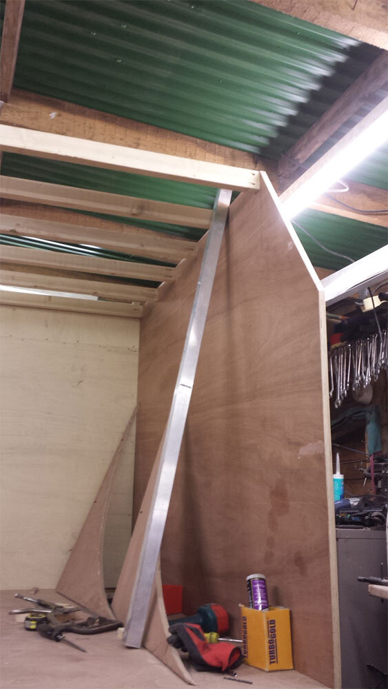

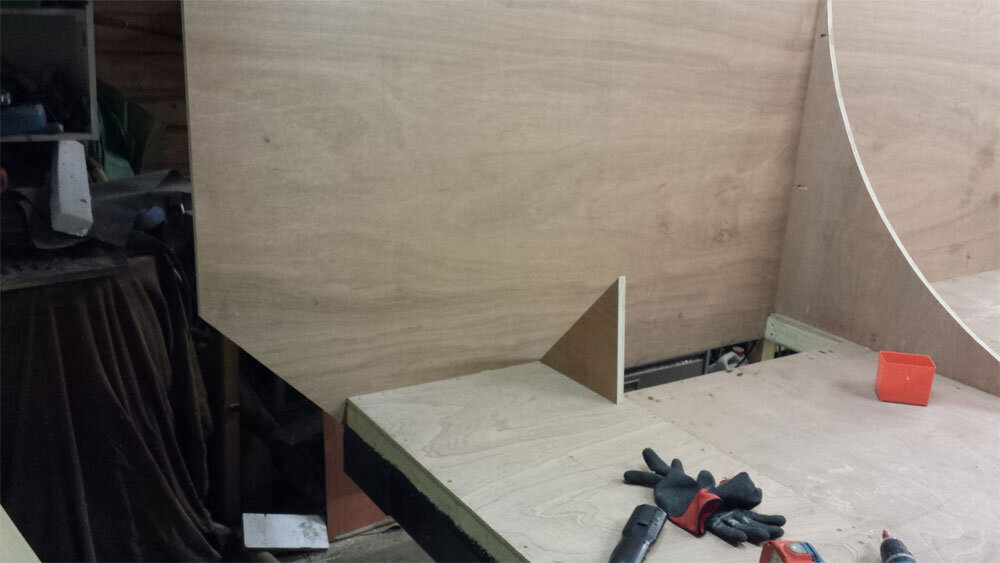

its massive, paul says its because of the surroundings, the front angle is for a small window or windows, still trying to find some at a reasonable price, thought i would pick up some old caravan windows but the prices are stupid
this shows the rear departure angle, well thats the intention, im trying to develope a step that rolls over from the floor point

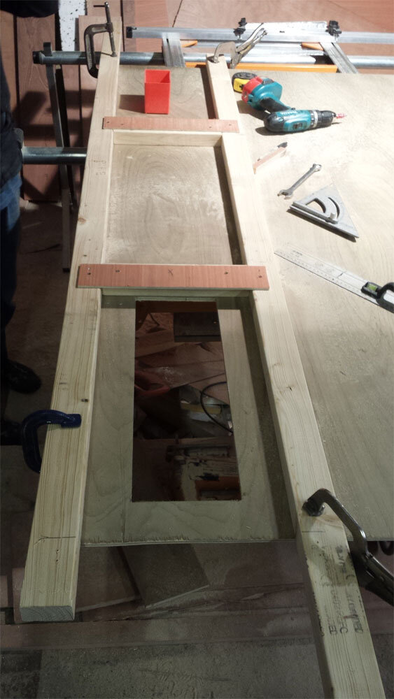

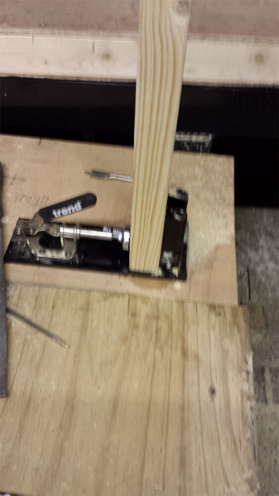

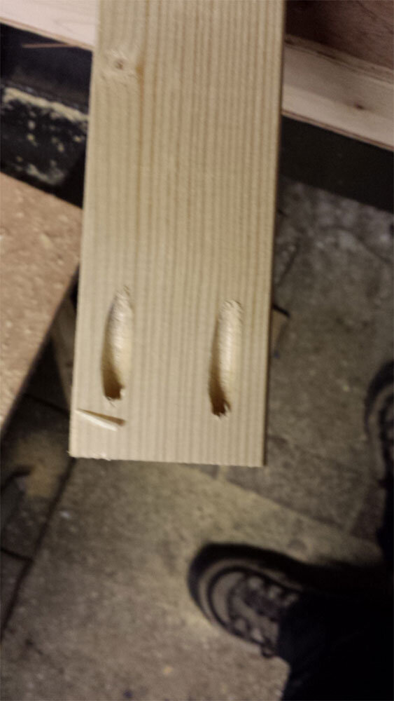

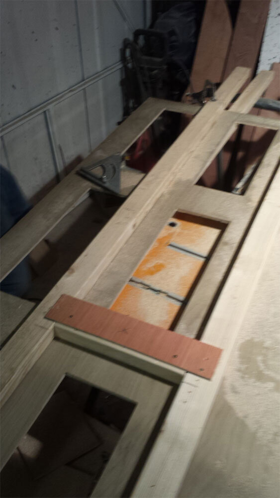

this is a pocket hole jig, never used one before and im impressed. we drilled two holes in one side and one on the other and again on the opposite end glued the two faces and screwed them in at 300mm centers, all the roof timbers were cut in a jig we set up

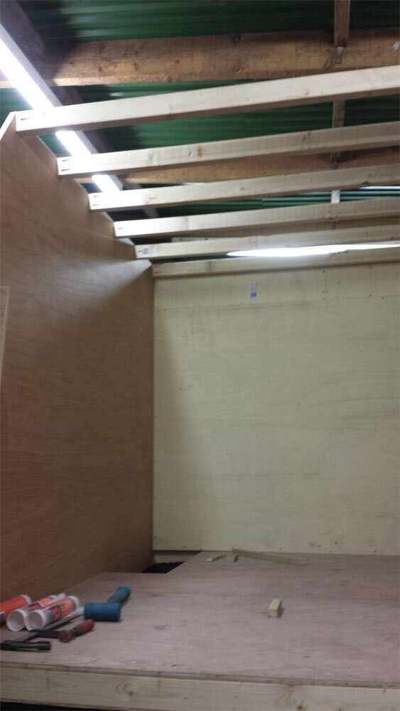

at this stage we fitted the bulk head, this comprised of a 12mm ply and insulation sandwich, i missed the pics of this part
the reason the timbers are 300 apart in the roof is, i want to fit my roof top tent up there the odd time , we take the grand kids away more often now,

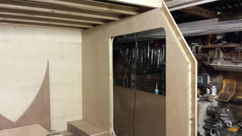

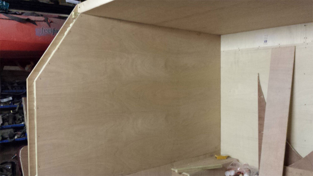

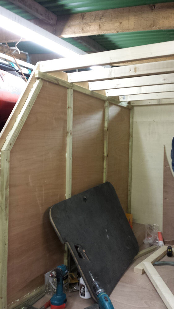

we have started to line the interior, using a 1 1/2 x 1" lathes these are not structual in any form but we took advantage of the placement we used 25mm celotex insulation, and finished using 4mm external ply, these are all glued and screwed , all the wiring is fitted into the roof space so no bother at the moment

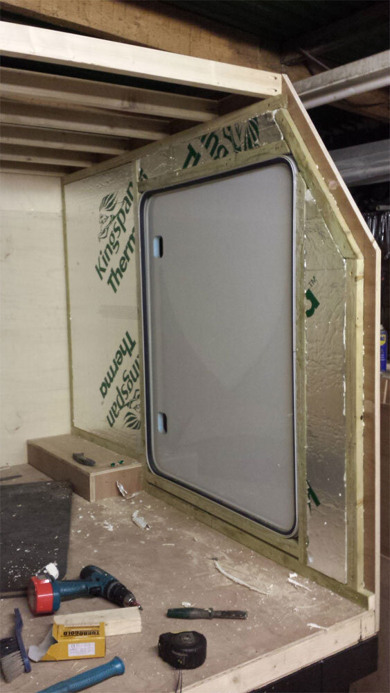

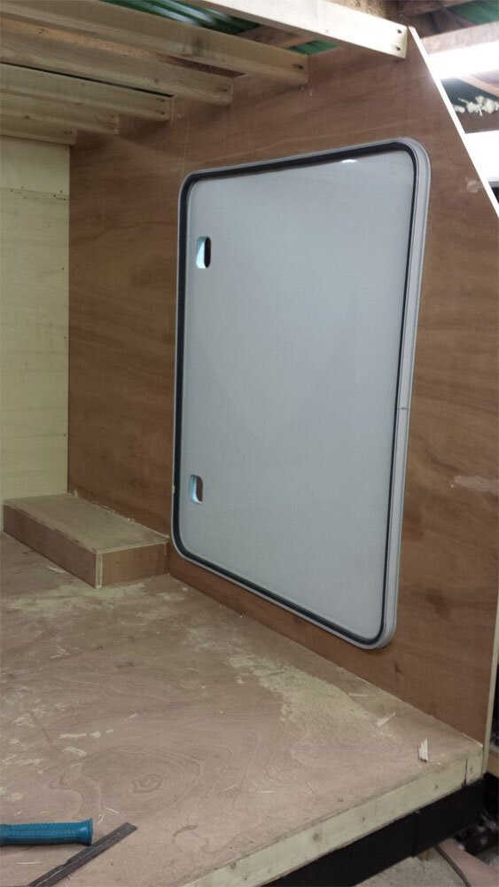

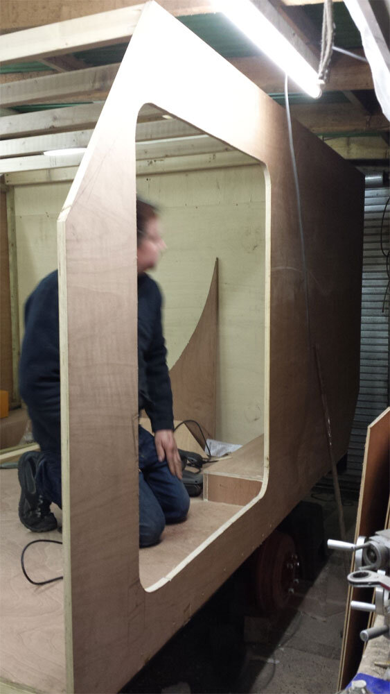

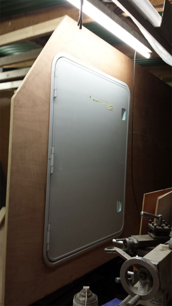

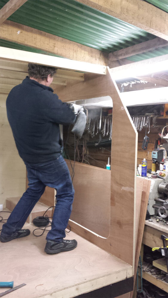

at this point we were ready to cut out the opening for the door this is a new motor home locker door, very very expensive, which i got very very cheap it might be on the large side but will do me nicely i was fitting two doors at one stage but you lose a lot of wall space, which im planning to use for storage and other hide aways

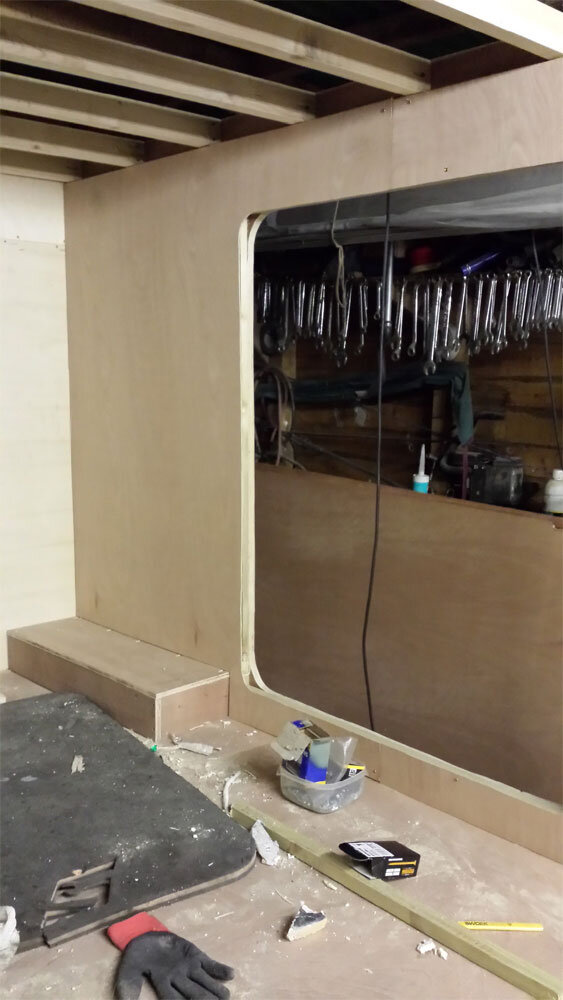

i lifted the door about 75mm off the floor to allow for my bed , we offered the door and frame to the inside sitting on the 75mm spacer then drew around tight , then we removed and drilled 4 8mm holes, slid in 4 8mm bolts, then sat the door and frame on the outside sitting on the bolts, might seem a long way round to do things, but it worked perfectly, then we simply cut out with a jig saw
great fit, im pleased with it, i couldnt have got hold of a better door there is just enough for the interior ply to sit flush with the frame , might even get hold of some t strip to finish,

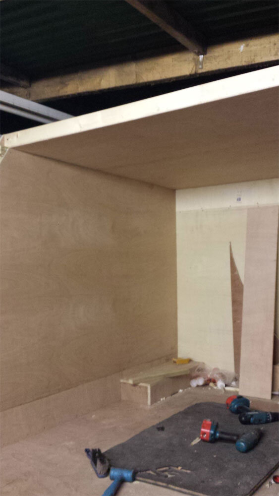

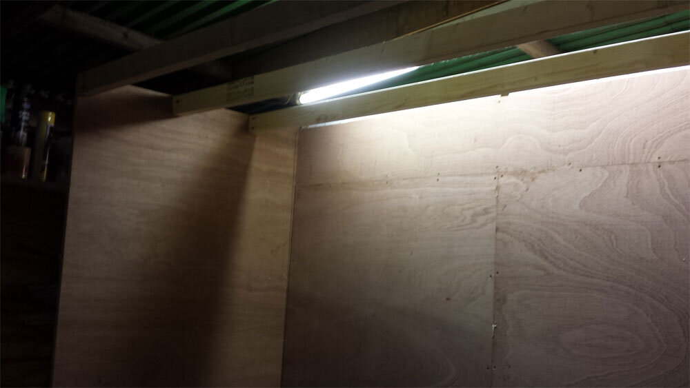

well im back, but after a night playing cards with the kids im worse for wear, i managed to get a couple of hours in yesterday afternoon.
internals lined, just got to fit false wall to the left for the storage/shelves, internal lights, and another visit to timber yard,
thats the trouble with design, build, then design again
still, looking foward to turning it around, going to try a dry fit on the truck, see what sought of adjustments we need to level the thing up

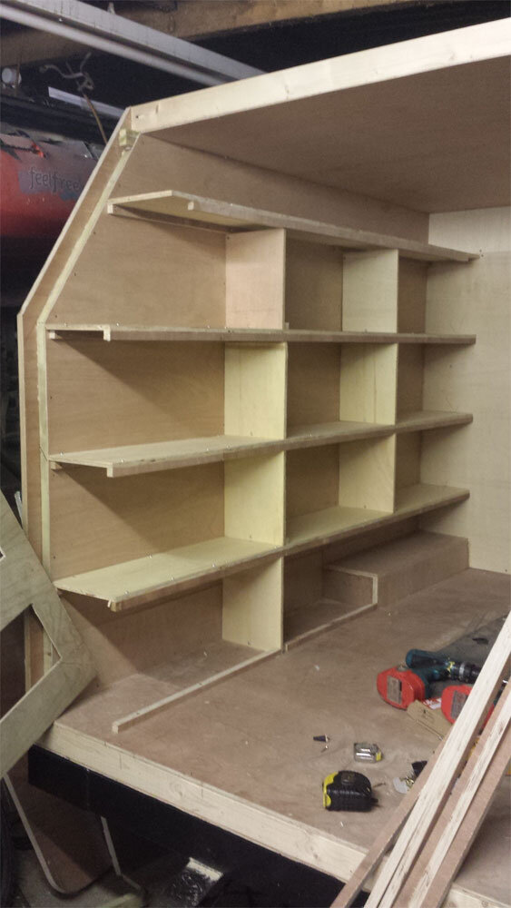

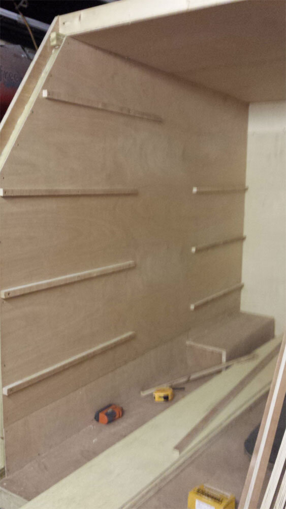

right, started on the false wall last night with the storage
we used a 9mm ply wall and the shelves are 12mm sitting on 18mm x 20mm ply rips glued and screwed.
first of all, set out the shelves, then transfer measurements over to false wall and cut out the holes with a jig and router
as you can see i have 3 pockets on each shelve, im not going to do any thing fancy with regards closure, im using some ballistic nylon fabric i have left over from tent build, we just bought an old German made commercial sewing machine im fixing the top with a small trim and using Velcro for the lower flap sought off rip up or down to open affair.
