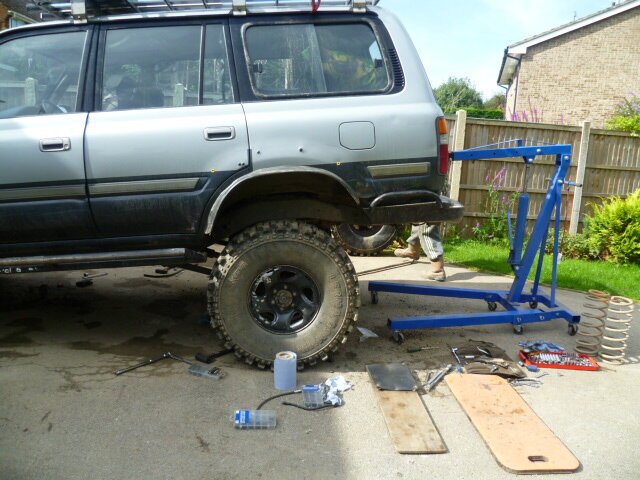

Started off looking like this
[attachment=4:stzt6bpm]P1010037.JPG[/attachment:stzt6bpm]

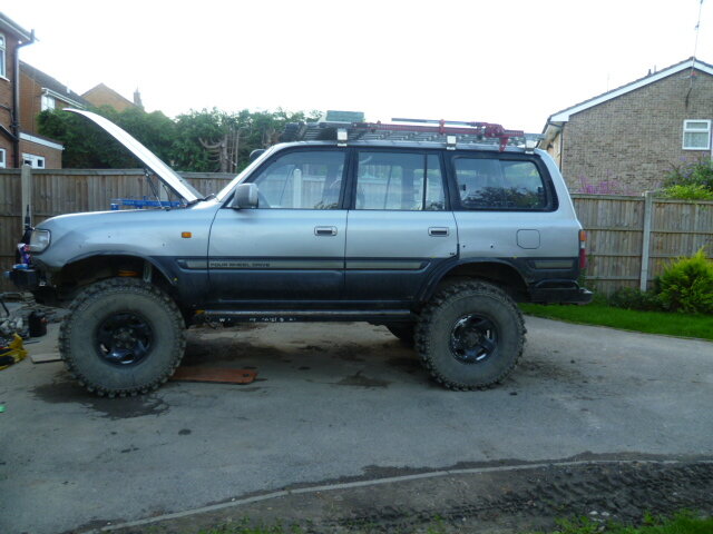

Then it got a bit like this
[attachment=3:stzt6bpm]P1010038.JPG[/attachment:stzt6bpm]

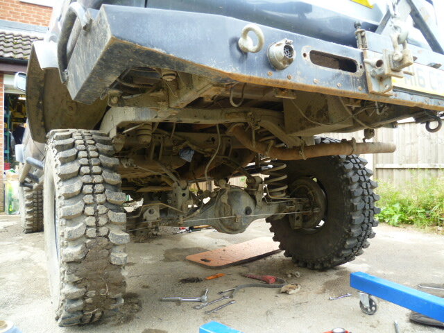

Then a little more like this
[attachment=2:stzt6bpm]P1010039.JPG[/attachment:stzt6bpm]

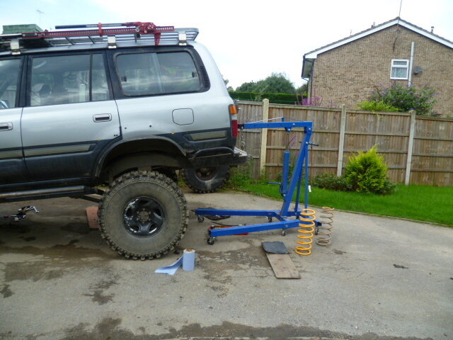

Until it started to look a bit like this
[attachment=1:stzt6bpm]P1010041.JPG[/attachment:stzt6bpm]

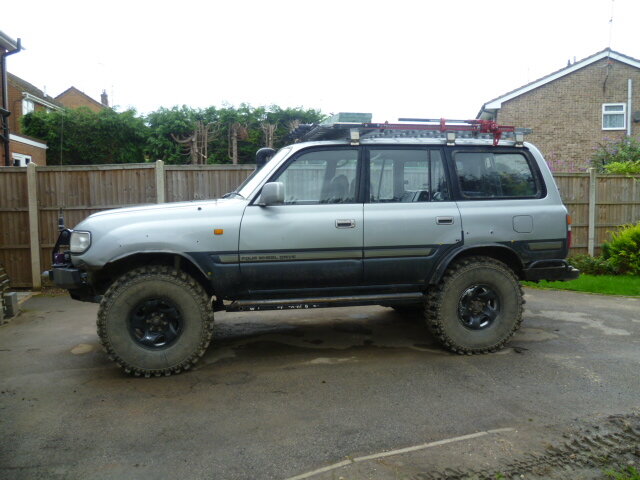

Then we did the same to the front endy bit until it looked like this
[attachment=0:stzt6bpm]P1010042.JPG[/attachment:stzt6bpm]
And there you go. Few bits to do tomorrow to make it look like they do in the brochure. Then winches back on and it's ready for action.

Ben, this pic IS full droop. We bolted everything up and then lifted the back until the wheels started to move. Obviously off road getting both wheel to drop at the same time would be unusual. But as travel is limited by the shocks, this how far it drops in total. Will be off road in two weeks, see what action shots I can get then. When you drop both wheels it doesn't look very dramatic I know. But trust me it's a lot. Whilst the wheel can't get any lower, as it leans in it gives the impression of being lower.
It is deff taller. It was already 3" now it's 5". No ARBs on now and it seems absolutely fine on the road.

Not sure you can correct 5" of lift with bushes can you Clive? I already had 2 degrees of correction on the front bolt holes and I haven't fitted the correction plates yet as I ran out of sunshine. But with the 2 degrees that I do have, it actually drives fine. A little light maybe but really fine. Will fit the plates tomorrow. It's a little but leany on the tight corners but remember that I am on 37" tyres too so it's never going to be like a sports car. Don't think you can really compare two vehicles when they are quite as different. But in short, ARB removed, barely tell the difference.

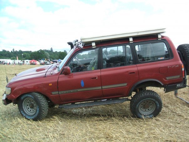

80's flex beautifully as standard, so i can only imagine what a kit like that will do when your off road! :twisted:
This is my 80 on an axle twister at the Berkshire 4x4 show before it was lifted.
