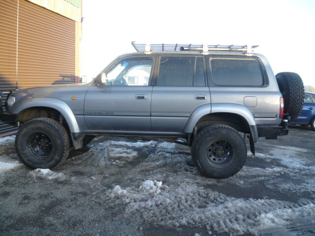

Looking good Chris, it's well worth getting the spring set-up by their loadings, not just "I want a lift, and....".
Just a tip, if you do have the over-arches wrapped, make sure they remove them and wrap them properly, meaning into the seal strips, not just up to them. You may have to dig deep for new seating beading seal strips and maybe replacement clips, but it will be worth it. I'm not trying to "teach my grandmother..." or anything, I know you always do a thorough job, JMHO.
As for the LSV, have you any evidence that it's working? Before my lift, I had no issues with mine, nor after. But because of the lift, I thought I should do something. Instead of doing the job properly, I lengthened the tie/actuator bar to the LSV by the appropriate length of the lift height. I still have no issues with it, no premature rear brake lock-up, nothing. But I also don't have any evidence that it's working. I'm letting a sleeping dog lie at the moment, but I'm interested to see if you feel any change when you get the "new" one set up properly.

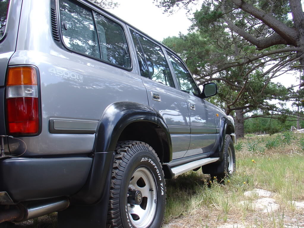

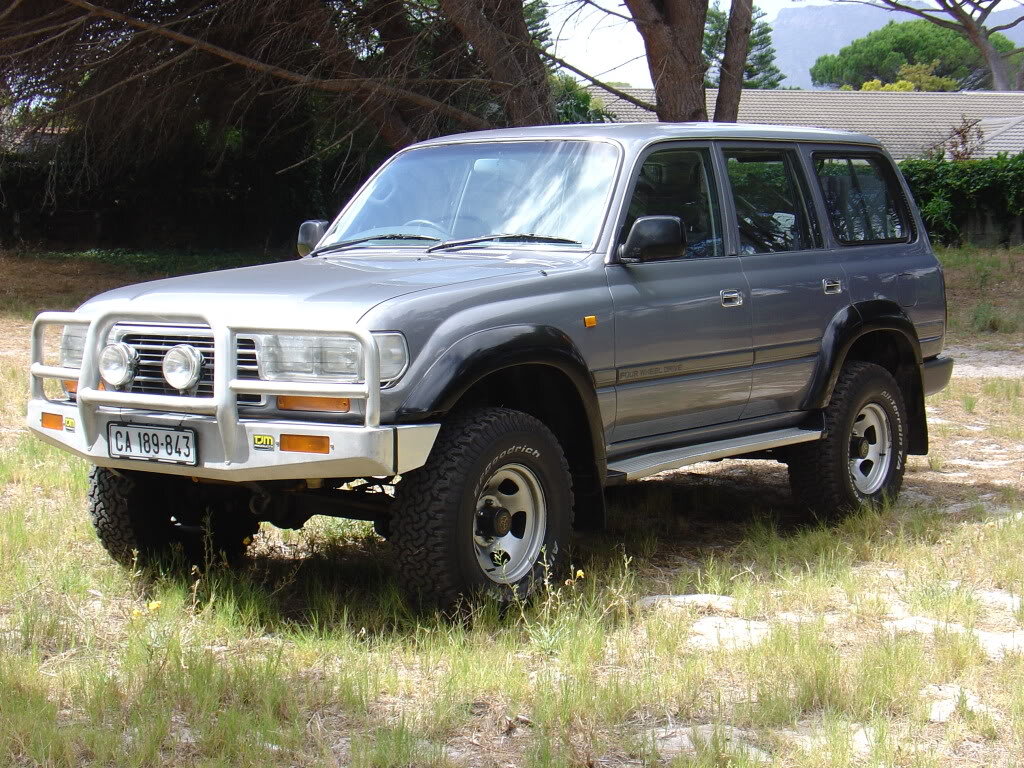

Although I'm lucky to have an 80 in "that" blue, the Grey is a great colour for an 80, and charcoal over-arches will set it off just fine IMO.
