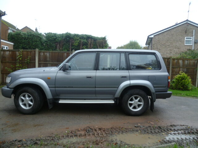

    And here it is. Silver, GS, 1995. Well it IS a manual, so really I did stick to my original requirements.

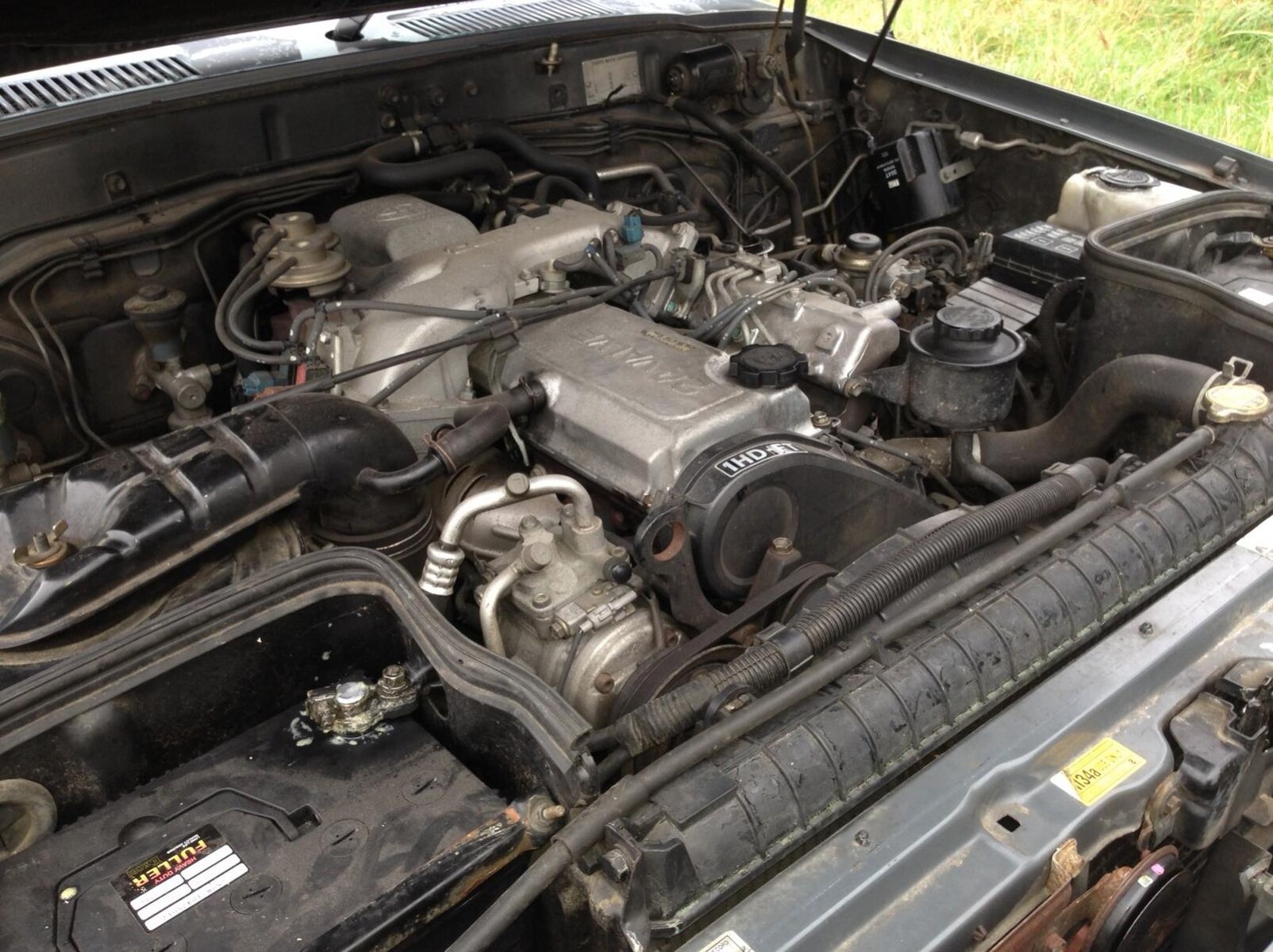

    Here’s the basic truck purchased from Laughton Land Cruisers. Technically it’s only had three previous owners and covered 215k miles. First owner covered 100k of those miles so I am told. Bodywork is very good indeed. Interior is extremely clean with very little work to do other than recover the steering wheel and rebuild the saggy driver’s seat. Underneath, well it’s not perfect. I have seen some crusty tubs and some minters – this is about halfway in between. Once blasted, it will get Dinitrol treatment in all the corners. So at the moment I am going through it replacing little bits here and there really to bring back to original. Over 18 years it’s hardly surprising that bits and pieces go missing.
    Pretty much everything works right down to the heated rear screen. All lockers now functioning. To drive it is very car like. Good brakes (no ABS) Handbrake perfect. I have touched (ahem) motorways speeds in it and it is as steady as a rock. The engine pulls like it has an intercooler (hmm, idea) and returned just shy of 29 mpg on a run to Scotland. All oils, fluids and filters have been changed along with the timing belt and two new matching Yuasa batteries. There were records of servicing up to around 190k so it’s been well looked after. Gear box is good, but not totally perfect. Changing down to second is the only very slight foible it has. But not every time. There are no noises at all associated with the driveline on or off the power. However, the top control arms could do with swapping as there is a bit of a push when you let off the power quickly. Hey – again, 215k miles!

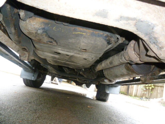

    So in summary, it’s dead straight. Not fiddled with and no odd bits and bobs that make you wonder what’s been going on. Even the exhaust which is nearly new is genuine Toyota.

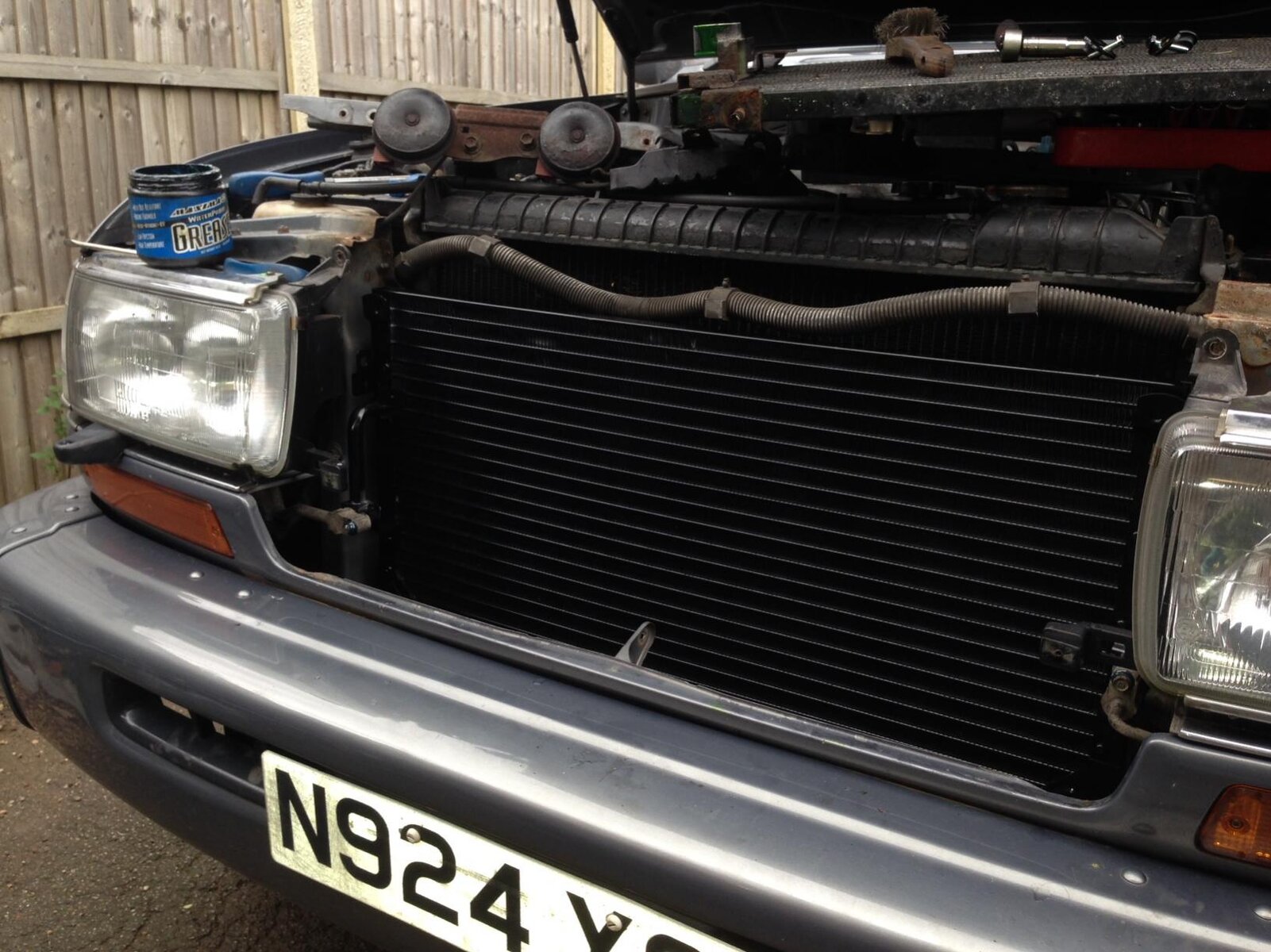

    After the servicing, I took it to have the AC re-gassed. Yes, AC in a GS. Factory option ticked! They put it under vacuum for 20 mins at the main dealer. It passed. They gassed it and I got as far as the window tinting place 500 yards up the road before there was green dye pissing out all over the place. So one click later on the Autokool site and a new condenser was on its way. Fitted, just need another re-gas. I also fitted a new roller blind at the same time. A friend had been given this by someone clearing out there shed. They used to have an 80 and wondered it it could be found a home. Thank you!

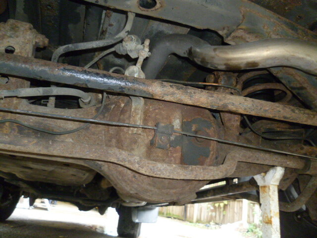

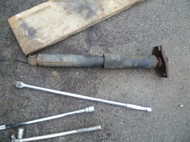

    I really wanted to base line it completely before doing anything at all to it. But there is a sequence that has unfortunately been knocked off kilter. The idea was to run as standard and then fit the 35” All Terrains to see how I felt about standard diff ratios. I have spare upgrade diffs on the shelf. But, the 35’s won’t fit without the suspension lift. So… off with the old genuine Toyota springs and dampers. I had to cut the front dampers off but the springs are good. The rear dampers are excellent, but the springs were rusted to bits. More for the scrap man when he shows up. I fitted the Iron Man B set up that I took off my other 80. But first I had the springs coated and blasted so that they didn’t look like crap in 2 minutes flat. So far they have been on a day and still look better than IM straight out of the box. They might look alittle dirty, but there's hardly any rust on them. I think that they have been replaced at some point - again with genuine parts.
    Suspension fit went OK other than snapping two ARB bolts in the chassis and bending the engine crane in half. Took me an hour to make a new jib and get going again.
    So, springs and dampers fitted, it drove well. Felt very nice.

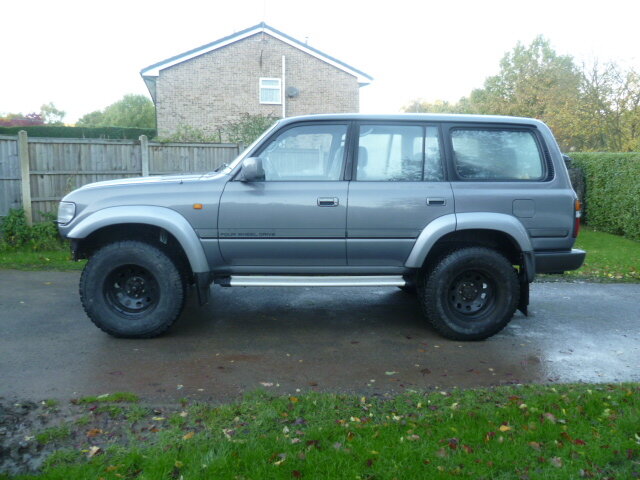

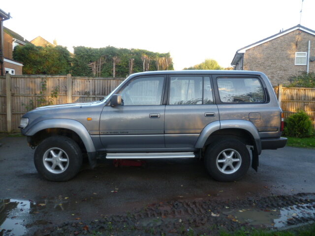

    Next job was fitting the 35’s. No clearance problems this time. By this time, I was starting to feel pretty good about the prospects for this vehicle. This grey is not my favourite colour, but with the black accents, it's beginning to come together. Once the tinting is done, it'll look even better.
    Whilst the sun was out, it would have been rude not to do a bit more. Soo….

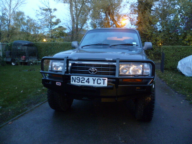

    Got Mrs Chris to help me lug the bumper round to the front of the house. Initially there was no chance it would go on. The chassis rails were too far apart. I suspended the bumper on the engine crane and wiggled and jiggled for half an hour and even battered the ends with a hammer. Nope. Then I got the High Lift, set it in squash mode and clamped it across the chassis ends. One heave-ho later and the chassis was the correct dimension. The ARB slipped on a treat. Holes lined up and bolts went in by hand. Loverly. By this time the sun was going down. So in time honoured fashion, Zebedee called time. We'll see what next weekend brings.
    Been for a spin and I really can’t tell that it has 35’s on. I have to question whether a re gear is necessary. It still goes like an express train from a standing start. With the decent tyres on, and the new suspenders, it goes round corners superbly.

    Thanks chaps. That's all for a bit. Busy again so can't spend much time out there and the damn rain keeps knocking me back. The tyres are BFG all terrains. 315's on 17" steels. Ordered a full set of window rubbers as these are set rock hard like plastic. They will put the new rubbers in when they do the tinting. Then I shall see how the motors cope. You can't tell at the minute. I won't start on the internal modifications just yet and I would like nice weather too. I'm not doing cabling etc in the dark with rain running down my neck. There is no particular rush to get this one done. I want to assemble all the parts and plan cable runs and things like that. Perhaps even make up a harness, in a sense and run it all in flexi-tube underneath. Might try for third battery under the bonnet this time although putting it in the floor has been good. Still lots of decisions to be made such as long range tank and rear bumper set up etc.

    35s on 17" rims? For 305s, what rim width do you have Chris? I'm using 10" because on 8" they looked decidedly "stretched" or the opposite, if you know what I mean!

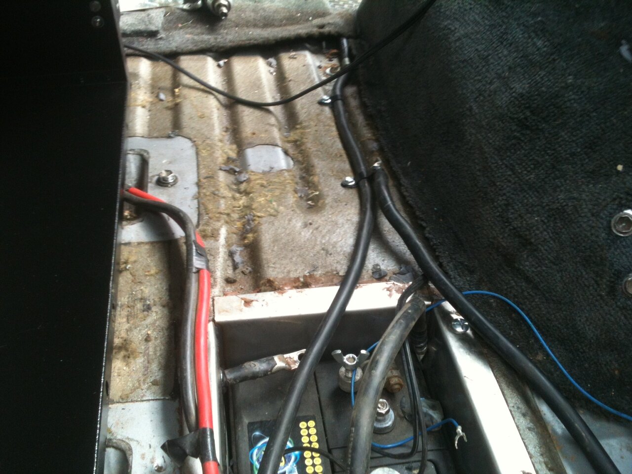

    I like the idea of batteries under the floor. If she's lifted then there won't be clearance problems and it seems to me that a lot of interior space is wasted on batteries inside the truck. Under the floor they can be protected in enclosed battery boxes (vented of course) but protected from the elements.

    Ooh, that might be 315 Clive. Sorry.
    They're feckin huge. They are not on an 8" rim.

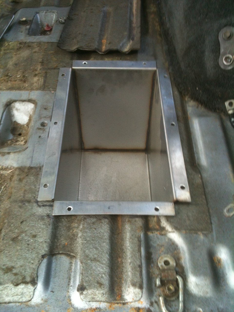

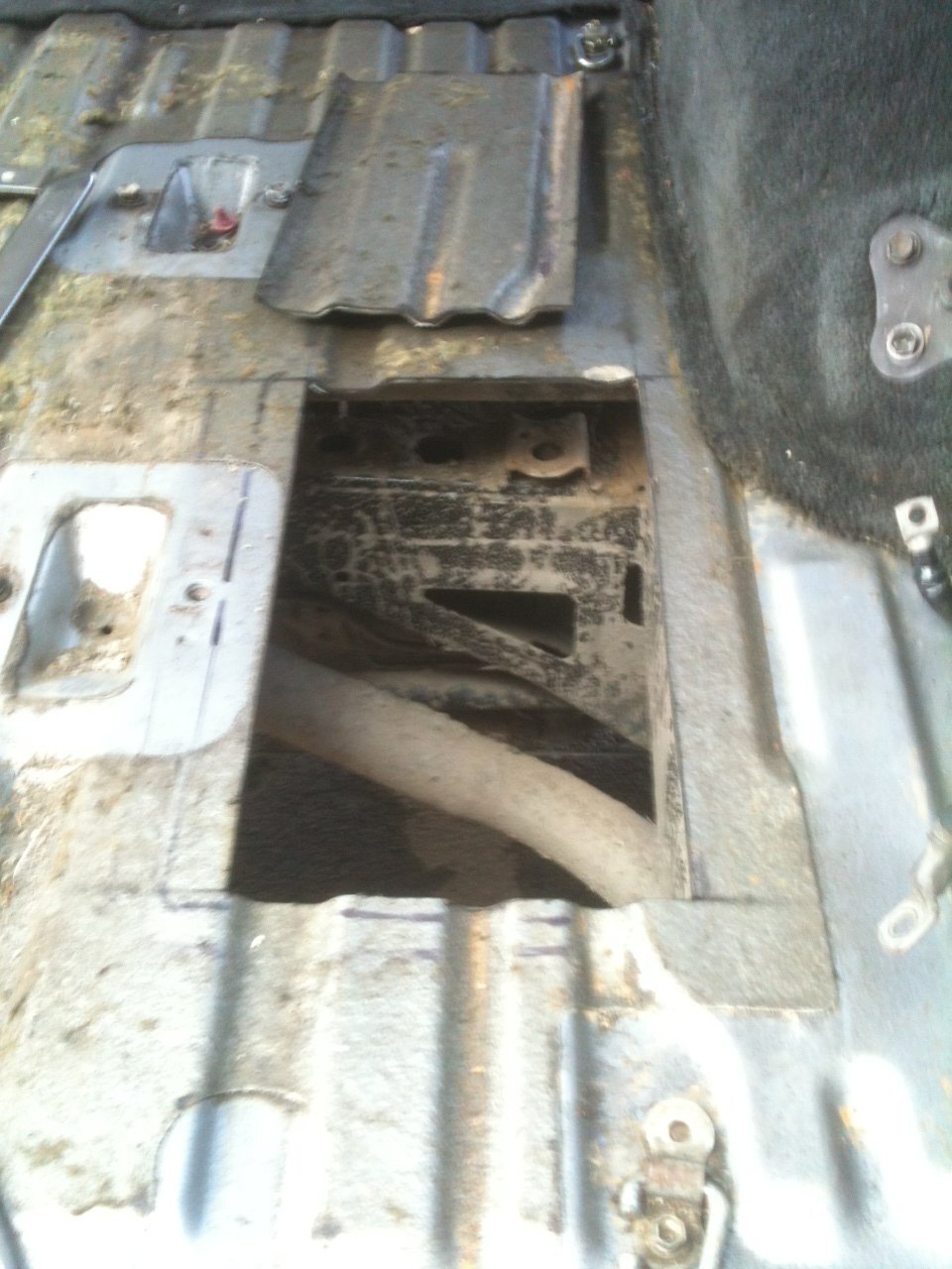

    Not sure where the pics of the battery box have gone. I had the box made from stainless. Cut the floor with a slitting disc, dropped the box into some goo to seal it and made a square 'hoop' to match the top lip of the box to go underneath so that the floor was sandwiched effectively. The box was built around the battery so it can't move. If I put it under the sliding top side of the outback drawers, I can get to it really easily. There are probably other places it could go. Like in a foot well for example. Not decided yet.

    I'm loving the idea of that battery tray in the floor.

    Found the pics. Although this is about the new build not the old one of course.

    I had similar issues with my ARB bumper, I used a bottle jack to spread the bumper open slightly, this allowed the bumper to slip on nicely and line up. Once all the bolts were in, I released the jack and the bumper compressed onto the chassis. If you removed all 12 of the bolts that bumper still wouldn't come off!

    What are they on then Chris?
    315s will be huge, my 305s look big enough :lol:

    Edit: My front ARB was a pig as well. That needed the chassis stretching. What I noticed from measuring, the two chassis rails taper slightly together towards the front of the truck. That means when you tighten up all the mounting bolts, the chassis rails are actually under some tension (trying to straighten the taper). It's only about 10mm in total but enough to measure. They were "even" as well from a central point, I'm sure they're not bent :whistle:

    Clive mate, I haven't a clue. They're black and that's all I can tell you. They measure 35" or a bit more and are mostly round with a flat bit at the bottom. They used to be Jon's, then possibly Toby's then Ian' and now mine. They have been to Morocco I think.
