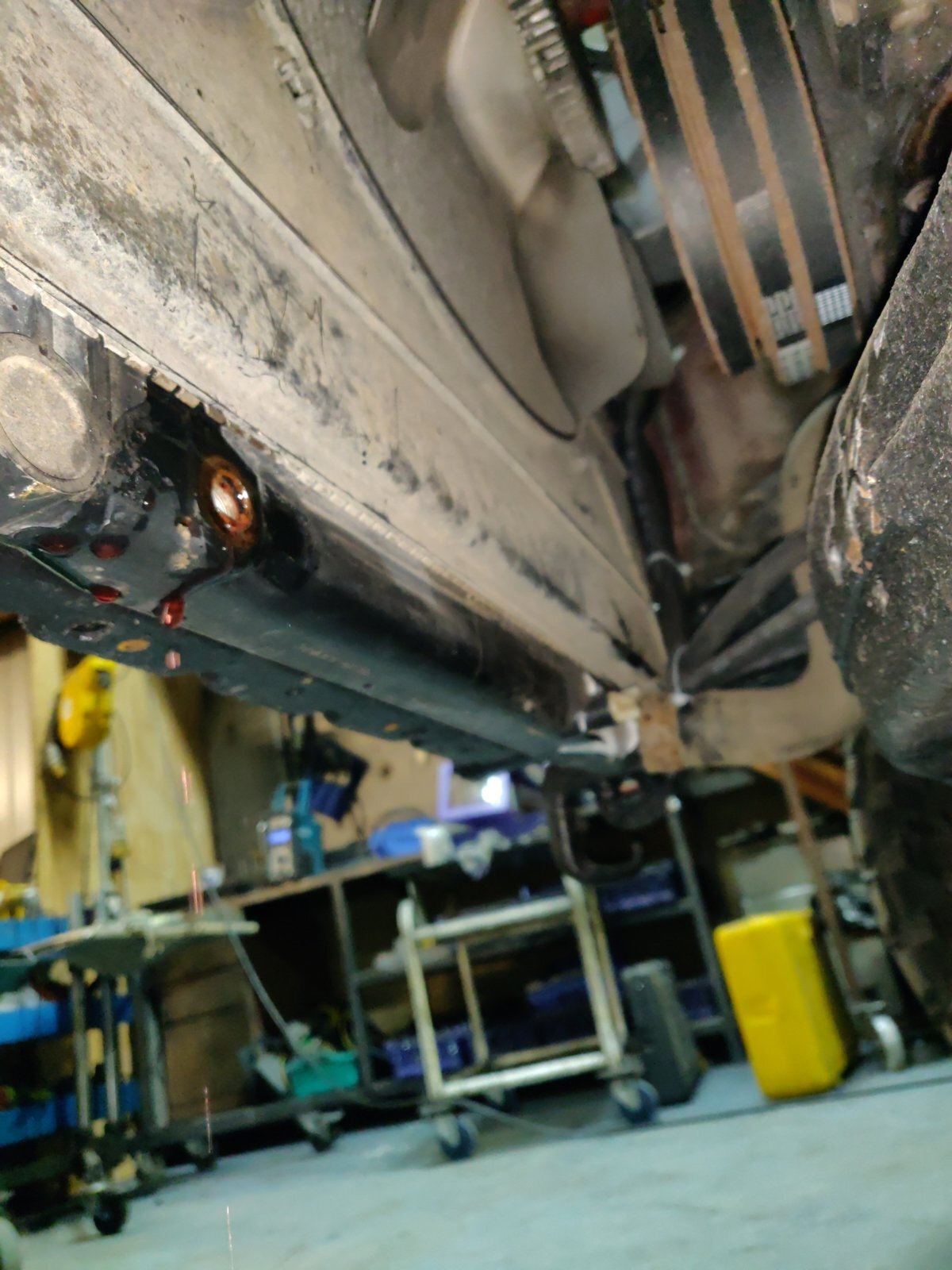

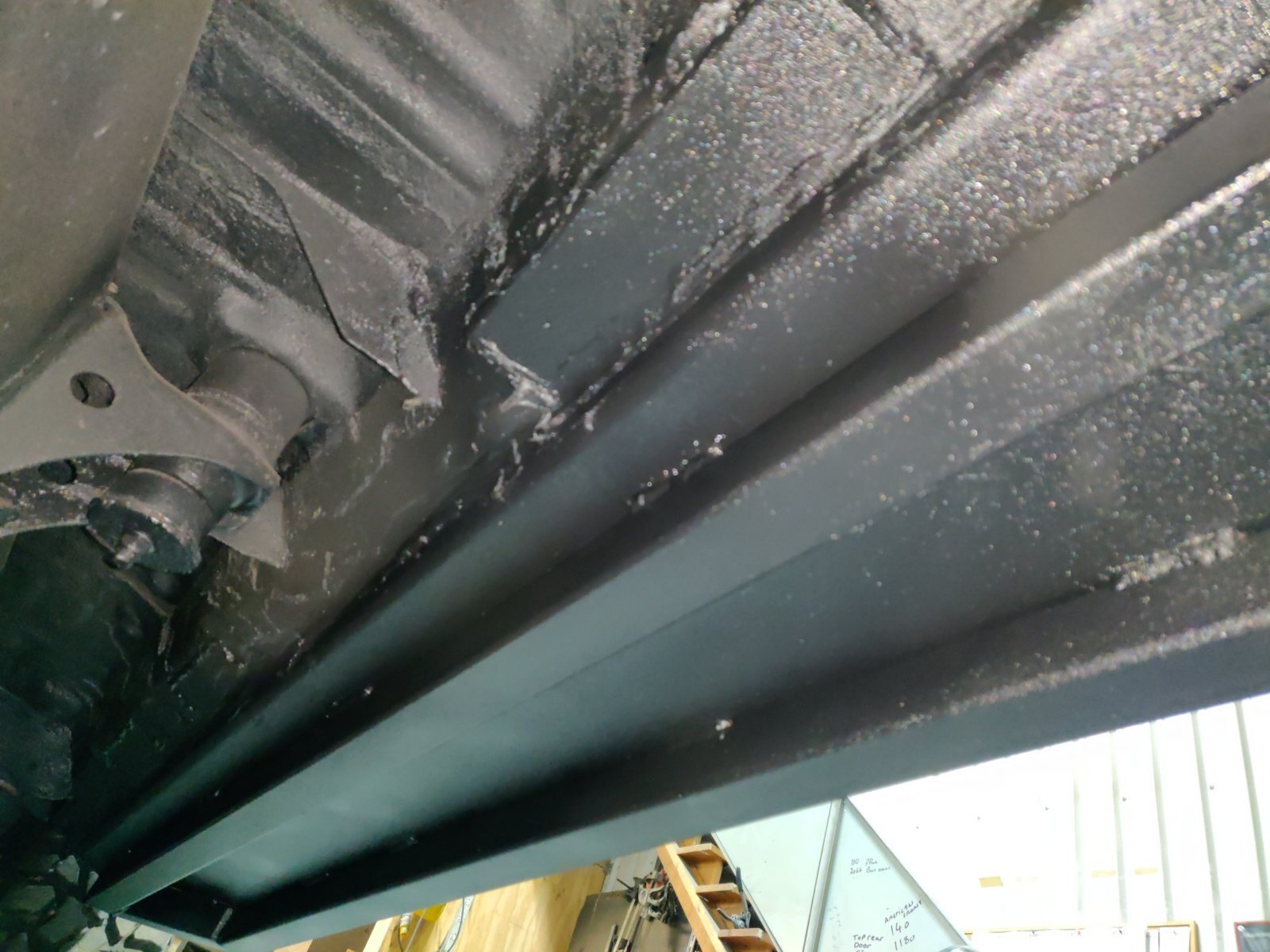

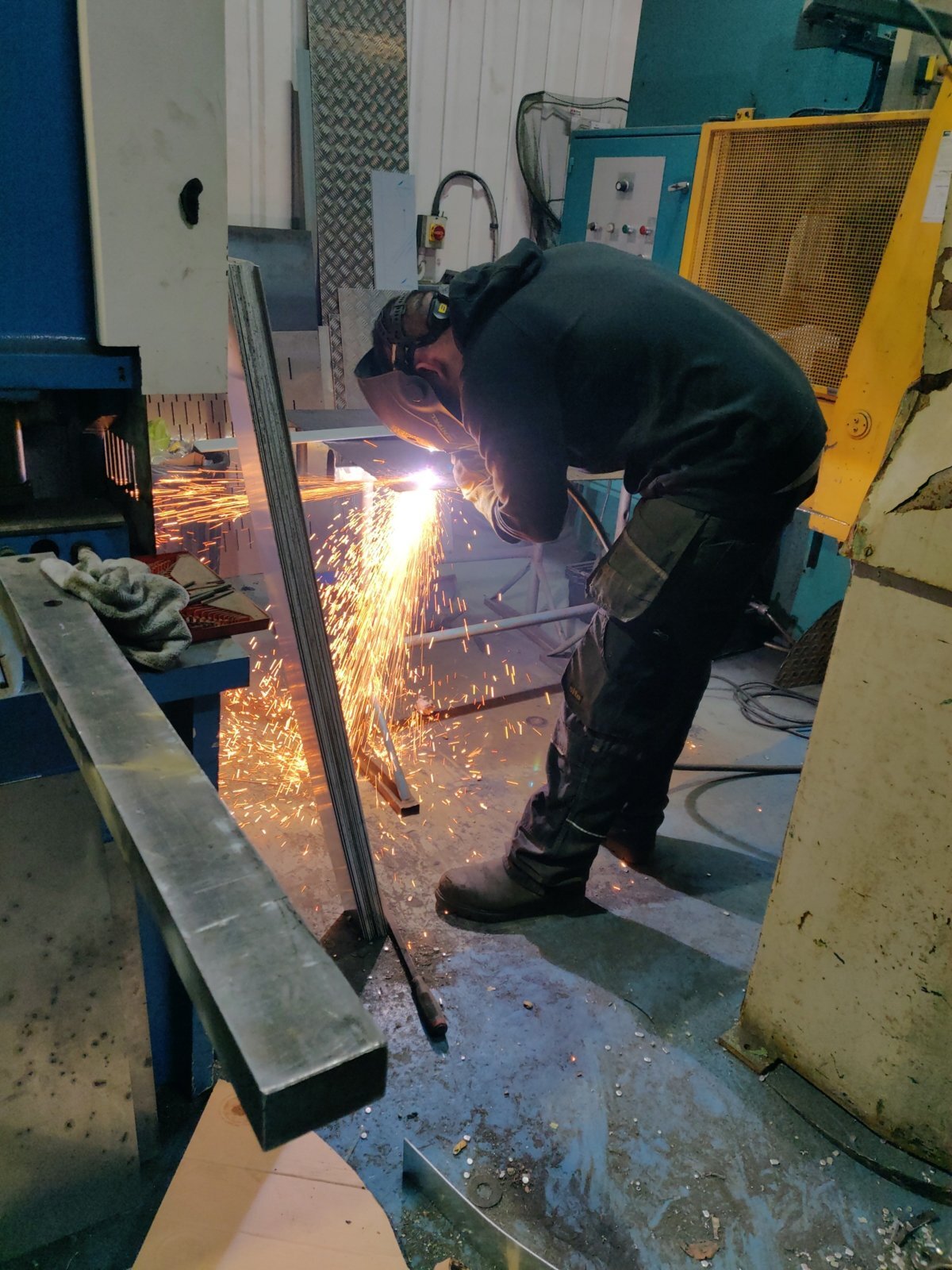

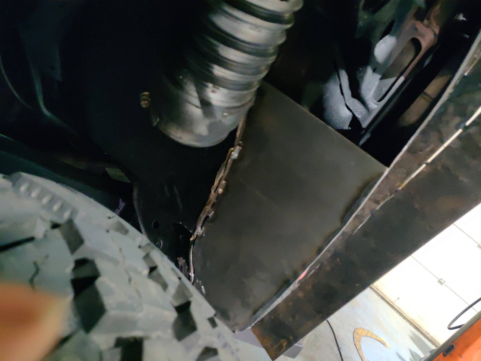

Where there was once body there was a lot of rust. Then along came the angle grinder and cut it all out. Now instead of body it is box section (80mm I think) seam welded to the gusset work / body strengthening... Strong enough that josh said he reckoned he could lift the truck with the fork lift off the steps... I Hvent taken him up on the suggestion yet but we may well give it a go after we've chopped the steps off and shortened them as after feedback (yours included) we've decided to raise them up.

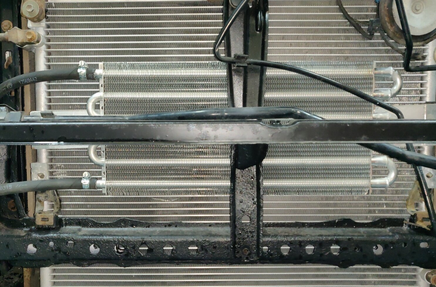

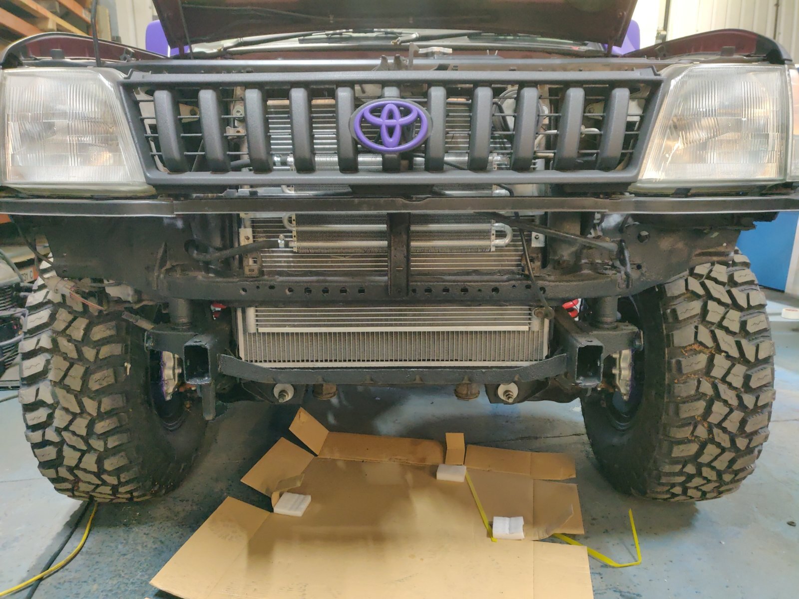

Trans cooler fitting completed

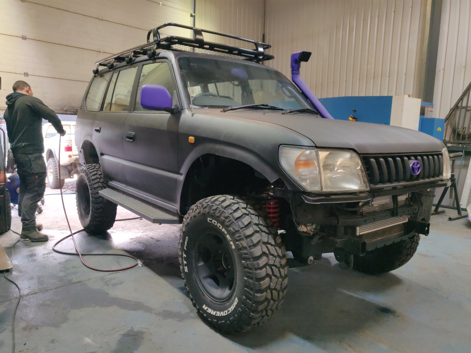

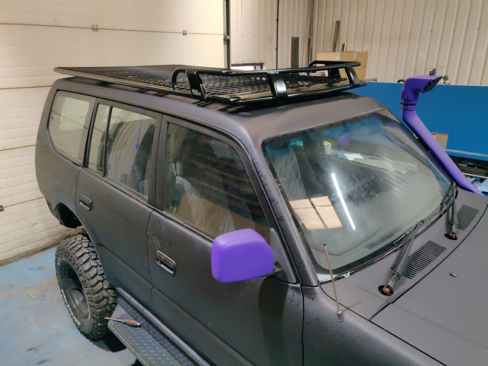

And ironman roof rack finally arrived from aus

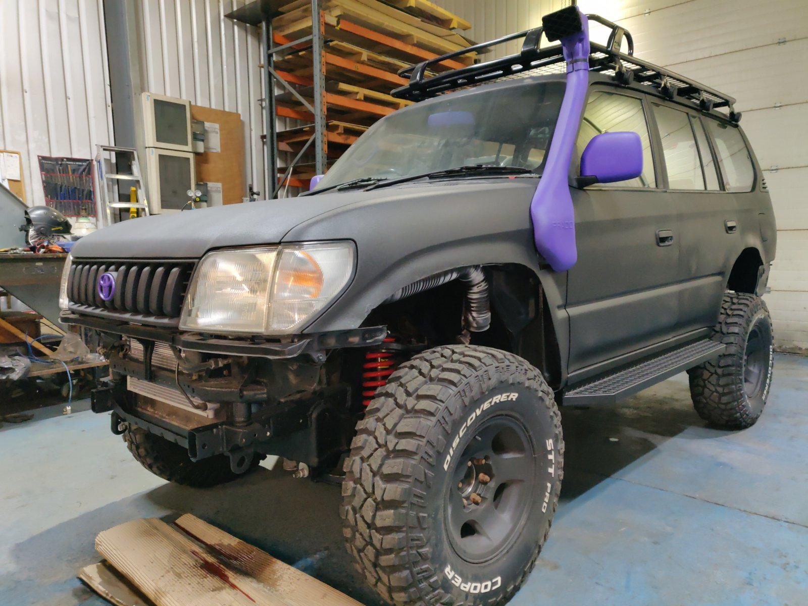

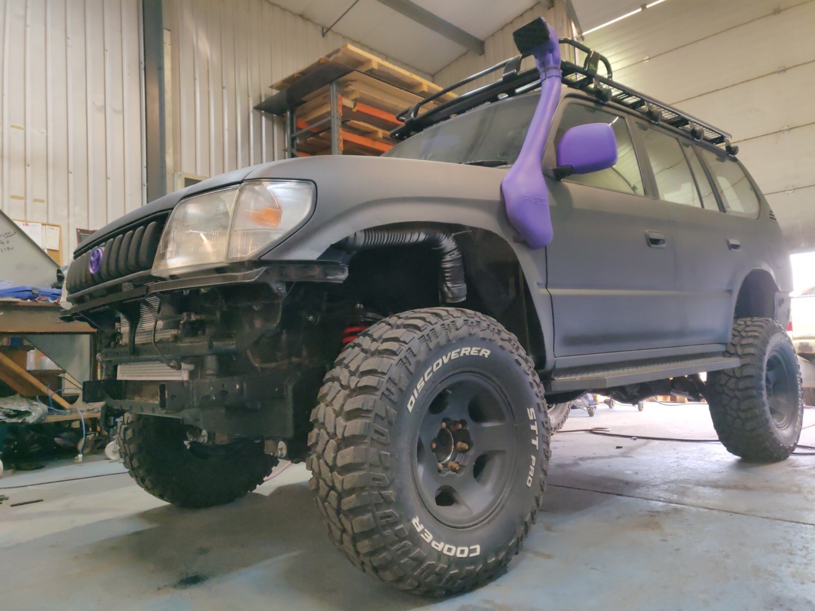

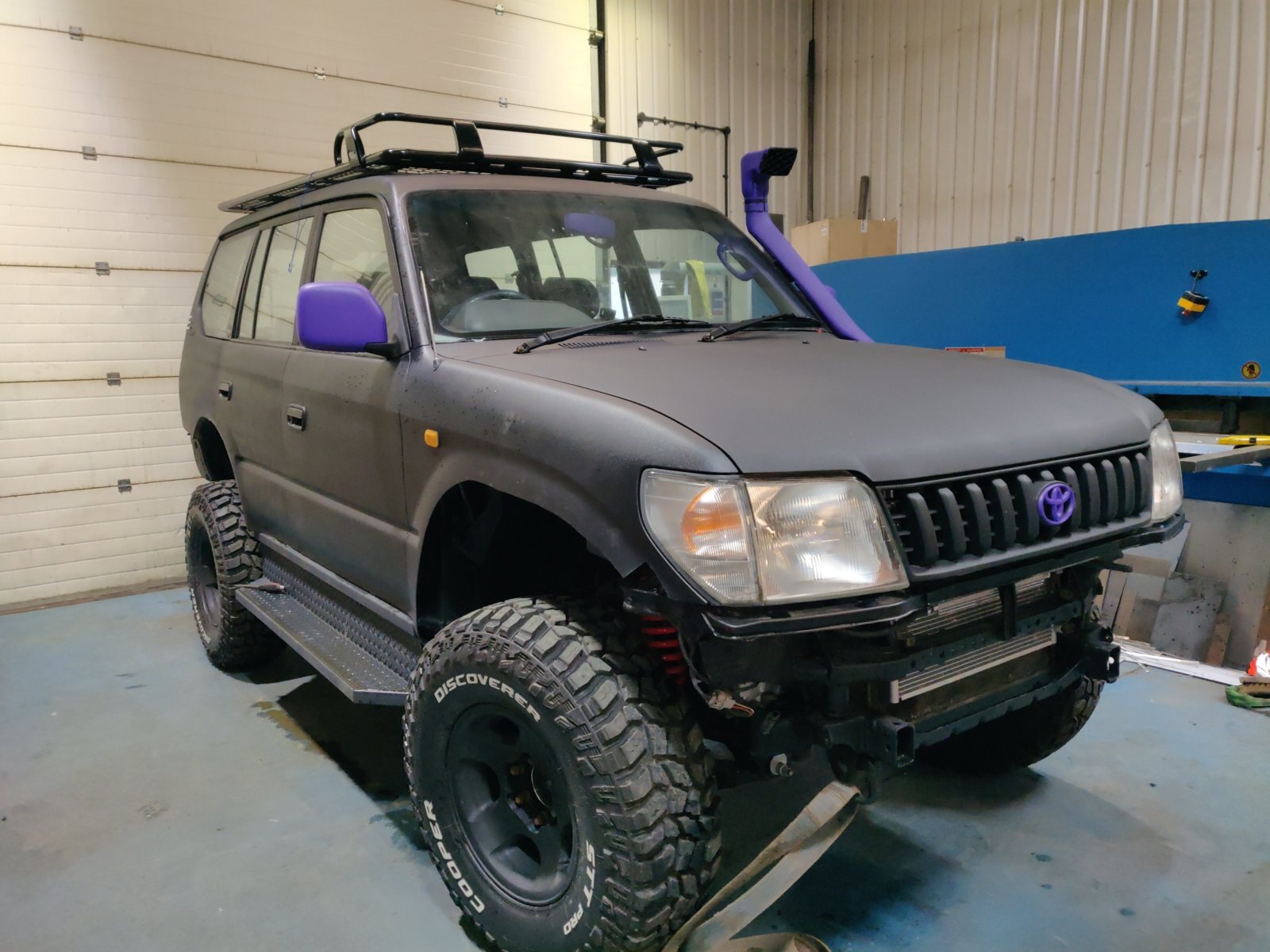

So we finally got a day when we weren't up to our backsides in alligators and spent the day in the workshop.
Roofrack fitted fully, ready for lights to be mounted and wired up.

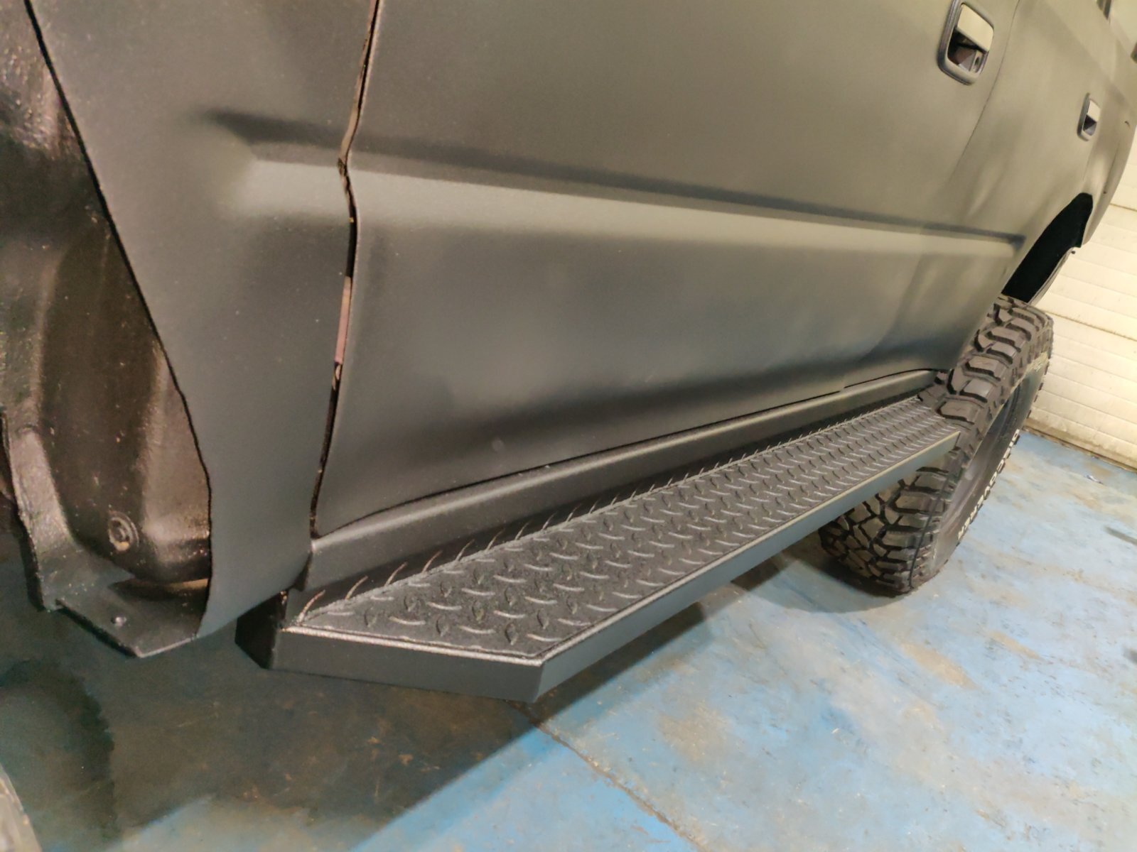

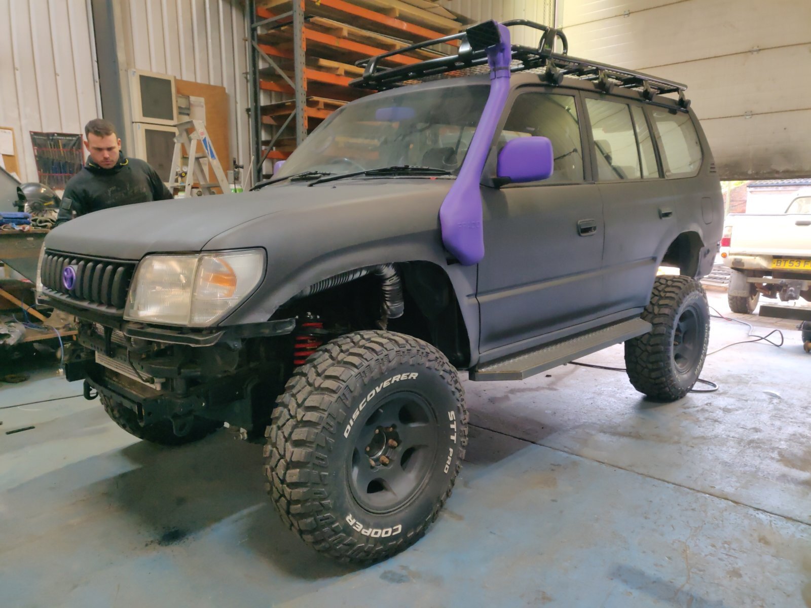

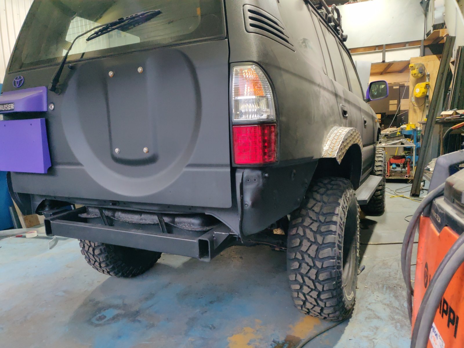

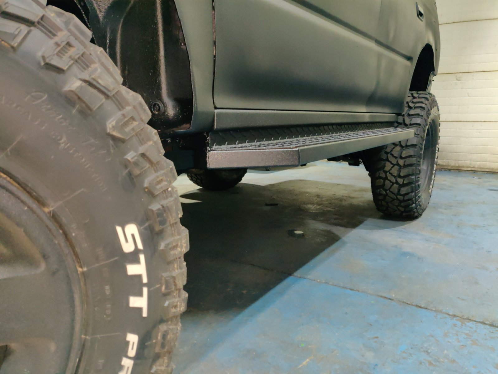

Side steps re-worked. We took on everyone's feedback and shortened them. We then picked the truck up on the forklift one side to see how strong they were... Epic... Wish I'd taken a photo! What that did prove is not only the side steps are strong as an ox but that the a sense of ARB at the rear means the centre brake line is holding the axle up on articulation. I'm having a think about whether to refit the ARB or just get a longer hose made up (have a feeling even with the ARB in it will be too short due to the body and suspension lifts.
We then finished up by raptoring the side steps/sliders, box sills, new rear inner arches and refitting the fuel tank.

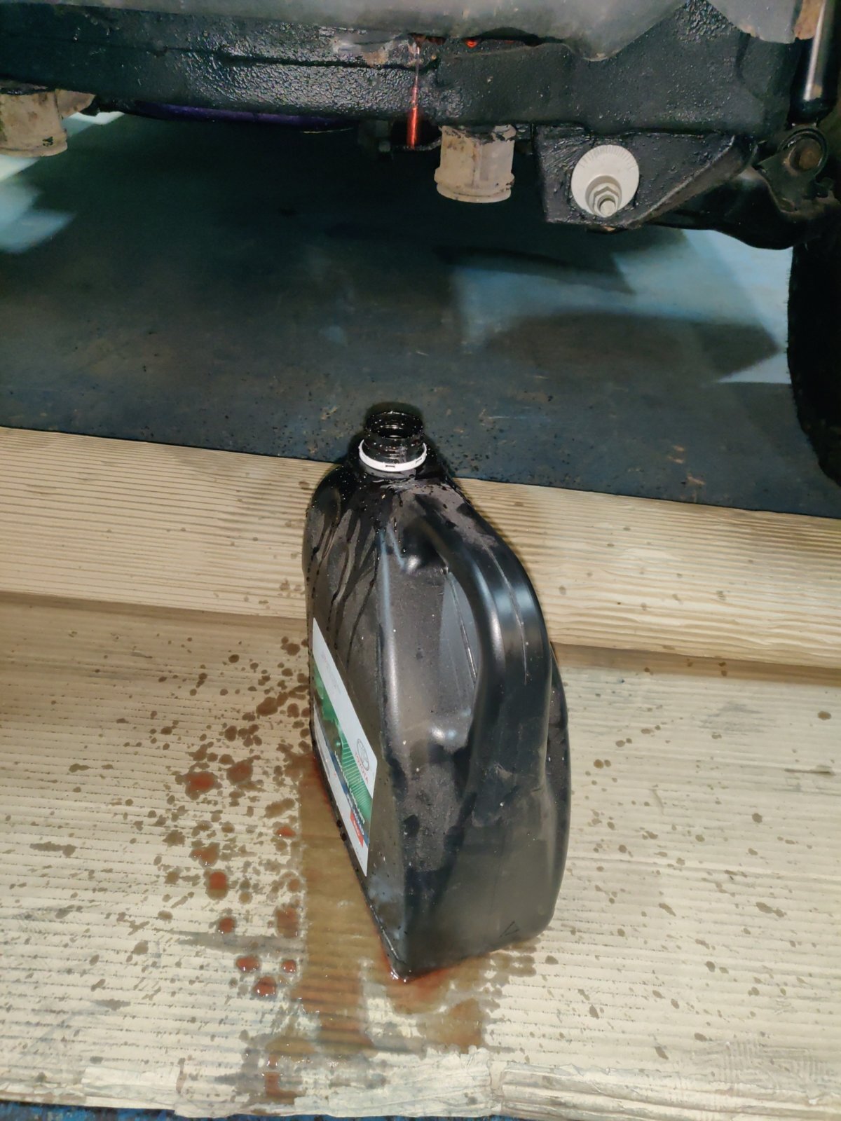

The plan had been to. Try and start her up so we started to fill the coolant only to end up with it pouring out of the ATF port on the n/s (now has no hose on it as the Atf cooler has been fitted). So it would appear the dreaded rad failure has occured! Very surprised as when we drained the gearbox there was no evidence of mayonnaise. My guess is that draining the coolant system dislodged whatever muck was keeping the two systems separated (albeit only just!). So new rad on order from roughtrax unless anyone has suggestions for an upgrade?

Steps look alot better mate.
Trucks getting there now. It's looking good.
The smiles of driving it are getting close
What a beast!
You’re gonna have loads of fun in that when you’ve sorted out the niggles.

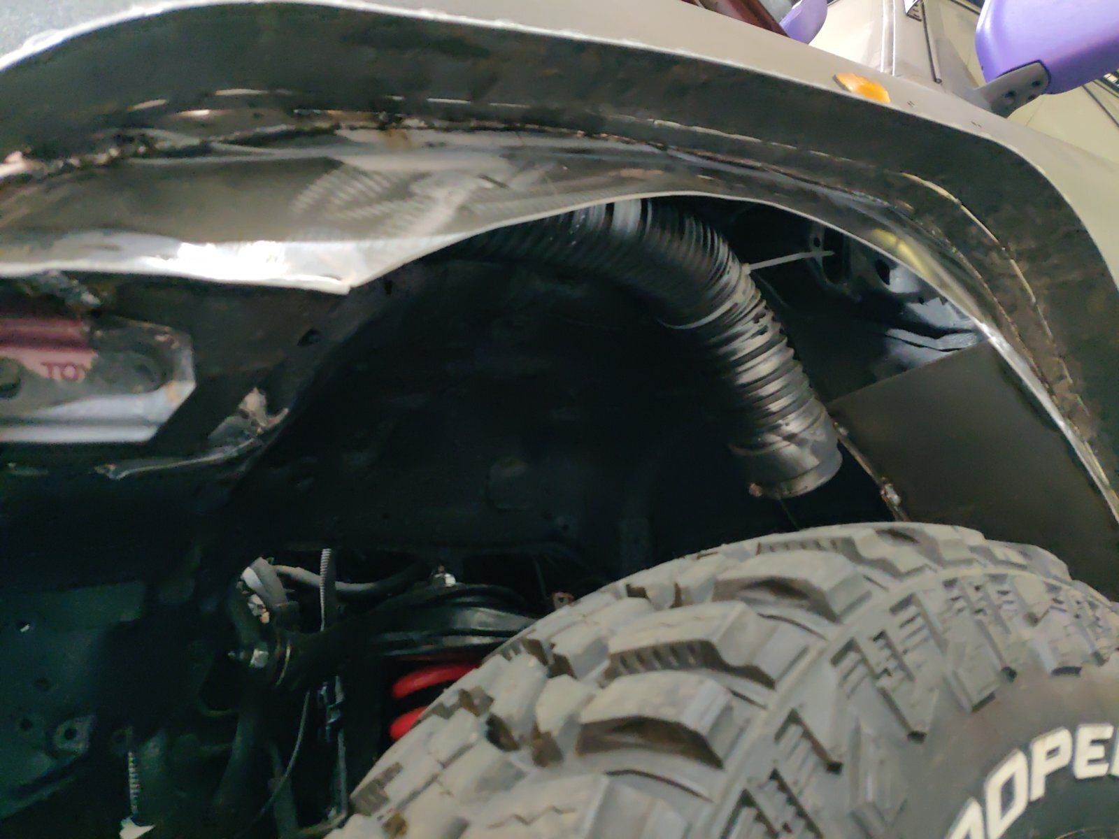

Have you extended the breathers yet to match the ability of the snorkel?

Steps do look a lot better and i'm curios to know how you will finish the arches .
Arches will be occurring this Christmas... Think Mitsubishi Evo is all I will say :).
Breathers are also on the very long list.... Got the bits just not fitted yet.

If you were in a hotter climate or tow a lot I'd say ditch the rad cooler and run the trans on a separate circuit (This is what I did) but you might be best keeping it to help heat the trans up in colder climates.

I'm running a separate trans cooler as have cooked a few autos in the past and don't fancy trying to find a good one when I blow this one :)

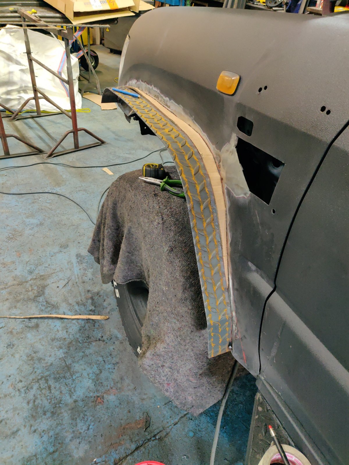

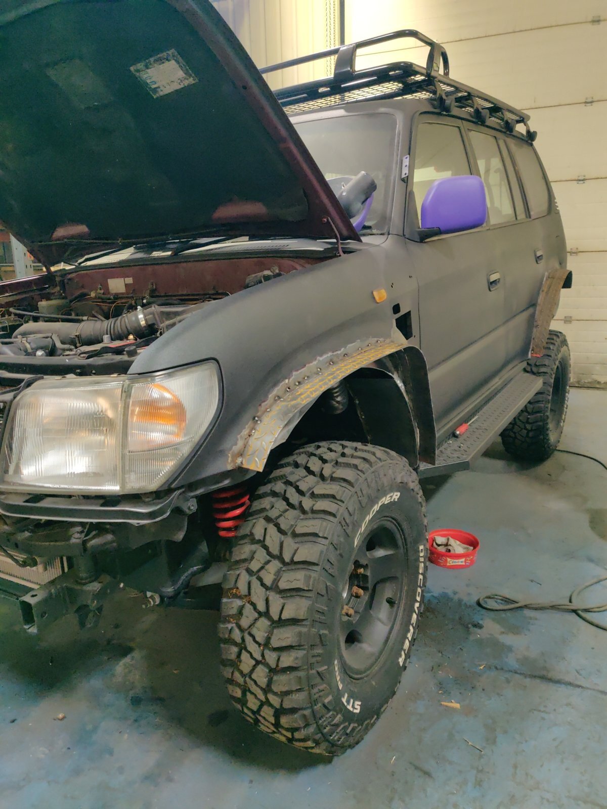

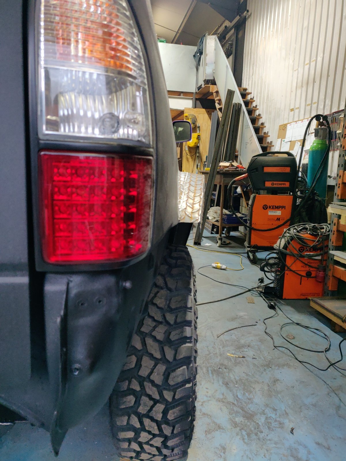

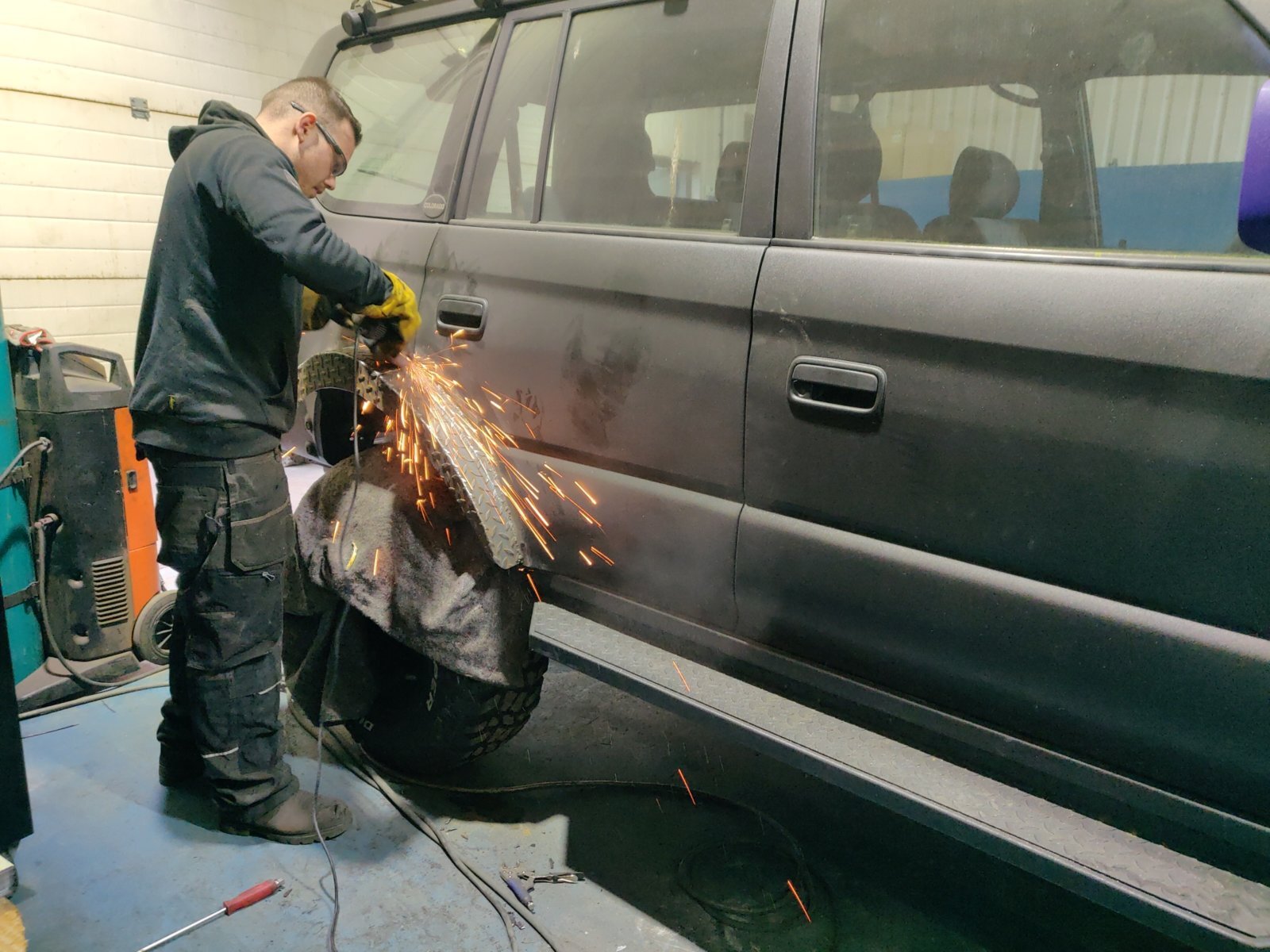

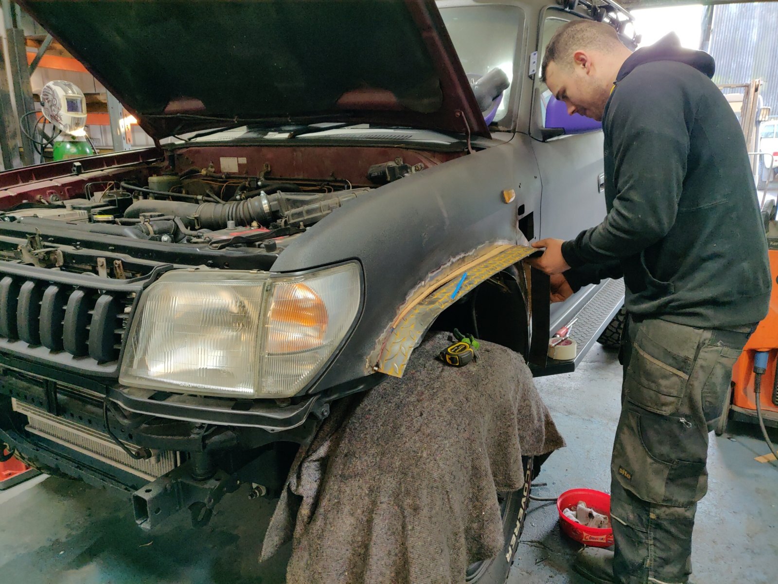

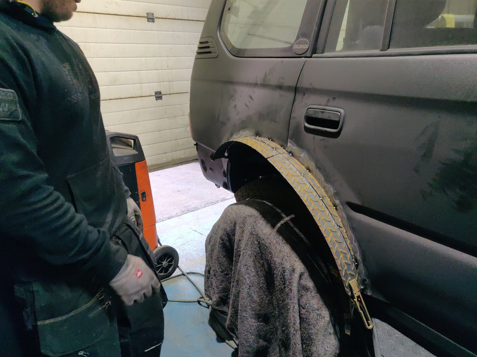

Christmas update time... Problem 1 we've been mad busy! Normally the guys at Metal Products are a bit quieter this time of year, but not this year! So a massive thanks to the guys and Josh for making the extra time!

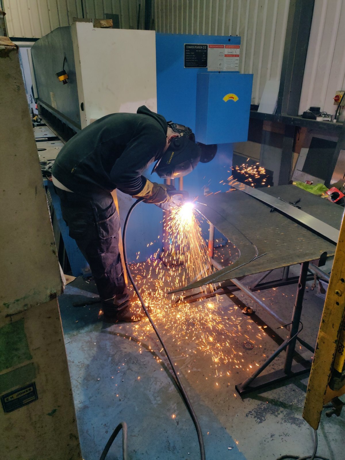

So tofay we replaced the rad, topped up coolant, changed tx box oil, refitted the fuel lines to the tank and Josh started arch fab. More to come tomorrow....
IMG_20191229_144221.jpg IMG_20191229_155620.jpg IMG_20191229_155551.jpg IMG_20191229_155555.jpg

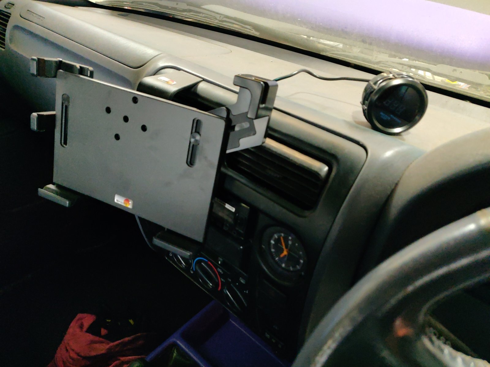

Some more fab work on the arches today, and fitted the water temp sensor and guage. Tried to service front diff but some tw*t has rounded the hex bolt drain plug so need to work out how I'm attacking that (if anyone knows of any tools like the irwin knackered bolt extractors please let me know). Also had a look at changing the upper ball joint rubbers (don't ask but the rubbers on the new joints got err you know... Fooed) but couldn't get the ball joints apart so again any suggestions for a good ball joint splitter let me know.
