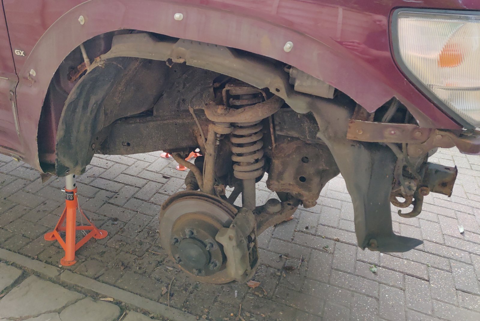

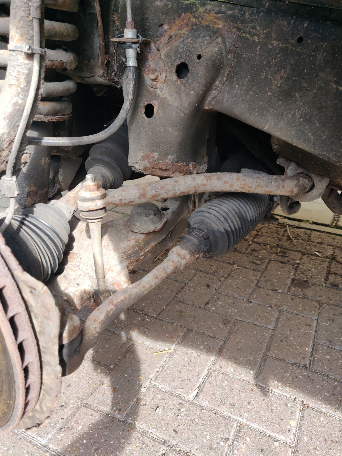

Yup... That'd be an anti roll barTorsion bars that go from chassis to front lower wishbones will go to shed and measure them up for you
Think you got it wrong under the drivers door area on the chassis is a big adjuster nut about 30 mil in size which adjusts the hight of the front suspension and the torsion bars go from there to the front lower wish bone of the independant front suspension if you have a workshop manual be best to have a look before you spend out for the wrong thing
Probably iron man... Still OK without the arbs? I'm used to ditching them on old discos.... Wibbly wobbly!Did you say you were upgrading suspension to Pedders ? If so scrap the the arb's you won't need them .
