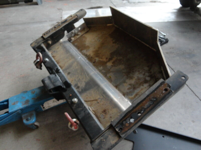

rear winch installation for LC 90/95
chris lc90
Active Member
Aug 18, 2010
88

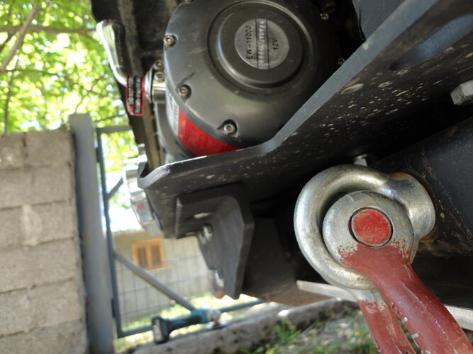

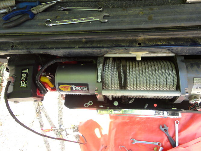

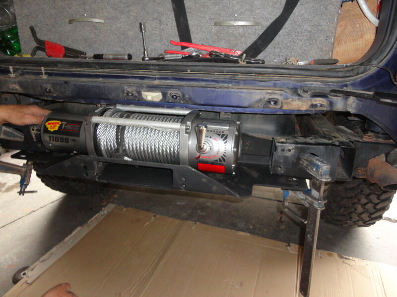

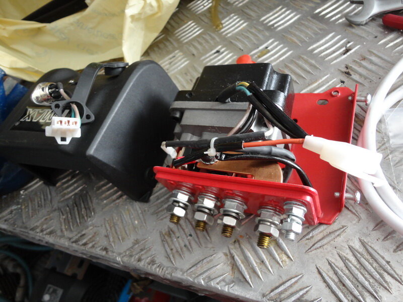

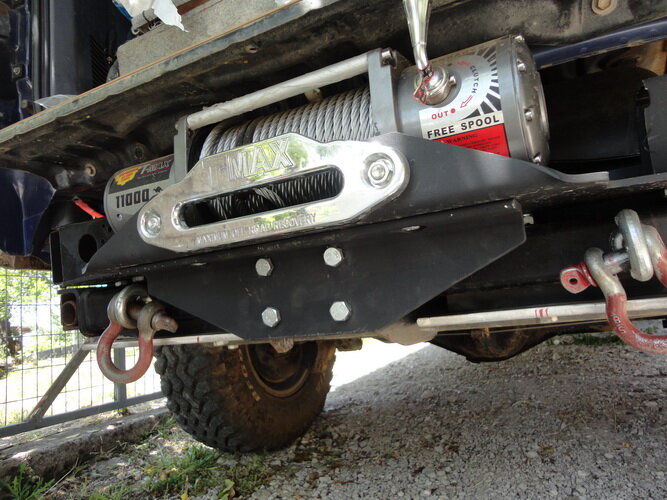

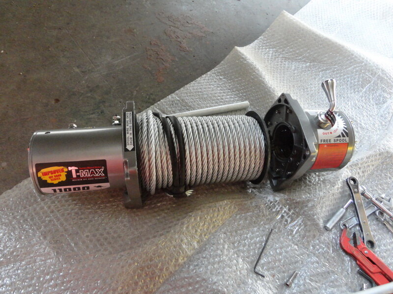

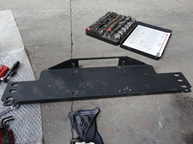

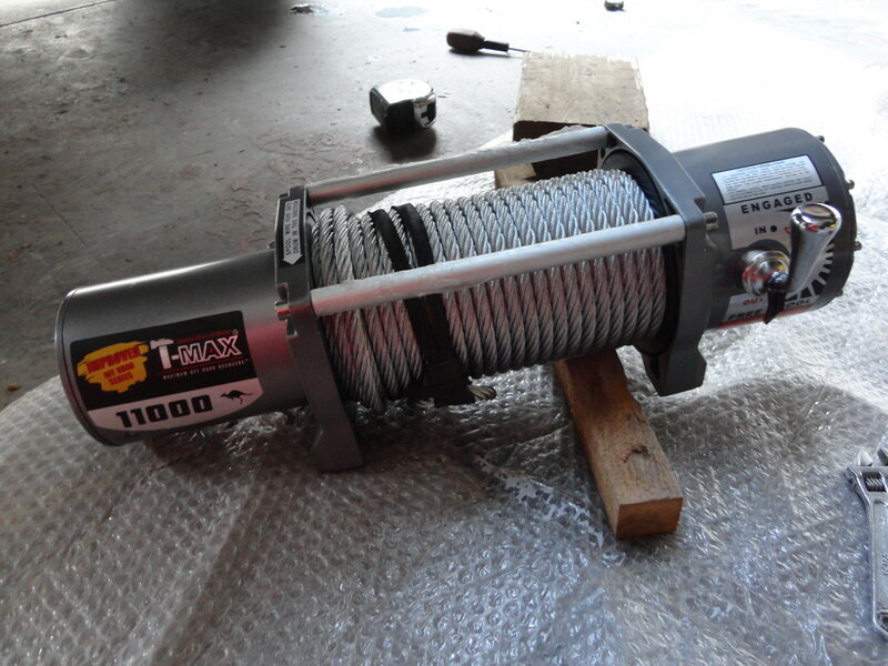

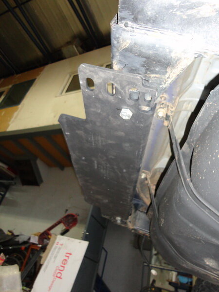

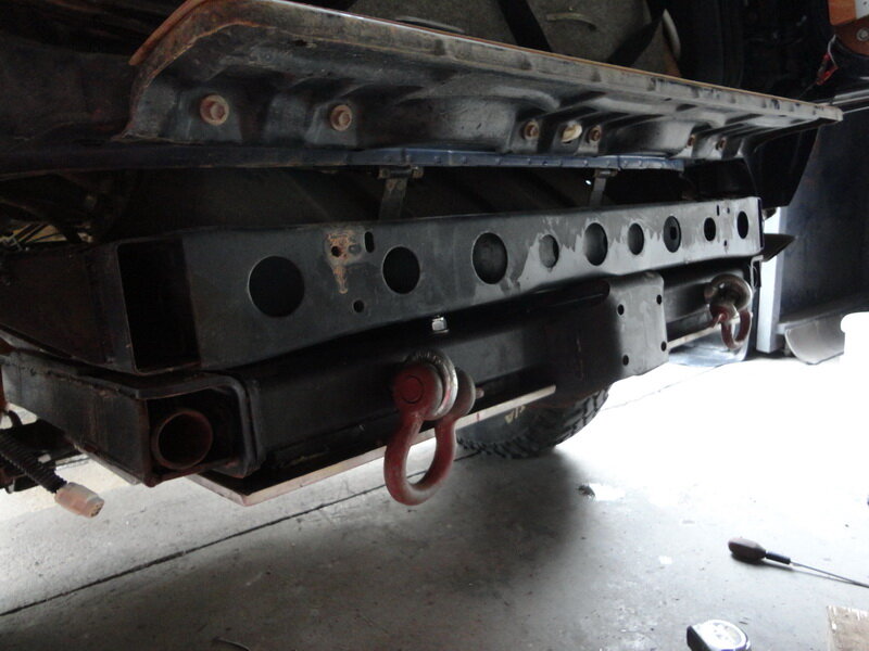

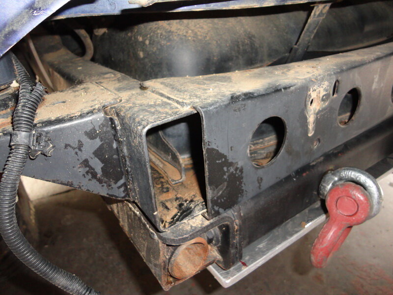

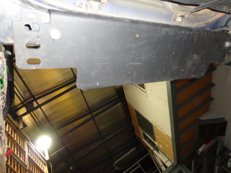

a T-max 11.000 lbs it was the choice for the rear recovery.. and the support base was from a jeep wrangler..
first changed the position of the free spool handle..

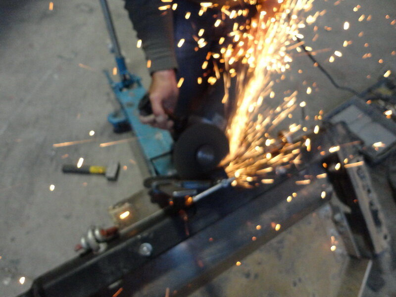

and then prepare to cut the traverse.

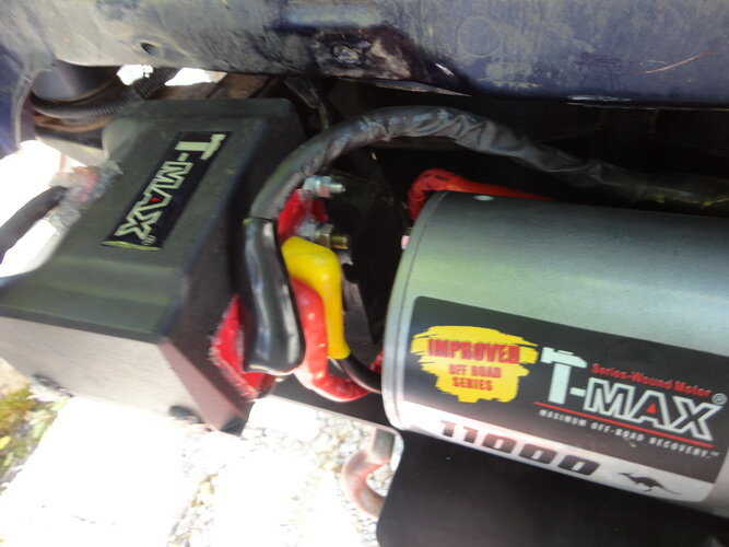

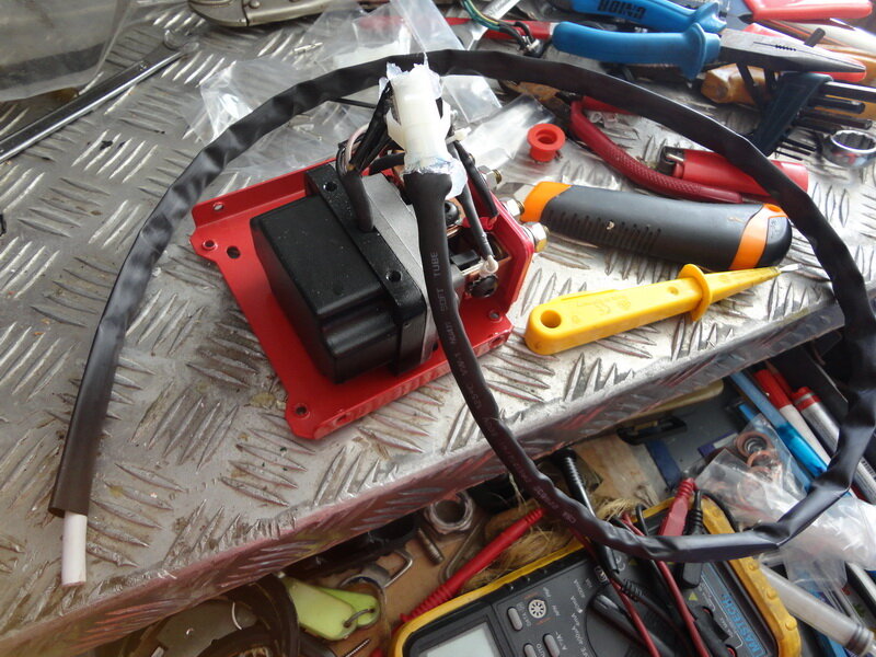

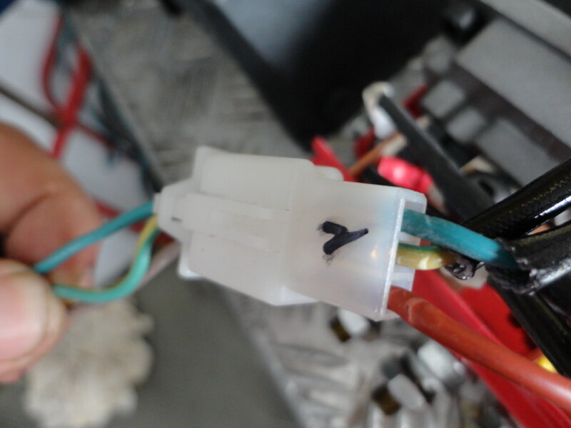

..change the position of the wire command with an extension cable..

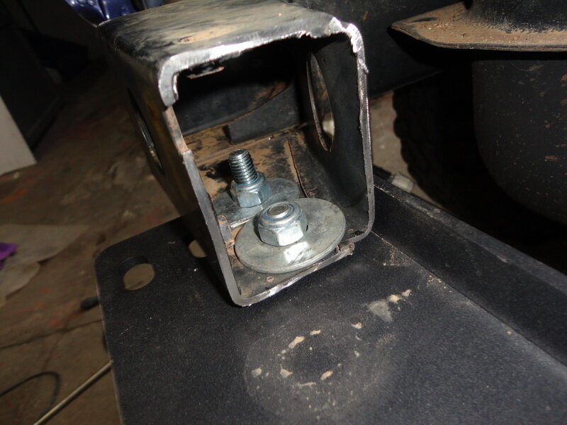

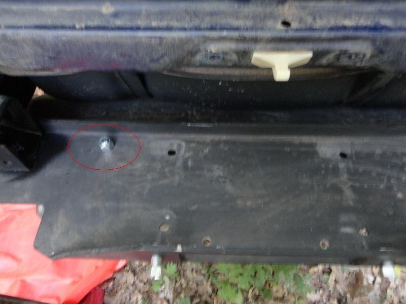

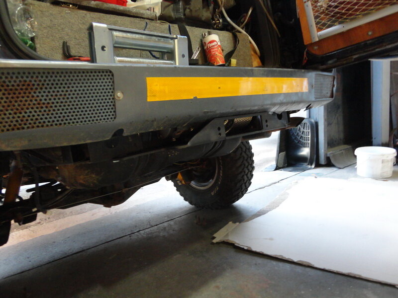

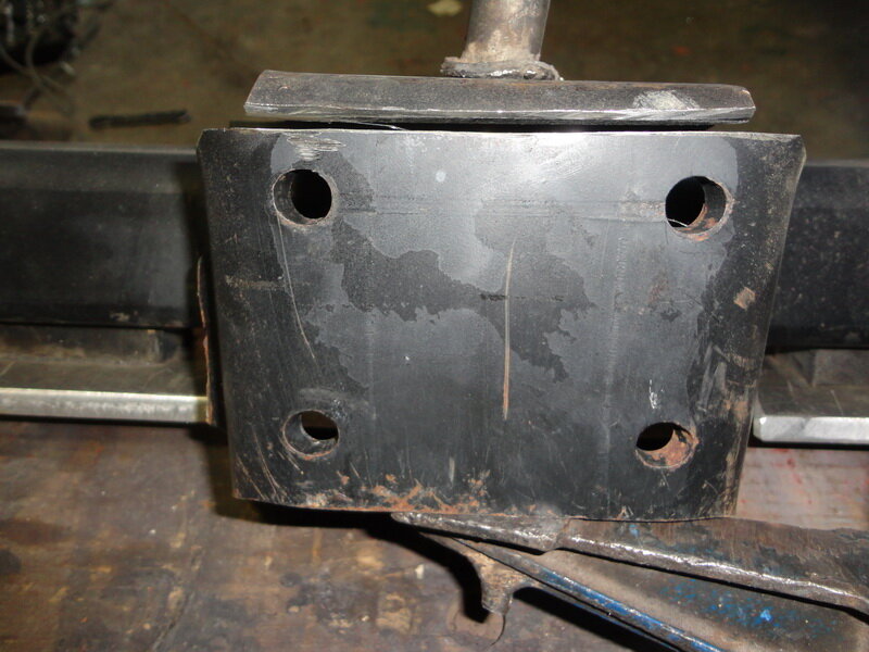

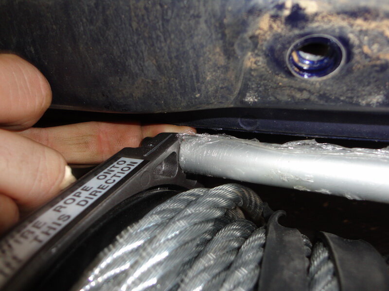

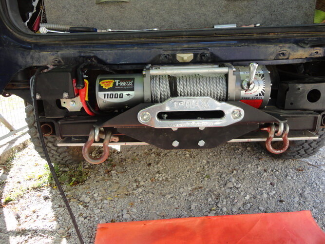

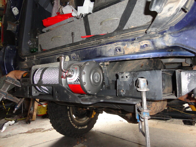

..one support angle reinforced the support base and fast everything..
4 hours job ...
5 cm body lift helped all this prosedure...

Love your work there Chris. New territory for Prado winch installation. I'd like to see it with the bumper replaced over it. Don't think that 11,000 lbs was completely necessary :think: but lovely job. Now you just need a plasma rope so that you can throw that horrible wire in the skip
Chris
chris i dont like the plasma rope..
cause of this..
[youtube:sqrihs2n]9Q0QaGaLLcg[/youtube:sqrihs2n]
(because i dont care about the load of the car..these cars made to work as an elefant :P :P
the 11.000 lbs it was a choice with many benefits..
first of all i believe that a warn XP 9.500 -that i use to my front bumper- is more expensive (1100 euro ,2 years ago) and more strong, compare with T-max 9.500 lbs.. (450 euro)
and also T-max 9.500 , 11.000 , 12.000 had the same outer dimensions and the price is 400 euro , 450 euro , 500 euro)
so ...i choose this ..maybe for one pull per year..when i am alone without other car..
the bumper matches perfectly and no need to cut anything..(if you dont use a roller fairlead)
the only "problem" is i want to replace the aluminum fairlead (the use is for rope only) with a steel one..and its difficult to find..
the next step is to replace the rear plastic bumber with a steel one..
