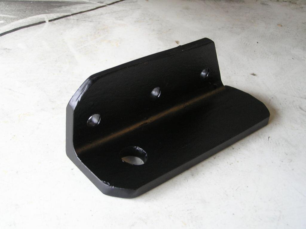

I did the same on my 80. Bolted to existing threaded holes in the chassis rails with three 12.9 high tensile cap head bolts. Probably the easiest and quickest way to do it.
