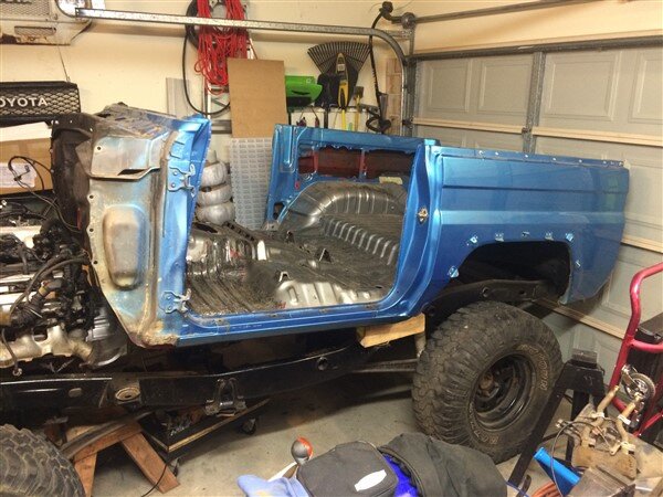

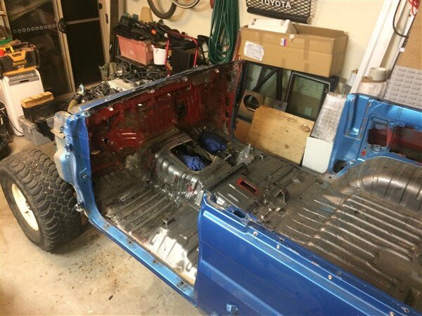

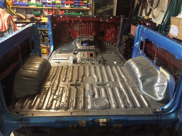

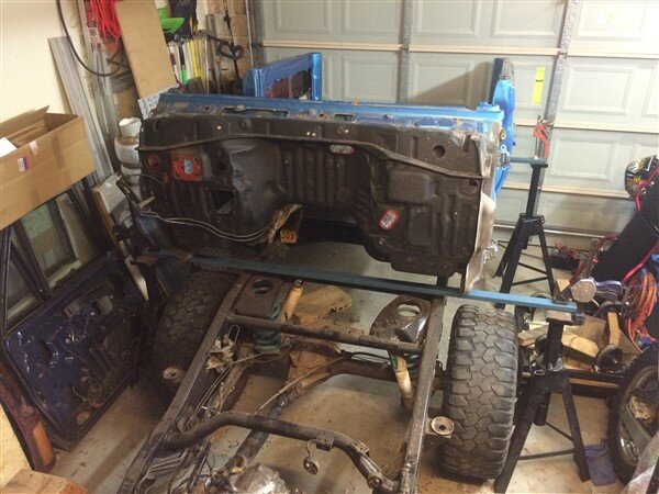

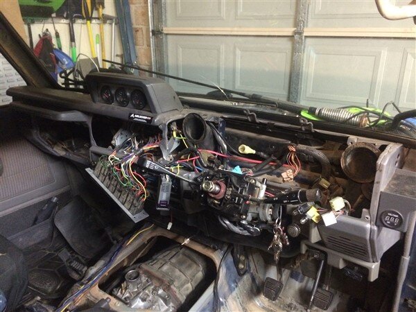

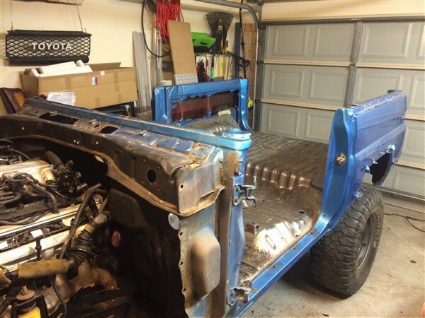

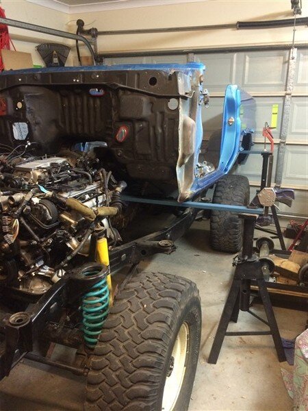

Last night I stripped the dash and the rest of the interior out of the soft top body.

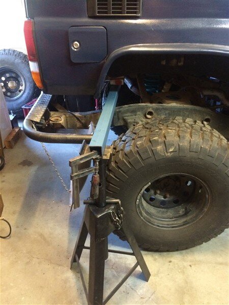

Started lifting and jacking the body up.
Got it supported on some 2" x 1" steel box section and my big chassis stands.
I could then push the chassis out from under it.

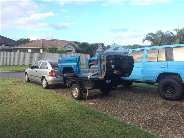

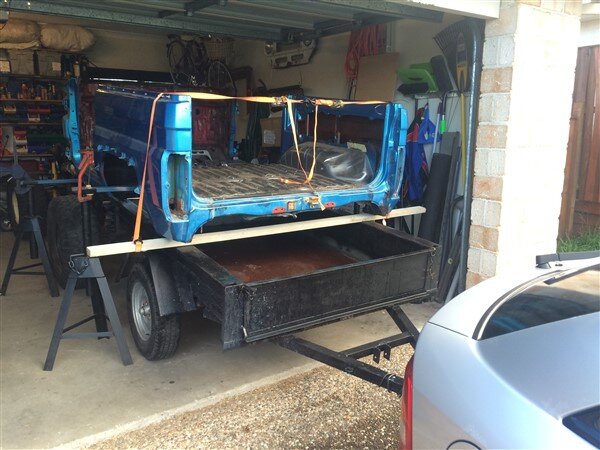

This morning I was out in the garage at 6am ready to start a huge 12 hour day working on the LandCruisers.
I reversed the trailer under the body.
Slid the body onto the trailer and towed it out.

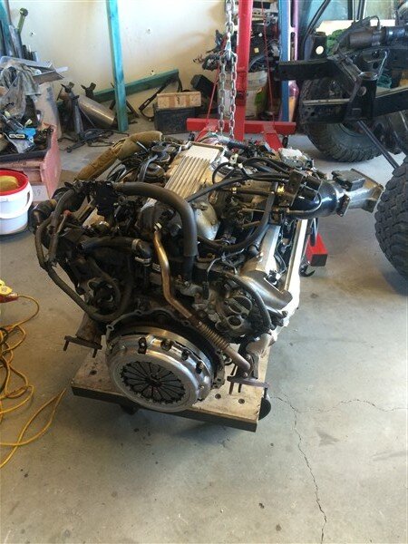

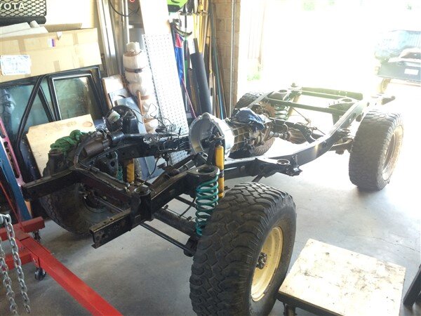

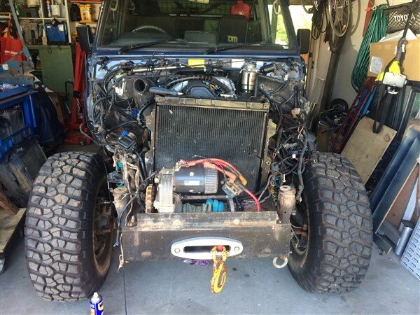

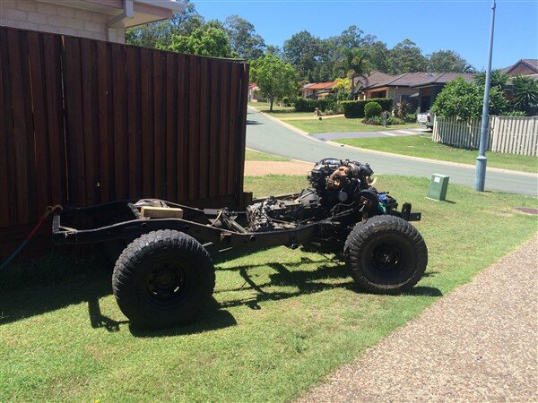

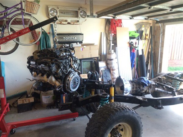

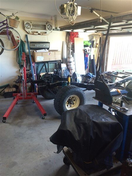

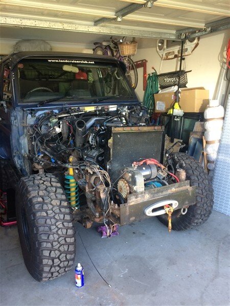

Then it was time to pull the V8 out of RJ's chassis.
By 7:30am the engine was out.
Put the V8 on a trolley.
Put a cover over it and moved it out of the way.
Back to RJ's chassis.

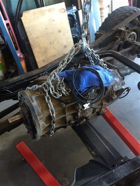

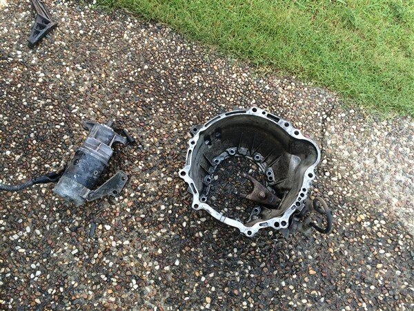

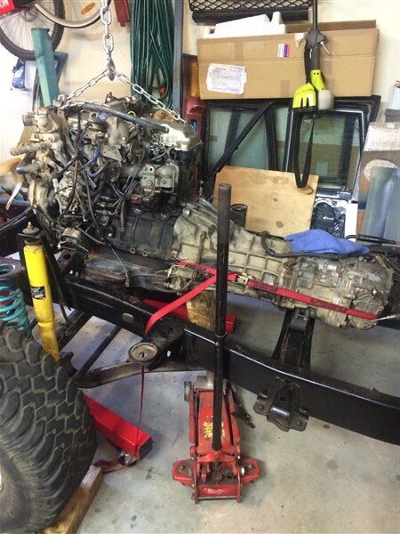

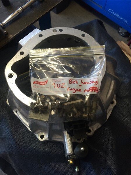

Pulled the bell housing off.

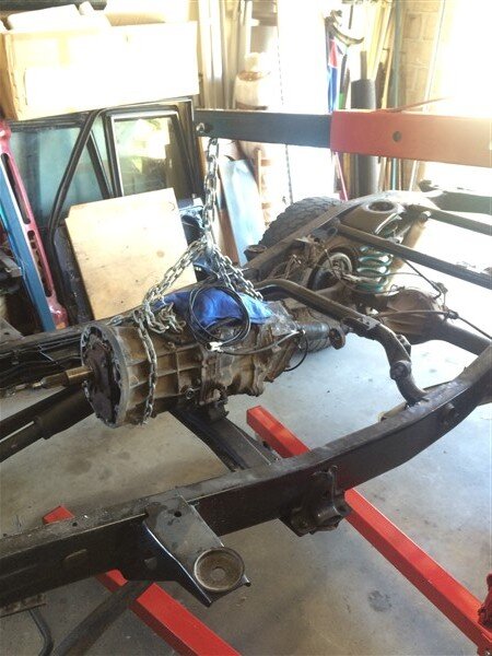

Supported the gearbox/transferbox with the engine crane.

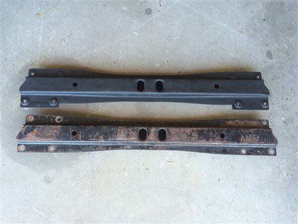

So I could swap my modified cross member for a standard one.

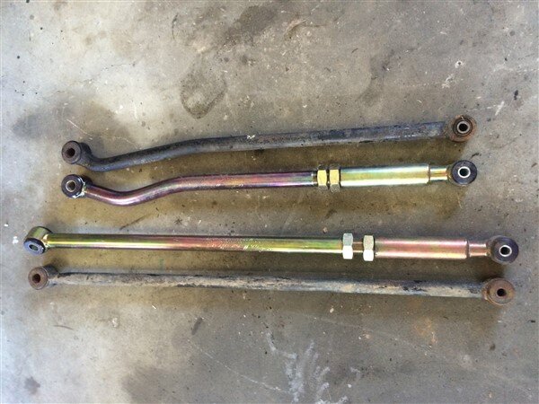

RJ came with Superior Engineering adjustable panhard rods, which I will be keeping for my other LandCruisers so I needed to fit some standard ones.

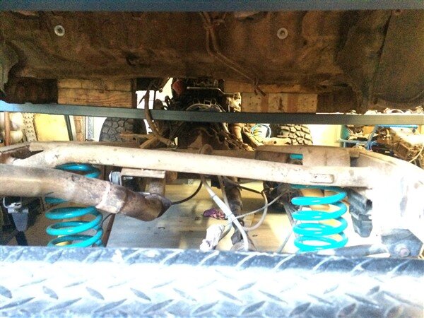

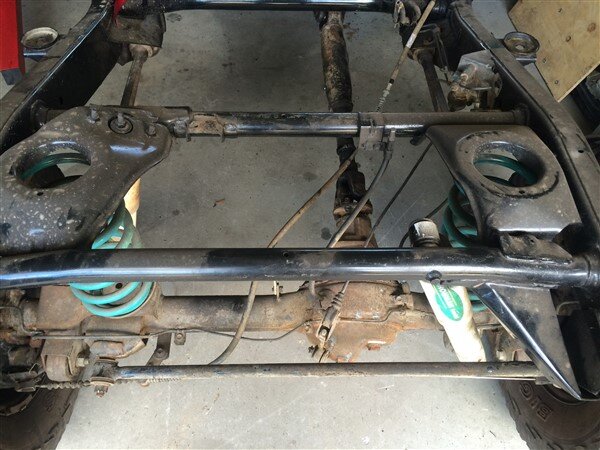

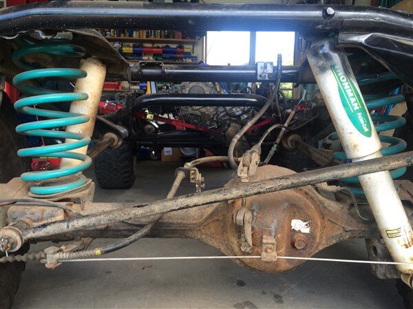

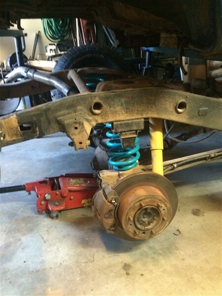

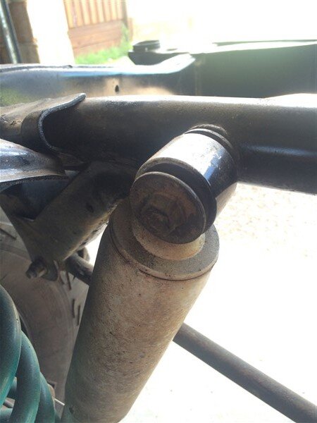

With the body removed you get a clear view of the unusual rear suspension design.
I'm not sure what Toyota were thinking designing a system with 2 completely different shocks, on different angles with different top mounts. :wtf:
But we will let them off as this was their first ever coil sprung 4wd! :shifty:

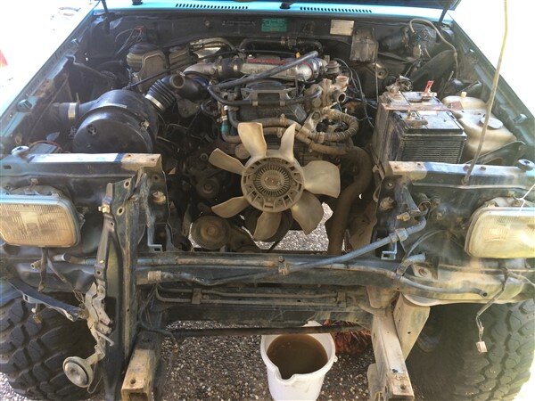

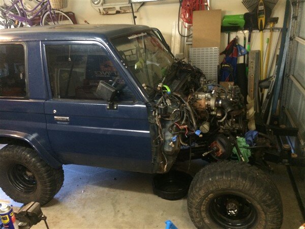

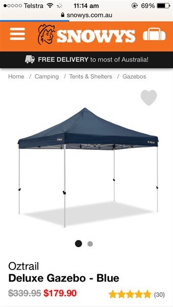

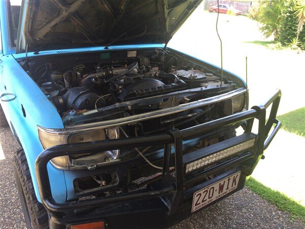

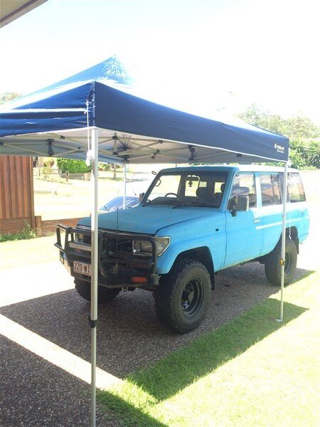

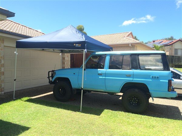

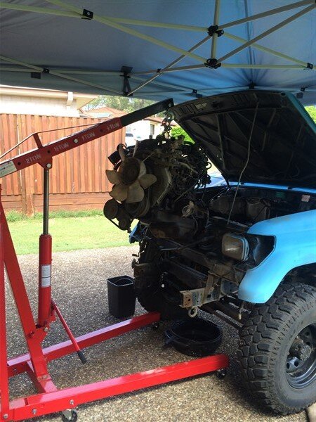

Next it was time to pull the engine out of the 78, but first I needed to get some shade from the hot summer Queensland sun! :think:
A quick look online for the cheapest price of a good quality pop up gazebo.
Followed by a trip to my local BCF and I got this.
And a nice saving as they price match any online price! :dance:
Perfect! :icon-cool:

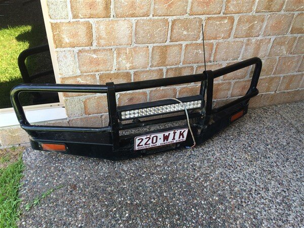

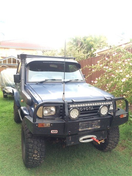

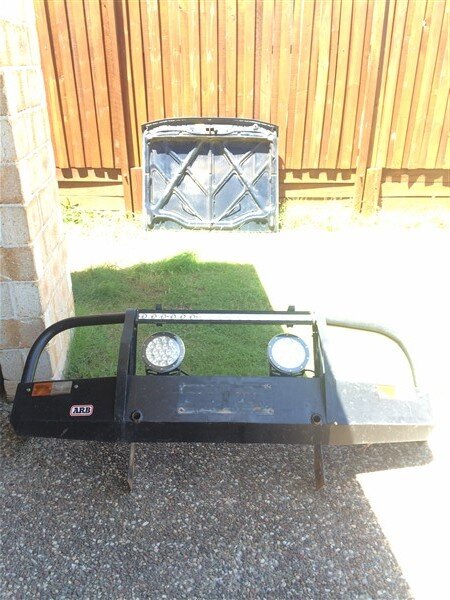

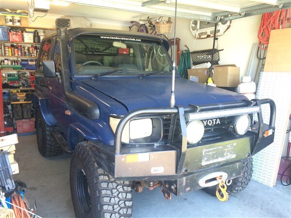

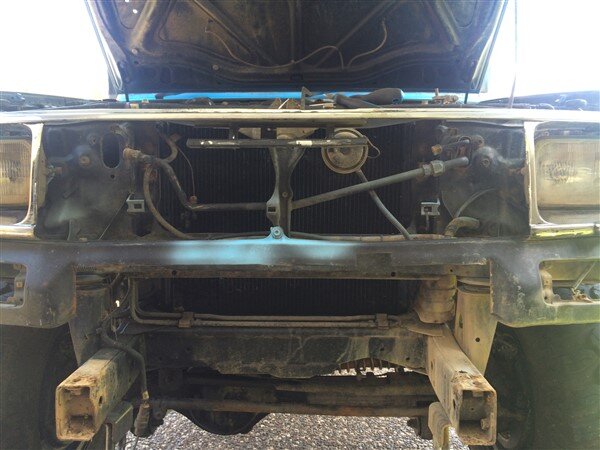

Started removing the bullbar.

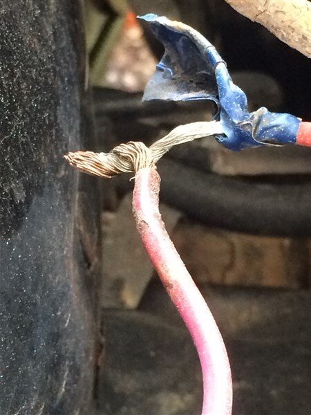

Whoever messed with this car shouldnt be allowed anywhere near any automobile! :icon-rolleyes:

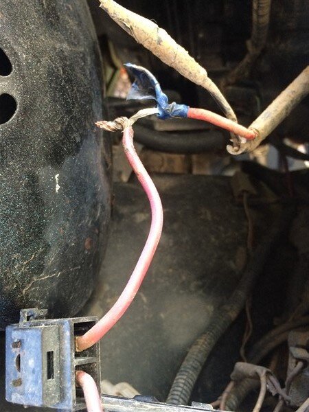

Twisted wires together to connect the light bar. :doh:
All after market wiring will be getting pulled out and I will rewire everything properly.

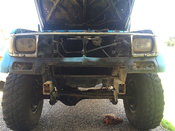

Bullbar off.

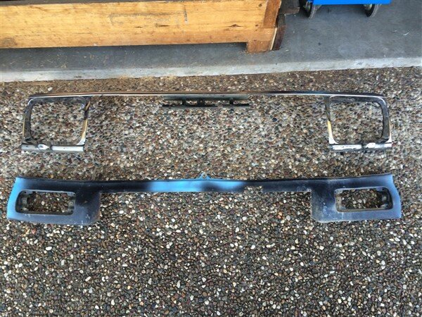

Badly butchered grill and bottom panel.
Pulled them off and they will be going in the bin.
Drained the rad.
Rad out.

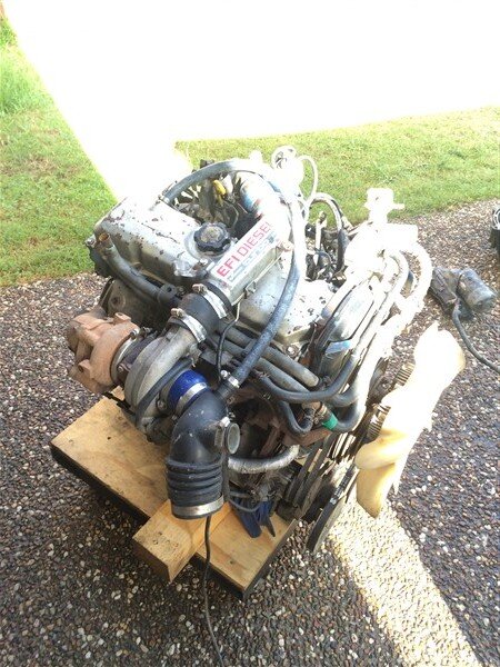

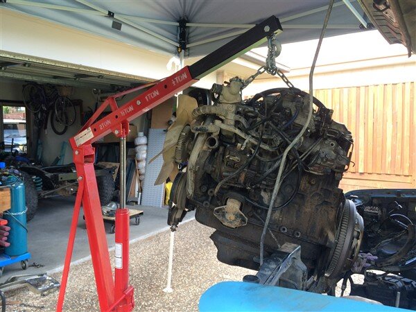

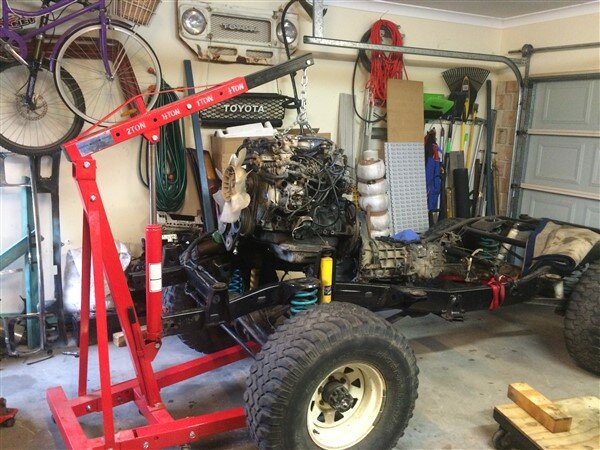

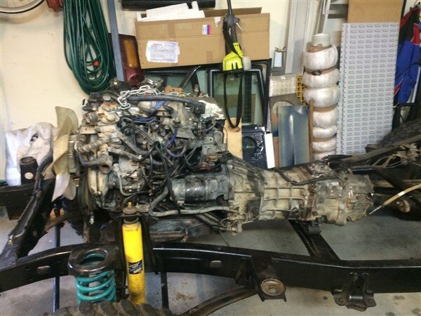

After a few hours removing bolts and disconnecting everything it was time to pull the engine out.
Got the engine on trolley.
Its got a major oil leak and I suspect it is coming from the rocker cover judging by the amount of silicon everywhere, that and the cracked oil cap.
Gave it a good degrease and pressure clean.
As well as the starter and bell housing.

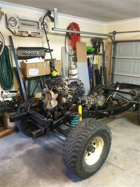

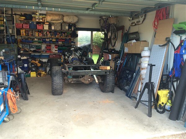

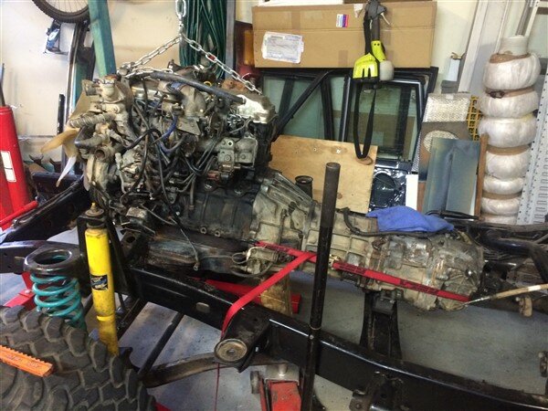

Then it was back into the garage to fit the engine into RJ's chassis.
It proved difficult to get the bell housing to pull up against the engine so a ratchet strap was needed.
And thats where I'm up to.

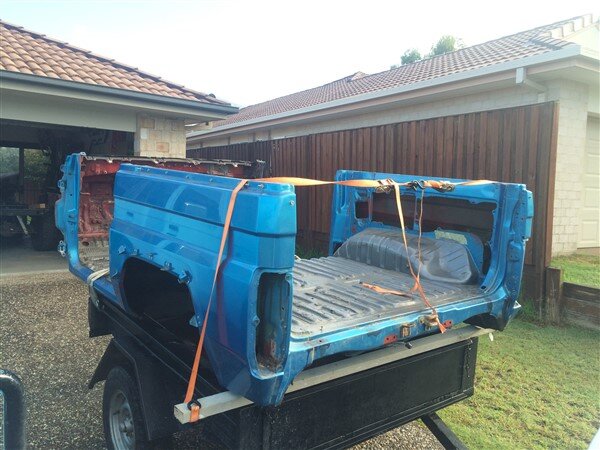

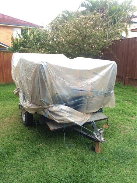

RJ's old body is in the garden wrapped in a tarp waiting to go off to the sand blaster.

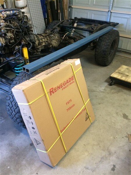

Picked up some steel and a fan.
Nice big industrial fan to keep me cool.

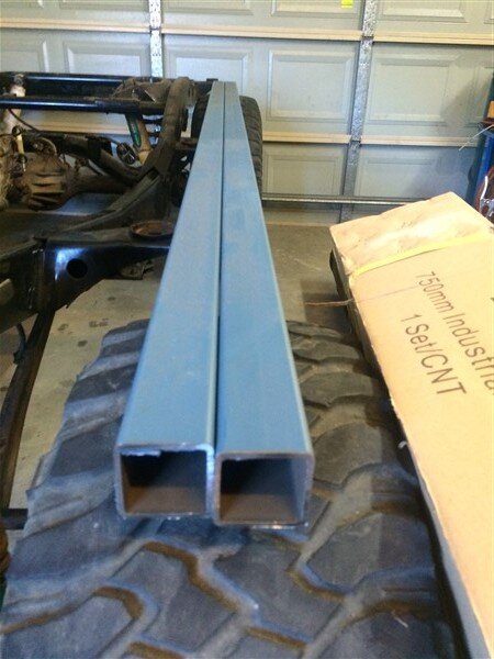

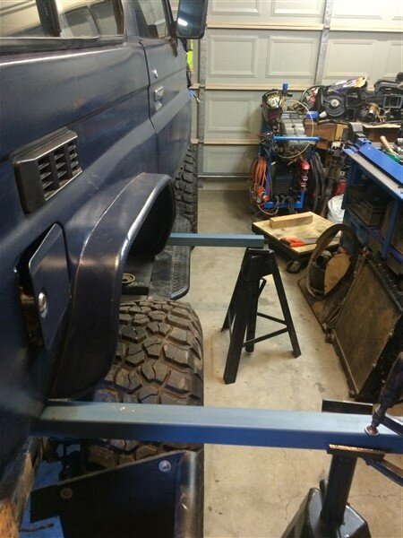

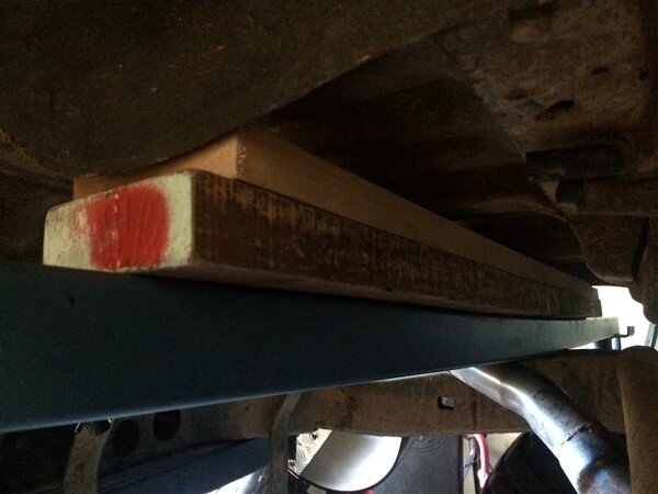

And some 50mm x 50mm x 3mm steel box section to use as bearers under the body while I swap chassis, these will then be used when I build some rock sliders/side steps for the 78.

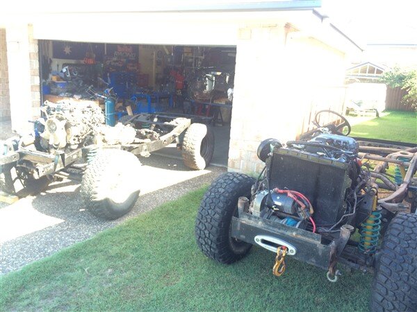

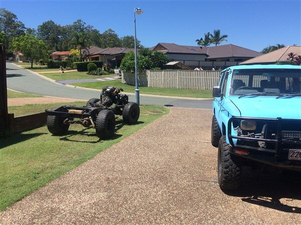

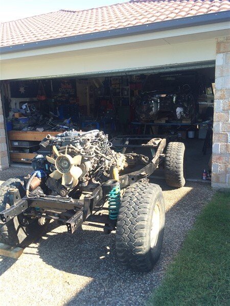

Pushed RJ's chassis outside and used LJ's winch to help drag the RJ's chassis around as it was facing the wrong way. Then I could get LJ into the garage.

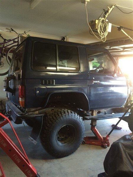

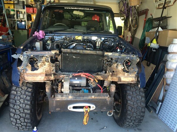

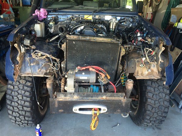

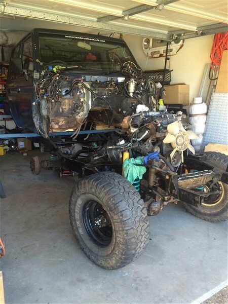

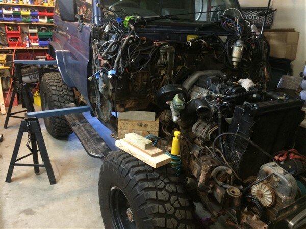

Got LJ in and began stripping down the front end.

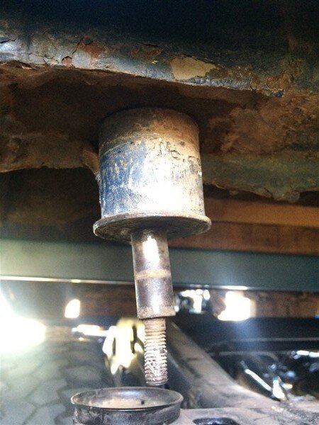

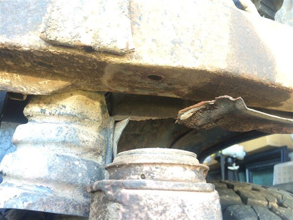

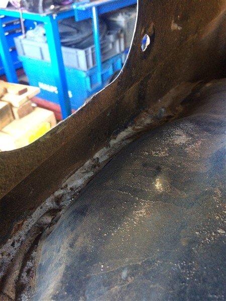

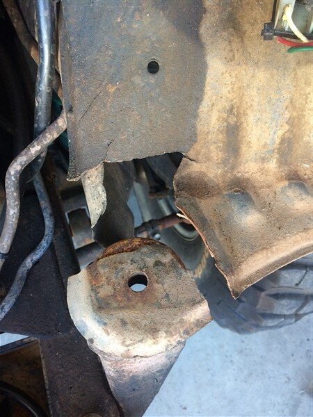

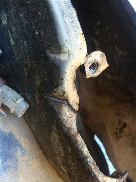

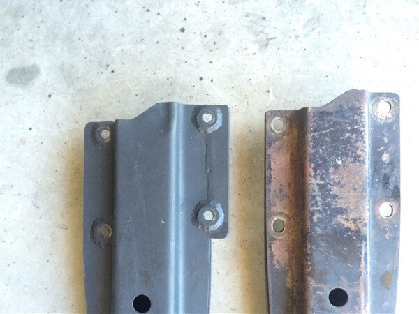

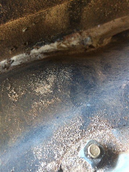

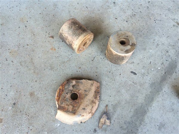

Without a doubt the worst modification I ever made to LJ was fitting a body lift! :thumbdown:
It puts too much strain on the body as its no longer properly supported and with all the off road driving and corrugations it had done some damage. :doh:
This front body mount had been torn completely off the inner wheel arch.
And a few cracks.
I'm not sure how much beach driving I want to do in future either as sand has gotten everywhere, despite never getting stuck or driving aggressively. :wtf:
It took the rest of the day to finish stripping LJ and undo all the body mounts.

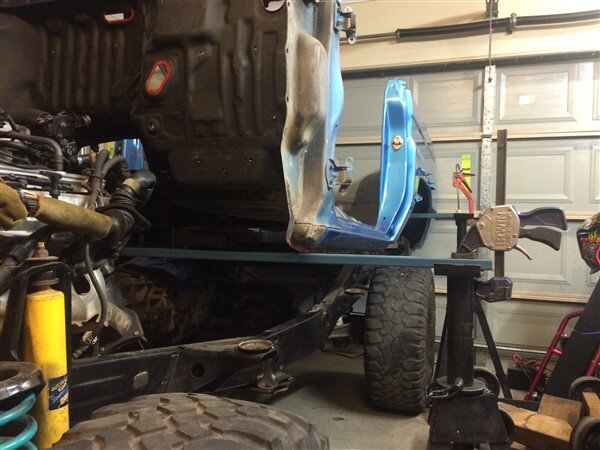

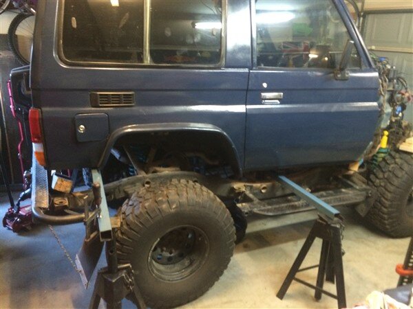

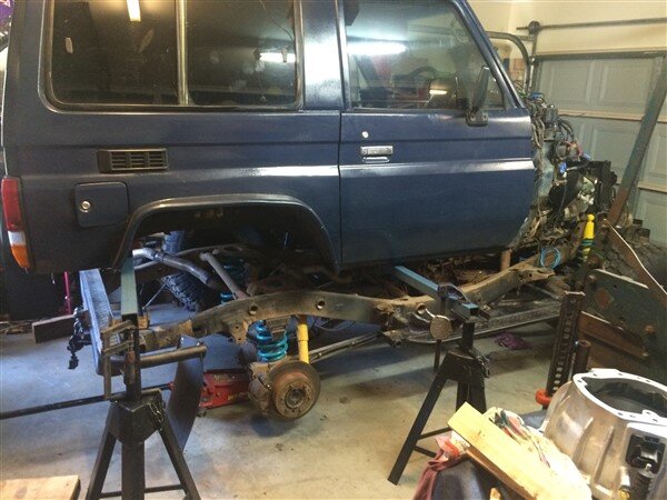

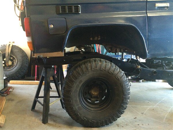

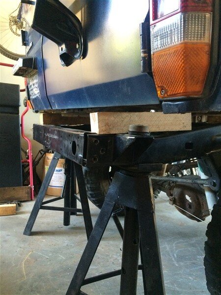

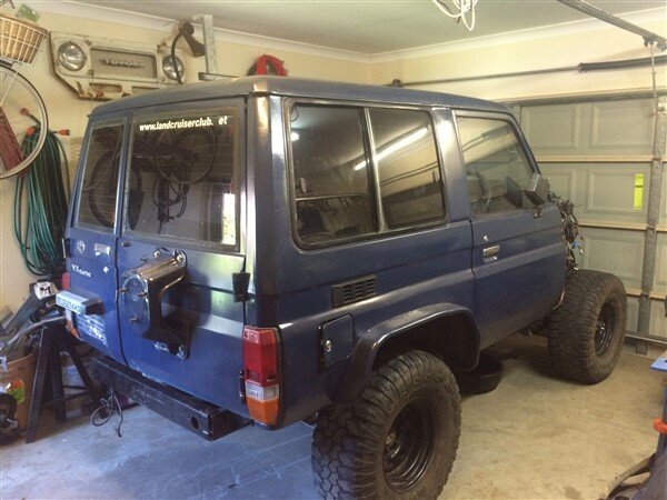

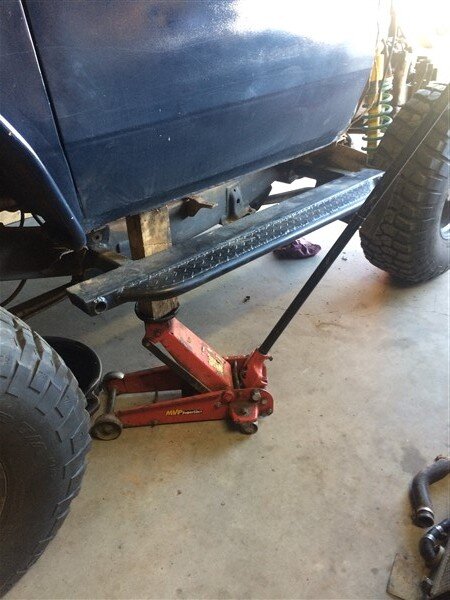

Sunday morning, bright and early I began jacking the body up.

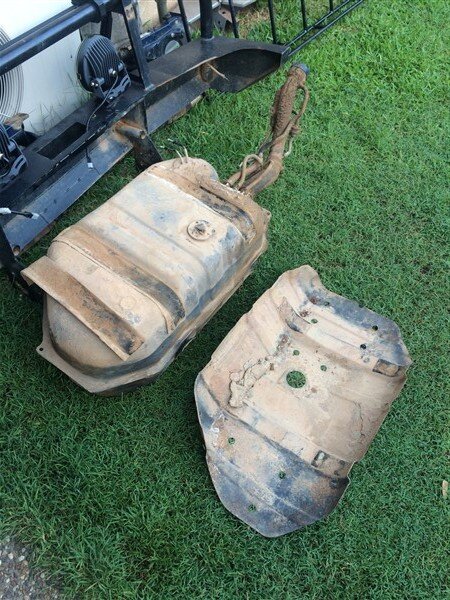

It soon became apparent that I really needed to drop the fuel tank as its mounted to the body, leaving it on would have meant having to lift the body really high.

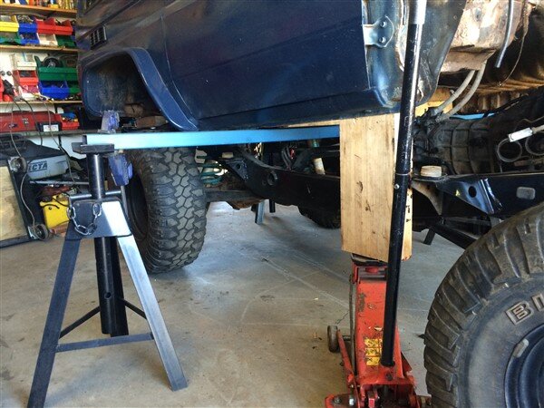

It was then just a case of jacking it up bit by bit and putting blocks of wood between the chassis and the body until it was high enough to get the steels in place.
If I had had 2 trolley jacks and could have jacked the whole body up at the same time with a jack each side it would have been a lot safer and easier. :think:
I'm not going to lie, it was quite a worry at times that the whole thing could come crashing down, possible on top of me. :shifty:

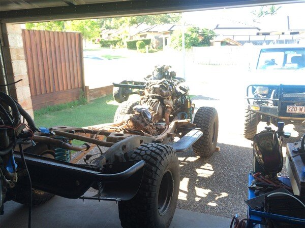

Eventually it was jacked high enough and I decided as the rear of the chassis slopes up, that I should remove the rear wheels and push the chassis out with the back end lowered.
And shes out! :dance:
With the chassis out I put the back wheels back on.
I then had to push the chassis's up and down the sloping drive on my own.

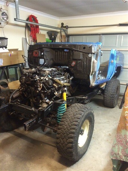

I could then push RJ's chassis under LJ's body.
Before I could lower the body back down I had a few things to fix up.

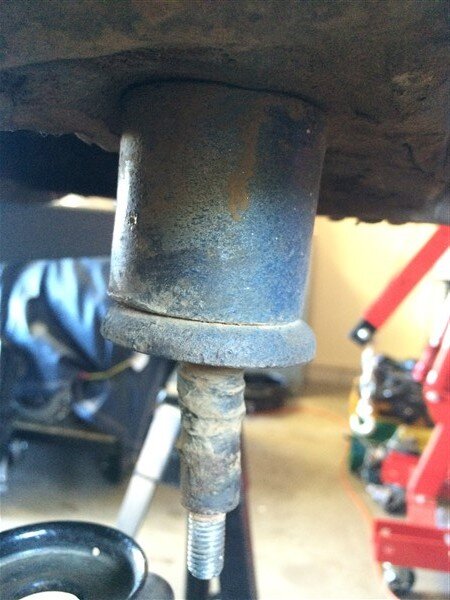

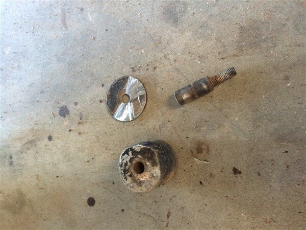

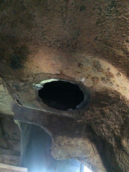

One body lift spacer (with a rubber on top of it) had been pushed through the body.
And both rear spacers had chemically bonded the alluminium spacer blocks to the steel bolts.
The 2 rear spacers got cut off.
Did I mention I hate body lifts? :angry-screaming:
Never fitting them to any of my vehicles ever again! :eusa-naughty:
Lowered the body back down using the jack and blocks of wood again.
The body is now fully fitted and bolted in position! :dance:

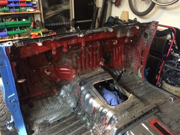

Now I could begin swapping all the good bits off LJ's body with all the spare parts that I dont want to keep. The idea being I will end up with all the good bits on my other 2 and can sell off all the other bits on RJ. :shifty:

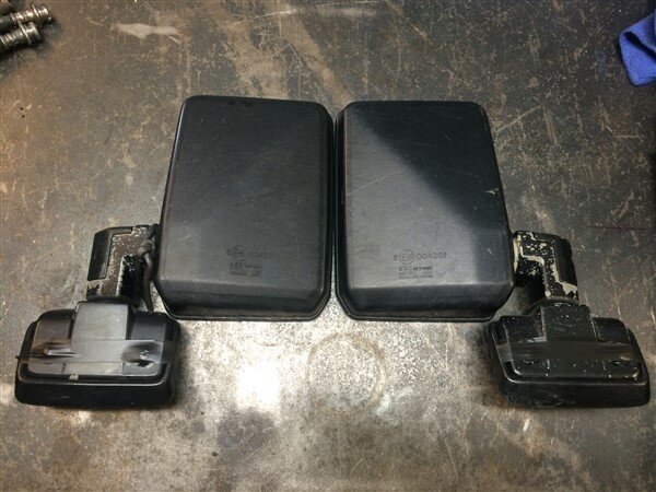

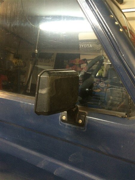

Swapped the mirrors for the older style small ones.
And began pulling the interior out ready to swap it all.
Dash, door cards, seats, center console, heater matrix, aircon, peddles, hand brake, gear sticks, everything is coming out and being swapped for the older RJ parts.

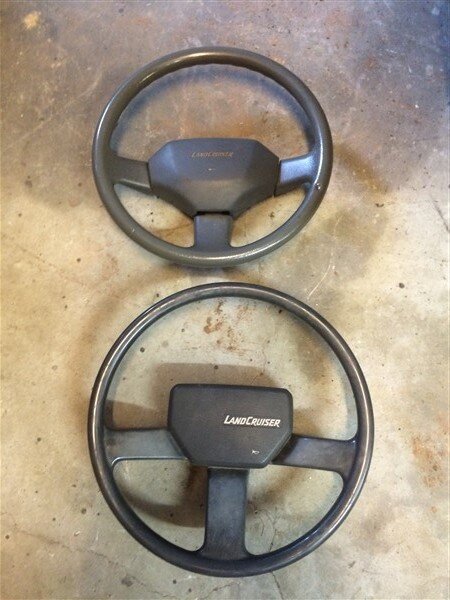

Even the steering wheel is getting swapped.
