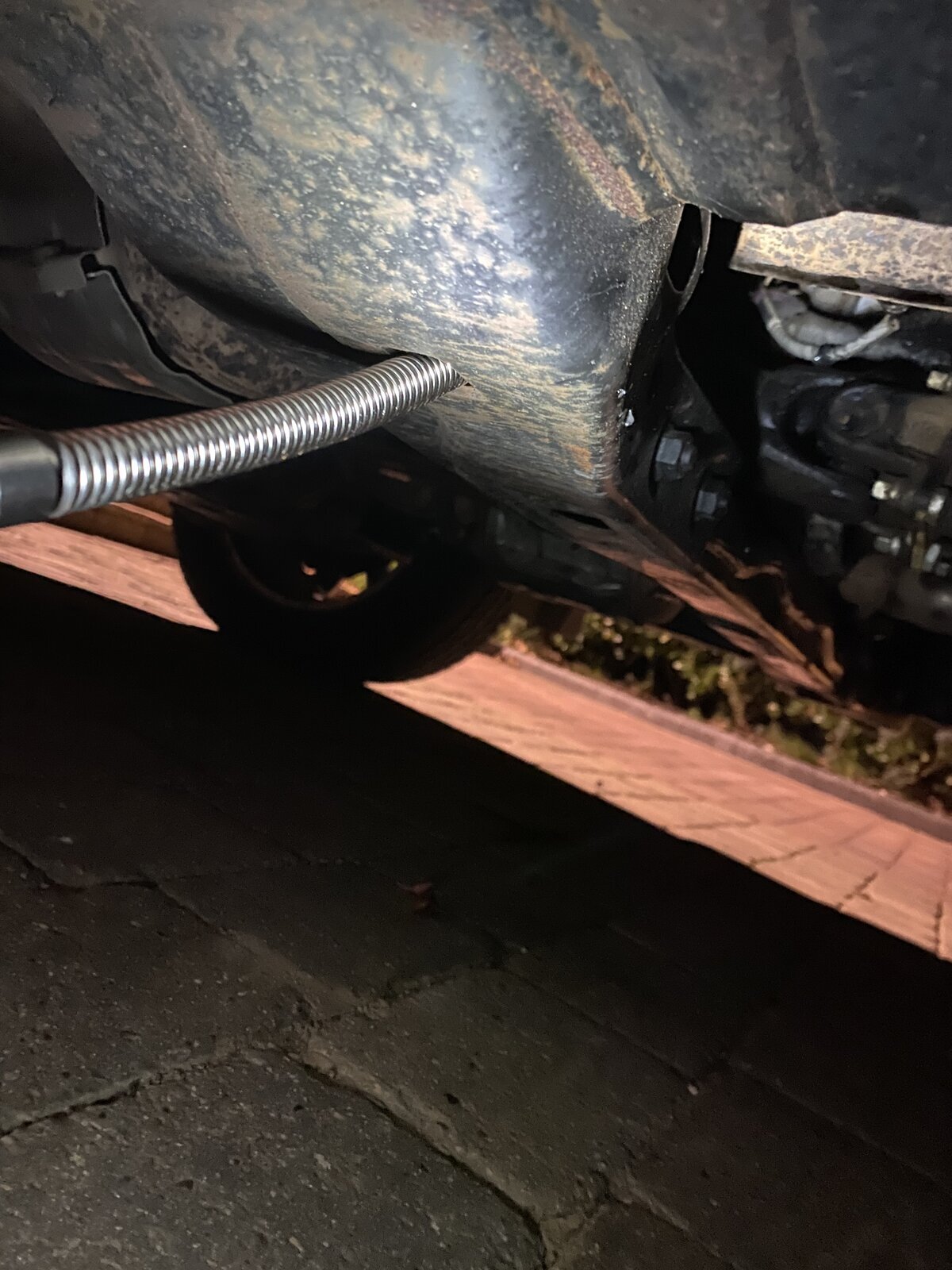

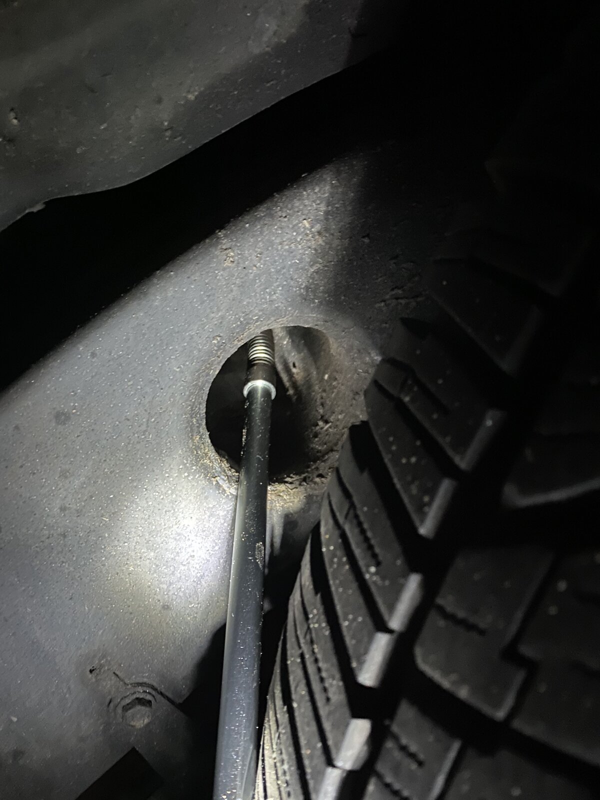

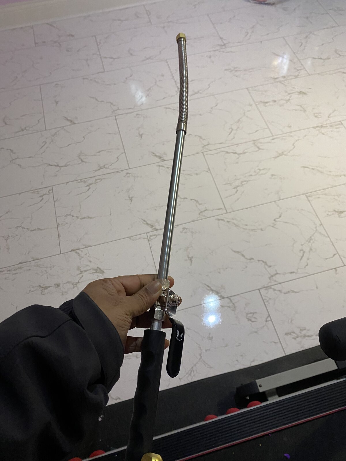

I finally got one hose extension that could go inside lot of holes on chasis. Hopefully this will clean a lot of chasis frame before next Krown treatment.

That looks good. I stuck a hose pipe in mine and let the water flow for ages to clean it all out. Make sure the water has somewhere to go, you can see it getting cleaner inside when the water runs out clear. Once I did that and dried it all out I painted the inside, before lanoguarding the lot.
Finally tested this hose extension. It was really good one as I managed to get water into small holes of chasis. There was lot of hard mud inside chasis and it took a while to flush it out. It looks like its moving from rear to front as I was using water pressure so had to move from rear to front many times and use long nail to unblock and move stuff. Only managed to do passenger side of chasis today. With all this mud inside blocking chasis, Krown wouldn't have spread inside chasis properly.
Where the he'll does all this mud keep coming from Raj, you doing muck away or sommat?
I thought Krown were supposed to do all the cleaning before application ?
Have you tried just the front up, just the back up when you're power flushing, might encourage more out of the chassis holes. IIRC the ends of the chassis rails have plates welded over the ends, so you won't get any out of there.

On Sunday I tried watering by lifting only one side and also attached a small silicon rubber tube to hose extension and pumped water into smallest holes of chasis. I am sure it’s 90% clean. Now ordered a snake camera to look inside.
