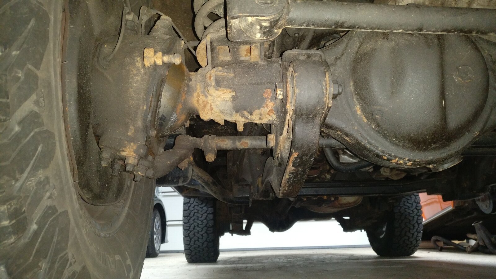

Hi folks,
Just thought I'd provide my experience with lanoguard.
I have been using the spray on lanoguard for almost two years now and spraying the underside every 6 months October and March when I service the cruiser. I normally use the Moto spray but I've used chassis guard with glass flakes in Shultz cans previously and sprayed directly on top of Granville rust converter. The photo is from today and considering everything was topped up in October, I'm not that impressed and it's something I've been noticing that each time I'm topping up, more work is needed so it's getting too labour intensive. I reckon it's just too thin a product and washes off but i have had good results with the grease and Moto spray in and around the engine bay and using the grease on bolts and brackets.

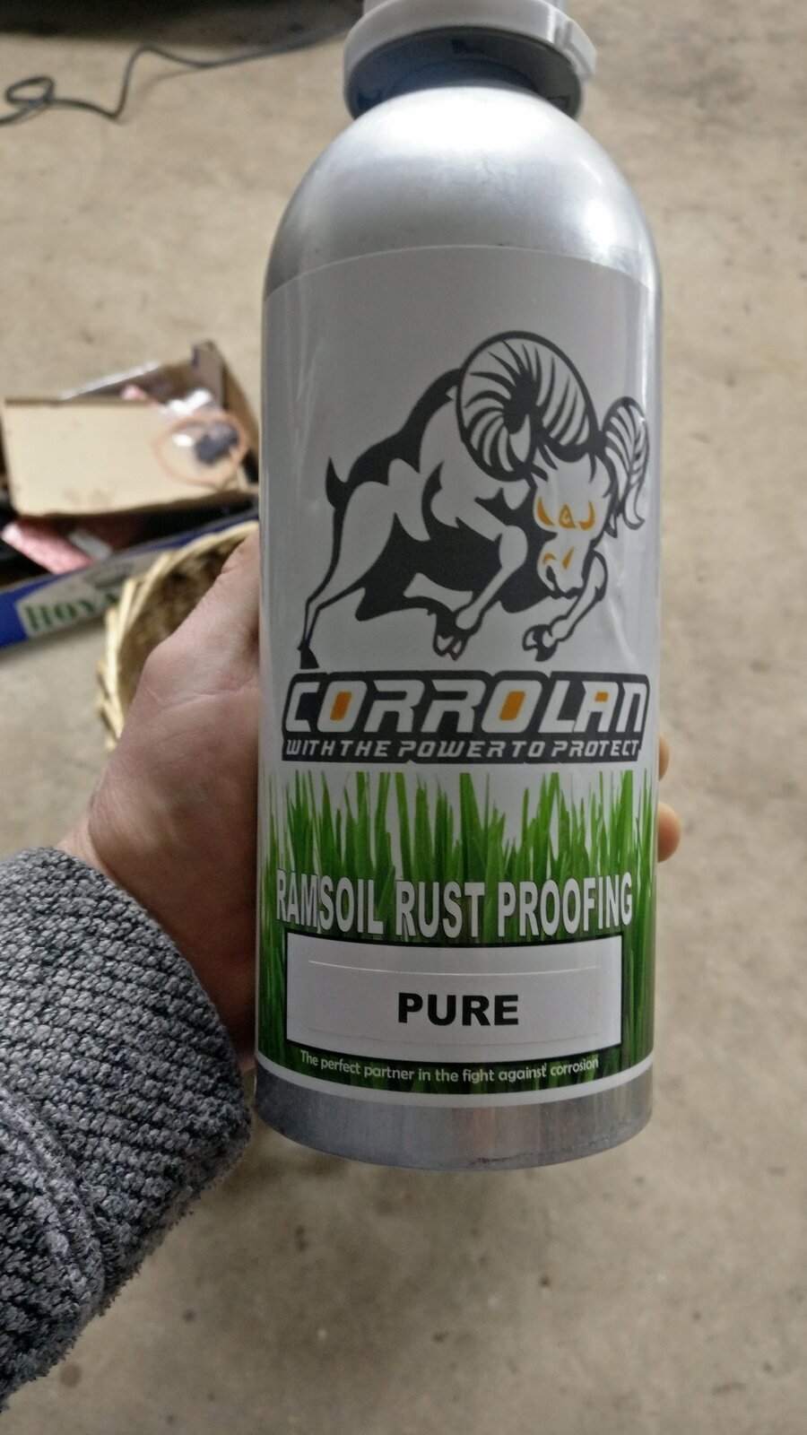

So, I'm going to give Corrolan a go as it's still a lanolin based product but more like a thick wax. As usual, everything orange underneath will get a wire brush and rust converter first then spray on the corrolan.
Couple of things to note, it doesn't smell like sheep's piss like lanoguard and it's around £11 plus vat for a litre. It will need thoroughly heating up on a stove or something before spraying as it's a thick wax at room temp and it's not clear like lanoguard but a sort of light brown colour.
Anyways, this is just my experience. The car originally had the full dinitrol treatment 3 years ago when I brought it into the UK but this needed attention in areas after one Scottish winter lol. I'll update once ive sprayed this stuff on with pics and see how it lasts.
Mike
