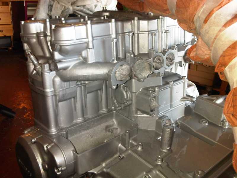

Our engines don't get hot enough to cure most vht paint , I took in too much info to be specific but i read somewhere hammerite is good to 600 whatever i think .
Ed,
I can guarantee Smooth Hammerite is the best.
I have tried & tested EVERYTHING & it comes out top every time. It also goes on good & thick.
Make sure you warm the can up in hot water for 20 minutes before spraying.........makes a lot of difference.
The secret with any paint is the preparation so as long as the metal is good & clean, it will last at least 10 years.
I have done every 1300 engine I gave owned with it including the current one.
Funny as it is, the Hammerite Factory is in the village I live in too !
Pete F
