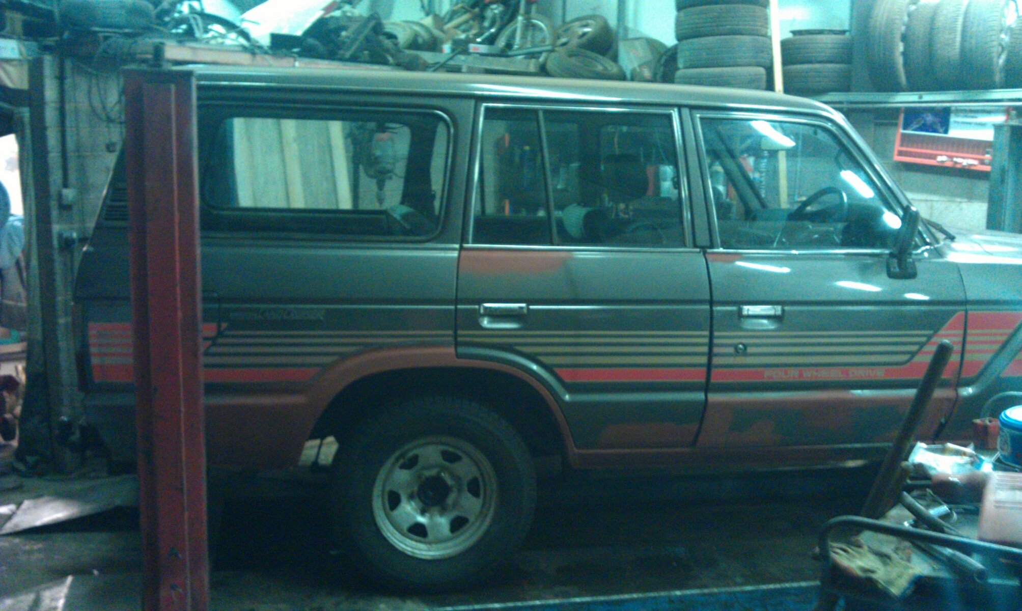

I borrowed my friends ramp to do the brakes and with no time to try the freshly installed and bled brakes or bed them in i decided to put it on axle stands on the ramp, put the 4wd on and lock the hubs and ran it for ten mins with my foot lightly on the brakes to bed all the disks and pads in. Worked a treat..
This is the last pic i took before the MOT 1.15am yesterday morning. Anyway with it being sat tomorrow, im going to run the fuel lines to the eberspacher tomorrow and have more of a play and take some fresh pics outside

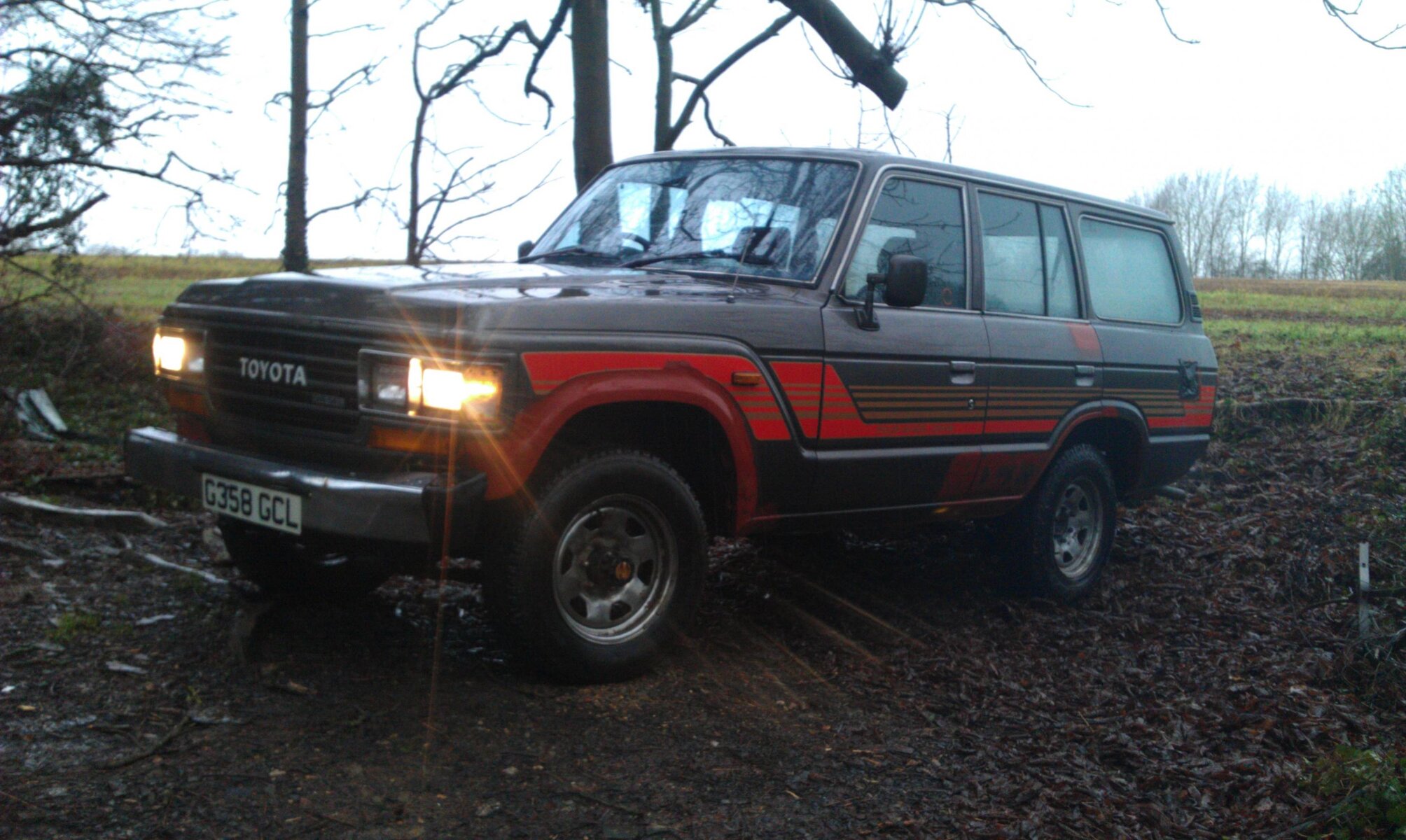

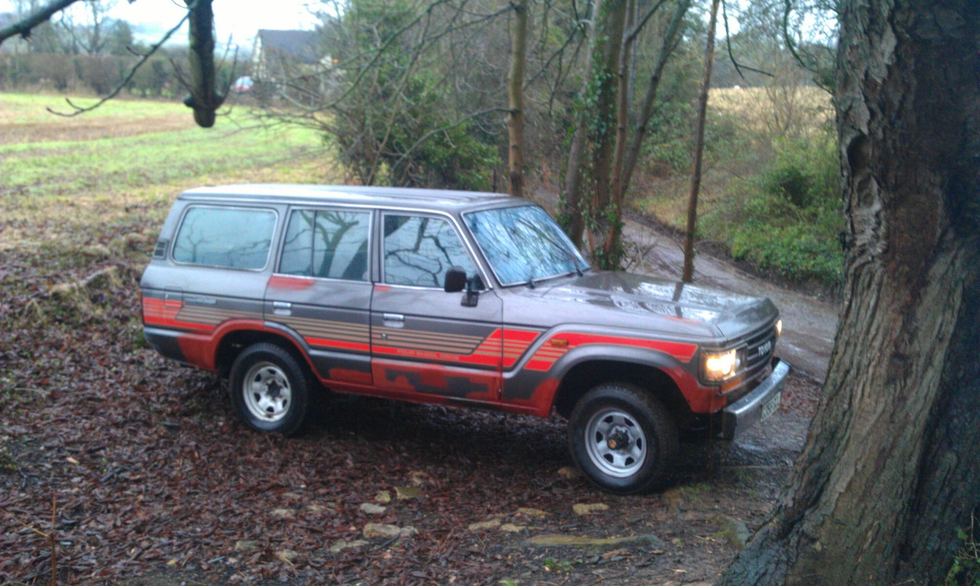

Took a couple of shots today, still a few bits of welding to finish off, door, under the front light but its mostly done. Old bent bumper went back on so no sharp edges

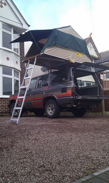

On Sat i made a couple of temporary brackets for the roof tent so we could use it over the break, i will replace with a full length roof rack soon enough i hope..
Quick Christmas day checking it out:occasion-xmas:

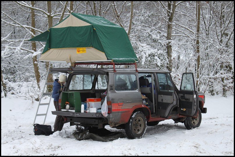

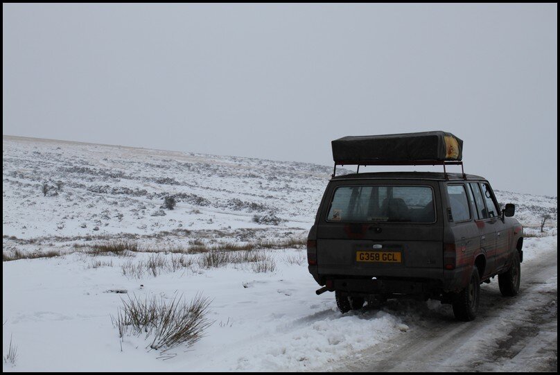

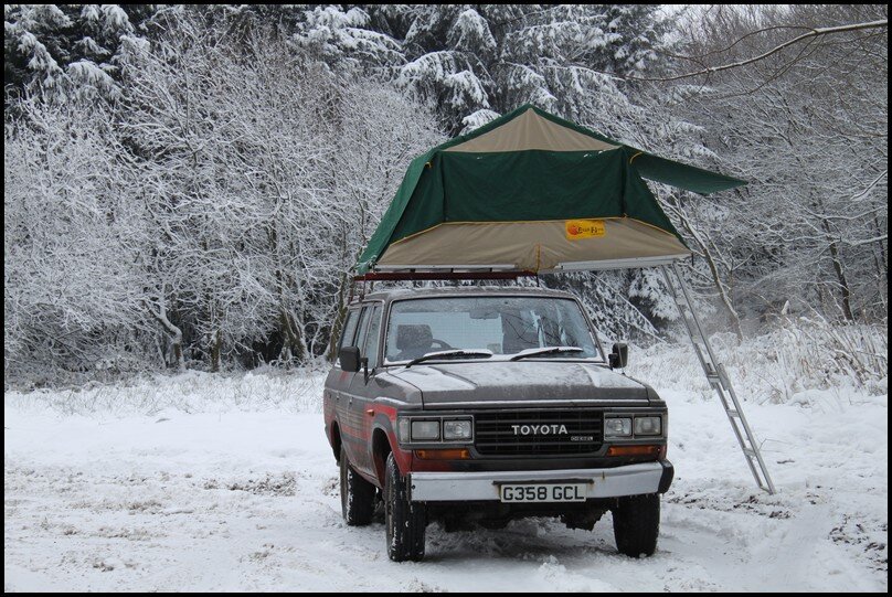

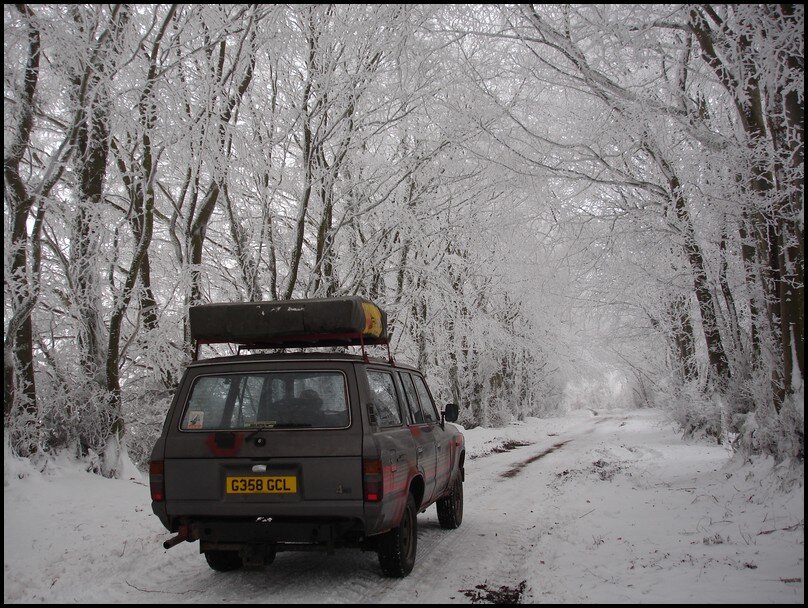

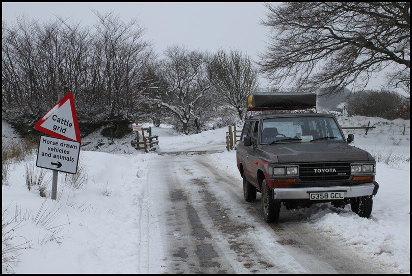

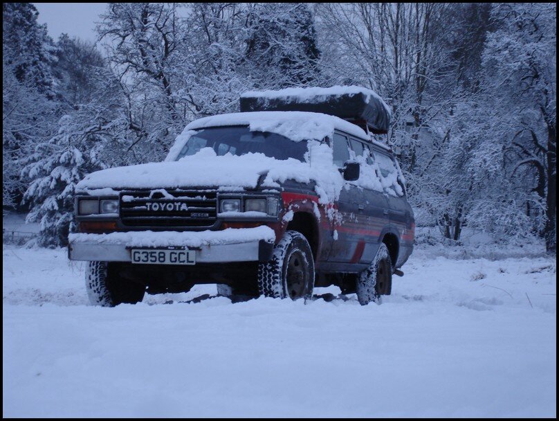

Meanwhile we thought we would get out and use it even more, only way to proove it is to use it!!So while the country collapsed under a tiny bit of snow we decided to head off to Exmoor and go camping:icon-biggrin:.
It was funny, having never had a 4x4 before , no idea what the 60 will do i was taking it extremely easy on the sat. Carefully considering what we went down and if we may be able to get back up. With Exmoor deserted and it still snowing i was really taking it steady... by Sunday i realised that it would pretty much do anything and we took off down and up anything with out too many problems.
Anyway few pics...
Not sure how cold it was but i guess around - 5 and to be honest we were warm up there..A 2 litre bottle of water froze almost solid over night IMG_2027.jpg
Breakfast in the basic setup we have so far

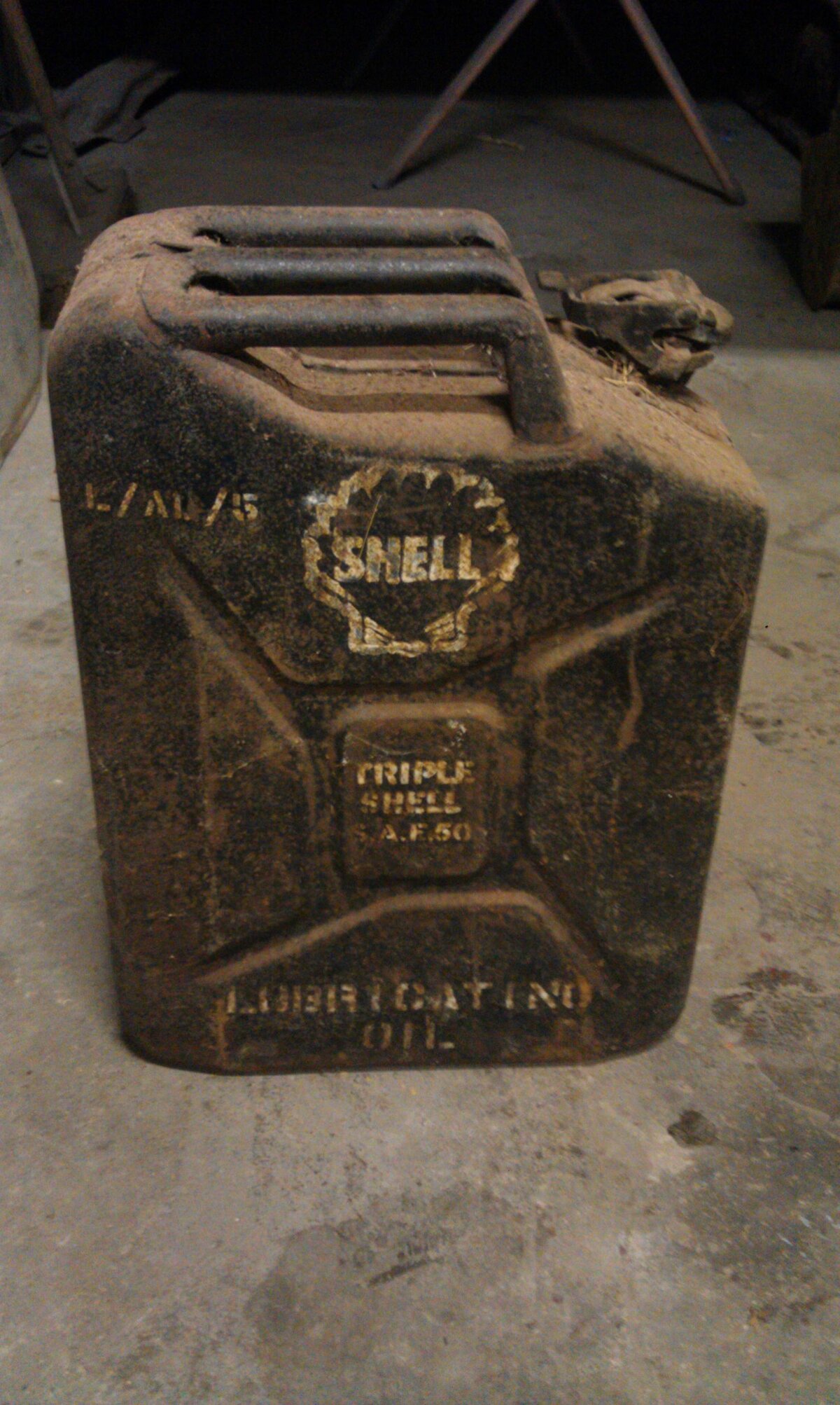

Quick preview of the roof rack im building for our stuff and the roof tent and the "new" 1945 fuel drum some one gave me as i loved those old logos (its not rusty inside)....

Never seen a Shell jerry can before. :icon-cool:
