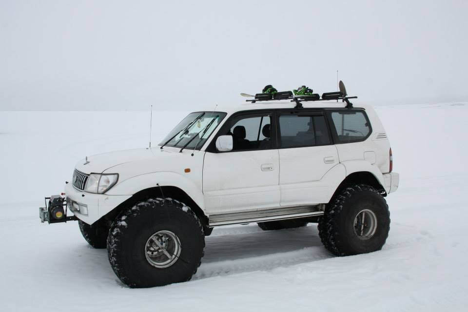

Snow cruiser
jongi
Feb 6, 2015
5
iceland

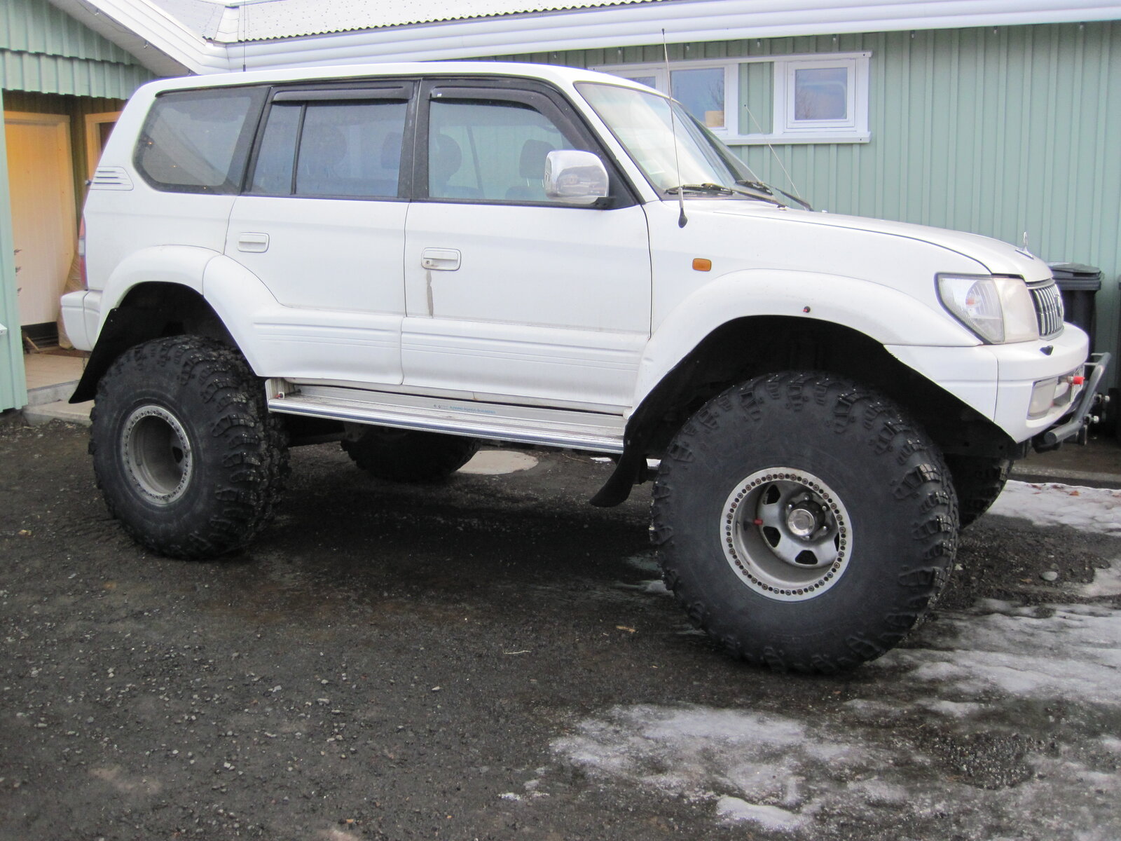

my 90 series
1997 diesel manual transmission
front axle from a 3.3 Nissan patrol w.ARB-lock
Rear is stock Toyota
4.88 diffs
100 mm body lift
OME Springs & shocks
Out side running air deflation pipes
Currently running Iroc 42" (DC44" in pics)
3" exhaust
engine chip
and more to come...

what diameter are the tyres ?
what diff ratios have you fitted ?

Edit: Sorry, welcome to the forum! Where are you from? Oh, and yes, tyres are 44s, but what is the rim size? I always think they look much smaller than stock, but maybe it's an optical illusion as the tyres are so mahOOSIVE!

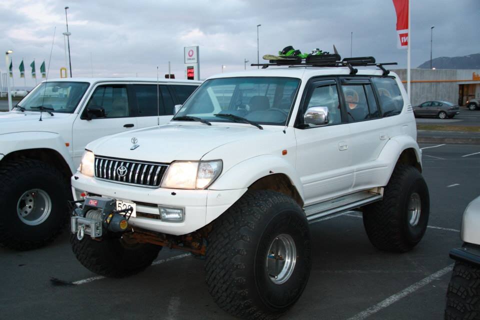

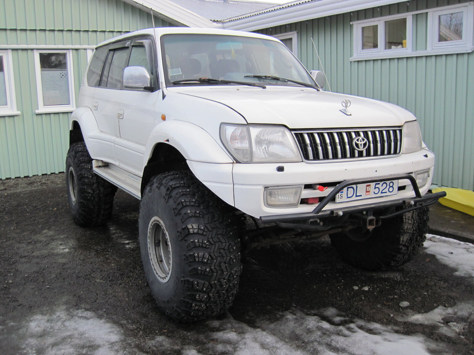

here are some off my current setup
the wheels are Ægir custom build. 16" high, 16" wide, outer bed-lock, 8 mm stamped center, 1/4" pipe valve for fast deflation or inflation.
The bed-lock is there to stop the tires slipping on the rim when running 2 psi for long periods in bad snow.

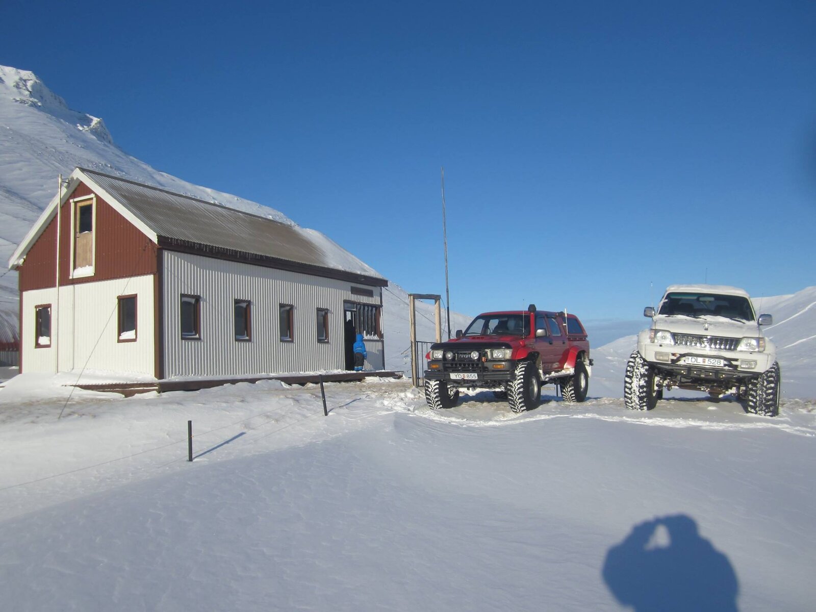

fyrst pic my and my dad´s hilux on "38 ground hawg at old sheep hoarders cabin in skying wally.

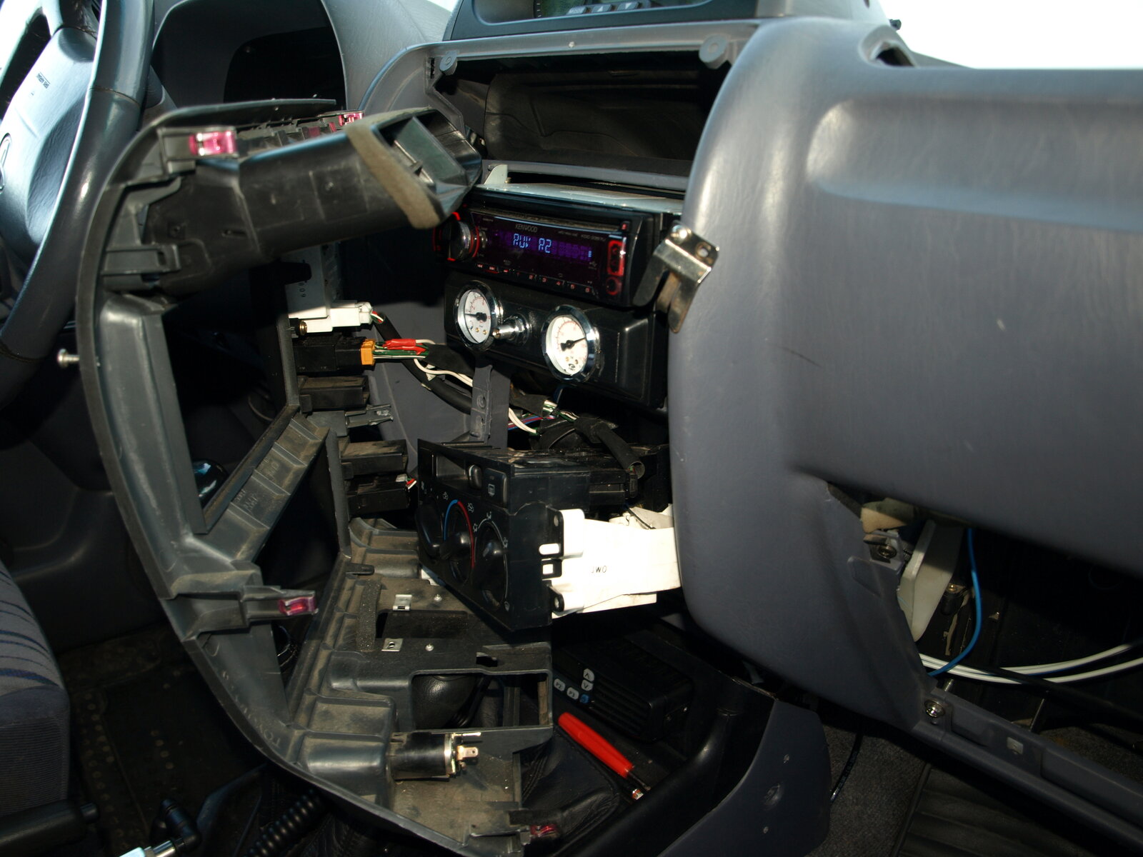

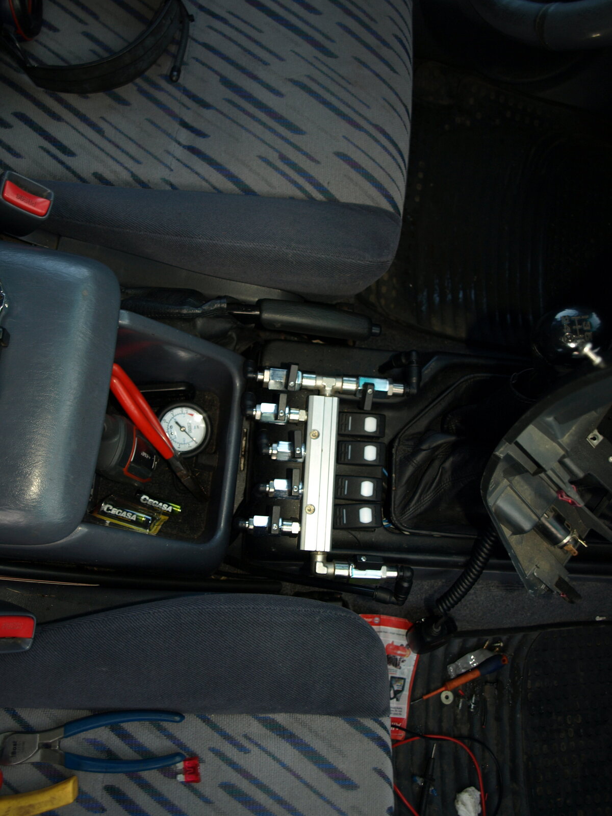

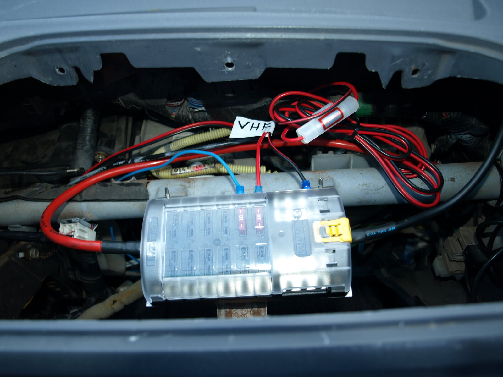

last two days I have worked on auxiliary electrics also installed Viair 400C Air - compressor
pics of air system
Air gauges in center console

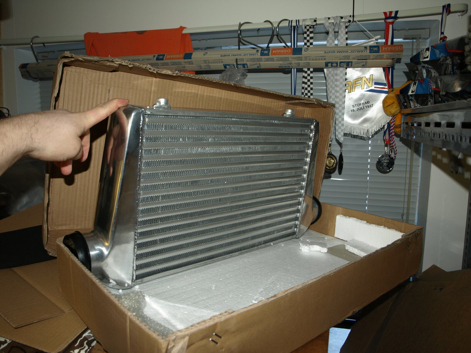

Next install itercooler
