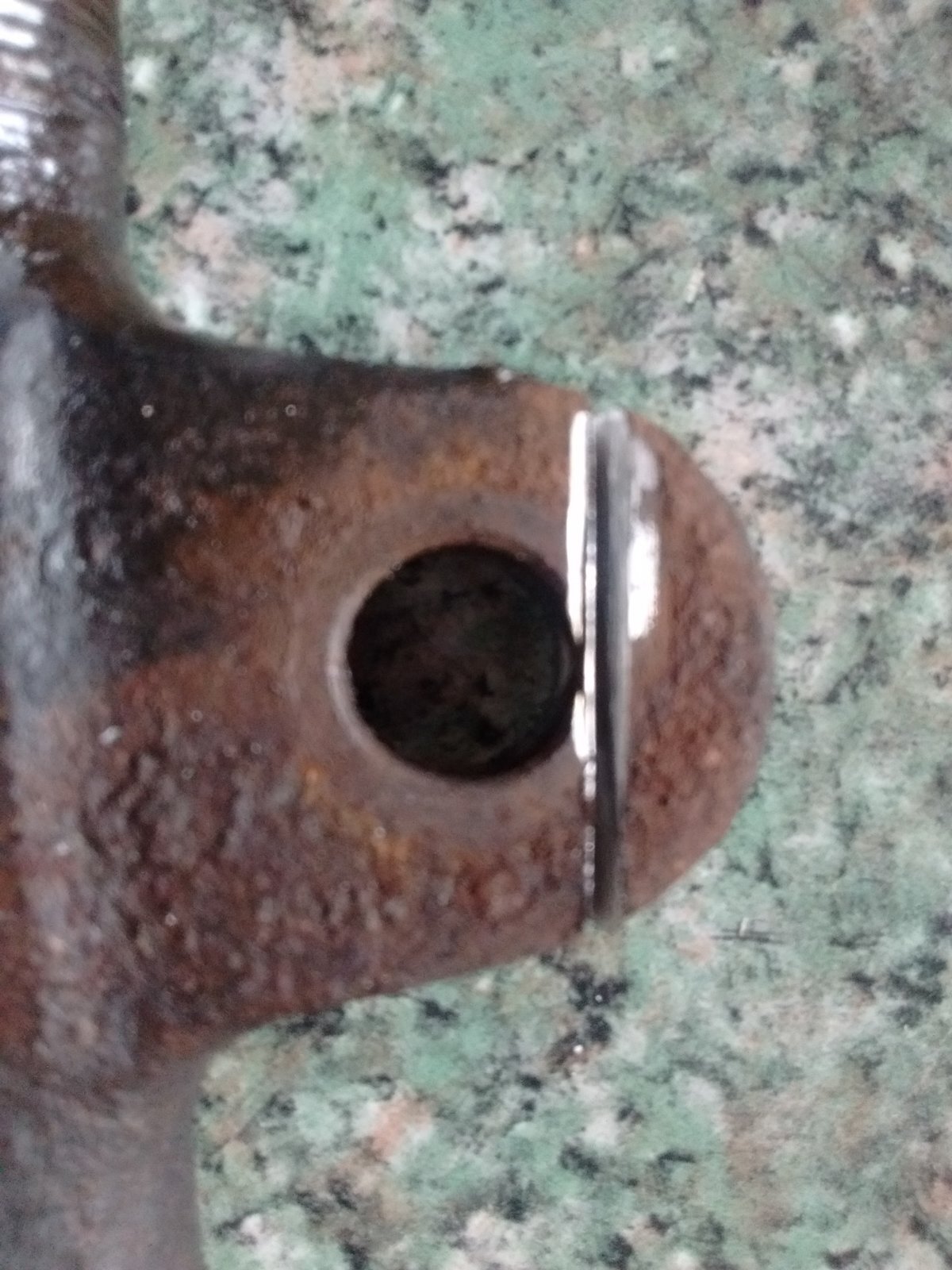

Did it - TOP TIP -
I applied a disc cutter on the old relay arm ball joint and cut very close to the thread about half way into the ball joint. The resulting heat close to the thread was enough for me to knock it out with a soft nosed hammer

The correct ball joint separator does not touch the rubber, there is another method but it takes some accuracy. Use a copper headed mallet and strike the cast iron straight, using that picture as a guide the mallet head would be parallel with the grind line, the copper will not fracture the cast iron, and leave the nut on a few turns to protect the joint thread if your aim is off.
I have been using this method for years where typical joint separators do not work, and the factory one designed for whatever particular model car is not available, only last week I changed the springs on a Mercedes E class, the common failure mode is when for whatever reason when parked they simply snap and the car drops to the floor.........no seriously it really does happen. During changing the fork type would damage the rubbers as mentioned, and a 'normal' separator is simply not the right shape to get around the upper wishbone, I just had to be careful not to hit the wheel arch!
