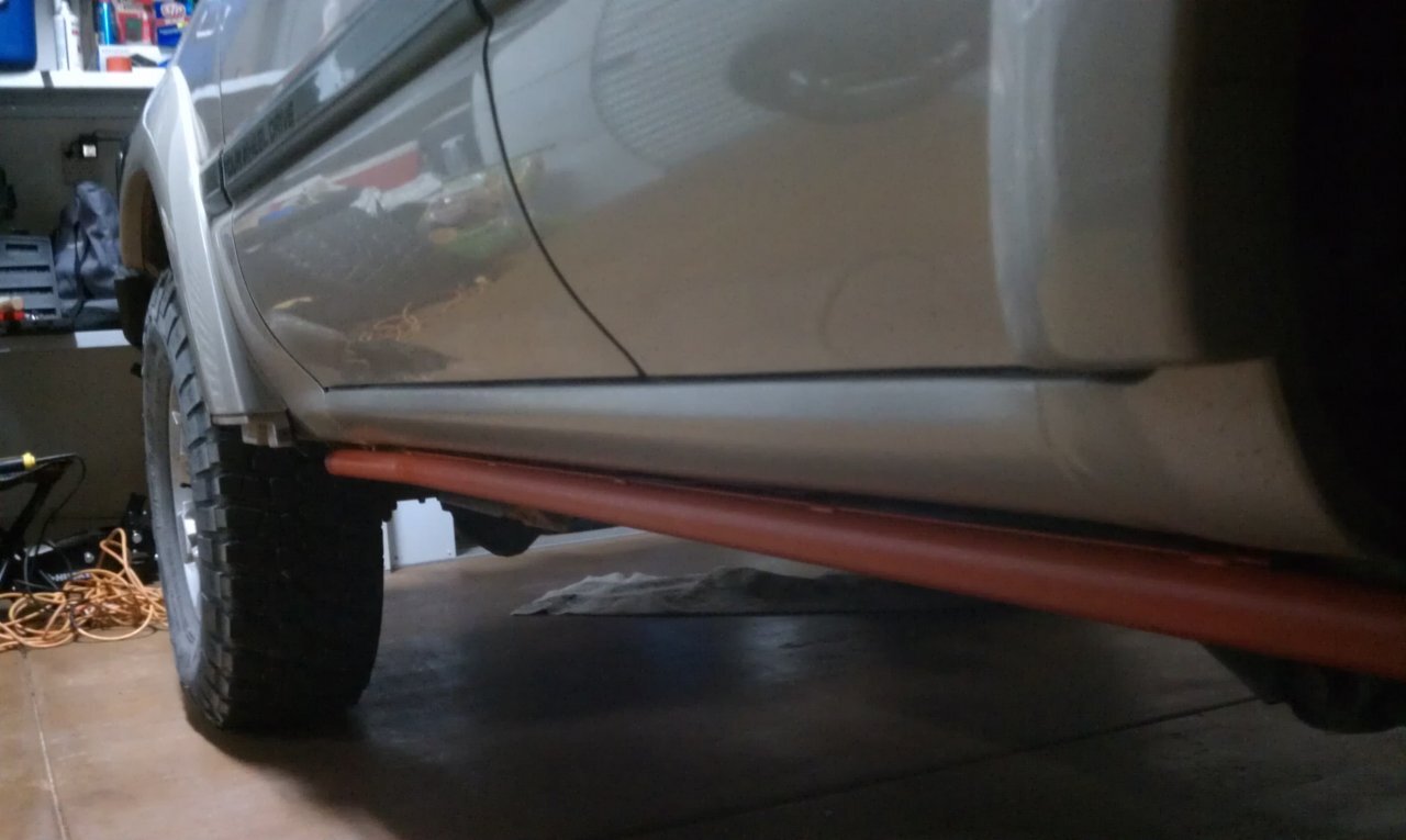

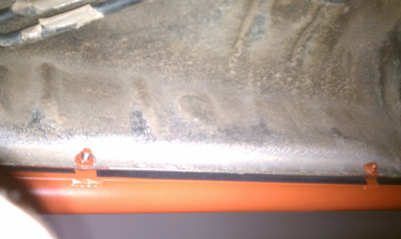

I'm also in the market for rock sliders. I took my wife out off-roading this last Sunday, and she loved it, minus the climbing in and out of the rig. This provides me a great excuse for a pair of sliders. Plus, I hit a rock which slightly damaged my exhaust and cracked a flange, which added a delightful little annoying "tinging" noise at idle.

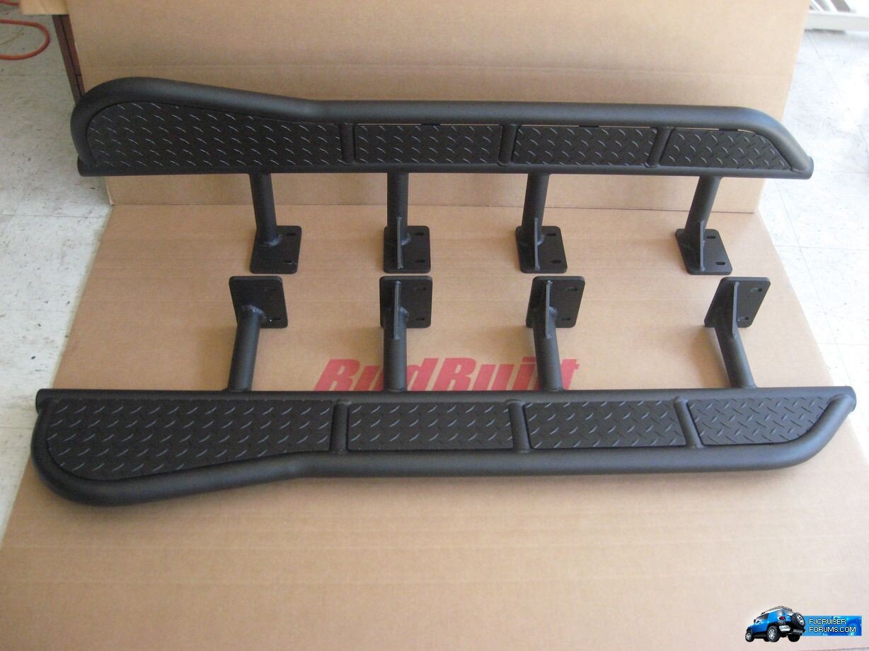

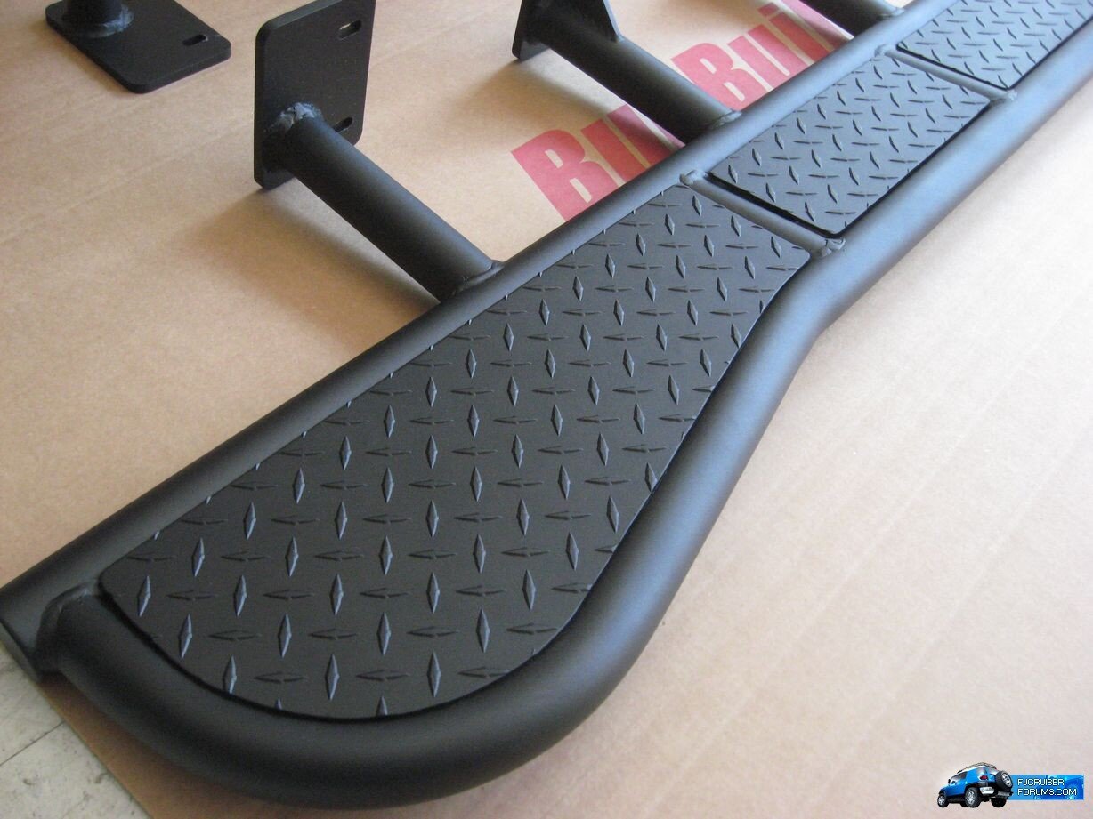

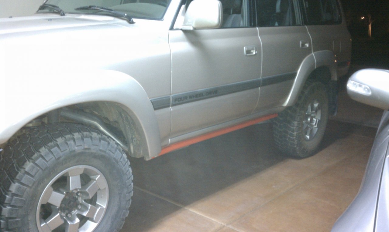

I just ordered a compromise sill protection called a "rock rail".
They weigh 25# a pair, and are remarkably good low profile protection, gaining extra clearance in the process.
They are low profile, as you can see, can bear the weight of the vehicle, despite being attached to the sill, and are about EUR 300.
The guy who makes them (in the US, unfortunately) has some video around the internet, showing himself completely high bottoming on a rock with no damage.
They do not replace rock sliders for radical use, but they do 90% of the job of rock sliders at 33% the cost. I think they are a great option.

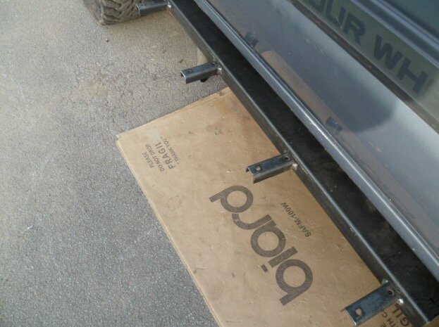

custom_sliders1.jpgcustom_sliders2.jpgI've emailed JV but who is JW ?? To be honest i dont mind if its JC himself :icon-biggrin:
What i want is the box section slider under the sill and the tread plates to look like these, Oh and the little stubby bit that lets me add those side bars that tie to the bumper.
If anyone knows someone who is a wizard with a welder and wants to send a few quid someones way let me know

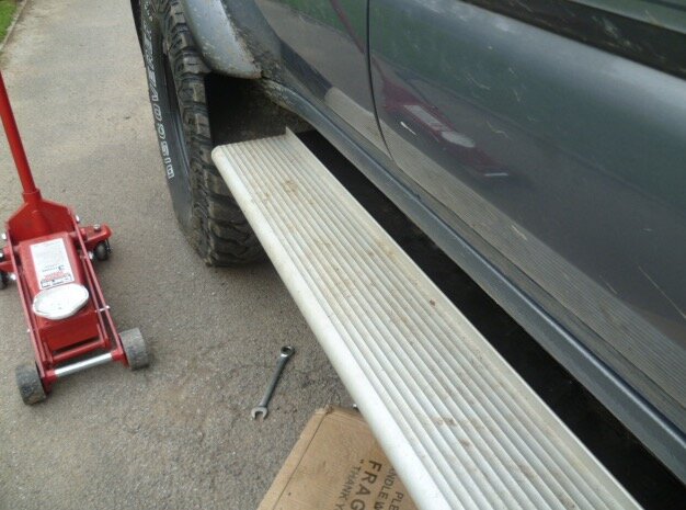

If it's of any use, I have the side bars, part of the ARB kit for steps and side bars in one package.
The side bars are tubing which narrows at the step and inserts into the end of the step tubing, secured with a bolt through. I don't know if there could be a better way to mount them TBH, it seems to work well and looks quite neat.
The step tubing is prone to stone chips and rusting, but there's not much you can do about that besides a rub down and lick of paint every so often. Where the side bars mount to the bumper can be improved. On mine, there are 3 coach bolts which rust and become quite unsightly. I'd recommend stainless bolts, but that goes without saying for any other bolts on the truck IMO.
If you need any more photos of the ARB set-up, I'm happy to post them on request.
