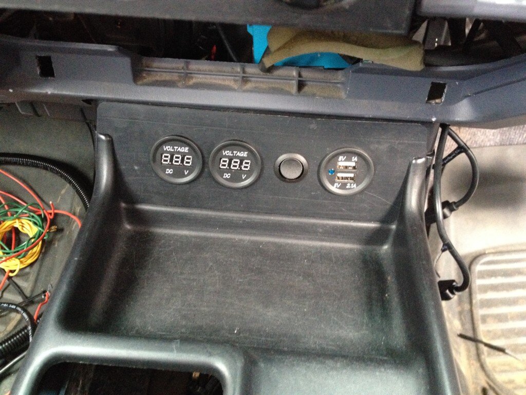

I also removed all of the center console and alot of the dash covers, so I can get on with finishing off all of the electrics. volt meters, accessory sockets, USB power outlets, CB aerial coax, ARB locker wiring etc.

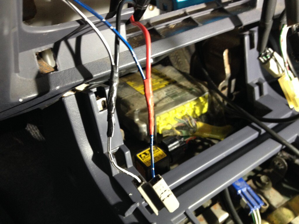

Managed to get all of the cabling done today :icon-biggrin:

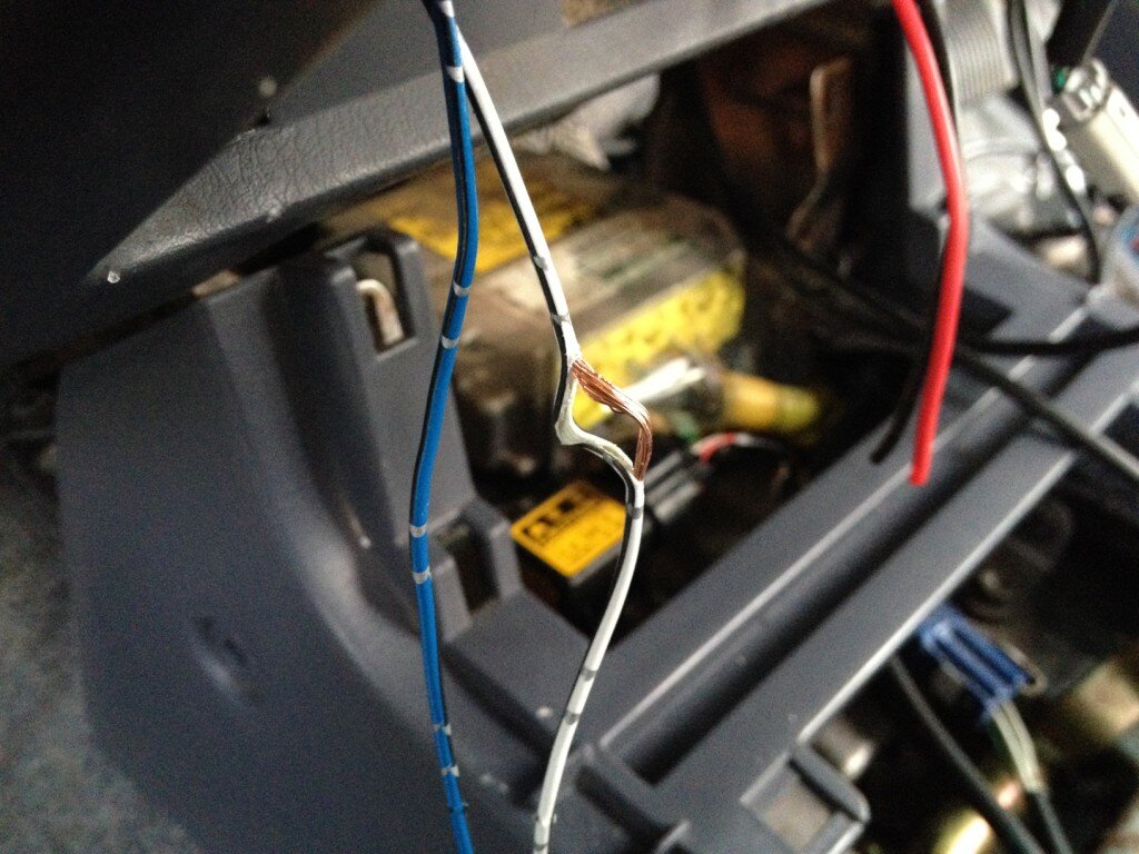

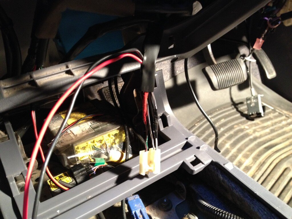

Eugh. Scotchblocks. :angry-cussing:
To be honest I don't have a problem with them :shifty: Not a thing of beauty I agree, but they work very well if used correctly. If you look though you can see that I've already cut away the offending ScotchBlocked item in prep for a nice heat shrunk solder joint buy the end of tomorrow.
As a quick and dirty emergency solution, they have their place in the toolbox. My electronics lecturer swore than anyone who used them in a finished job should have half a dozen clamped to their bollocks.

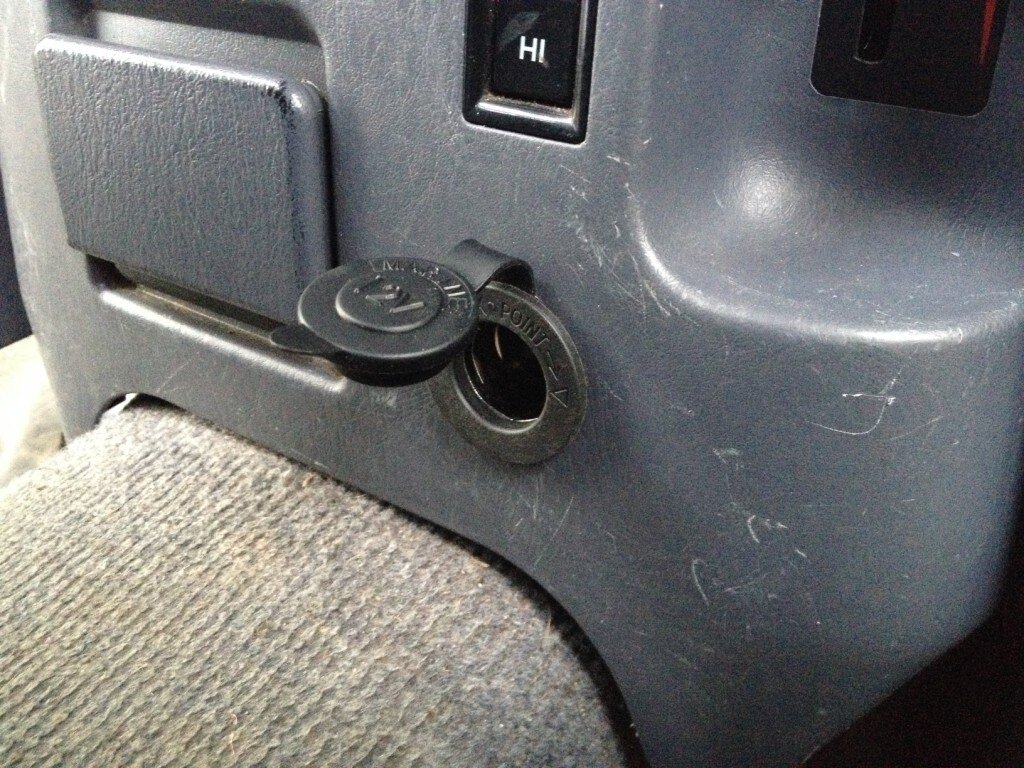

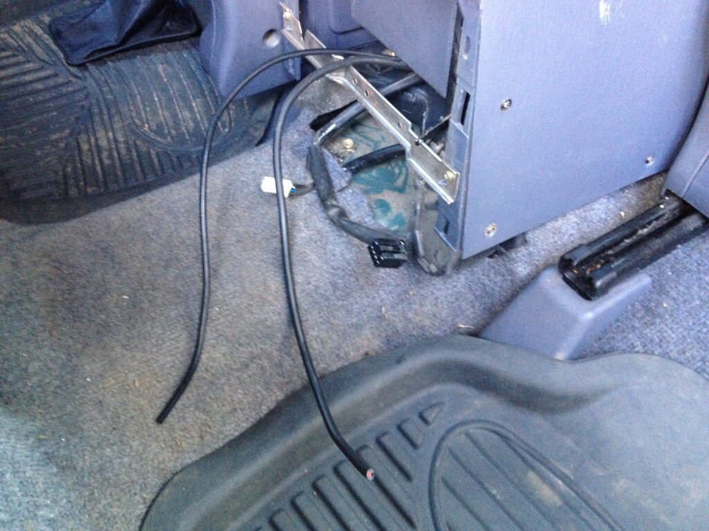

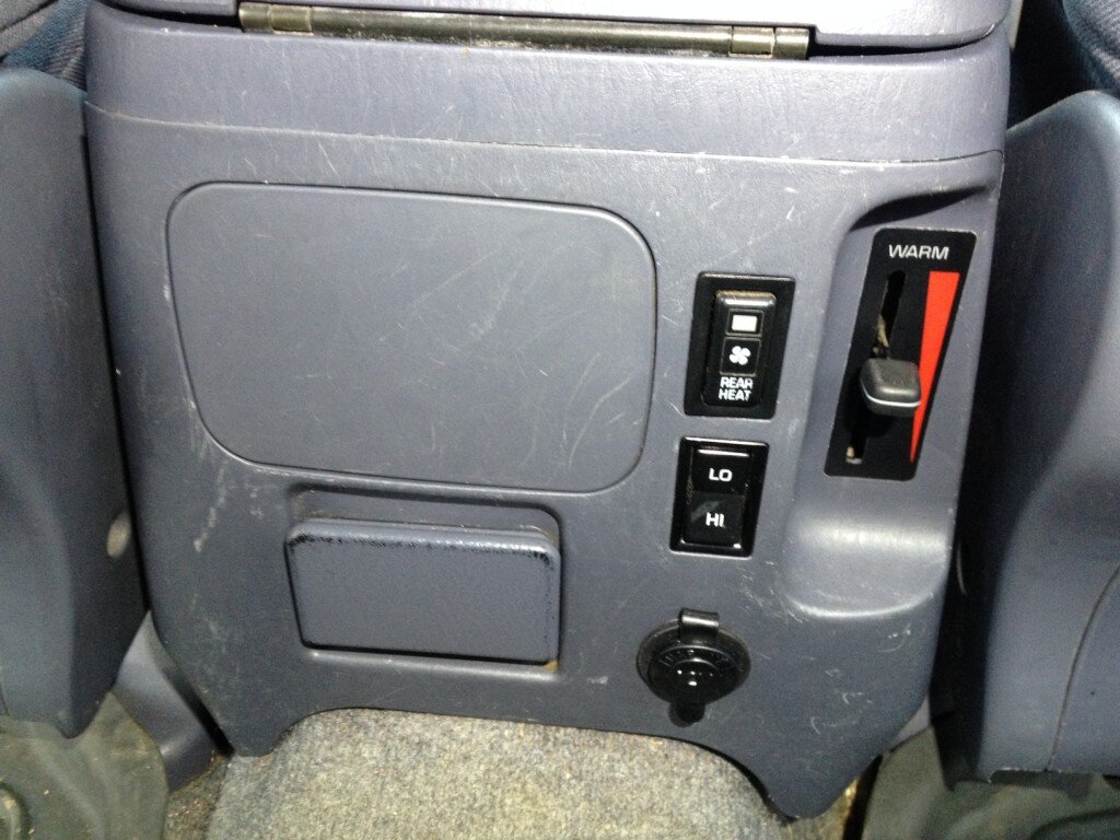

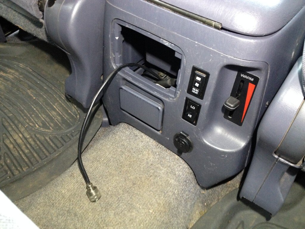

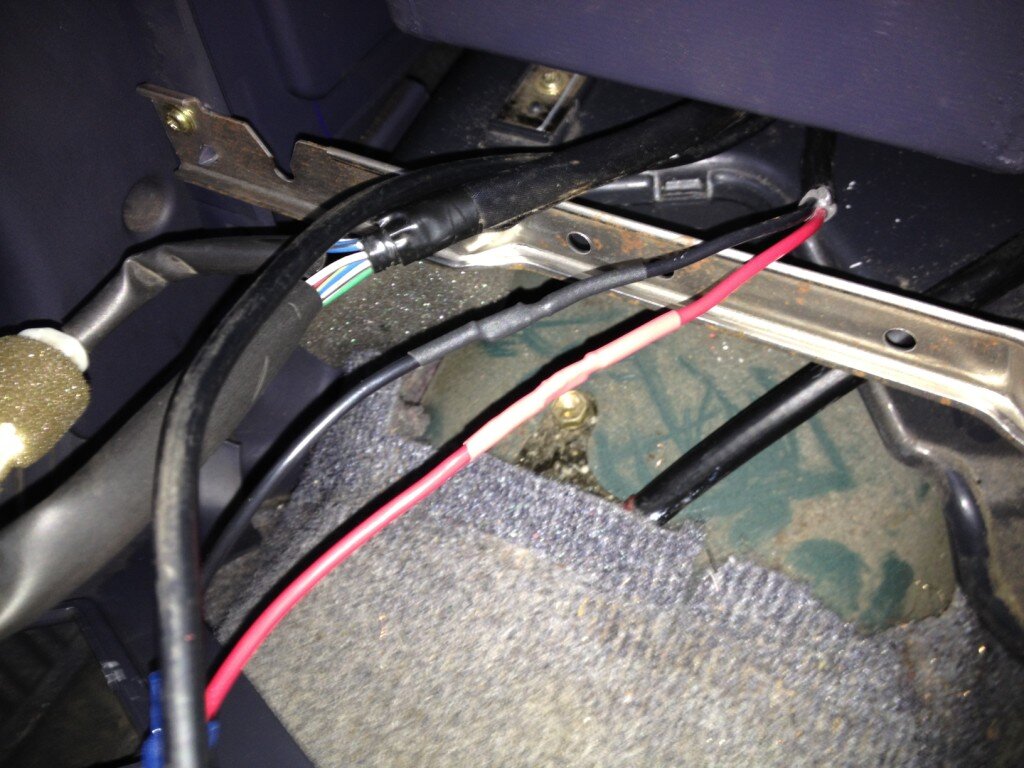

Got the new cabling installed for the rear seat accessory socket and the CB coax.

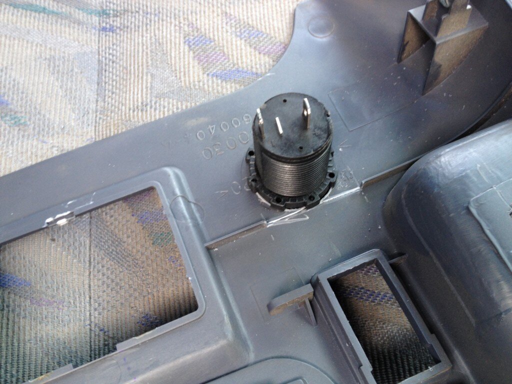

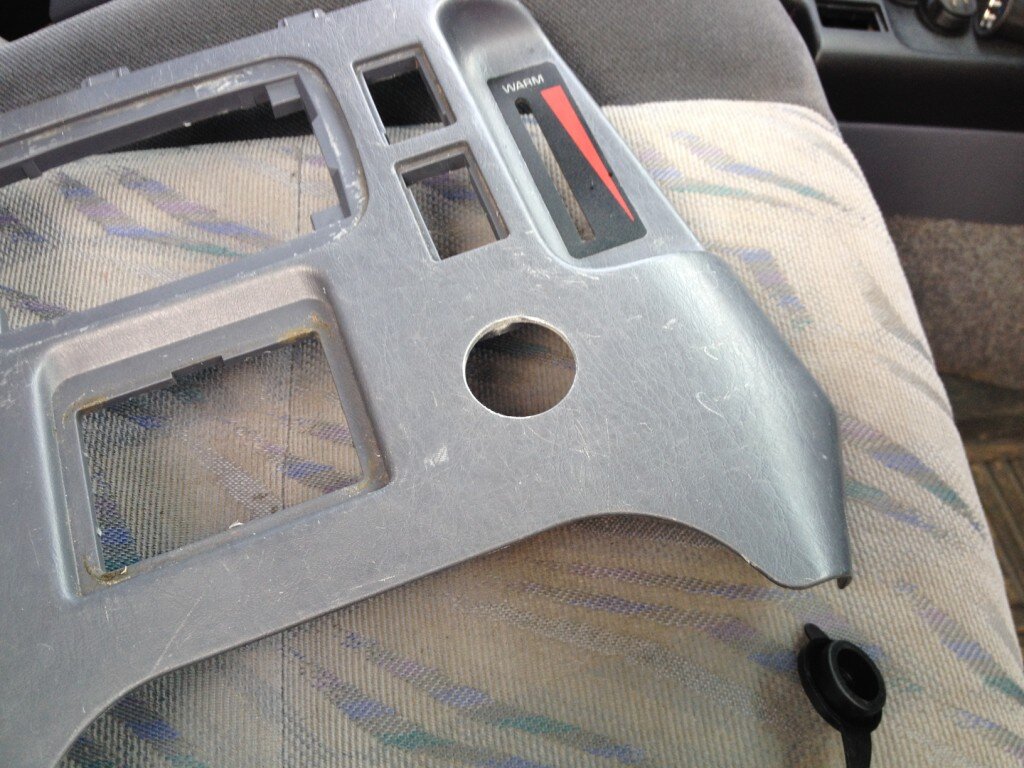

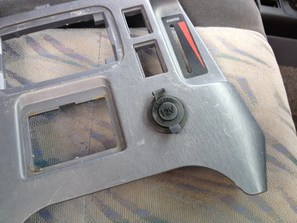

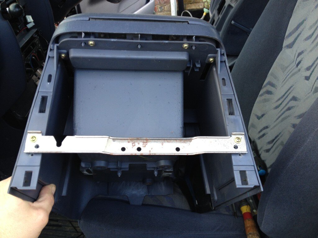

Positioned the socket and drilled a hole.

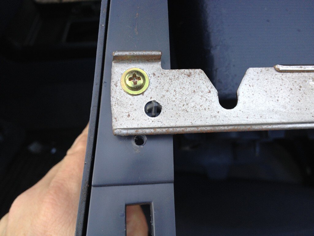

I had to remove a rib on the back of the console to get the locking nut on.
I also had to turn this brace up the other way to allow me to fit the socket in the location that I wanted.
Console back in and wires proudly hanging out.
I cut the socket wiring back to a length that I thought would be good, but then found that due to the way the rear cover fits they needed to be longer. So I lengthened them again!
Fitted a plug to the CB coax.
It's inside this cover that I will run the aerial to and join the two ends together with a female/female connector.

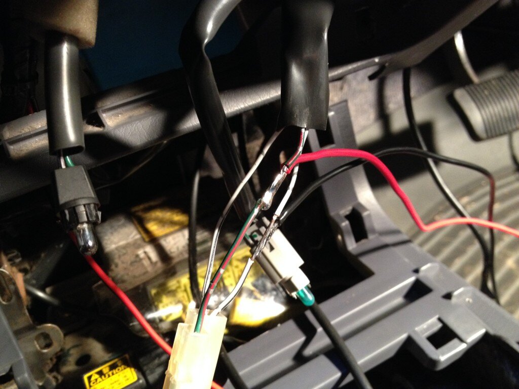

These are the two wires that Doodle got all excited about the Scotch Blocks :)

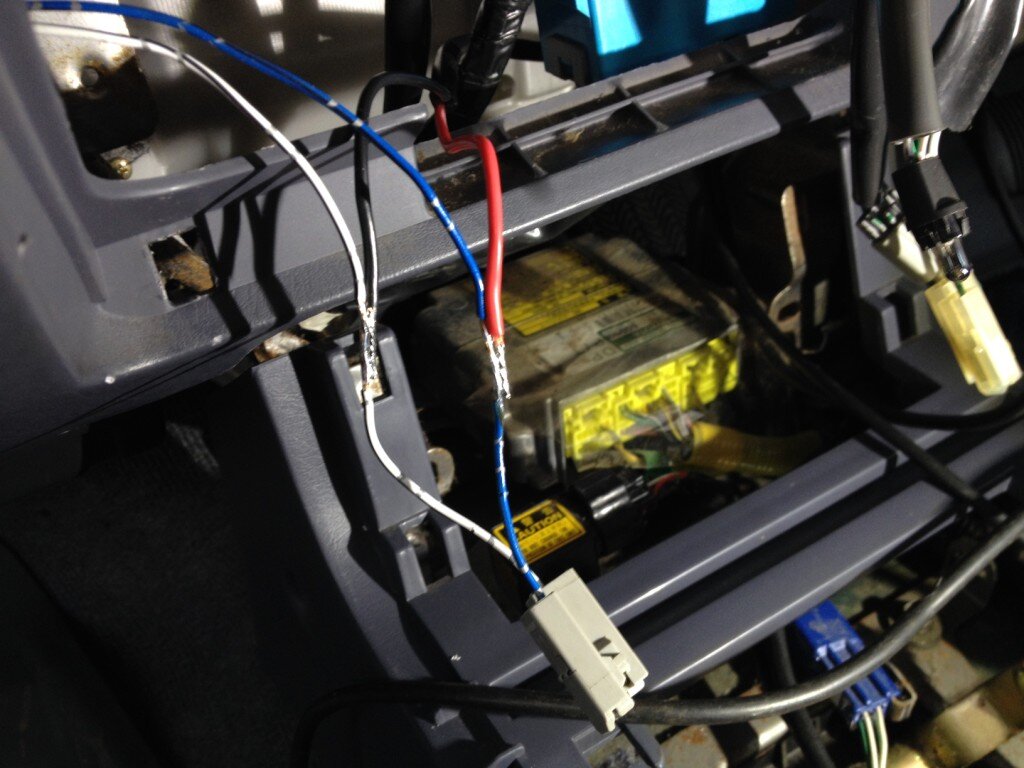

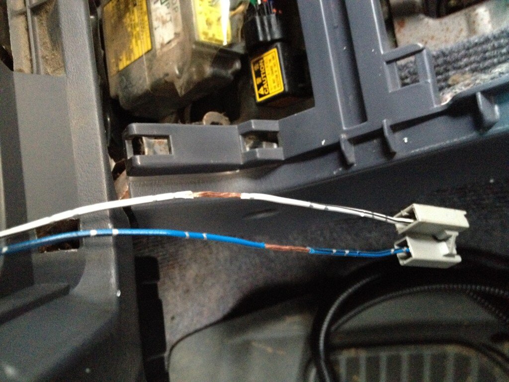

These are the supply to the accessory socket on the front dash and where I've connected the new one in to.

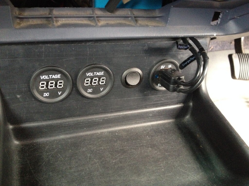

I've also nicked a supply from the cigar lighter socket feed to power the two relays that'll switch the supply to the two new volt meters when the ignition is on.

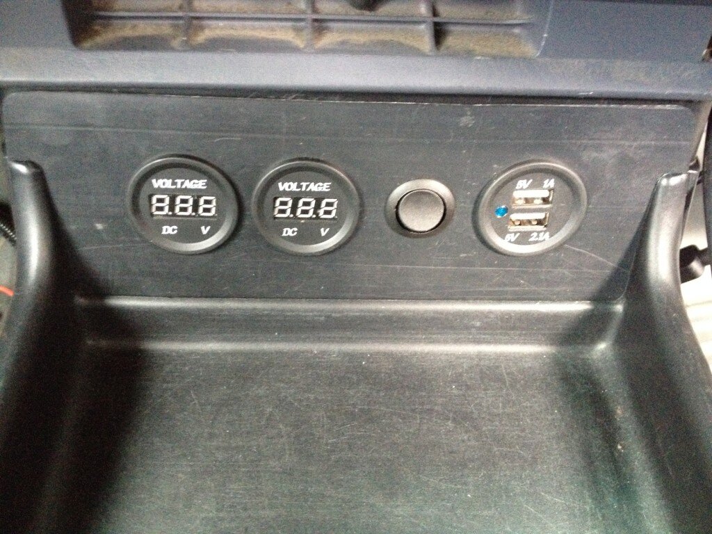

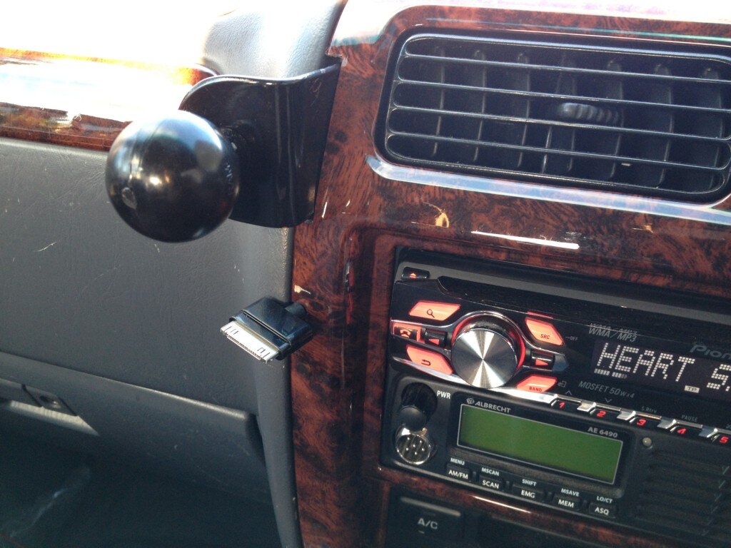

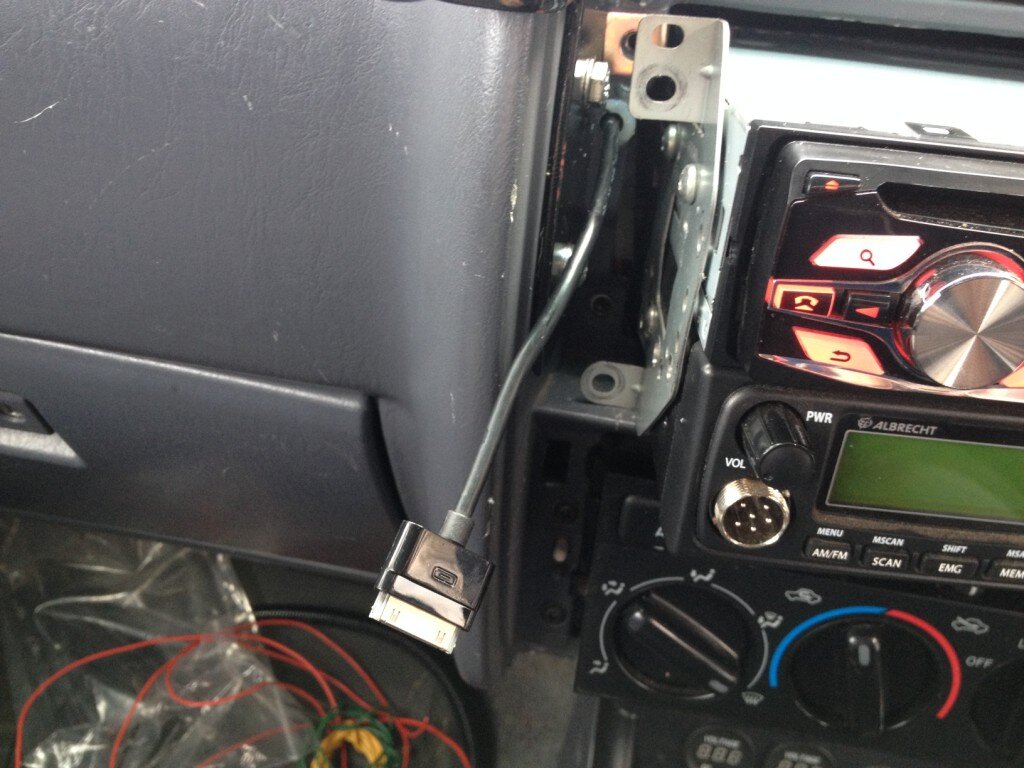

Volt meters and USB power outlet are now fitted, but still need wiring up.

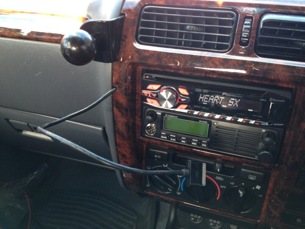

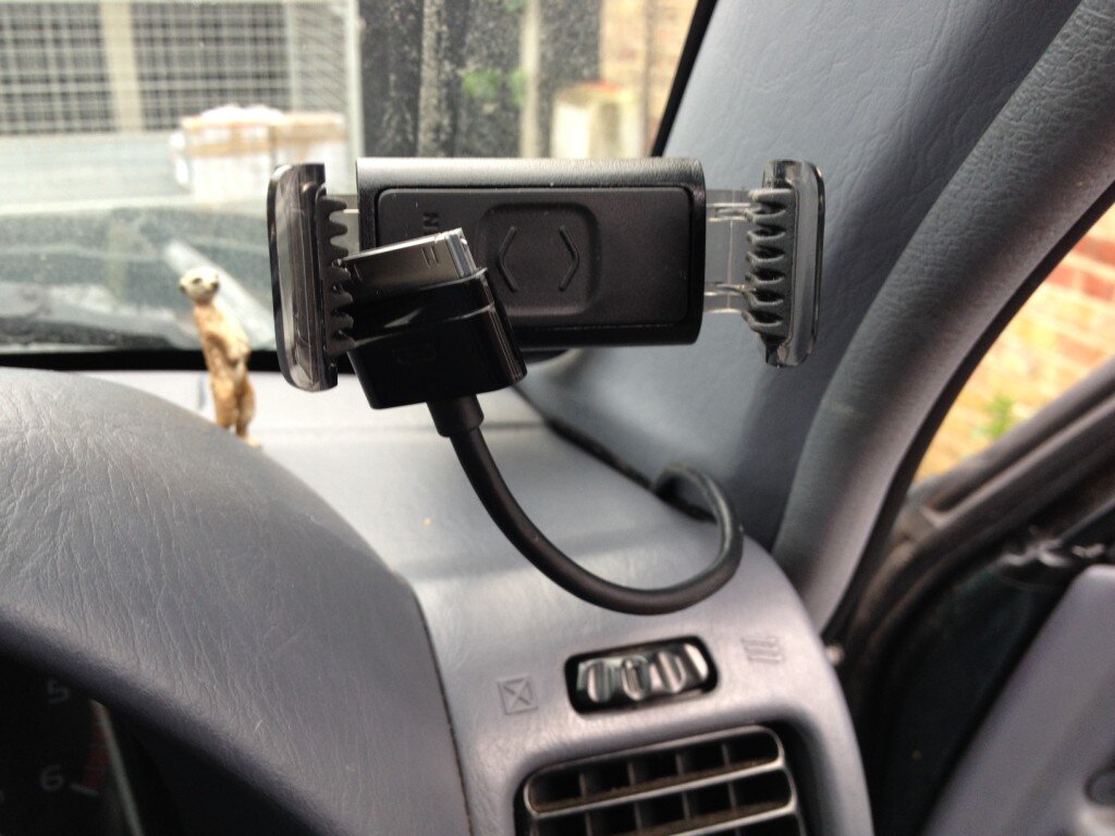

Permanent USB charge leads are now fitted for my iPhone and the iPad.

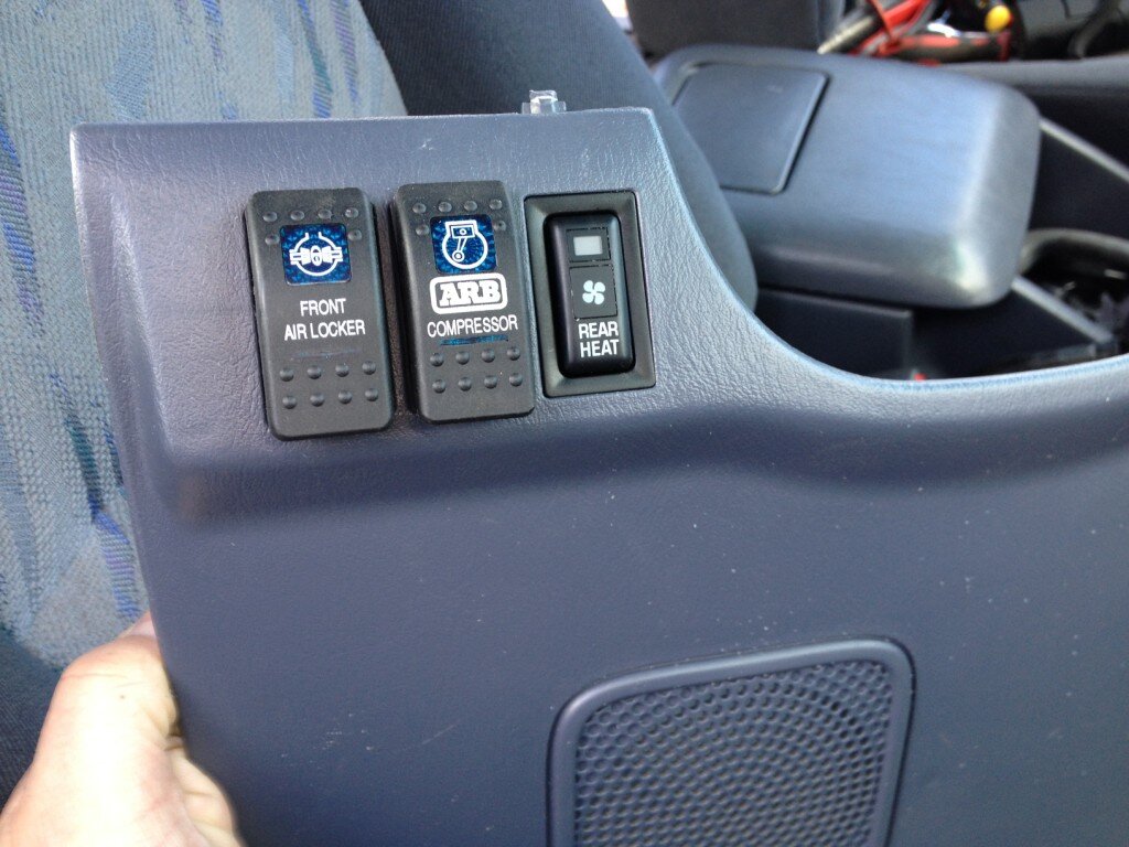

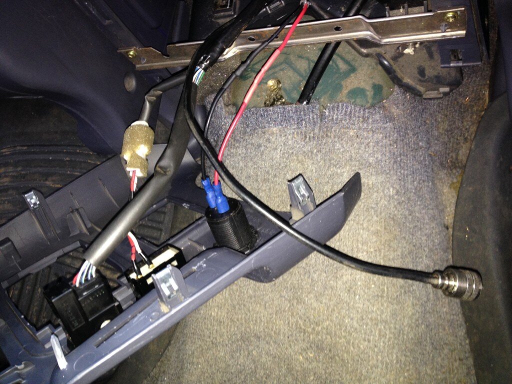

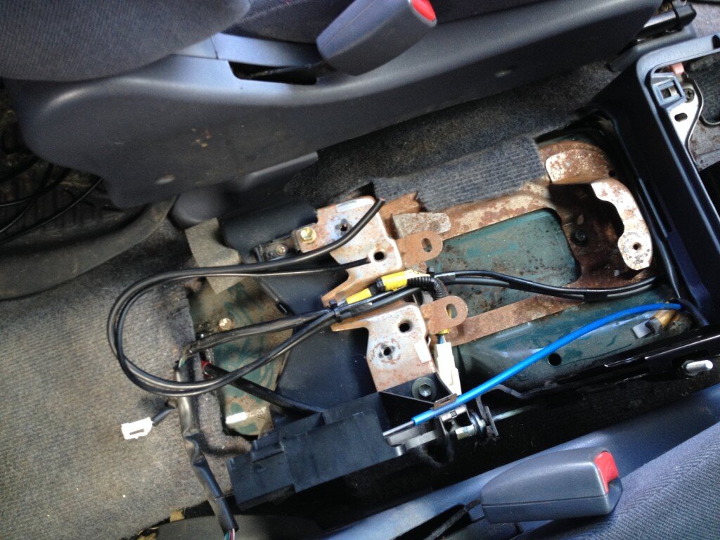

I've also made a start on re-fitting and tidying up the ARB front locker wiring and installation.
I've relocated the switches from up on the dash to under the left side of drivers seating area so they are less obtrusive, bloody ugly things!!!

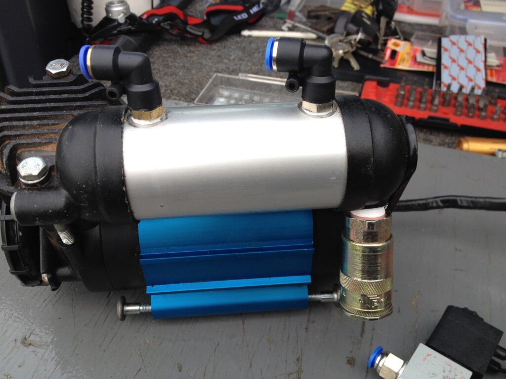

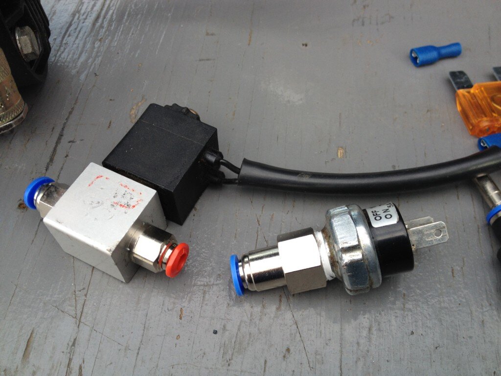

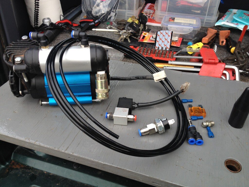

I've also removed all of the pressure switches, solenoids and relays from off of the pump in favor of installing them all remotely in a nice little box.

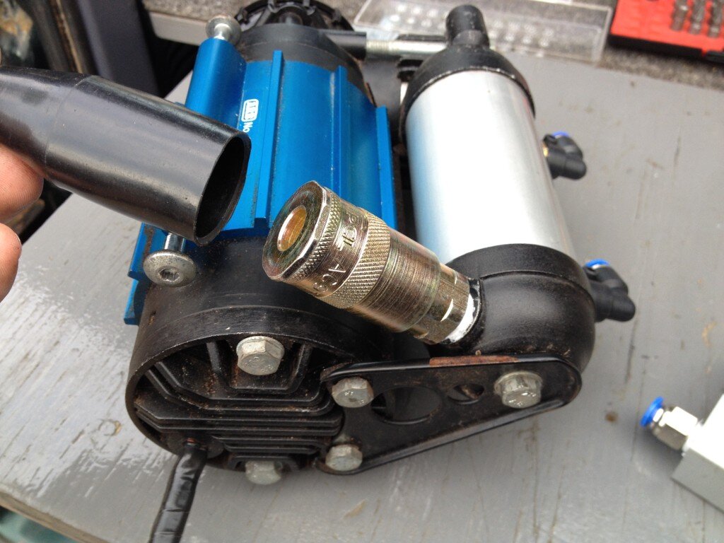

Fitted a PCL Vertex coupling to match the rest of my existing air line and inflation set up and found an armored cable gland that will be good for keeping the dirt out of it when not in use.
I also significantly shortened and tidied up some of the locker wiring.

Great update Steven. :thumbup:
One thing I would say though, and apologies if you already know this.........................
If you cut the ARB airline at any point using side cutters you will invariably get leaks in the system as the pipe wont seal properly in those push fit fittings as it always kinks the pipe slightly.
You need to use one of these:
