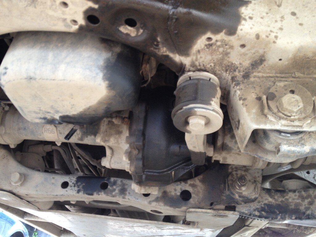

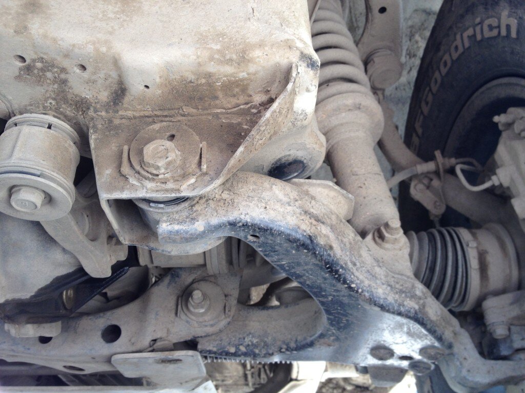

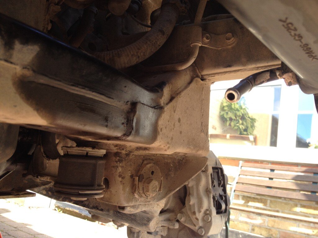

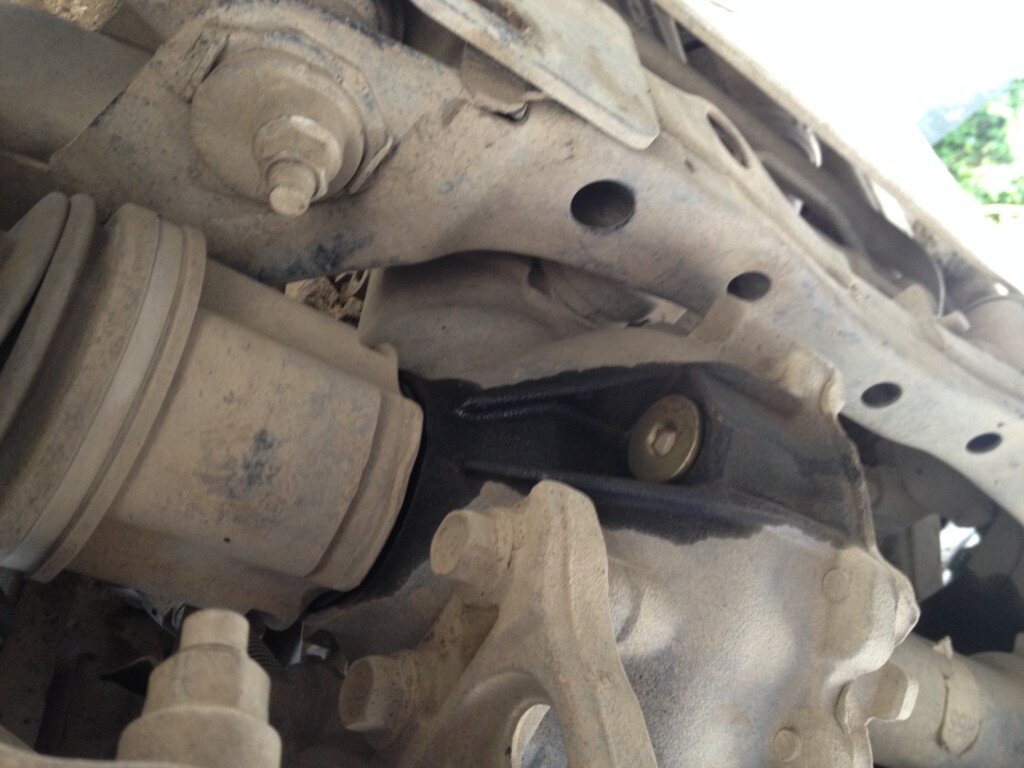

Following my trip to Wales a couple of weeks before I was aware that the near side front axle oil seal was weeping a little as you can see in the photos below and although I had a spare I had not planned to change it before Lincomb.

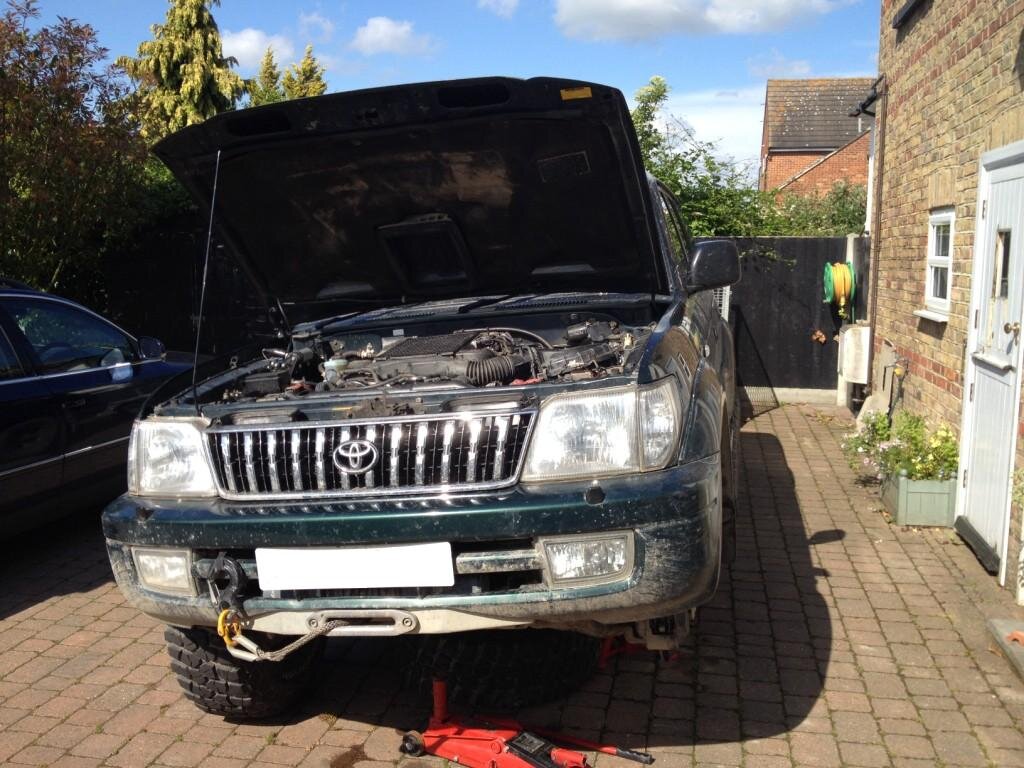

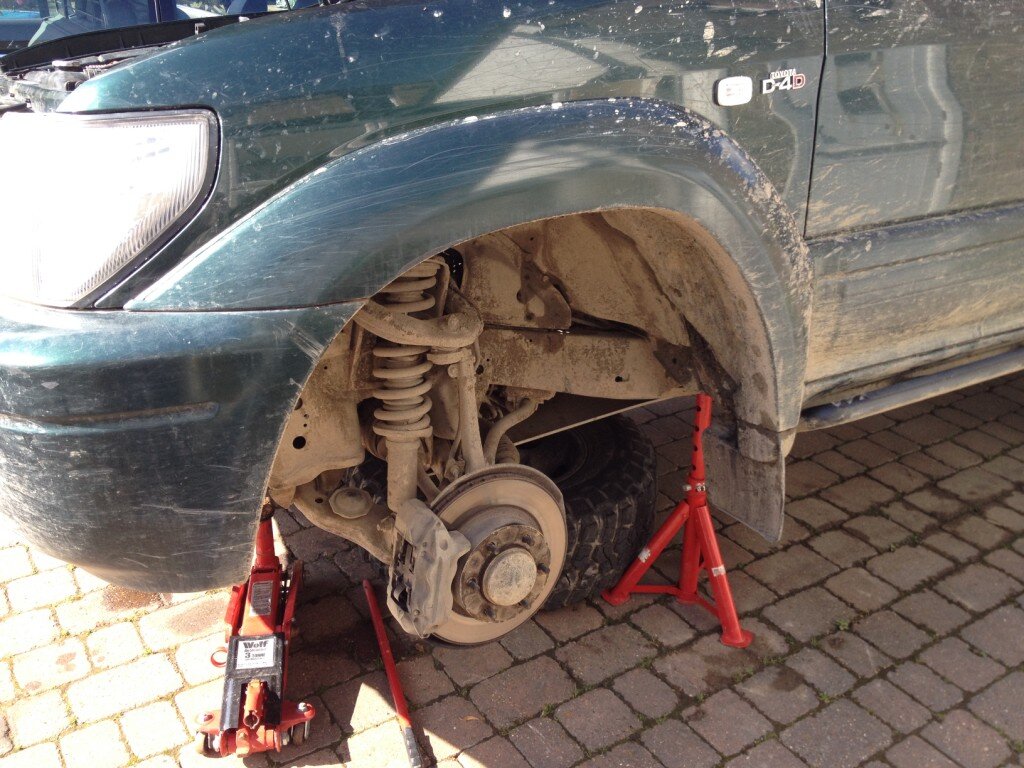

I guess now though I would have to as it looked to have almost completely failed during the test drive, so somewhere around the Wednesday before Lincomb I set about pulling all of the near side front suspension apart to replace the now shot oil seal!

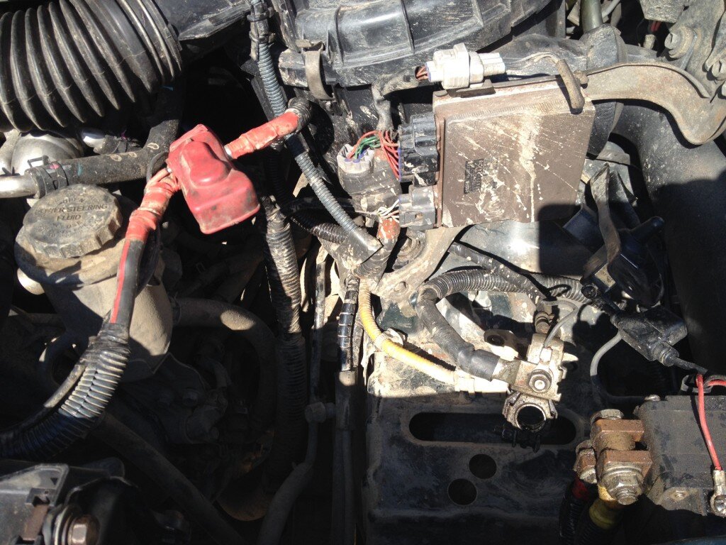

Removed the near side battery to allow me to pull out the upper wishbone bolt.
Then started removing all of the components to allow the suspension leg to swing clear.

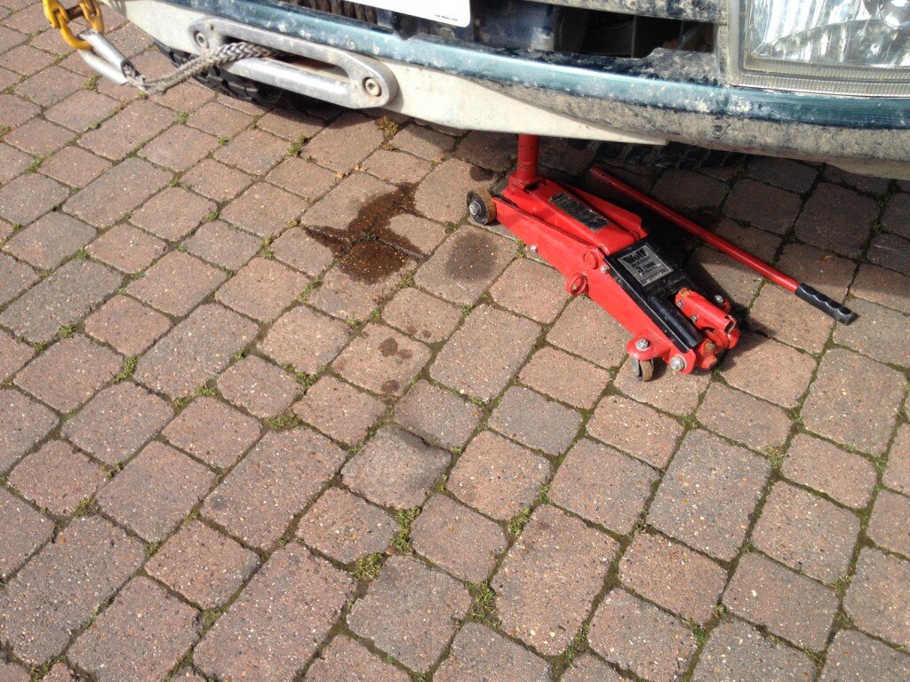

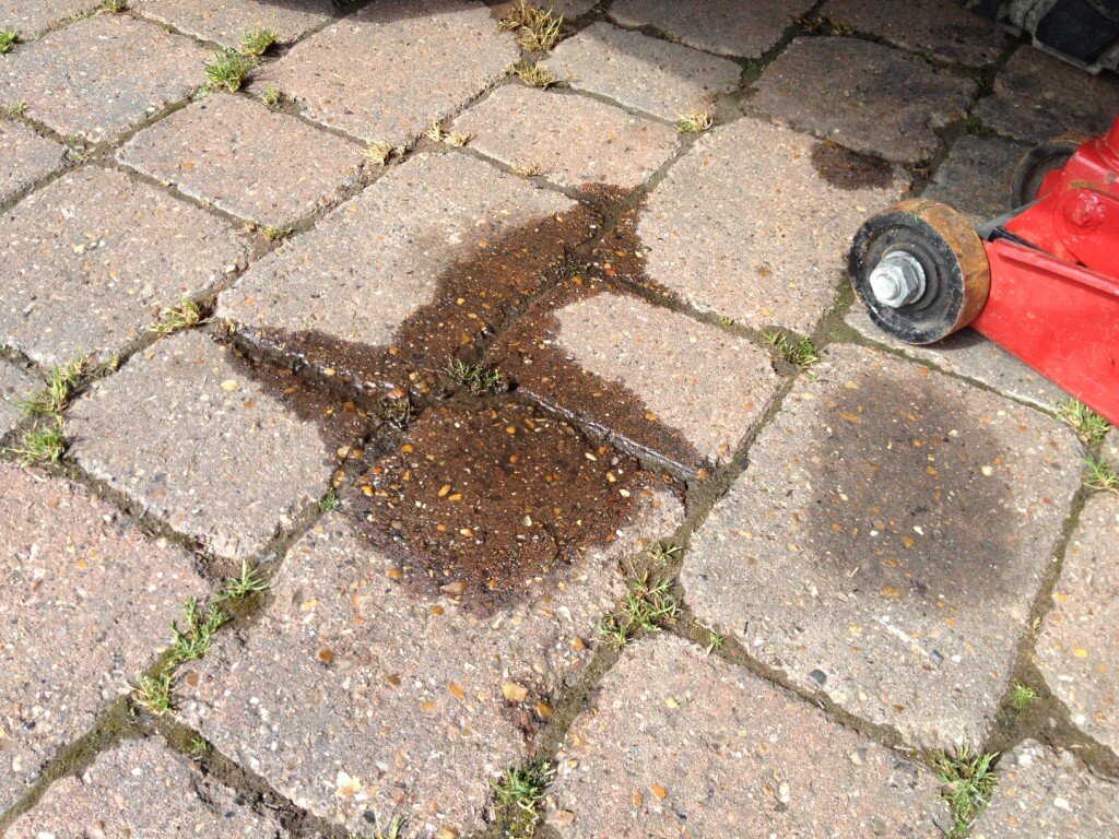

I then noticed this fresh patch of oil at the front end and could even see a regular drip dropping into the middle of it!!! :wtf:
I'm now thinking 'Christ I'm never going to make it to Lincomb at this rate!'

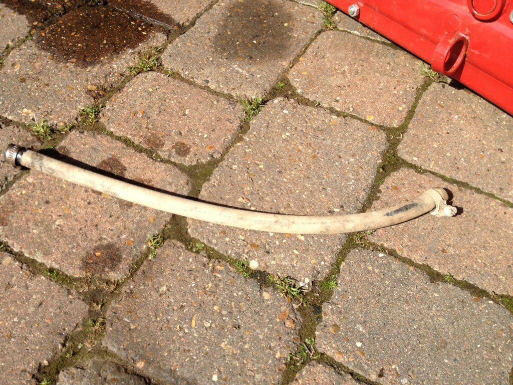

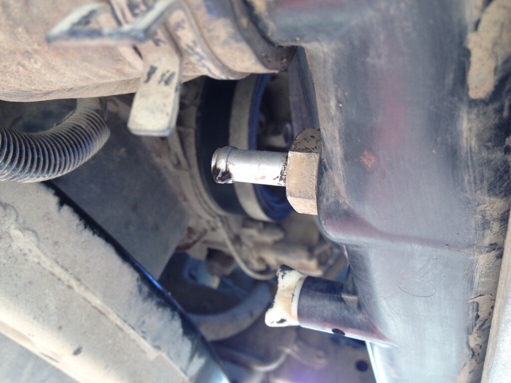

On looking up under the front of the truck I discover that the new oil leak is coming out of the OE ATF oil cooler in the bottom of the rad and it's just old residual ATF oil that's now just dripping out of the oil cooler as I have the truck jacked up on the opposite side, thank you God :pray:
The people that had fitted the after market oil cooler to Swampy had joined the two sides of the OE oil cooler with this short length of pipe and I'd not fitted it back on after re-fitting the radiator following its deep clean.
It's about now I notice that the pattern of oil that I think has come from the weeping, soon to fail in my mind, front oil seal is not as it should be and in fact the masses of oil that now surrounds this area has in fact come from the open end of the OE oil cooler :doh::icon-biggrin:
That's a relief, but now to far along with replacing the oil seal and it'll need doing at some point in the future anyway, so got on with it and got it done :icon-biggrin:
Wednesday evening after fitting the new oil seal I'm thinking to myself 'Why not tear out the aftermarket ATF oil cooler that's been poorly installed and caused me some aggravation as a result and re-connect the gearbox to the OE oil cooler'?
Thursday the day before leaving for Lincomb, job on :thumbup: :icon-biggrin:
Picked up 5Ltrs of ATF fluid on the way home from the school run and set to by blowing through the OE oil cooler with an air line till little or no old oil was coming out from the other side.
Ripped out the aftermarket oil cooler fitted by someone else :icon-evil:
Then started to flush the automatic gearbox ATF fluid through by dangling the pipe from off of the off-side outlet from the OE oil cooler into a washing up bowl and starting the engine till a couple of Ltrs had been pumped out then turning off the engine and replacing what had come out with new and so on.
