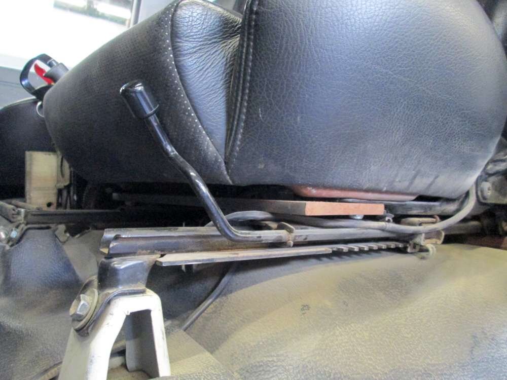

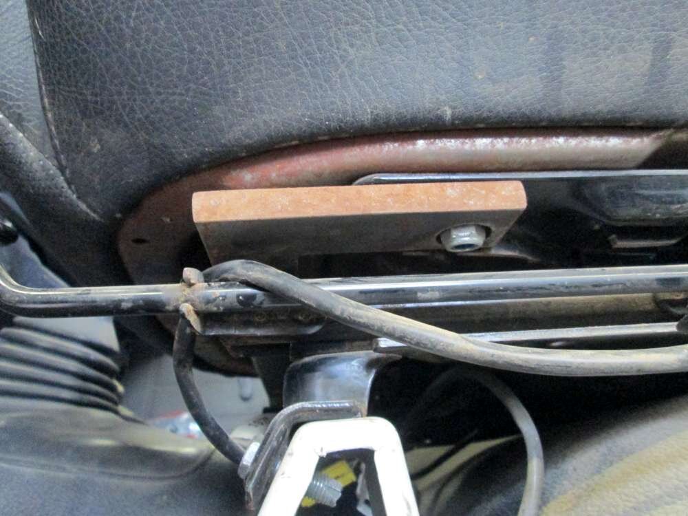

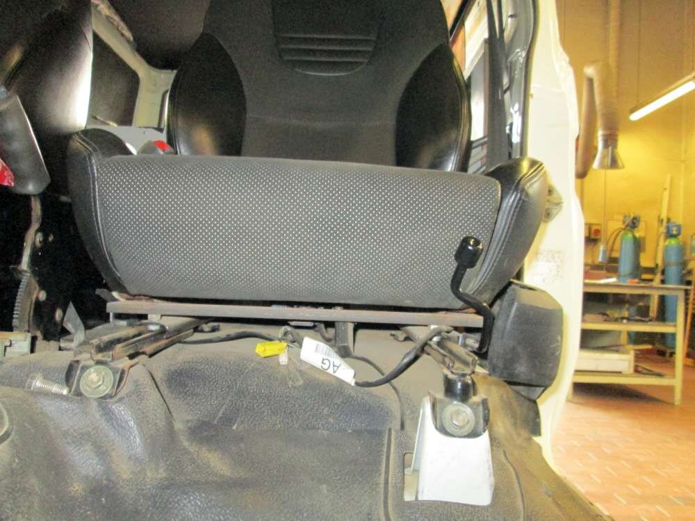

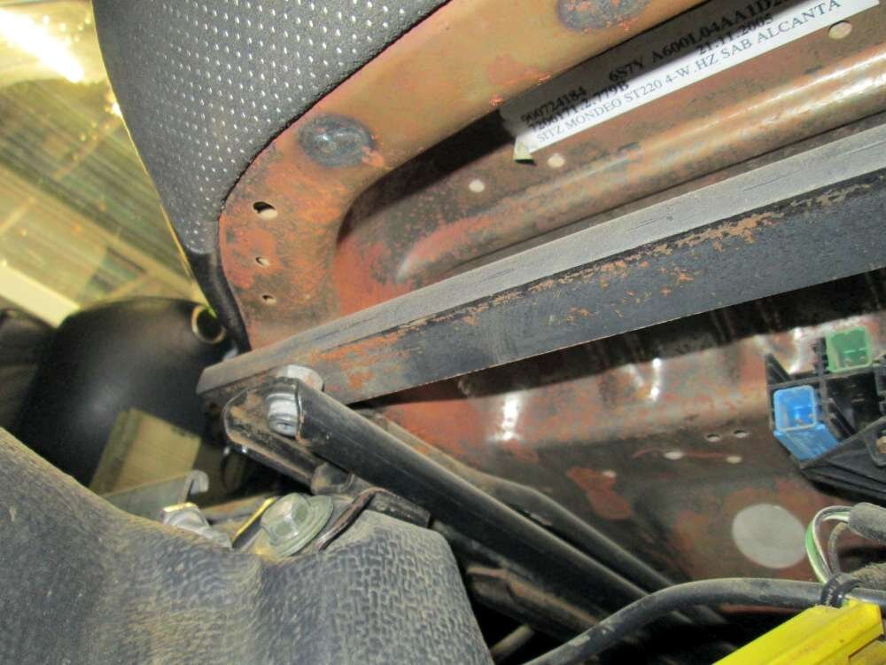

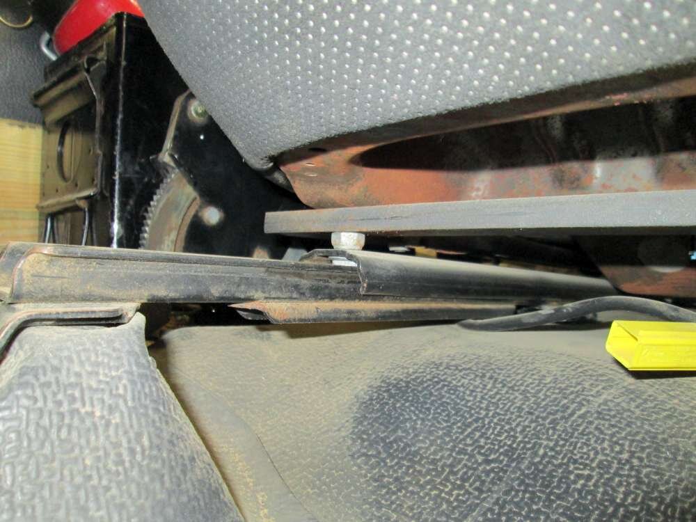

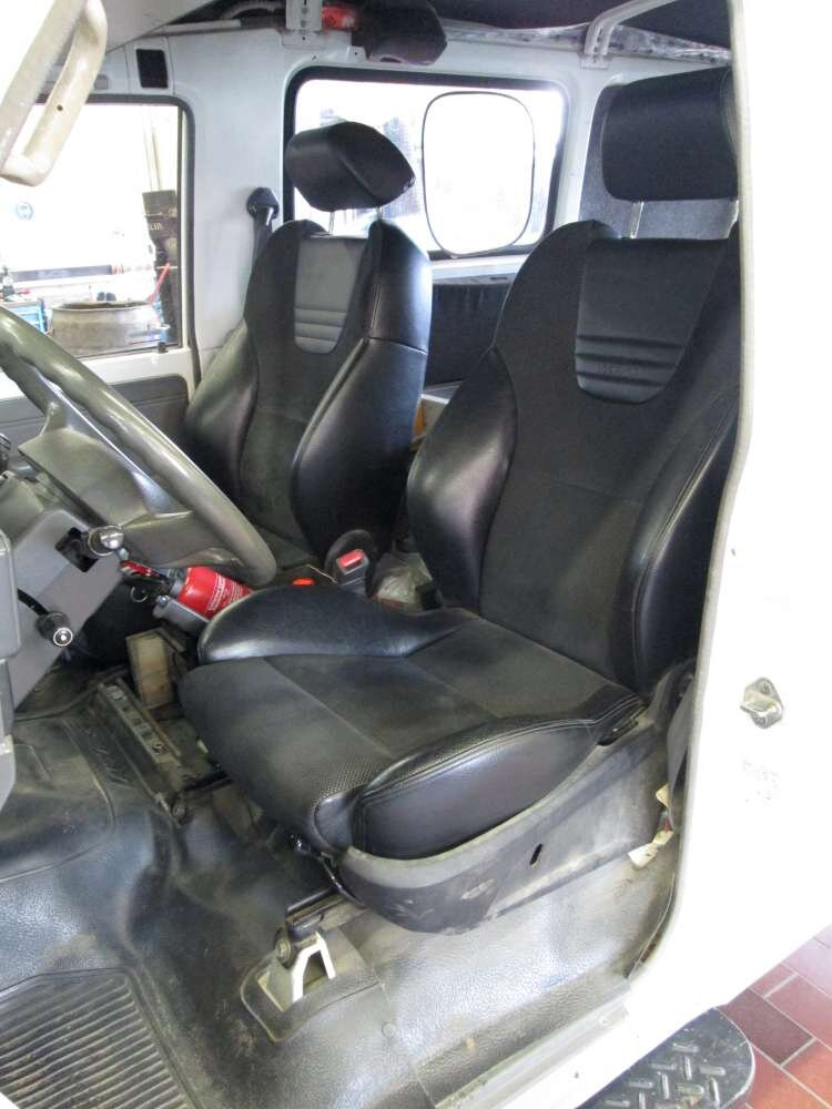

My 75 has recaro seats from a mondeo s220.
afaik they are fitted on two flat steel bars. Very simple.

original rails + flat bar as adapter
IMG_7104-1000.jpgIMG_7106-1000.jpgIMG_7109-1000.jpgIMG_7110-1000.jpgIMG_7111-1000.jpgIMG_7112-1000.jpg
