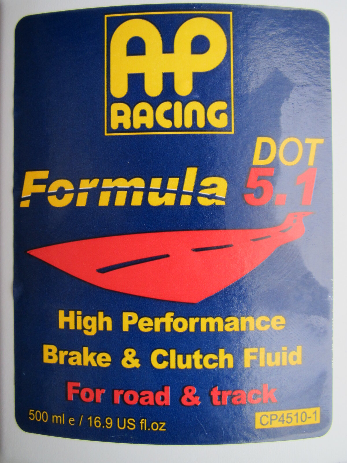

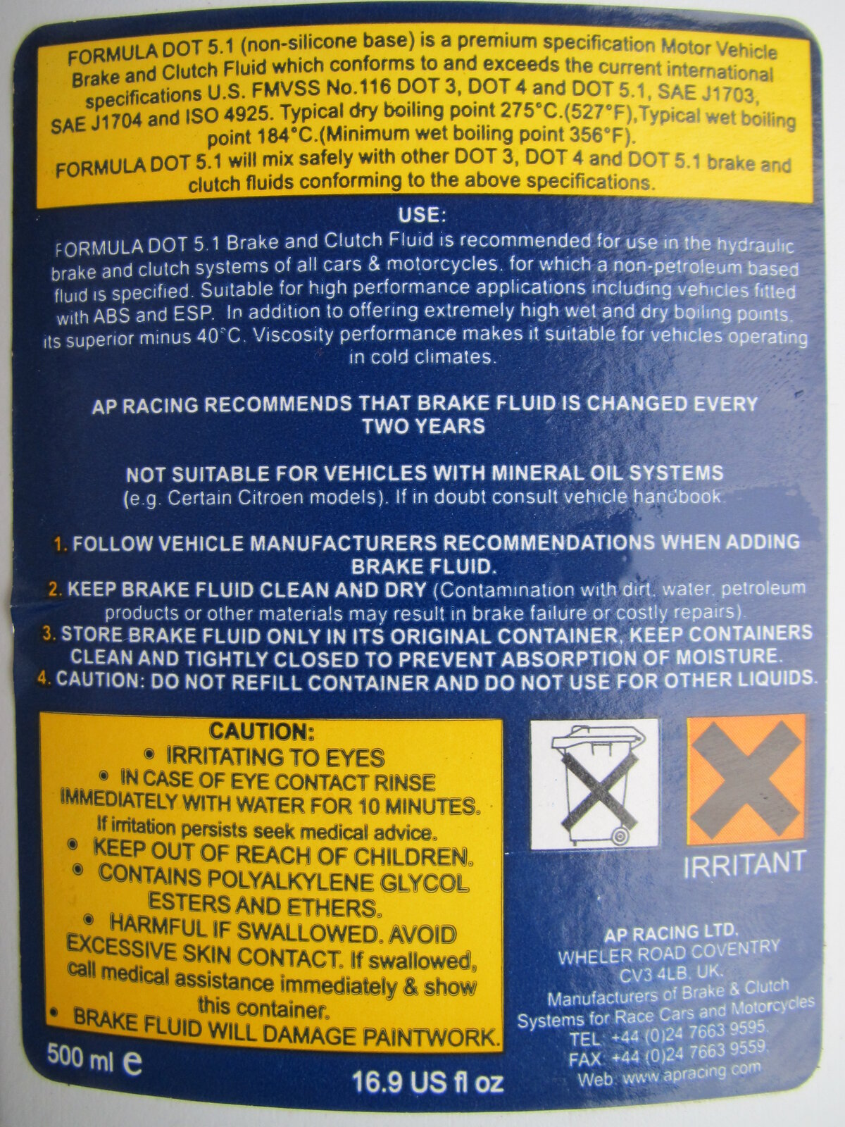

I happened to have AP racing formula DOT 5.1 and put that in. I've checked the bottle and it's compatible with all the DOTS thank goodness. Had me worried for a bit. brake fluid 005.JPGbrake fluid 004.JPG
