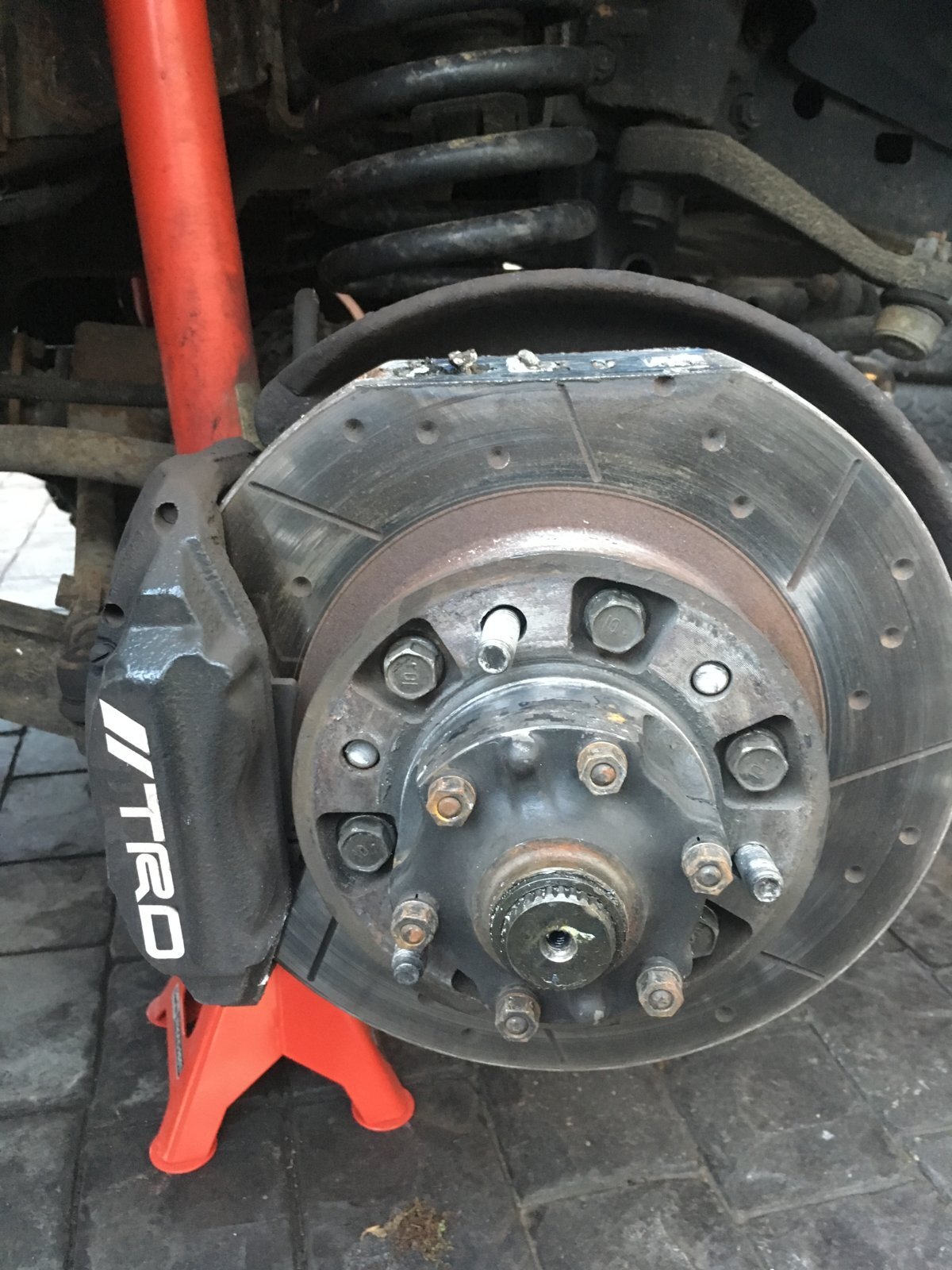

I managed to get away with it with a lesso. Learnt. I'll check studs with pressures periodically.
Next question is ... with only 3 k on the existing discs and pads do I change one side or both of the discs ??
I would say just the one disc, theoretically you would then have spare pads for just in case.

Well after a trip to London in a Peugeot I'm back and Brenda is fine
Disc swapped all bolts checked and torqued to spec and some of those yellow torque markers that HGV's use are on the way.
So it'll be part of the pre use checks to make sure all the markers are ok
