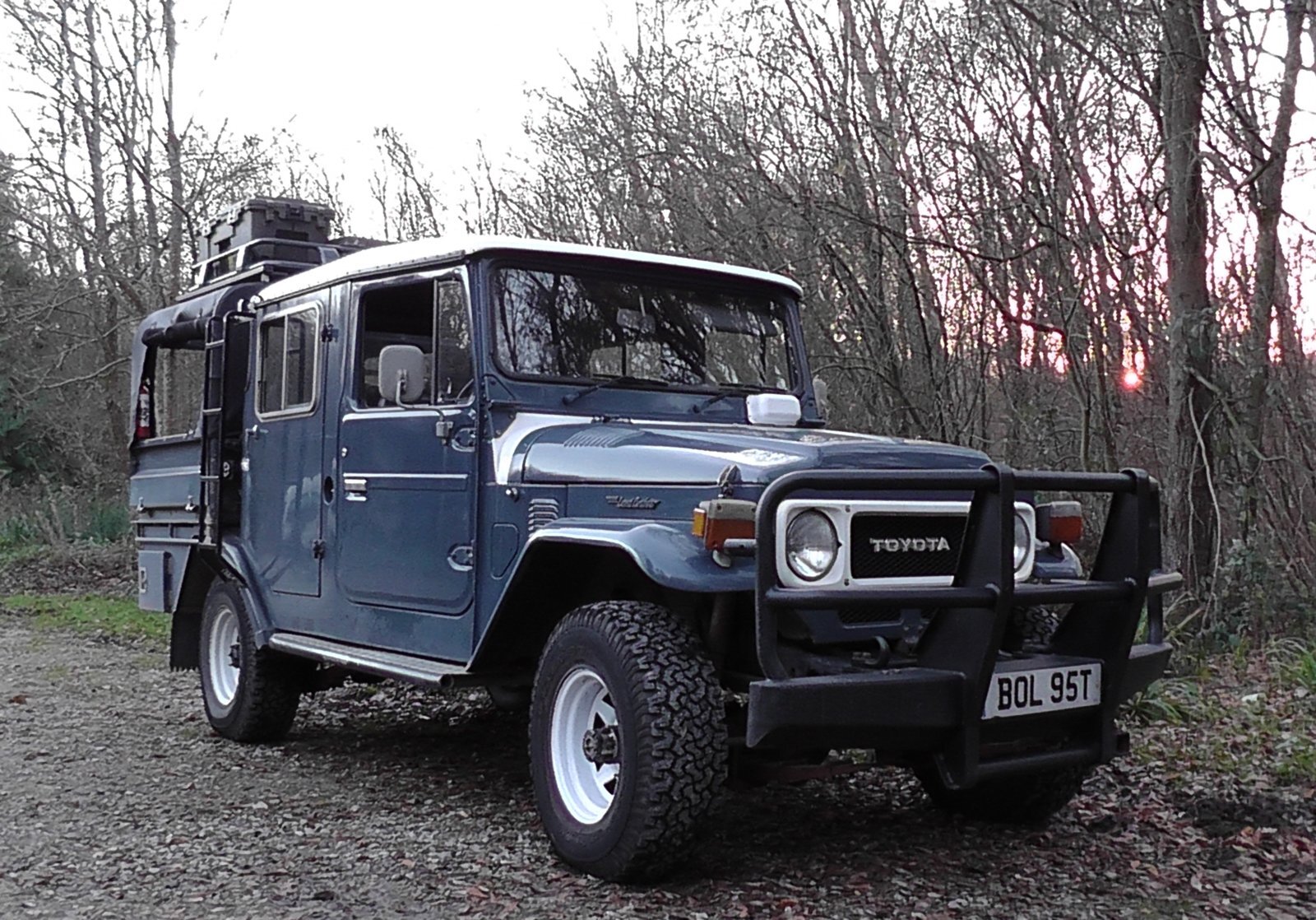

Oh and in case you're not familiar with my truck it's this modest little run-around!
She is a beauty.
Whyou do you need to know what angle she will go over at?
This is where you need to get out and build up what you can do.
Alot of people don't know the limits of there trucks and then faulter when they need to know what's going on.
There is plenty on places in the UK that you can take your cruiser offroad and get a feel for what's happening and I can assure you how capable it will be.
Neat truck Cliffy, love the colour. Doesn't look too lofty so it should be well planted.

Mmmmm, oh man, I've just seen the photie of your truck, she is a thing of beauty.
Lovely. :clap:

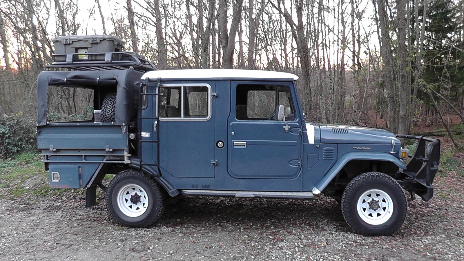

Yes, it's not too high - 6'.4" at roof, and 7'4" at roof rack, but it only has the 31" tyres, which I'll prob replace with 33" at some point. Here's the truck from another angle!
Got to agree there Clive, that one heck of a lovely truck. And good reason to not want to roll it. And good that it will be used for what it was designed for.
Still love that colour.
Yep, it could certainly take bigger wheels, visually at least.
Errm, how does one get in the rear door with that ladder in the way? :think:

The ladder just hooks on and off the sides and rear of truck.
The colour is original too. Under dash etc is all the same. Obviously originally this was a pickup, but the mining industry commissioned Arkana (Aus coach-builder company) to convert a number into crew cabs back in the 1980s. So, they had to paint the new body sections to match, but I've seen others in this colour.
