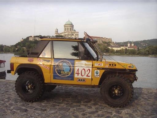

Jim, you know all my toys are from hard work so dont give me that one ya lazy sod - all you need to do is 20 hour days for 4-5 months at a time :shh:
one old NBC welder and a budget of fek all;
one rusty turd
add tarpaulin, snow, rain and a 30 degree incline
and go trophy raiding..
My tip for what its worth;
go to college and do a course, then weld anything and everything that passes by slow enough to fire up the plant for, then go back to college and do all the follow up courses, repeat process until you think you've got it...... at that point you'll understand what a weld is and what it needs to be, you'll know what a good weld should look like and why your welds need constant improvement. I try to do a bit of welding here and there and find it a constant learning process.
