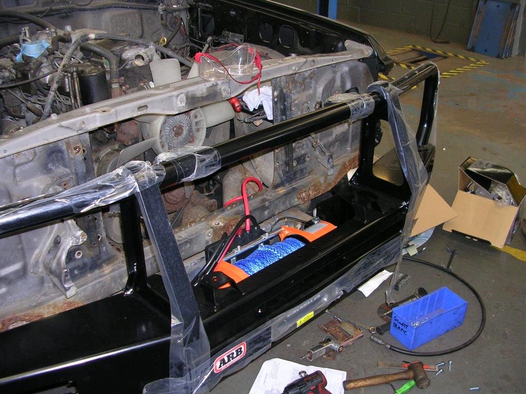

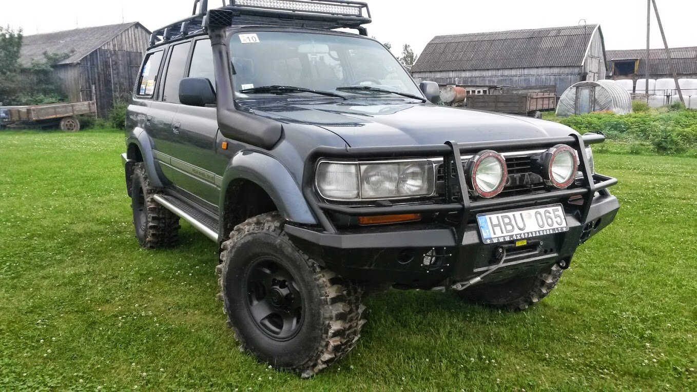

Can anyone indentify the below winch bumper ? If not can anyone recommend a good combination of bumper and winch suitable for my needs based on an extra vbehicle weight of 300kg approx

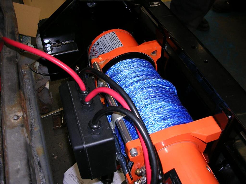

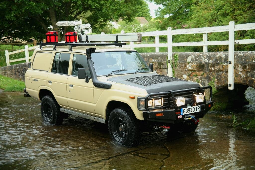

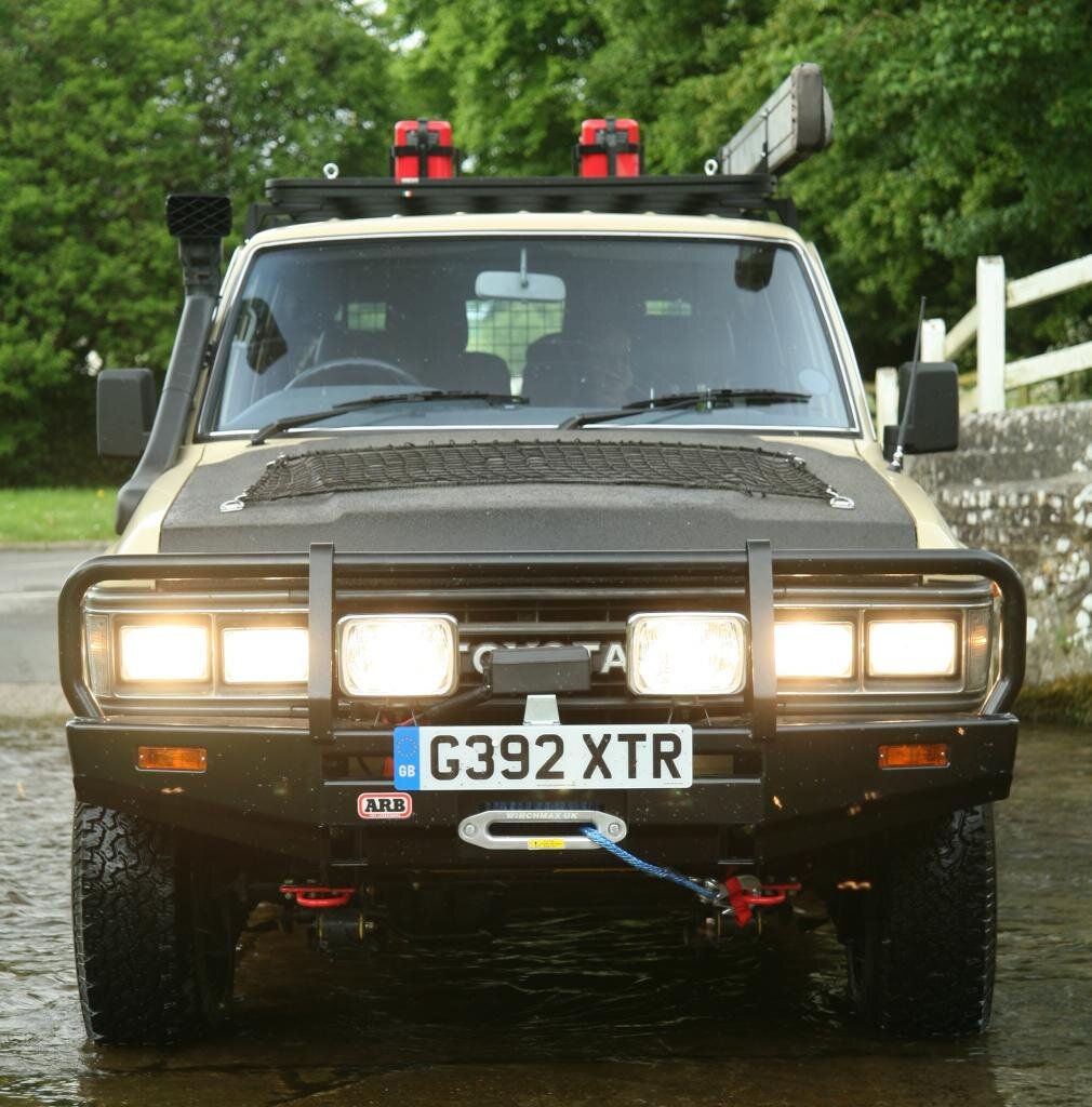

I believe the bumper must be EU marked, it must also have a winch fitted to be legal, you can't just have the bar. I've got an ARB on my 60 with a winchmax 13000lbs winch and plasma rope (plasma reduces the weight massively and is also more suited to occasional use where a wire rope would corrode)
Pretty pleased with it all. The winch is exceptionally well made, and cheap, but that money had to be saved somewhere and thats in speed, it is slooooooow but for me thats not a problem as like you it's just for self recovery in emergency.

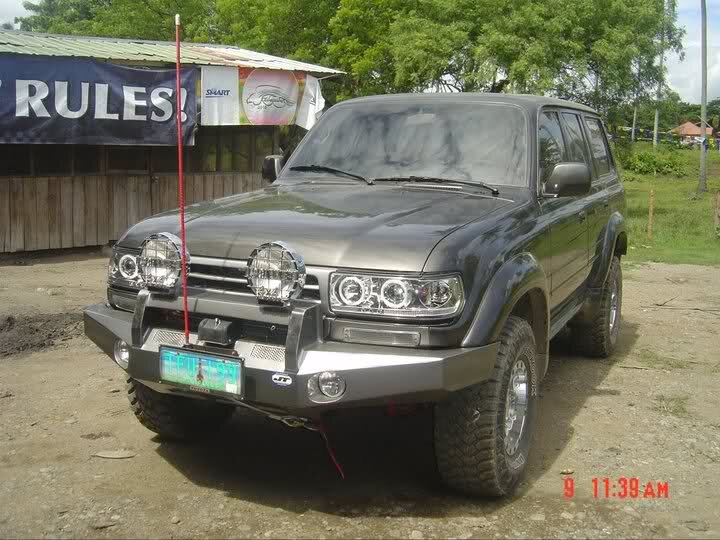

My guess it's from the States, but it's smart.:thumbup:
