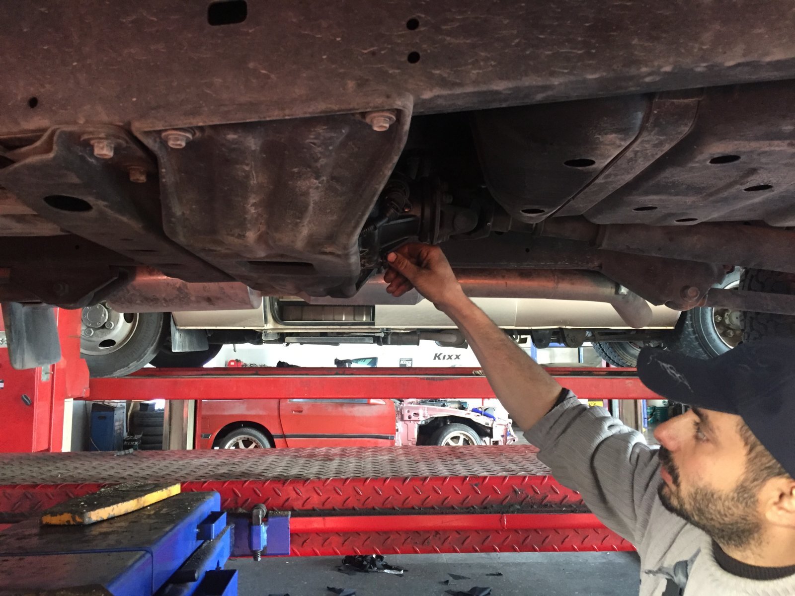

Guys Axle serviced today something easily forgotten with time.
Front was bad will have to change again in a week or so. Rear ok and the gearbox rear end swival shaft changed also.
41B8DDF6-9AA5-49B1-9A32-0ED6B7A77634.jpeg 107EE6DB-A97C-45EB-84D8-35171E807290.jpeg

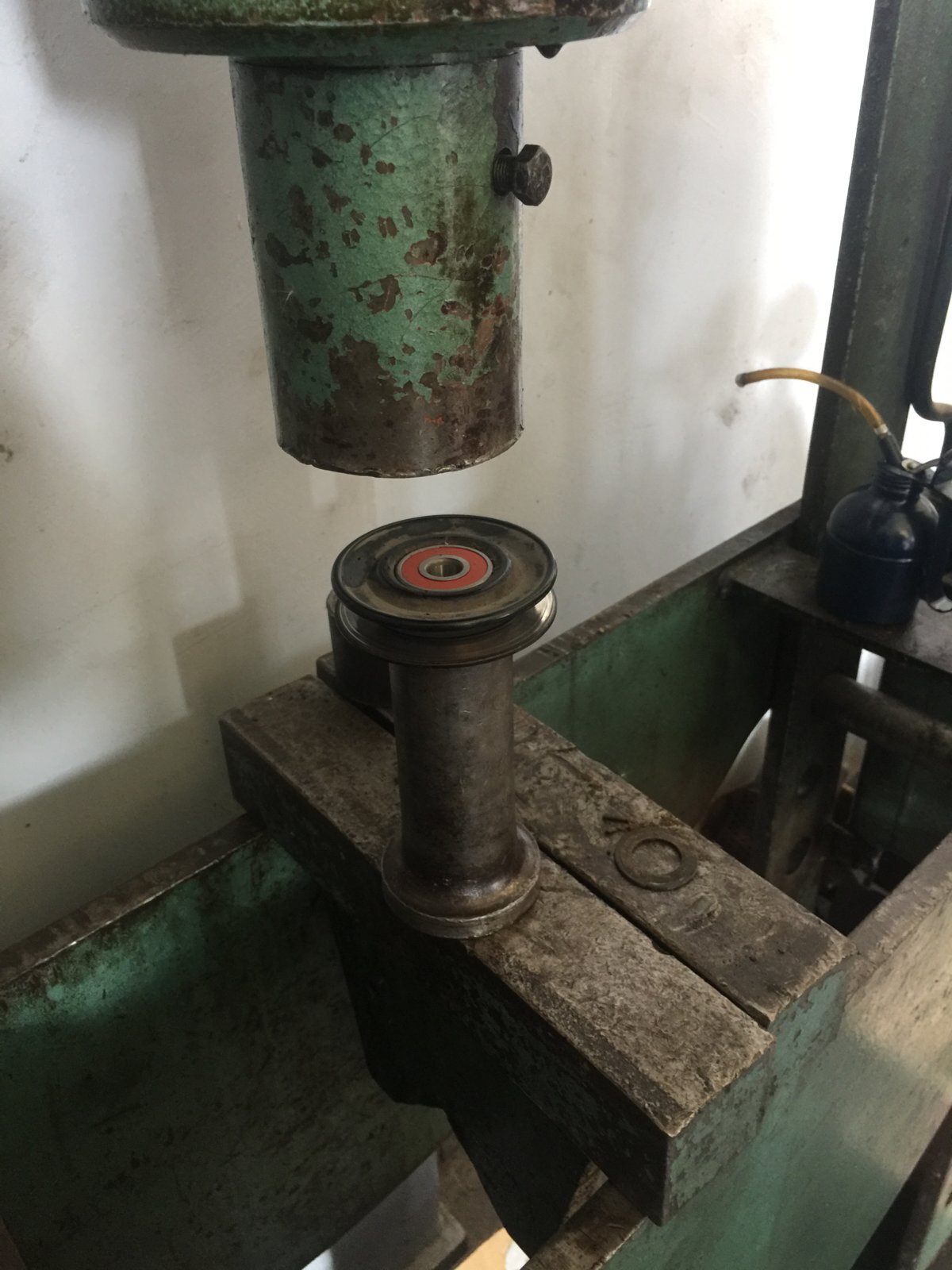

Guys last few weeks noticed a noise coming from the engine pulleys & having a better check it appeared the small pulley next to the a/c condesor was the issue.
Pretty simple fix with a new bearing and back to its best again.
E4BF3C78-13E5-4CA2-96A2-58227F6C4DC8.jpeg 72663077-0D9B-494D-A6A3-1342DAE06199.jpeg
I've had to replace a couple of those. It's a cheap little bearing and spinning from the day it left the factory. So 20 years later it's not a surprise really. One went when my Missus borrowed the Cruiser to go to Cornwall one weekend. It just disintegrated. She listened over the phone and managed to get the AC belt off over the fan!!. I told her to just cut it. Nope, she did it the right way and carried on.
Yes Chris this must be the only one left I’ve not changed until now.
Your missus is awesome to have done such a job... most don’t even know how to open the bonnet / hood :clap:
