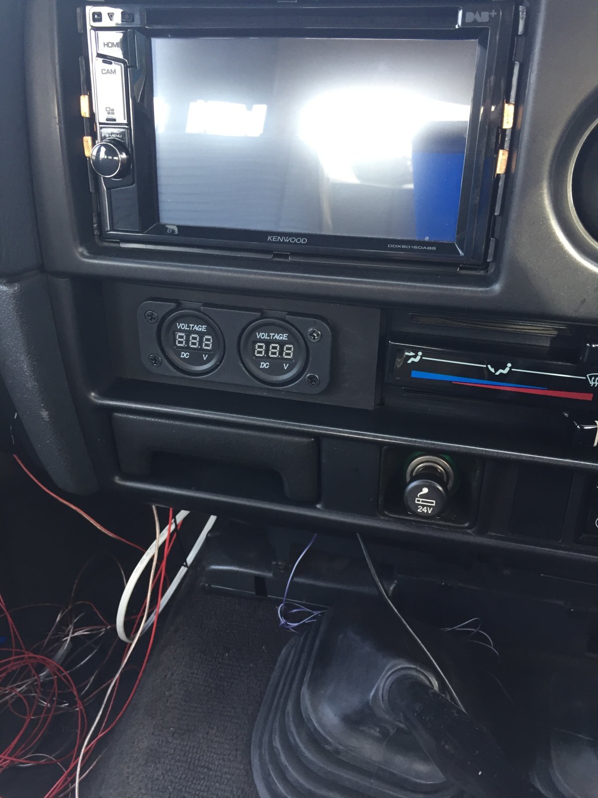

Installed a pair of voltmeters. The left one will display the left battery voltage (which has been draining) and the right one will show combined voltage of the pair of batteries. A relay will be utilised to ensure they only come on with the ignition switch.
Once wired up the charging status should be easier to monitor
Luckily there was a spare space with a blanking plate so very straight forward dervis. Mounted them on a sheet of matt black 3mm thick perspex which was easyto cut and drillNice touch there Ben looking perfect
