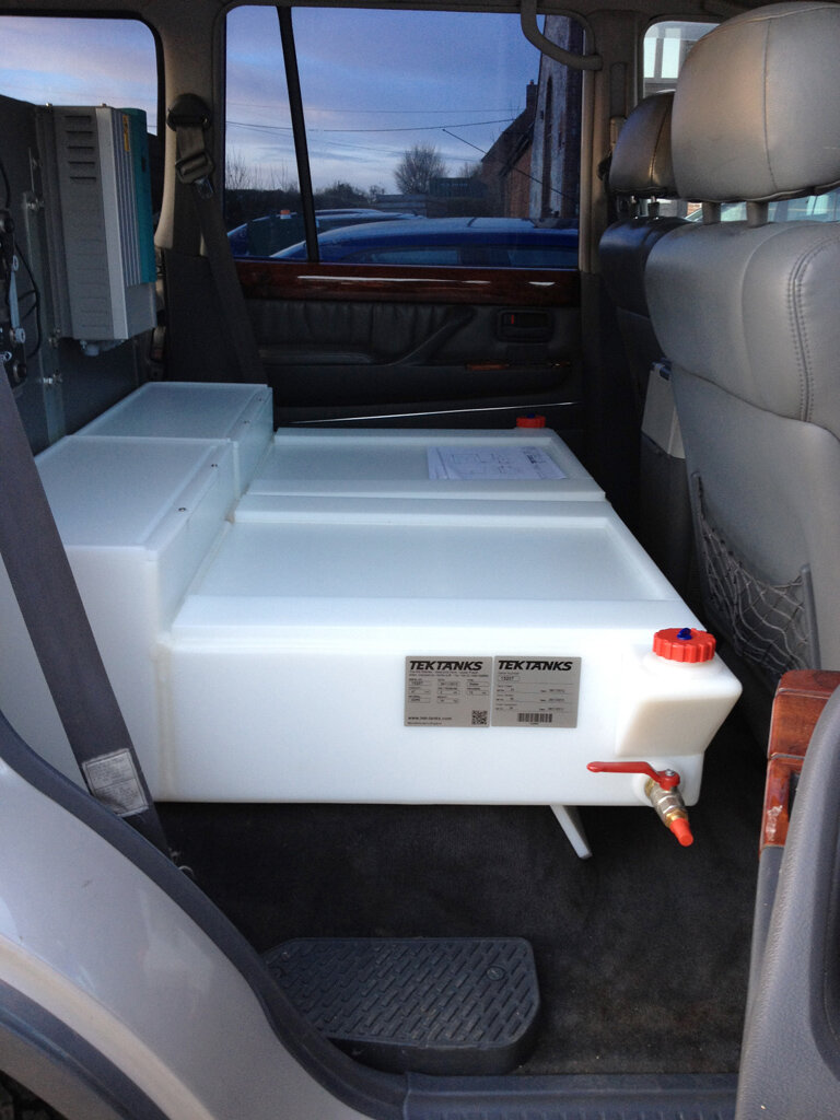

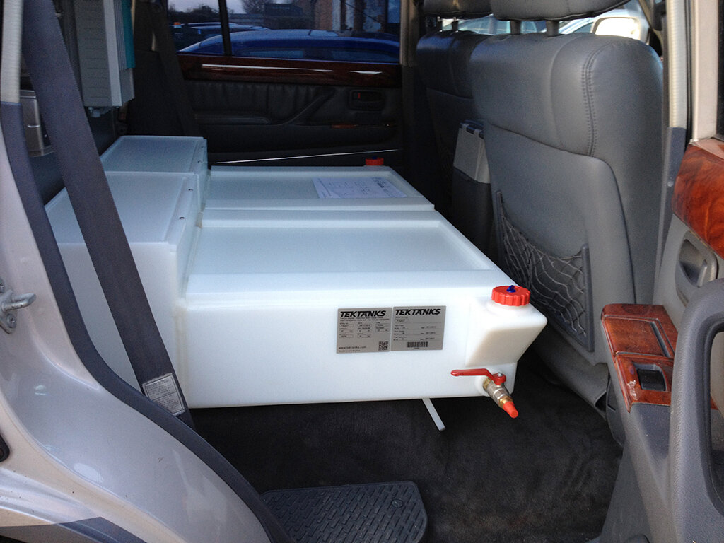

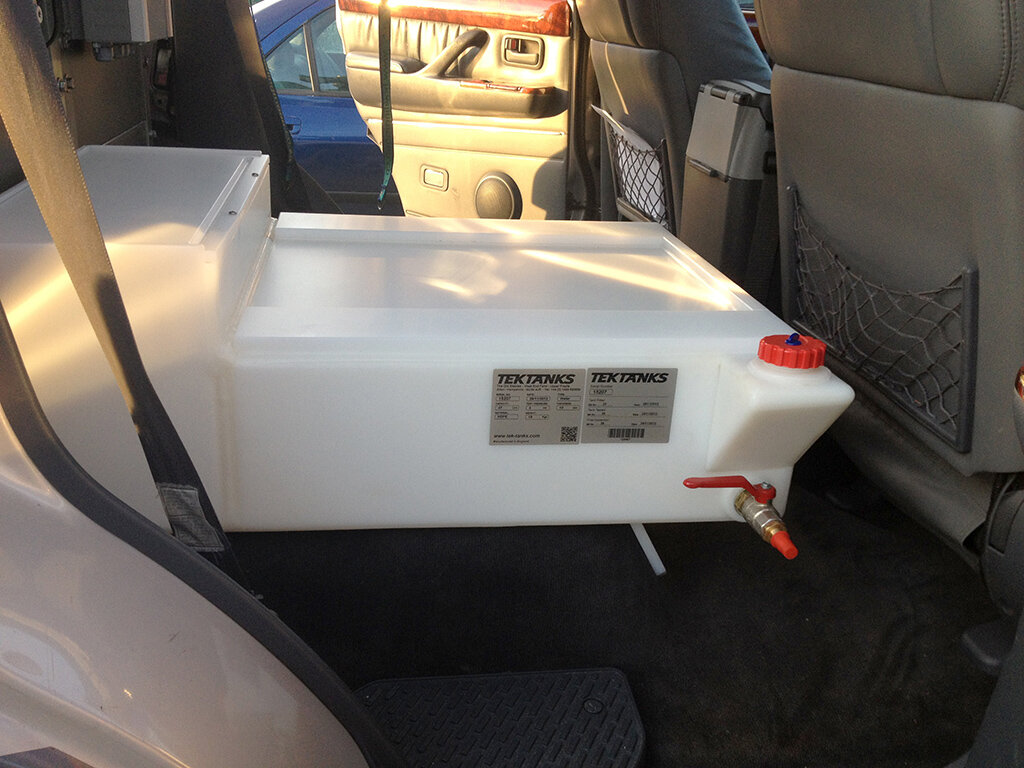

Tek-Tanks fresh water tanks
I had the two new bespoke fresh water tanks installed in the truck. The water tanks with battery boxes were designed by me and Tek-Tanks to fit perfectly in the truck behind the front seats. Tek-Tanks manufacture all sorts of tanks for the marine industry. www.tek-tanks.com

Very nice Marius.
I am in discussion with TeK Tanks about my needs after having had the discussion with you at the Elec day.
Thanks Warren.
That is very good news and I’m glad you are going with Tek-Tanks as they are an exceptional company.
Those tanks look good Marius. :clap:

They look great Marius, just remember there is water along the way and that might be a LOT of weight you may not need (depending on your plans of course). Have a look at a Lifesaver purification jerry can. We used it daily and it served the 4 of us 100% the whole trip. Not one bout of any sickness at all.
Filtering along the way means you can carry a lot less.. :)
Thanks Warren.

I know it’s a bit over the top but we wanted a modular design that could hold up to about 80L of fresh water for those long stays in the deep desert. We are also fitting a long range fuel tank and two big solar panels to be completely self sustainable away from civilisation.
