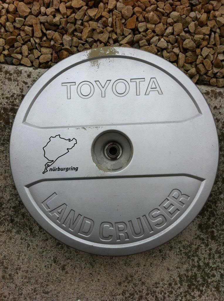

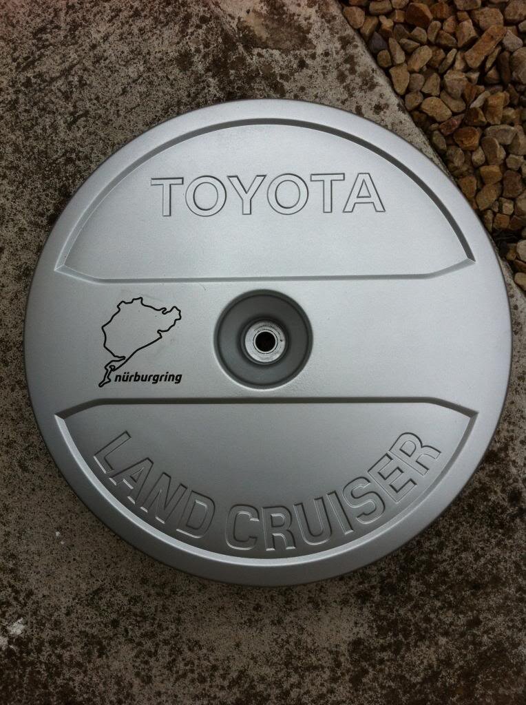

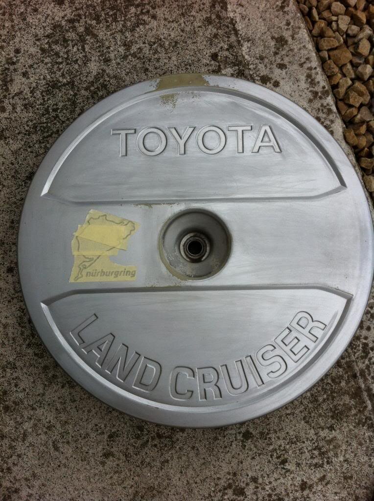

Decided to improve a couple of scrapes and paint marks on the cruiser today. There's plenty of scratches and stone chips, most are tiny, but two big scratches on the front bumper were annoying me lately. I put the passenger side one on it, the other one was there when i bought it. Also resprayed the spare wheel cover as it was faded.
Wheel cover:
Scratches:
This is rough enough work by any standards!! but its better than it was. I don't have the time to set up the air gun and all the rest or to spend hours sanding. Plus I already had the aerosol primer and lacquer. Total cost €12 for a can of Lucerne silver
