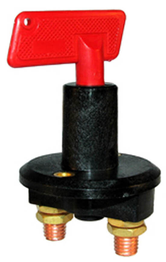

You just have to make sure it's able to handle the power so I would probably start with at least 500amp one make sure it's wired correctly and is securely mounted to the vehicle and don't turn it on or off unless in an emergency when operating the winch. Mine was a similar type to this one I found a pic of I use to take the key out and keep it in the cabin and when I was heading out bush I would put the key in at home or when I first arrived at the track I was heading down so it was ready to go if needed. Also you don't put a fuse on a winch.

I think you're misreading what I mean by kill the winch. I didn't mean damage it in any way. Same as a kill switch wouldn't. It kills the power. Also I am sure that you get rain in Oz, I know you do. But you don't have quite the weather we have here with salt spread on the roads etc. Here, Im afraid those plastic rally kill switches last about as long as a pint on Melbourne Cup Day. Or possibly about a long as a Warn winch in winter. Salt is the ruin of many vehicle and components. Where alloy meets steel is a real sore point.
Ok some switches can fail or the set up is wrong. So I'm just wondering why would this type of switch wouldn't last long where you are ? Mine was mounted drivers side up high behind the battery out of harms way but easy to get at on a GQ patrol. I don't have salted roads to drive on but live near the beach in the tropics with high humidity and salt mist covers the cars often because my vehicle is under a carport exposed to the elements and it's fine.
