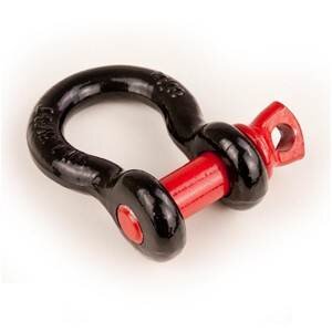

I was told something interesting recently........................
A D shackle like on Stevens pics above shouldnt be used for snatch recoveries, D shackles are not for shock loading.
To demonstrate this the guy that told me was told to put a strap around a tree and attach it to the back of his car using a D shackle. Then told to try and drive off.
He did and the D shackle was then too tight to be undone by hand and they ended up having to cut it off.
Instead he should have used a Bow shackle as the shape of them means they can flex and stretch slightly and then still be undone. :think:
I dont know if this is true or not its just something I was told? :icon-smile:

I would fully agree, D shackles can distort quite easily, unless you are using one that is MASSIVELY oversized for the job in hand. I have used them a lot over the years attached to chains moving machinery/scrap and they are not as undeformable as you think. Actually in my opinion 'D' shackles are the worst pieces of sh1te going.

My recovery kit is made up of bow shackles like Ben has posted above; I get mine from the industrial suppliers (Bearfast, GasWeld over here) rather than the 4wd shops... often cheaper and sold alongside gear that is designed with a a full set of load limit documentation.

D shackles can also only be used on a straight pull. anything off straight a bow shackle should be used so the rope, winch hook etc can move around the shackle off axis. with a D shackle it will slip, putting a lot more shock loads through the equipment.
