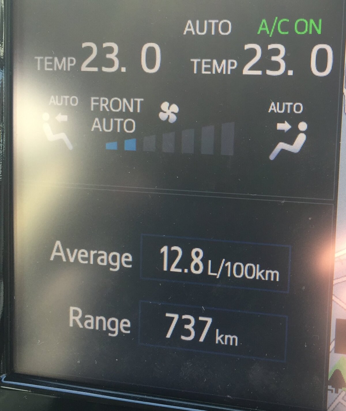

I have a 2017 200 series Sahara. In 12 months I have clocked up 30,000klm mainly highway driving.
I have an issue with the range function not being accurate.
The system shows my average being 12.8 l/100 klm
Having filled the car to full, and drive off, the range shown is ONLY 737 klm.
With a 138 litre tank and the above fuel economy I would expect over 1000klm range.
When the car was new it would show over 1000 klm range.
Toyota have looked at it and say the system is working normal, and also takes into account idle time and fuel burnt durning DPF regeneration (noting I have never had to manually do DPF because of the highway driving).
The handbook says range is calculated on the average litre/100klm.
Has anyone else had a similar issue and what was the fix??

Max Borgen
Mar 14, 2018
3
australia
Hi Grant, I have done a separate trip to manually confirm the accuracy of the ltr/100klm calculation. the distance this time was 100klm and the vehicle calculation is correct. The issue appears to be with the range calculation.

Hi Nick, thanks for your comment. Your comment makes sense. My car is calculating fuel used in litres /100 klm. This varies when towing or around town as expected, I have also checked actual fuel used when refilling which is also correct. The issue is the range calculation is not correct or even close based on fuel used / 100klm and fuel tank capacity.
uHu
Mar 7, 2010
2,184
norway
The figure makes sense if it's for the main tank only.
What happens when you press the sub tank switch, does the range change? Or maybe the sub tank is completely out of the equation for the computer.

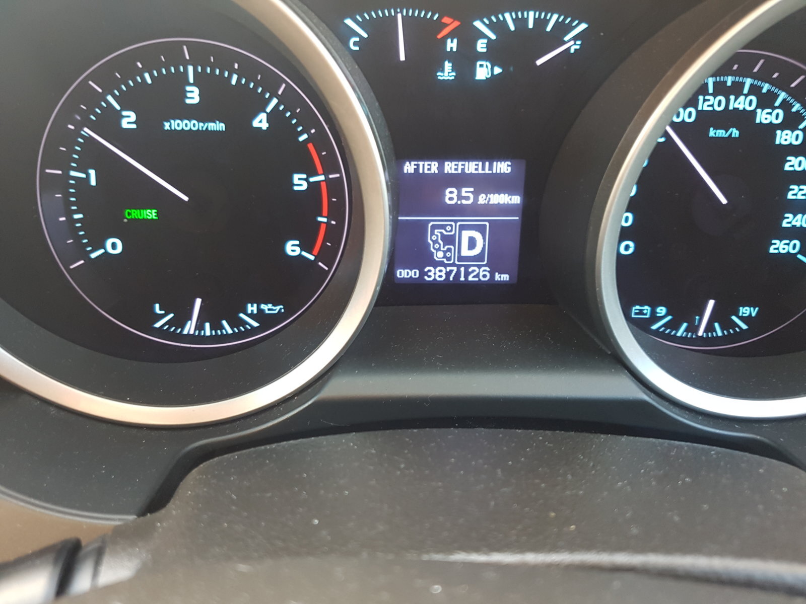

ctiley
Jan 19, 2013
36
australia
I'd be taking the car back for a tune up if that is your average highway fuel consumption. I have a 2008 VX with close on 400000 km on the clock and recently on a trip from Townsville out west and south averaged 8.7 litres/100km using the cruise control. I use an Android app called FuelLog and record all my ownership costs as well as fuel expenses (it is also accepted by the ATO for tax purposes) and that backs up the car's computer for average fuel consumption figures. I don't know if it is available for those strange things called iPhone.
Paddler Ed
Aug 1, 2012
1,916
australia
Main tank is 93 Litres, Aux tank is 45 litres
If we go on the main tank being 93 litres, and the average economy being 12.8L/100km, then that 737km is about right - it ignores the Aux tank. What happens if you select the Aux tank?
93/7.37 = 12.6, so that 12.8 is pretty close - 12.8L/100km with 93 litres of fuel gives a range of 726km.
