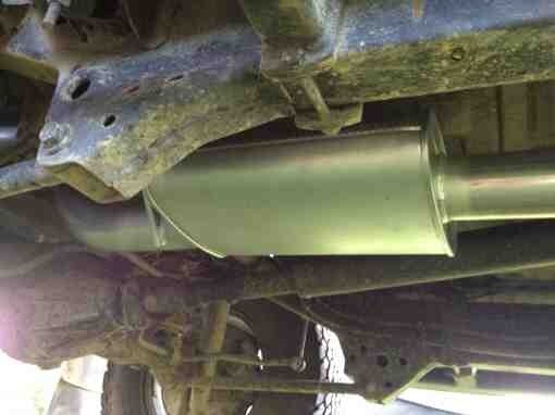

Towing our camper trailer around Australia I decided that we need more power. On the flat at sea level is fine, but up steep hills at altitude is a bit tedious and the truck is working harder than I feel comfortable with. I already have a Tunit box, K&N air filter and water injection kit, as well as the large centre muffler removed from my 2.5" exhaust. Up the big hills with right foot buried I can see a bit if black smoke which suggested unburnt fuel. So I could turn the pump down a bit, or I could try to use that unburnt fuel...

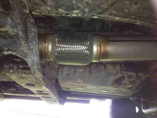

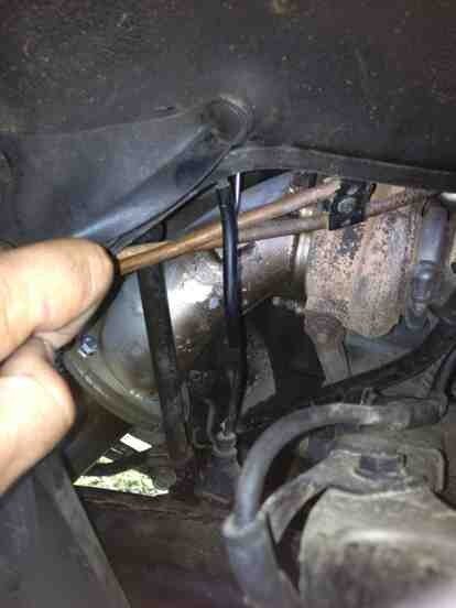

So first up I had a 3" turbo back system (includes the dump pipe) installed yesterday. There is a crowd called Scott's Rods here in Brisbane that are starting to make a name for themselves, so I decided to give them a try. I could also have gone with Beaudesert, but they were a few hundred $ more, and only do a 2.75" system for Prados.
The difference in low and mid rpm torque (up to about 2600rpm) is very impressive - definitely at least 10% gain, maybe more. I am very happy with this mod!

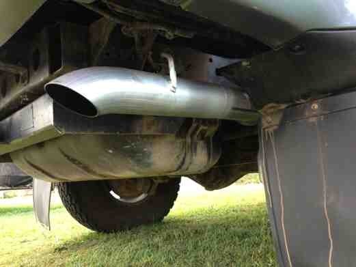

I asked them to turn the tip down so that it didn't gas me anymore when I hook up the trailer chains & plugs.
We're off to Landcruiser Mountain Park now so will try to get some vid of what it sounds like too.

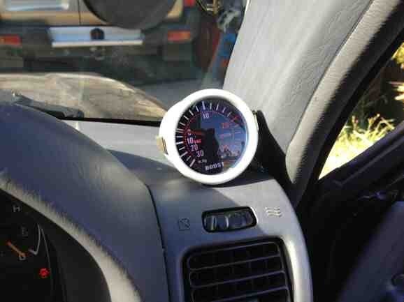

Tomorrow I will be fitting the EGT gauge and boost controller, which I'm looking forward to. And when funds permit, I will high flow the turbo. Lets see what the 1KZ lump can do
