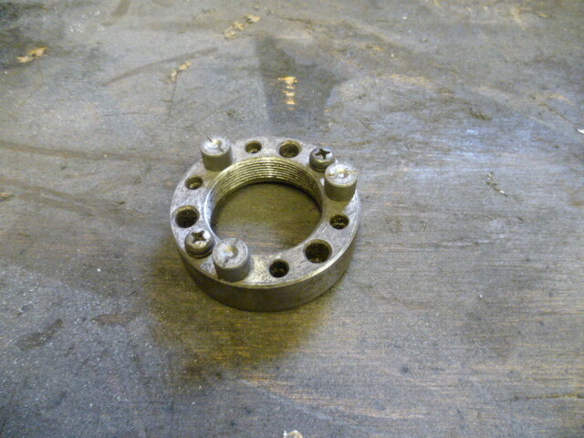

We have been discussing this SST recently and with my rear bearings and seals beckoning, I figured I'd do a proper job as with the rest of the build. No short-cuts this time. I am sure I could buy one, from the States yadda yadda. But then I wouldn't be able to post this, would I.
This is the little blighter that needs torquing in a rather bizarre ritual.

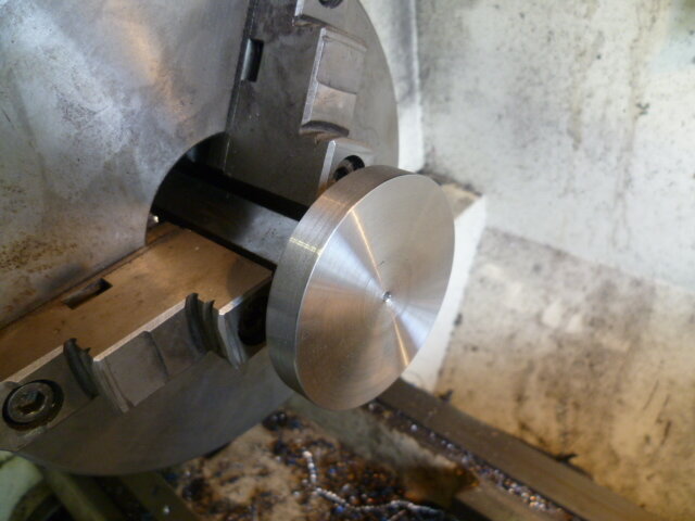

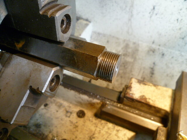

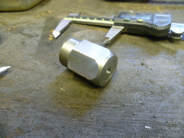

First turned a piece of stainless to size and threaded it.
Found a piece of thick plate which was then threaded to take the bar.
I then reversed it in the lathe and turned the plate down into the main section for the SST

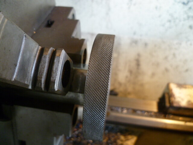

Added some knurling so that the locking ring could be done up hand tight

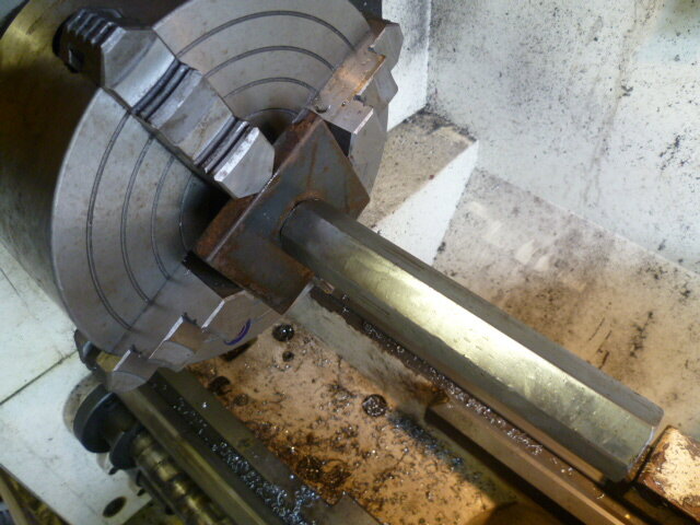

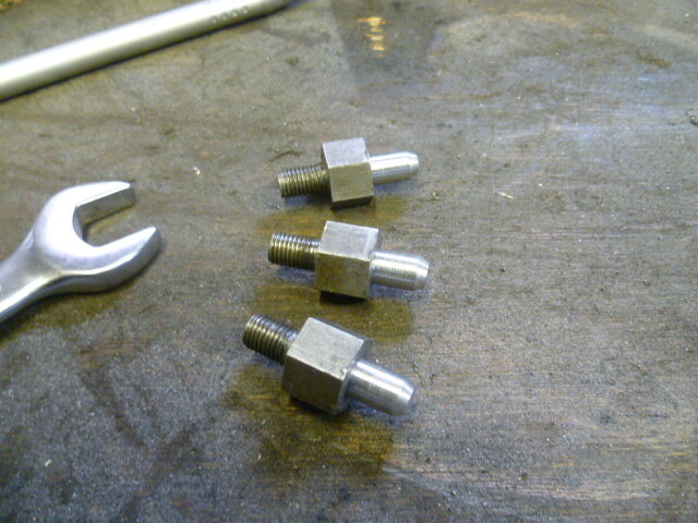

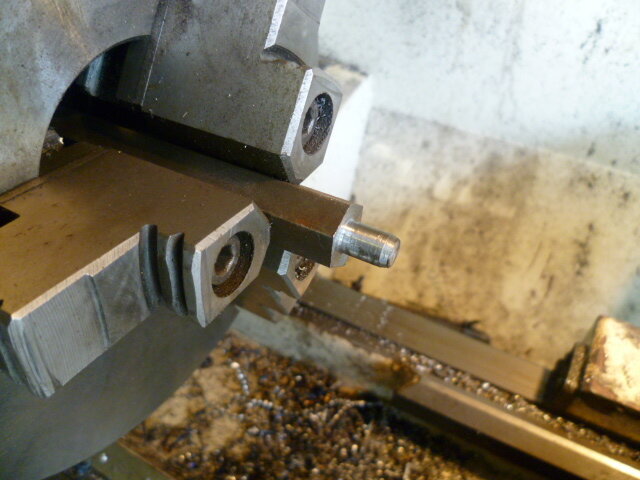

Then I had to make the three pins
I made those from hex bar too so that could be screwed in easily. 8mm on the plain end and threaded 8 x 1 on the other. BTW the PCD was 57mm

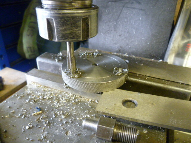

Following that I needed to drill out the three holes and thread them to accept the pins.

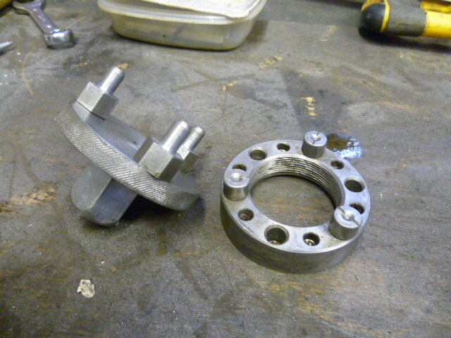

And then just a bit of twiddling and finishing and hey presto, a bearing tool. In a matter of mere hours.
Does it fit? Will it work? Oh you doubters you ...
