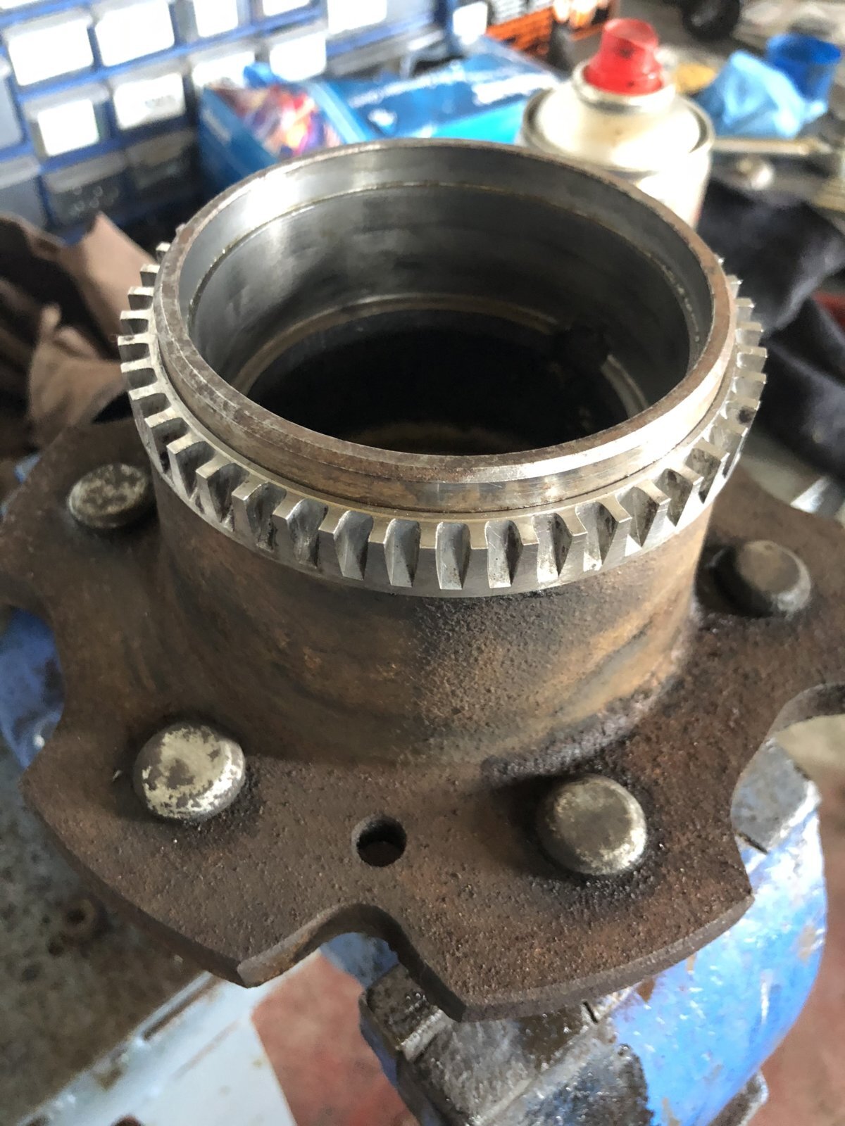

So yesterday evening I got the rear axle built up, stripped out the old bearings, races etc
New bearings greased up, races pressed in, new seals fitted etc.

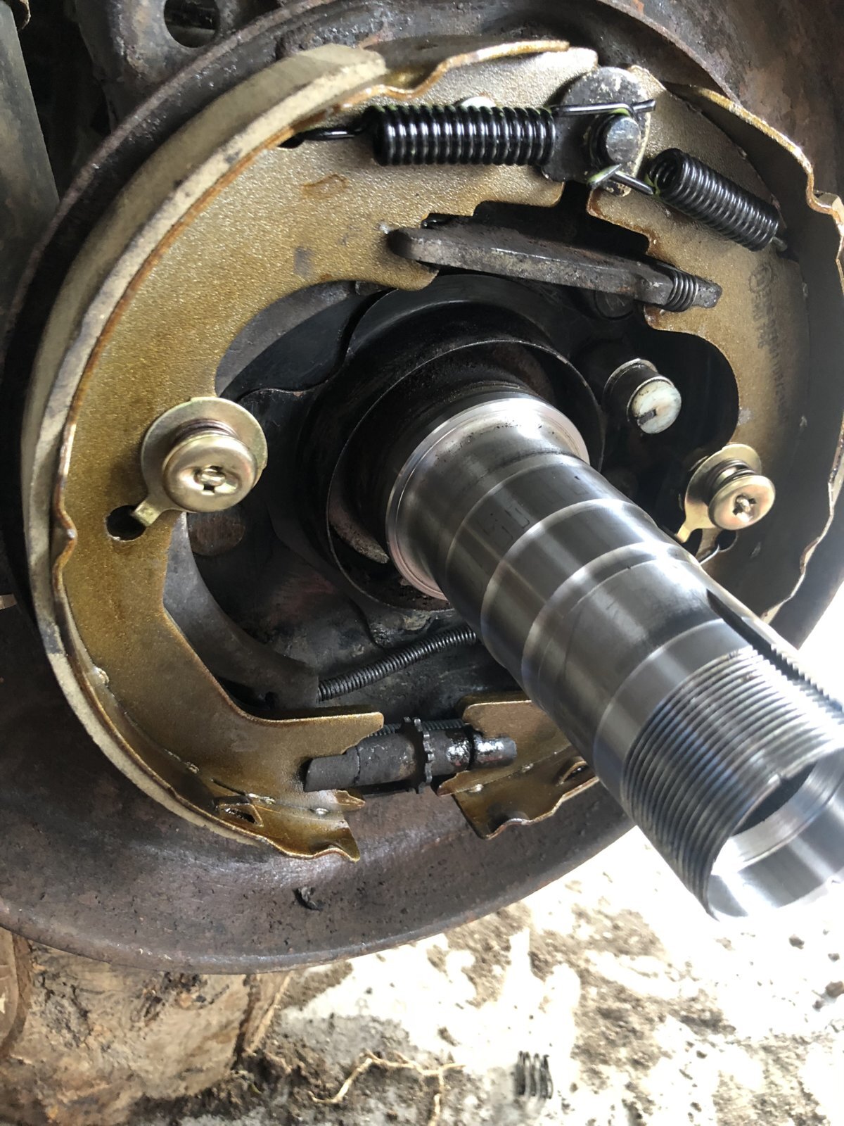

Stripped out the old handbrake shoes and got the new one fitted up and cleaned the backing plate when I was in there.
New oil seals fitted
