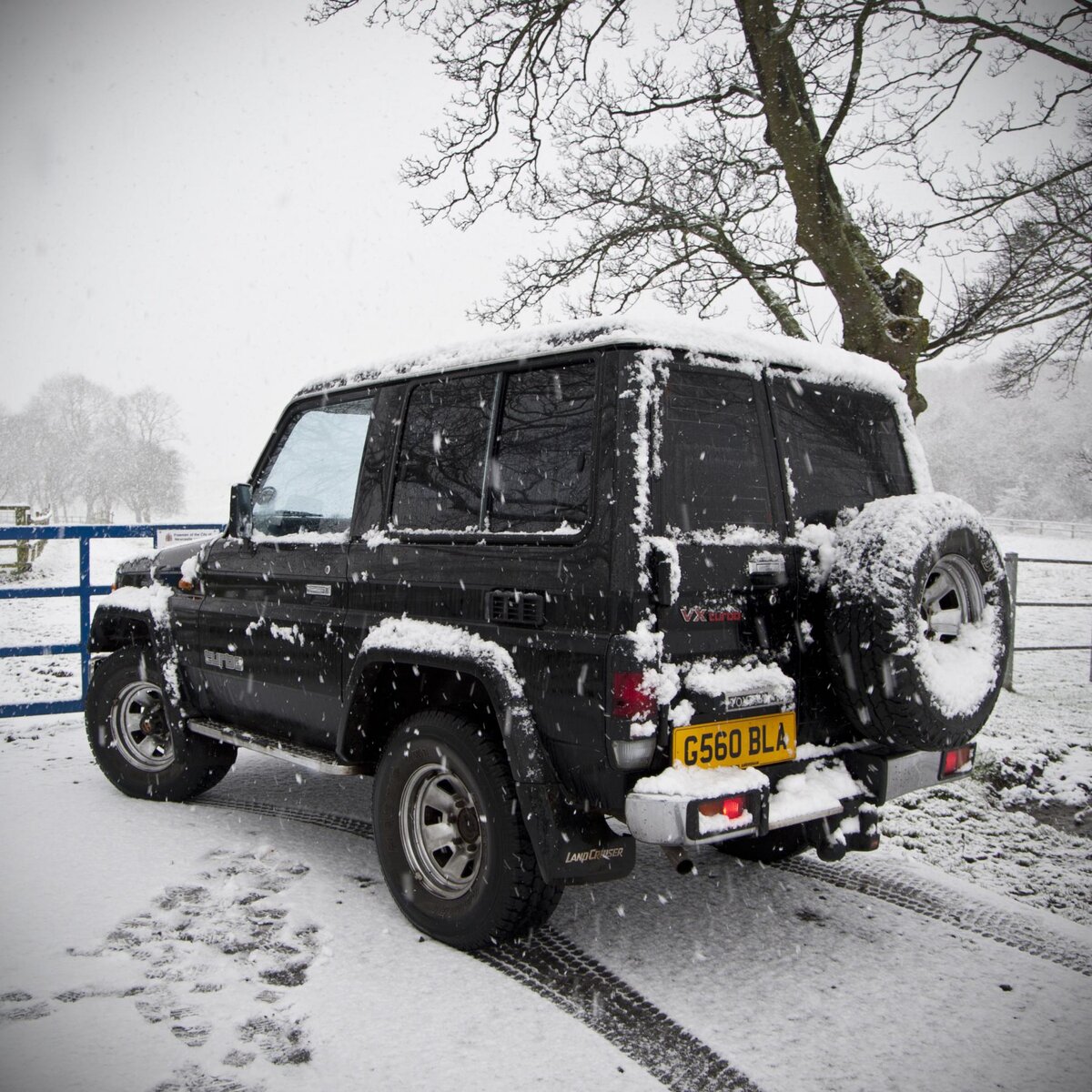

Hi all,
Thanks so much for all your advice on the tyres/grip issue in January. Haven't been able to get back on here until now (and yes Roger it was a genuine enquiry!!!!).
OK so I dropped the tyre pressure and locked the hubs in the centre of the front wheels - problem solved immediately. I haven't unlocked the hubs yet as we've had snow continuously since January. I plan to unlock the hubs as soon as this snow buggers off completely (I believe that's the right thing to do so as to reduce wear on the diff and improve MPG).
The tyres I have on have excellent grip/tread although may well not be the ideal 'snow-tyre'. I appear to have a really good, new Dunlop tyre as a spare on the back and then four 'Radial Maxxis 751' tyres running on the vehicle. I've never heard of them so not sure whether they are crap.
Anyway, here's the beastie in the snow ...
Lovely looking 70 BTW (there really is something about black that's so irresistible!)
I wish my 80 had a split rear door like that.

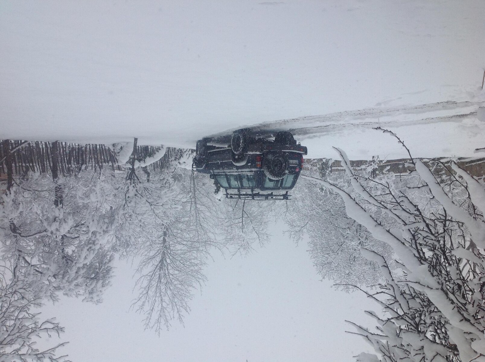

Mine does and I love them!
Damn iPads, never know which way up photos are! :-(

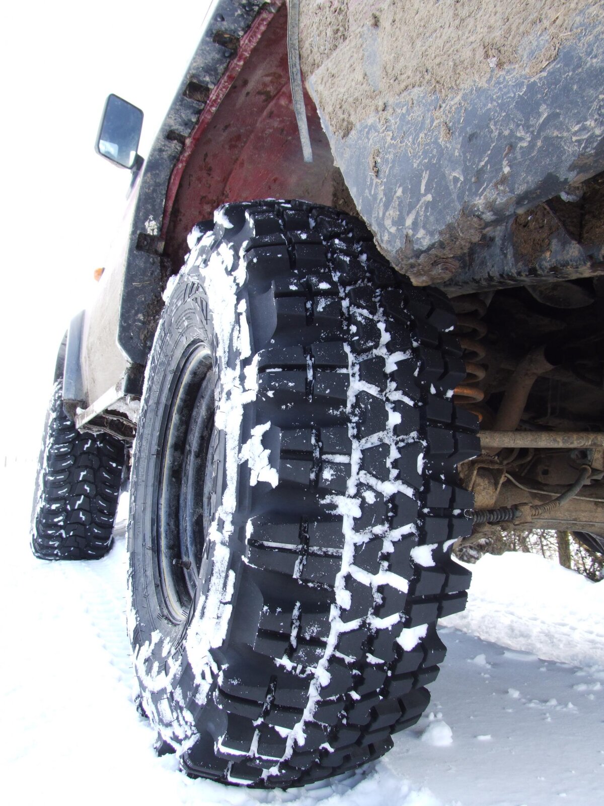

Fitted these on the rear when the snow arrived, when in L4, 2nd gear and low rpm. Up here in the sticks of wales the 70 has taken on some fair drifts. The trick I have found is when on a un broken track to go slow - the grip is there! To try as soon as traction is lost pull back and have another go. after upto 5 go's it will get through. By going balls out fast results in a 2hr dig out!
It has failed also, when the drifts are above the fence posts and taking up 30m of road!
All fun tho!![]()
Simex Trekker Muds, I presume. What size are they? 285/80/15's?
