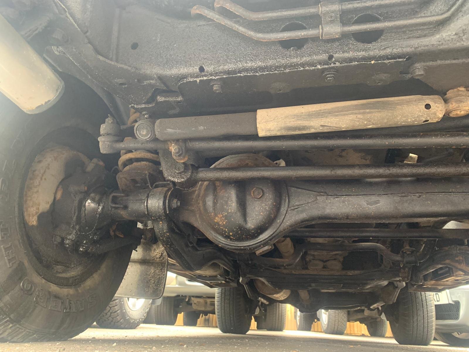

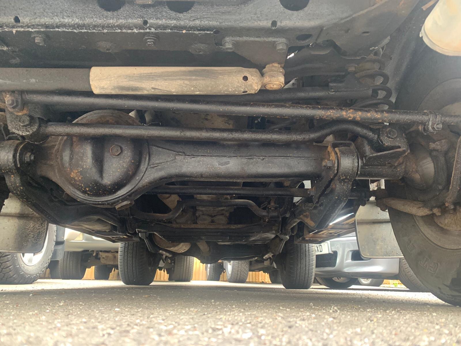

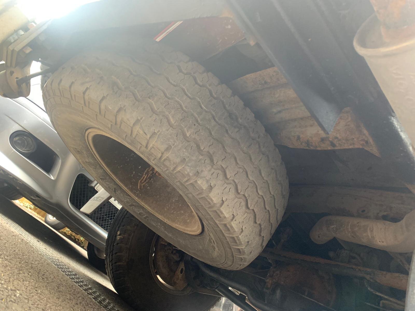

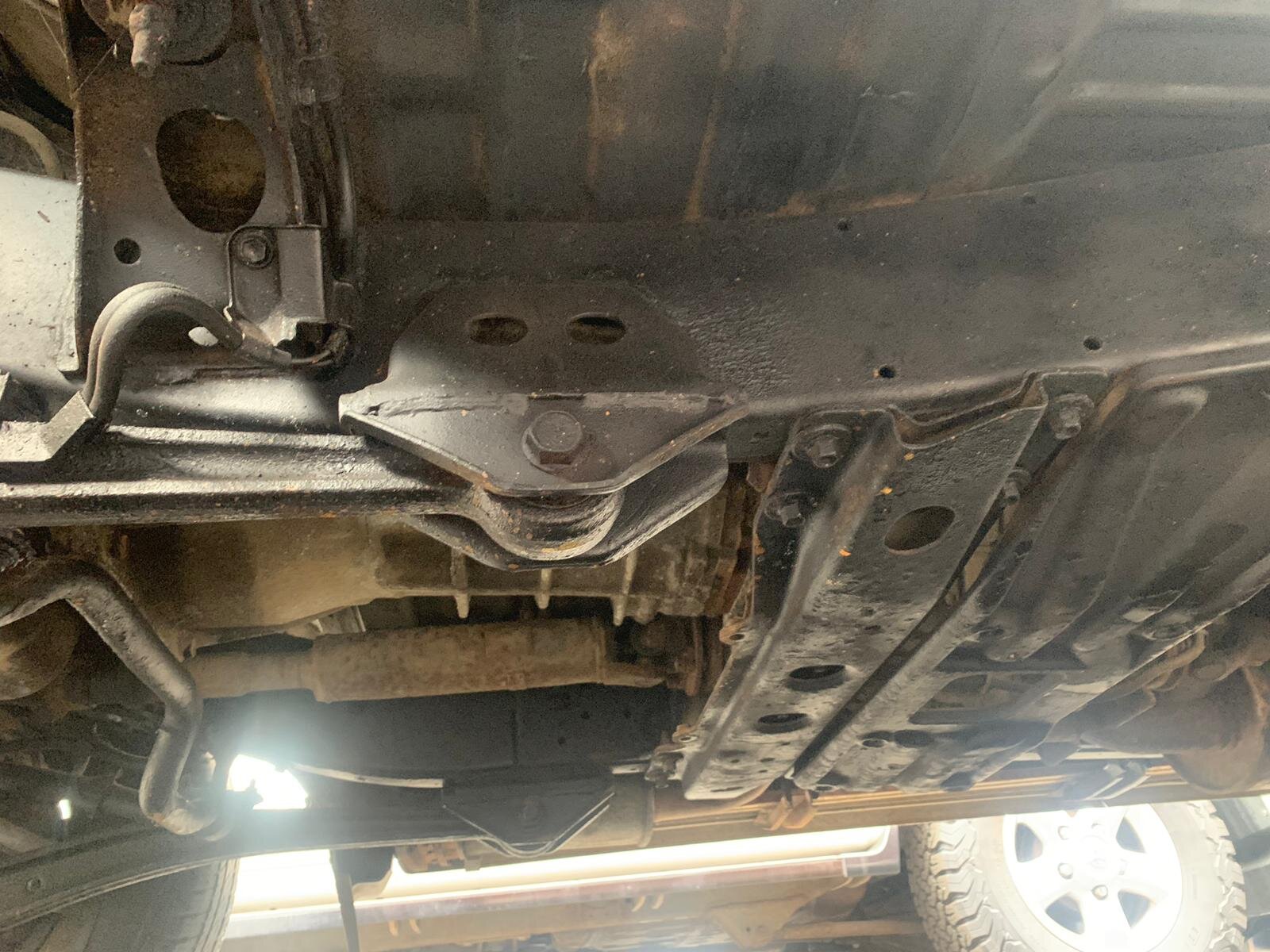

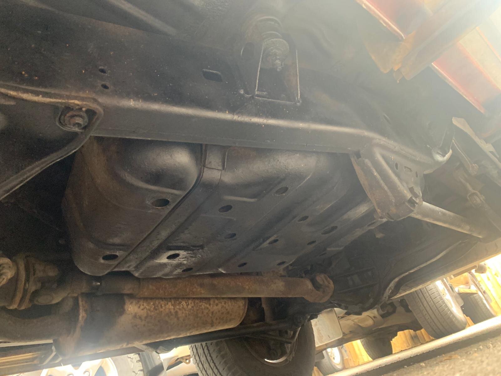

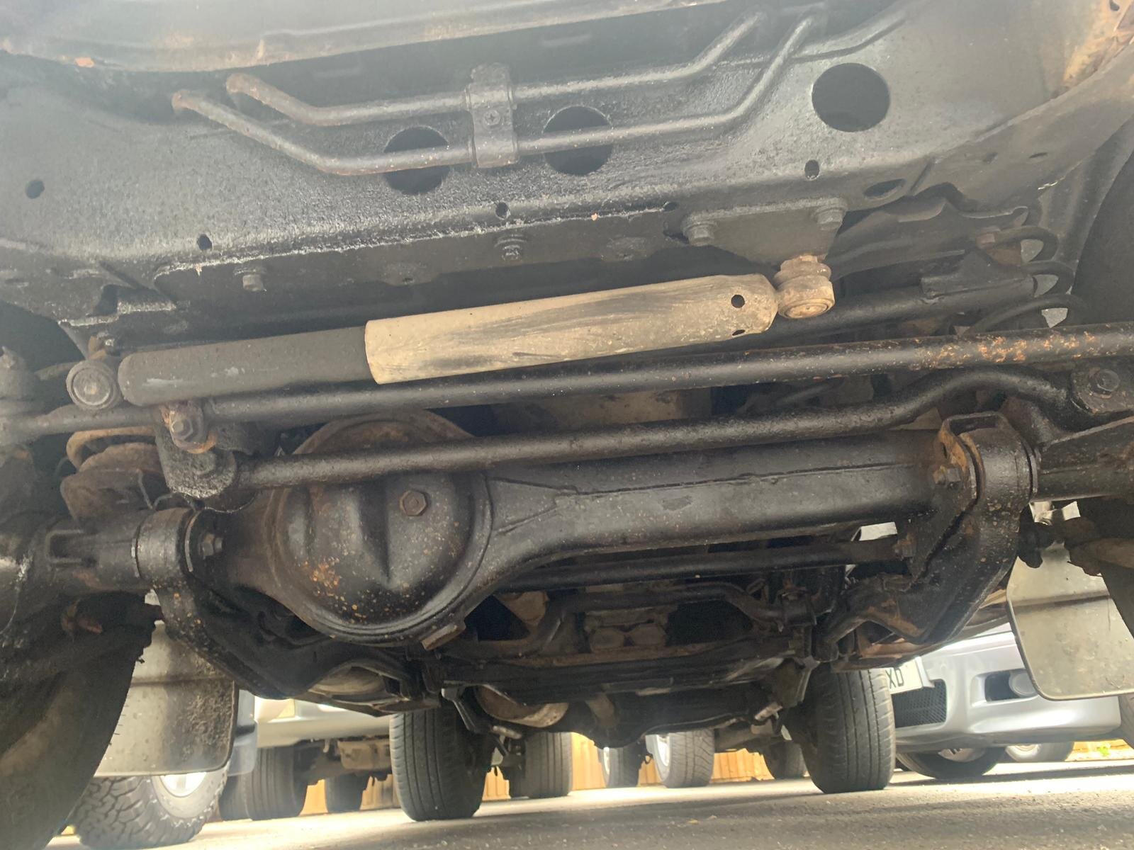

Hi all,
Looking for an 80 and have found a couple which looked OK from the outside but MOT history revealed a long and bitter battle with rust... As a former defender owner I am quite aware of what damage rust can do to a car, and I think I'm right in saying that in LCs body rust is a bigger killer than chassis rust, which can be dealt with a little more easily.
I've now found a potential cruiser with a mostly clean MOT history and decent enough mileage at what looks to be a fair price, and the seller has kindly sent me some photographs of the underside of the car. I've attached the photos they sent over - would any of you guys and gals be kind enough to assess what you can see? I owned a 100 Series for a while which I sadly (massive regret) had to sell in order to buy a house and that had way more chassis/running gear corrosion but still drove sweet as anything.
I'm looking to get any work to 'baseline' it done at Overland Cruisers and Julian has been incredibly helpful in his reply to my email, as I expected reading such glowing reviews of his work on here. I'd prefer to buy something for a little less money which needs a little work doing and get it done myself for peace of mind, rather than buy something which claims to have had loads of money spent on it and find I have to spend a fortune anyway.
I'm going to look at it on Saturday so will be able to take a look at any bodywork corrosion issues then, currently only have photos of the underside. If the engine runs well then I'll strongly consider it, but keen to make sure that rust isn't going to be a killer. If it's going to die an untimely death then it may as well be whilst I'm enjoying it!
Any thoughts very much appreciated!
Best, Shay.

Julian replied to an e mail? Well I'd start by framing that!
It looks very good underneath. Some degree of something or other has been painted on by the looks of it, but it's not like it's dripping with tar like somesuch.
Looks pretty good. But check out the sticky section here on the 80 pages to see what to look for in a good 80. They do have their rust spots most notably in the rear arches and front sills. Nothing that can't be fixed.
80s can have a very chequered past and many suffer from a lack of proper maintenance. Front axles and diffs get ignored and need a full rebuild usually. The rest is pretty bombproof. There are still good ones out there but as you've find, they take some tracking down. Do you have any more general shots of this one?
It's had a shit type underseal job to tart it up, but you'll be unlucky to get chassis corrosion anyway.
Look closely at the rear axle top link mount pillars. A boat launching 80 will have paper thin mounts or thick with loose rust mounts hiding paper thin mounts.
The panhard rod mount also dissappear's from inside out and if the axles rotten you can guarantee the difflock actuator is a pile of £350 dust.
While you're under there, look across to the rear of the rear arches and have a poke about, it collects mud here and rots the area out completely, not a difficult fix from the outside and hidden by the bumper corners when done.
Check the top of the rear arches where the seat belts mount, it's hidden by plastic but they rot there too, not a difficult repair but an MOT fail.
Rear of the sills / front of rear arches are also a typical area, again not a difficult repair. Body mounts directly next to them can get quite bad too.
Front of front wings, quite often there's nothing under the plastic.
Same area, front body mounts can suffer too.
Windscreen / rear window surround.
At least one of them will be bubbly with rust due to loose fitting rubber surround, potentially a somewhat difficult repair

Looks reasonable to me. Might have had waxoyl or Krown sprayed on, but the top of the rear Diff seems to have been missed so that possibly indicates a DIY job as this would be easily seen if jacked up on a ramp.
