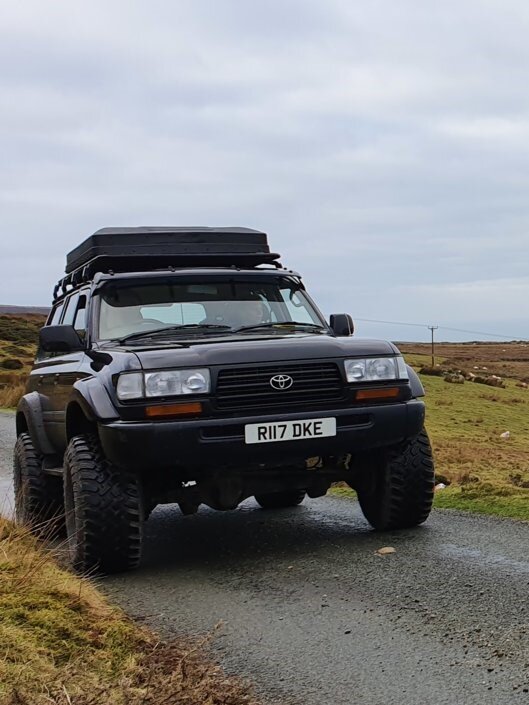

Its hard to tell from your pics but they look like standard collie alloys sitting almost flush with the wheel arches , which suggests skinny tyres and wheel spacers ?
Looks pretty good though so maybe you just want a similar sized tyre with an aggressive sidewall , cooper stt , toyo open country , BFG KM2 , Mud Rage off the top of my head
Shayne if I didn’t want to change the rim size what’s the largest tyre size I could potentially put on it ?
I think 265/70 on landcruiser 80 alloy rims is the subtle choice and it looks like it should have come from the factory new looking that way , Andy should be able to confirm ?
275/70/16's on 80 series wheels ( 0 offset) on standard suspension.
I've sold it now. With that set up there was the slightest rub. This was cured with a 2" lift, it didn't catch then. I did like it but it was noisy compared with the 120 I replaced it with.

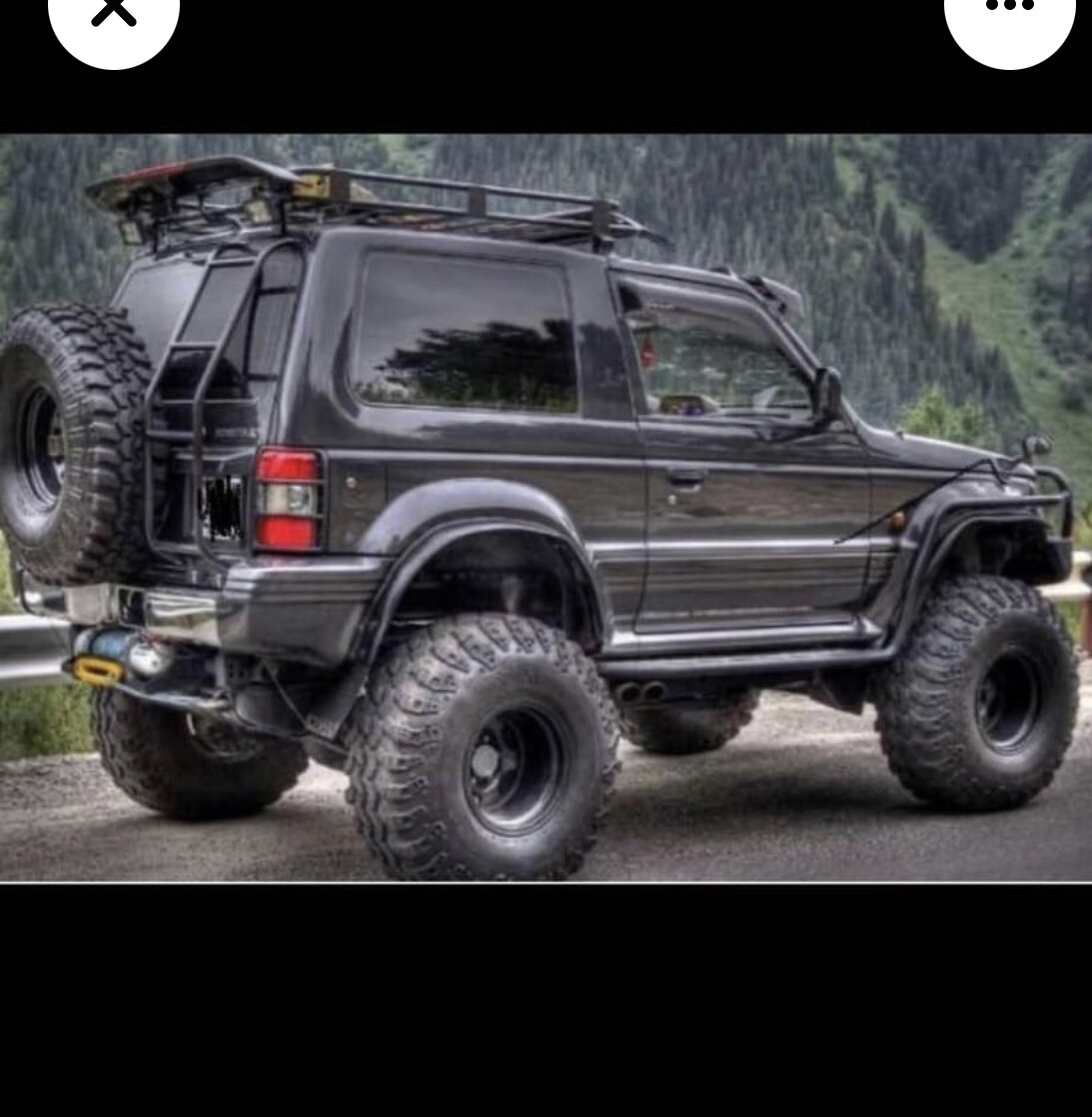

Hi Shayne
would you happen to know approx what wheel size are these on this shogun I really like these wheels and ultimately want these on my swb landcruiser
I don't know much about Pajero's but at a glance I'd guess 15x10 with a -35 offset and 35x12.50 tyres .
