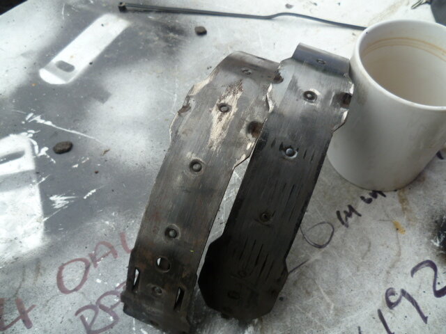

Took the green one for the MOT last month. Flew through. Adjusted the handbrake before I went. It was all it needed. A few weeks later the lever came right up in the cabin and I had no hand brake. Ahh, I thought, maybe a spring has come off. So today, drivers side off, all perfect. Went round to passenger side.
Think I have found the problem.
Mice have eaten the linings. All I found were a few chunks of shoe about 4mm thick in the bottom of the drum. It was all there a couple of weeks ago. So, new shoes please. Other side is perfect.

Don't think so Gary. If they were a little tight (which they weren't) it would just 'machine' off a bit as the wheels went round and it would be fine. A set of handbrake shoes should really last forever. There's no wear if adjusted properly. These have disintegrated.
Ouch, where did you get the shoes from ?
Seen plenty that have fallen apart before, some due to age, some due to adjustment or seized linkages, others because they were french crap :lol:
Any scoring to the disc? One on the left looks to have a polished bit? Bit of corrosion lower down too, maybe made the material lift?

Andy, I didn't fit them. they were on the car already. No markings on them. Drum is fine inside. New shoes, 30 mins and all will be well again I'm sure. Never seen this on a Yota before.
