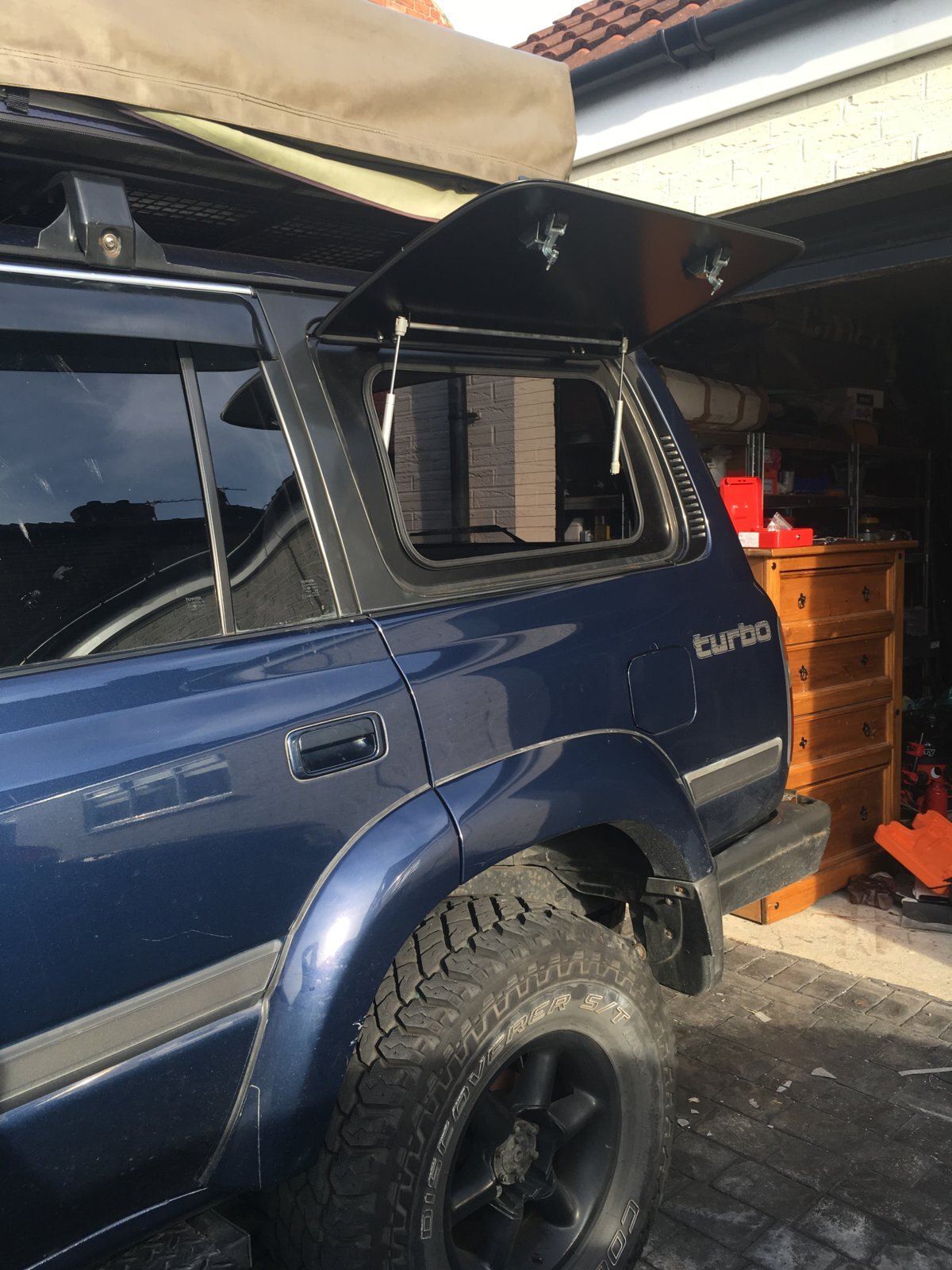

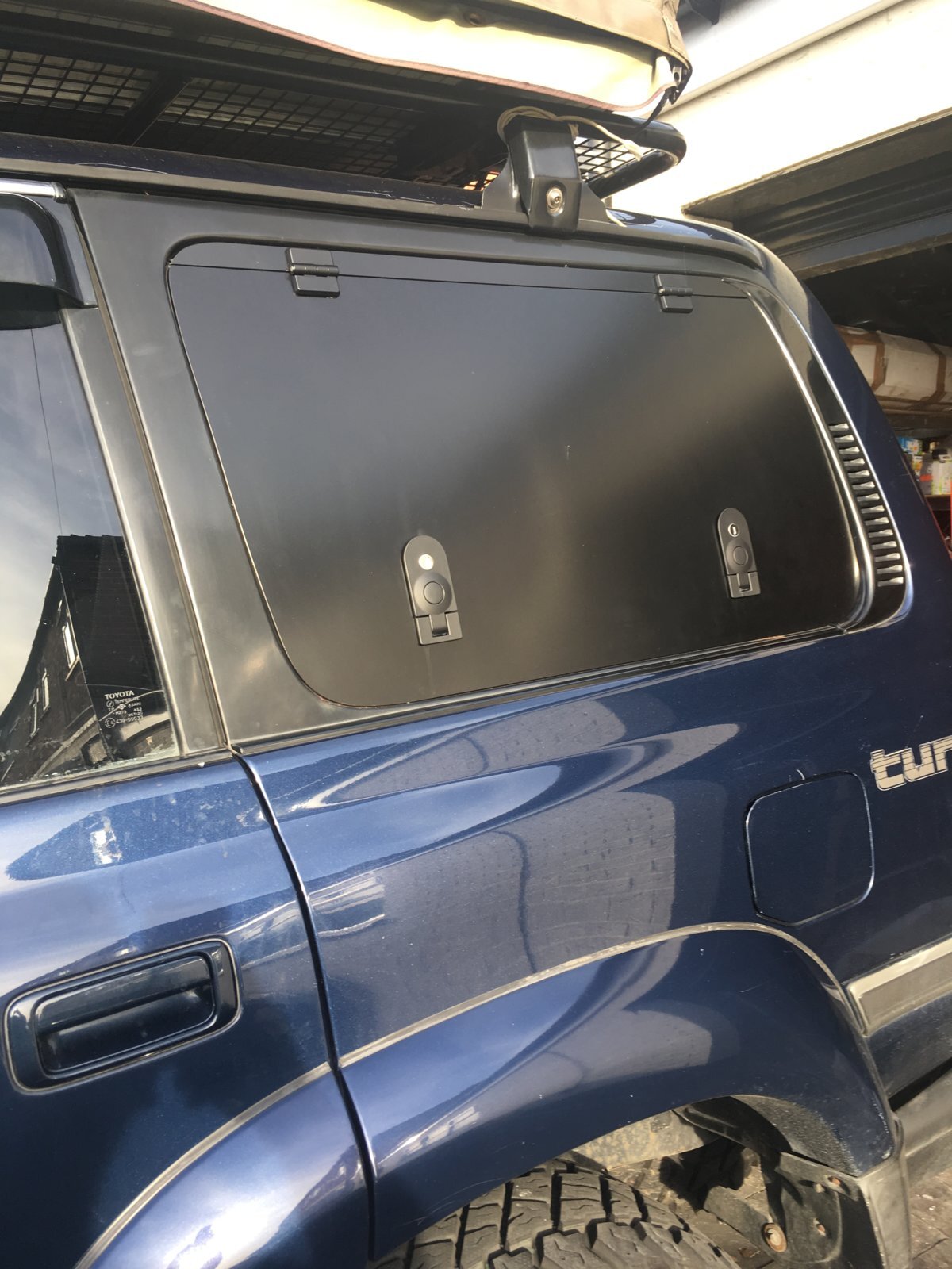

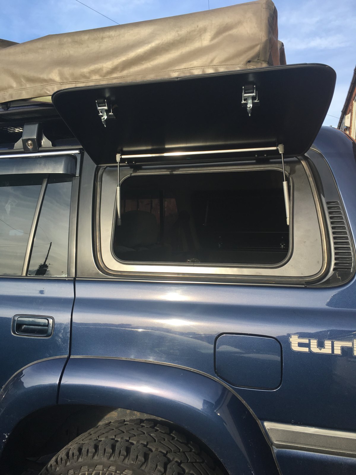

Arrived back to a mountain of parcels and the one I was really looking forward to .... Pop up windows from Rich . They're in but pics are to come. Really well built, packaged really well and I can't believe my luck.. The keys are the same as my roof box, tis destiny I tell you.

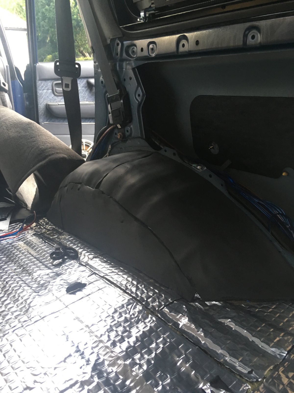

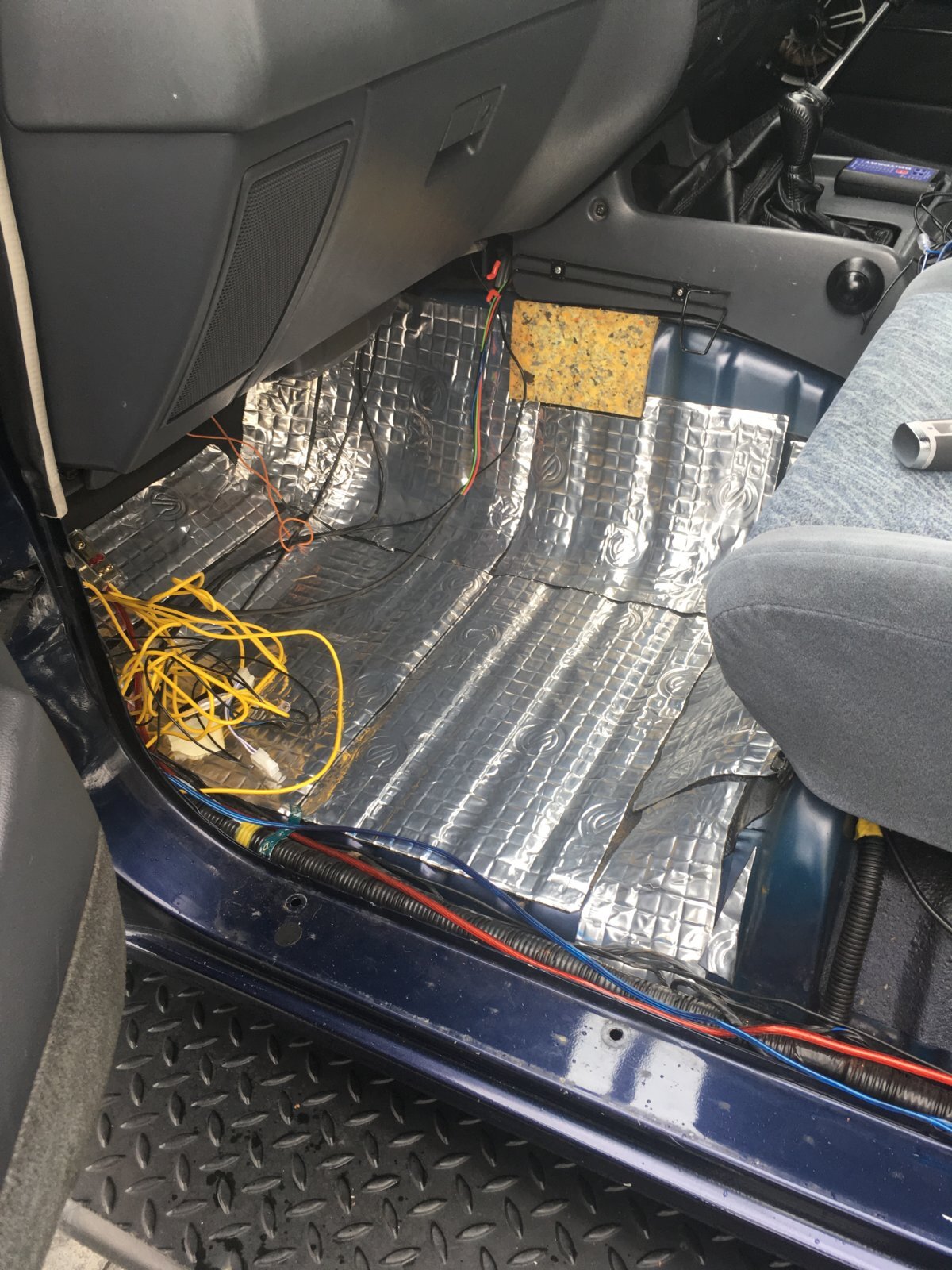

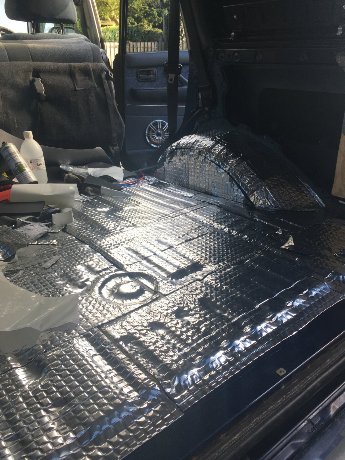

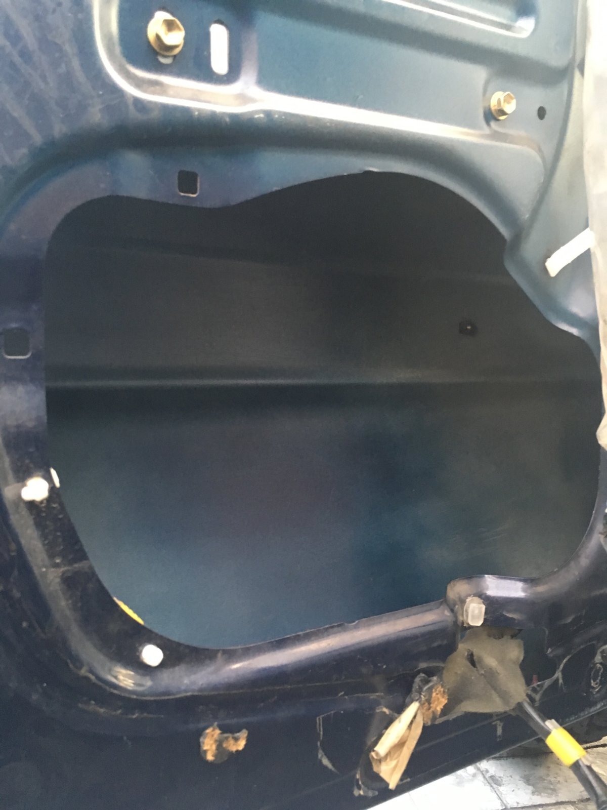

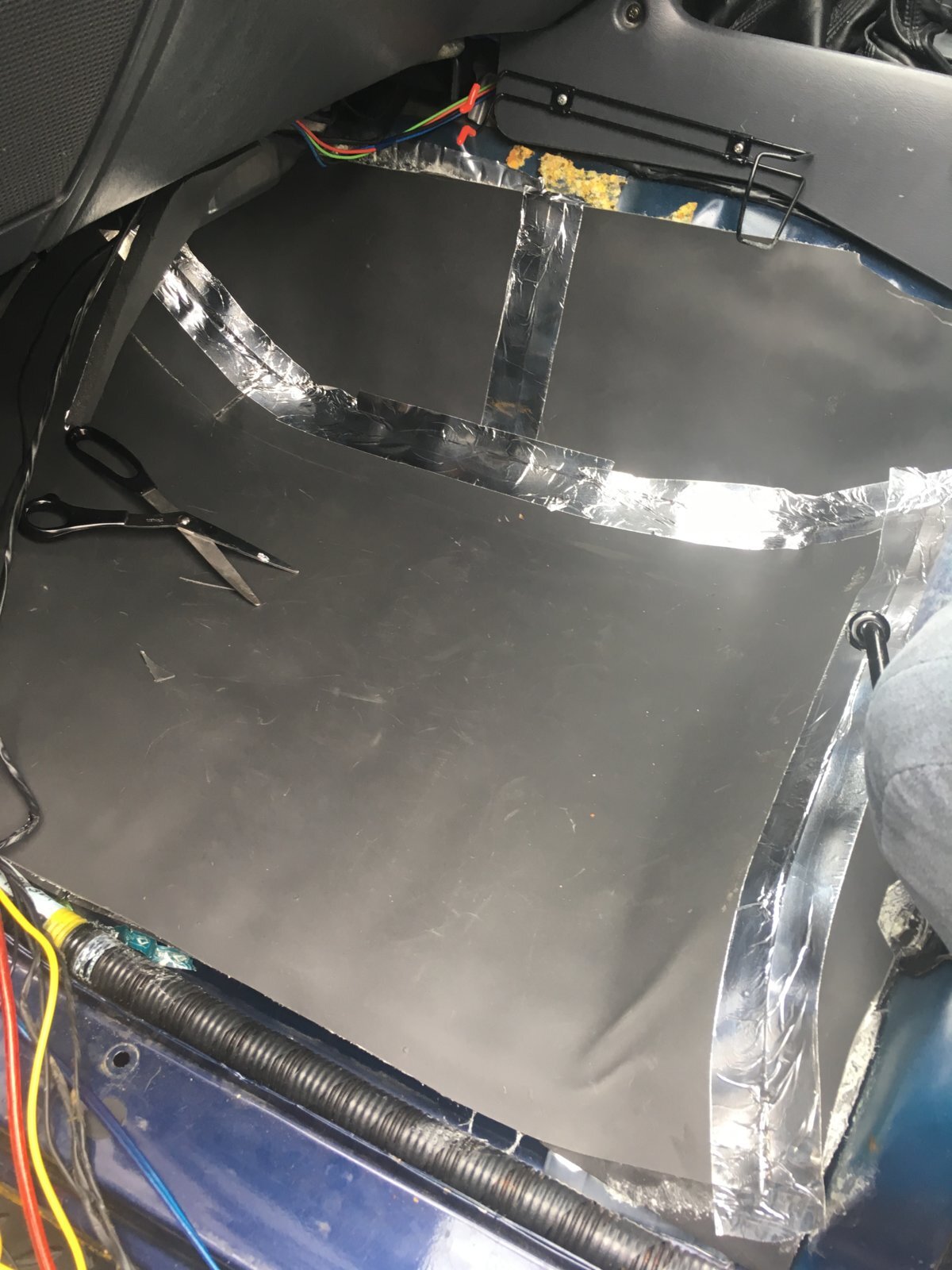

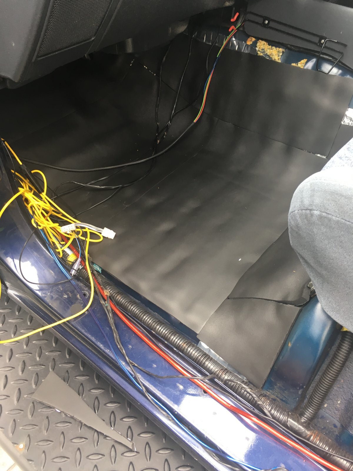

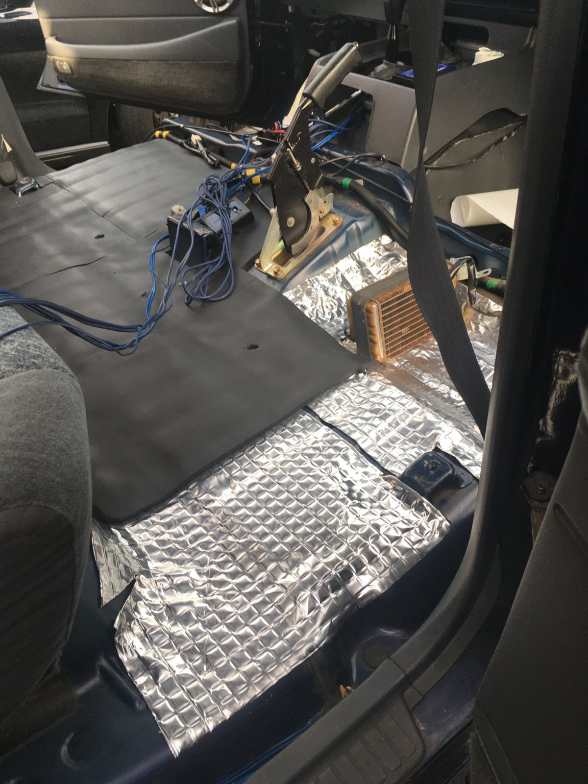

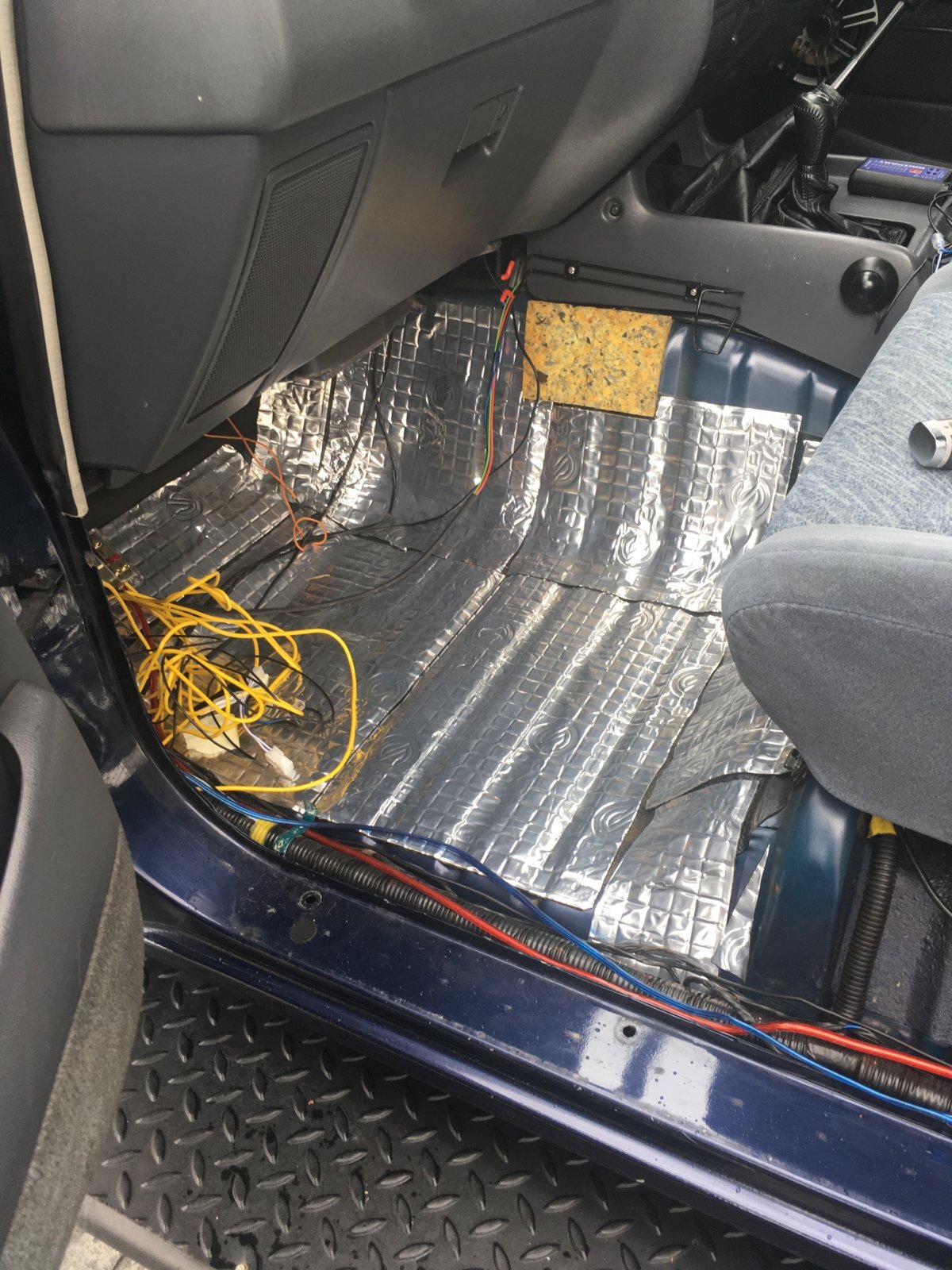

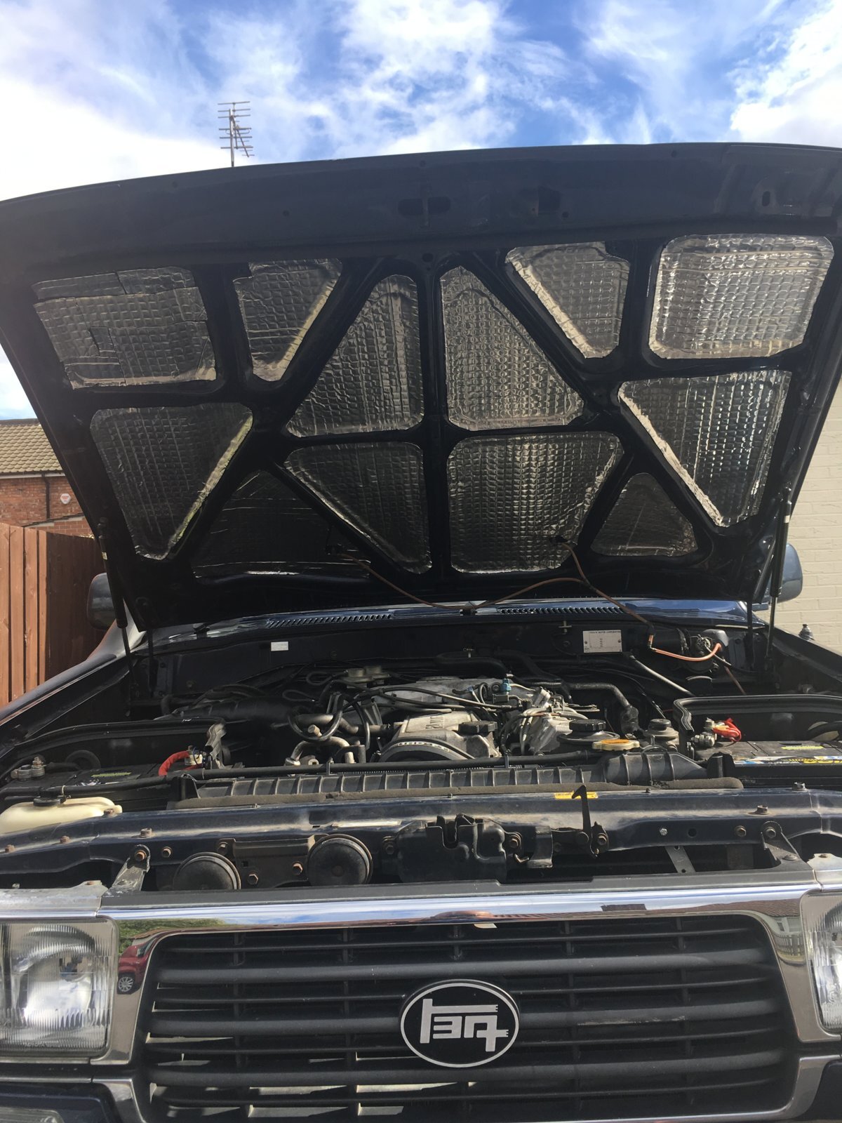

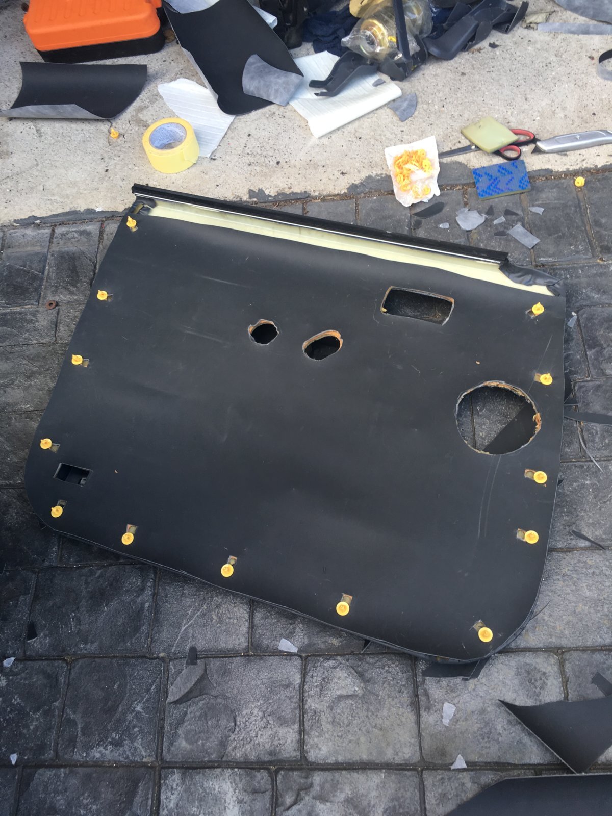

I have had boxes of soundproofing lying around for months so I bit the bullet and started.
First layer is sound dampening with an aluminium skin. Apparently you only need to cover 50% of the panel but she's a noisy girl and I over ordered.
2nd layer is a 10mm closed cell foam and the final (in most areas) layer is
Mass loaded vinyl 2mm thick.
I had to do it in bits and bobs as she is still a working car and most of the work was done between 5 & 9 am before the kids woke and demanded trips to the swimming pool, shops, etc etc.
Is it quieter ? I haven't finished and most sound comes through the doors anyway so I'll post my findings in a couple of days. I can say one thing though, without anything there the transmission tunnel is the main source of the cabin noise, so may double up the vinyl with another product in this area.
